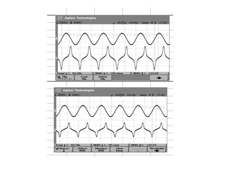

For the effect of nonlinear core saturation on current on voltage, see the thread
https://www.physicsforums.com/showthread.php?t=353333
and in particular post #12 with attachment. Here in my attachment are voltage and current waveforms from the thread for a transformer without a secondary load. The nonlinear inductance causes the primary current to spike when the knee in the permeability is reached. Excitation voltage is on top, and the primary current is on bottom.
Bob S
[added] Note that the peak (reactive) current lags the peak applied voltage by 90 degrees.

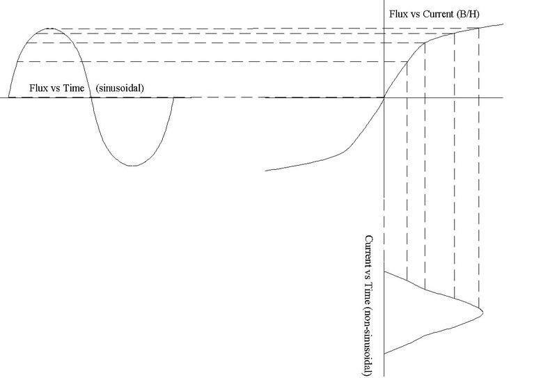

Yes no problems with that, but the flux is not shown. The flux is proportional to the time integral of the excitation (which is sinusoidal). The flux is not proportional to the magnetizing current in the case of a nonlinear core.
See my diagram of flux versus current attached. It's very crude (doesn't include hysteresis) but shows basically what's going on. Notice how a sinusoidal flux implies a non-sinusoidal current (and visa vera)
The whole point of this thread was to explain to the OP why it is the former (flux sinusoidal, current distorted) rather than the latter (visa versa) that is typically the case. The reason is that given by msj in post #6. It is because the flux is linearly related to the voltage and the current is non-linearly related to the flux. So for a sinusoidal voltage driven transformer it's the flux that is sinusoidal and the current that is distorted (that is, current distorted as shown in your attachment).

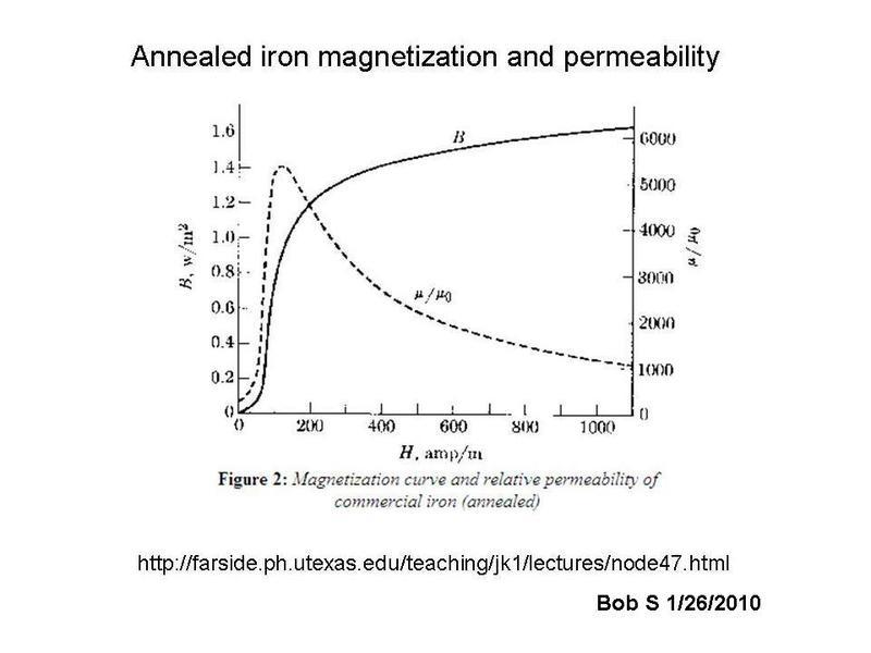

The flux Φ=B·A (where A = area), and the flux density B, are both functions of the iron core magnetization H. In mks units, the flux Φ is measured in webers, the flux density B in webers per m2 or Tesla, and the magnetization H in amp-turns per meter. See attachment for flux density plots for soft iron.
The attachment (left hand scale) plots the flux density (solid curve) against the magnetizing force, in amp-turns per meter. The relative permeability (dotted line), right hand scale, is also plotted.
Very specifically, B = μμ0 N·I
where μ is the relative permeability, μ0 is the permeability of free space, and NI = amps I times turns N. Note the knee in the flux density curve at ~ 1.2 Tesla.
Bob S
[added] The Faraday Law is
V = -N (d/dt) ∫B·n dA
∫V·dt = -N·B·A = -N·Φ
