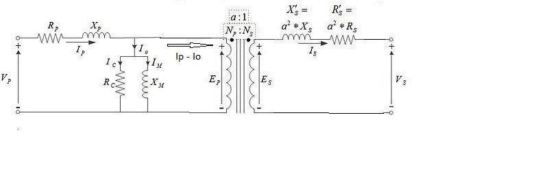

Hi all,
I've been having a conversation with a brilliant PF memeber about power transfer, but I wouldn't be surprised if my inability for comprehension has driven them to their knees.
I don't quite remember/understand how the concept of power fits into a transformer. I used to think that it was something to do with inductance storing energy from the primary in the magnetic field, then it would go out through the secondary.
Basically I know there is stored magnetic energy in inductance in the core, but I've been told it has nothing to do with power transfer (and it's purely Faradays law).
First, I want to get someone to clarify this:
I assume the inductance from Xm, is that actually the mutual inductance from both primary and secondary coils, ignoring leakage inductance, what I was thinking was something like:
Average Energy in core = 1/2 *L*I2 = 1/2 * (Xm*jω) * (IO)2
=1/2 * L1*(I1)2+M*I1*I2+ 1/2 *L2*(I2)2
=1/2 * N1Φ12*I1+M*I1*I2+ 1/2 *N2Φ21*I2where 1 is primary, and 2 is secondary, LΦ12 is flux from primary without leakage, Φ21 is flux from secondary
and total core Φ = Φ12 - Φ21
Using the characteristic of:
jim hardy said:
xy.php?image=https%3A%2F%2Fupload.wikimedia.org%2Fwikipedia%2Fcommons%2Fthumb%2F3%2F39%2FTREQCCT.jpg
2F%2Felectrical4u.com%2Felectrical%2Fwp-content%2Fuploads%2F2013%2F03%2Finductive-reactive-power.png

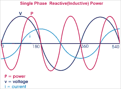

Where the inductance is on the primary circuit, power goes in from source, and goes back out to the source. So that power waveform isn't what's going to a secondary load.
So Thigns I'm seeking to confirm are:
Q1: (from the diagram) is the power of the TX going from one side to the other is equal to Ep*Is
= Es*Ip/a
This seems possible to me because I imagine that power is pretty much contingent on the secondary, as it's just an inductor when there is no secondary current. This should be true regardless?
Q2: Jim said that power goes straight across, without waiting (like a sinusoid) So is that average Energy equation that I wrote above right?
And if so, (given energy = power*time) does this mean:
Aveage Energy in core = 1/2 * (Xm*jω) * (IO)2
is going swishing and swoshing in and out of the core as reactive power?
So if Inductive energy has nothing to do with power transfer, then does one need to think of power being transferred through the ideal TX as:
At Case 1>OC sec: no power
At Case 2>small load on secondary, not much current through secondary: Es = N d(Φ12 - Φ21)/dt
At Case 3>large load on secondary, lots of secondary current: means lots of Φ21 pushing back, reduces the back EMF of Ep, means more current will flow through Ip, which will mean Ep*Is will increase and more flux will be produced for Φ12, which will mean that there is Es = N d(Φ12 - Φ21)/dt will increase as Is increase.
And, that's how the power is transferred across the Ideal TX?
Bravo - you open circuit tested it in your mind .
Indeed it's just an inductor so energy shuttles back and forth between core and source.
Let's think here
Energy in a magnetic field is in proportion to flux^2, see http://hyperphysics.phy-astr.gsu.edu/hbase/electric/indeng.html
And flux in a transformer is set by primary volts per turn.
So for any given primary voltage the core contains a set amount of energy .That amount does not change because of energy flow from primary to secondary.
(well, contains was a poor verb to use but it's succinct. We all realize the energy shuttles between the inductance and the source as in Tim's sinewave chart adjacent his transformer model, but had i said "cyclically exchanges with the source" i'd have lost the audience-- old jim )I think Tim has made remarkable progress in his mental workings of transformer action

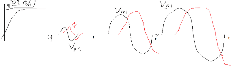

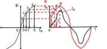

What he wrote above was a "Eureka" moment for electrical researchers of late 1800's .
Above discussion assumes sine waves which are a mathematical oddity (God Bless Euler and his Transcendental functions !) .
Flyback converters are quite another story - energy does linger in those cores.

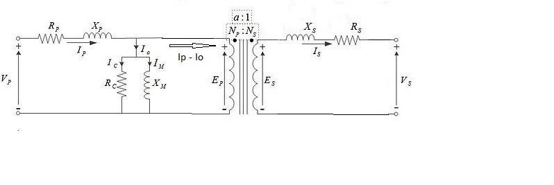

Well this is the trouble with words instead of drawings and formulas .
I write in a choppy style.
It's because i think in a jumbled mess and have to force myself to go back and put one step per sentence.
tim9000 said:
From your response I take it I was on the money?
well let's see.
tim9000 said:
So, (using the aforementioned diagram)
tim9000 said:
is it fair to say that the inductance L1 = Xm/jω
sets up a base flux Φ = L1*IO/N1,
you got that from definition of inductance, L=NΦ/I , right ?
If by N1 you mean the number of turns in XM
(which we can assign same number of turns as ideal TX primary at heart of this model)
I'd say instead Φ = L1*IM / N1
tim9000 said:
which is the flux at OC.
yes, OC = open circuit = no load
tim9000 said:
Then this flux stays, but get added to by additional flux when a load on the secondary
ahhh so now you have connected a load, we're no longer OC i see...
[load current in secondary] causes an opposing flux Φ12 from the secondary,
Some people sum fluxes,, myself i prefer to sum mmf's . I won't call you wrong
just for me the total flux is the total MMF/reluctance of core
so I'm holding my thought to see if we diverge further down the thought stream
tim9000 said:
which reduces the Back EMF of Ep,
okay some of the ideal transformer's primary flux Φ is removed, for you by secondary Φ and for me by secondary MMF
(Kirchoff has two laws , after all)
tim9000 said:
which increase Ip.
yes,
remember that the ideal transformer requires no magnetizing current
so now we have Is>0 for first time in this thought experiment
(look carefully where Is is in the model..)
tim9000 said:
Now here's where it still gets 'sticky' for me, so the power being used transferred by the TX is Ep*Is (I assume? please correct otherwise)
seems right per the model , so stay rigorous with labels
tim9000 said:
but when Ip increase there is a larger voltage drop on Rp,
indisputably
tim9000 said:
meaning that the Voltage on Xm will be less,
slightly less yes
tim9000 said:
meaning that IO will drop
slightly, yes, there are fewer volts per turn of induction but more volts per turn of IR drop
tim9000 said:
and the base flux (Φ = L1*IO/N1) will be less.
slightly less, yes
tim9000 said:
But how can this make sense with more current running through the primary coil,
That primary coil is on the ideal transformer. So none of those Is amps are magnetizing amps, they're all load amps.
tim9000 said:
I'd have thought the flux from the primary would fight back from this increase in current?
That piece of logic i cannot follow.
Primary and secondary amp-turns in an ideal transformer are exactly equal, there's no magnetizing current (infinite inductance)
Primary amp-turns rise to match secondary amp turns.
Perhaps this would help your thinking:
go back to the model
Set turns ratio = 1 so it's out of the way.
Move X"S and R'S over to secondary side in between ES and VS.
Observe that's where it belongs anyway,
and draw a second Is arrow over there in secondary flowing through the secondary X"S and R'S .
Now what voltage Ep is impressed across ideal TX's primary ?
Why, of course, IM* XM.
That's what is left of VP after RP and XP each have taken their bite.
(sorry - too much shark talk on TV right now)
It's the magnetizing current that makes counter-EMF not the load current.
Moving secondary impedances over where they belong made that more visually obvious.
Kirchoff rules, take him one step at a time
He rules for volts, amps, maxwells and oersteds.
just be methodical and rigorous

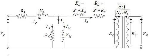

here's the model with secondary impedance moved over into secondary...
so what is flux in primary of ideal transformer?
It's whatever is voltage Ep divided by 377.
And voltage Ep is IM * XM
That may be the root of our miscommunication i don't know.
Surely it'd resolve with some application of Ohm and Kirchoff to our model.

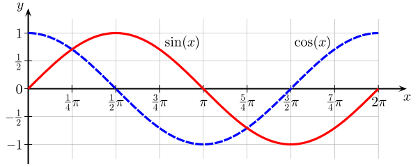

Is it just convenience you can say flux is the sin and voltage is the cos?
I'm not sure that's the root of our miscommnunication, I'm not even sure it is a 'miscommunication' as such.
Shouldn't the a^2 terms in the secondary impedances be removed?
Likes jim hardy
indeed it should be - victim of click and drag.
Likes Nascarnut
yes. Start simple. Start with flux = cos if you prefer.
You know volts and flux have a derivative relationship e = n dΦ/dt ;;;
and from high school precalc that d/dt of (sinwt) = wcoswt

Is this how the model responds?
back to model (fixed those peaky a's that The Electrician caught)

Real transformer? Not the model anymore? Draw what circuit you want to address and label the currents.
Your wording sounds as if you mean (Ip -Io) took a bite from IM instead of Ip and i don't want to assume different.
Net MMF is a sum of all the currents , phasors are handy for that calculation.
Flux willl be that MMF divided by reluctance of the core.
Since you said it's a short circuited secondary the net flux will be low, in the linear region of the curve well below saturation.

How's this?
Although wouldn't the voltage drop on (Rp + Xp) have to be very very big for a significant drop in the flux of (in the real world core) to reduce IM enough to reduce the flux significantly?
No need to mist up "fight-back fluxes from Ip" and counter fluxes from Is, they're all contained in the ideal TX and you can always say (loaded or not) that the net energy of the core is calculable from the inductance of XM?

What's the larger current ? Ip or I am ? From whom does (Ip-Io) take his bite?
The voltage divider action between (Rp + Xp) and the rest of the circuit determines Ep.
Ep over Xm determines Im.
Which establishes what must be the magnitude of flux in the ideal transformer's core.
To me you've confused cause and effect.
tim9000 said:
s the root issues I'm having is that a secondary flux starts opposing the flux caused from XM, and IM drops so the primary flux drops. Even though Ip has increased, there's no primary flux push-back from the increased Ip.
You've flipflopped on me again. What's driving the system ?
Let Zp = Rp +jSp .
Im drops because Ip* Zp went up ,
lowering Ep a little bit.
So net flux went down a little bit.
? push back ? Where ? Are you acknowledging tug-of-war?
Ip-Io flows in primary of ideal tx and Is flows in secondary.
Since you sum fluxes, and fluxes are in proportion to currents,
over in the ideal transformer,
the increased primary flux is canceled by the increased secondary flux.
Their sum remains that number established by I am through Xm for whatever is voltage Ep.
That's equilibrium.
Since i sum MMF's, their MMF's add to zero which is the MMF necessary to push any amount of flux,
namely that number established by I am through Xm,
through zero reluctance.
That's equilibrium.

It's down to elementary circuits now
set Rp = 0, Xp = j1, Xm = j1, Rc = ∞, Vp = 1, Rs and Xs both = 0
and solve for Vs & Is at OC
and then with shorted secondary..Lavoisier :

Still addressing our model ?
If so
Yes,
but which current are you applying to XM (XM in the model)
That energy has to be half LI^2 where I is IM and L is XM/ω.
What do you think?
That leads to the observation that the energy content of a transformer is more a function of the voltage across it than the current through it.

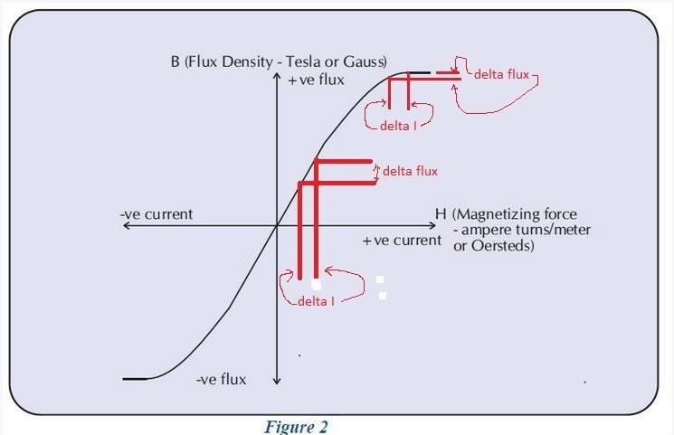

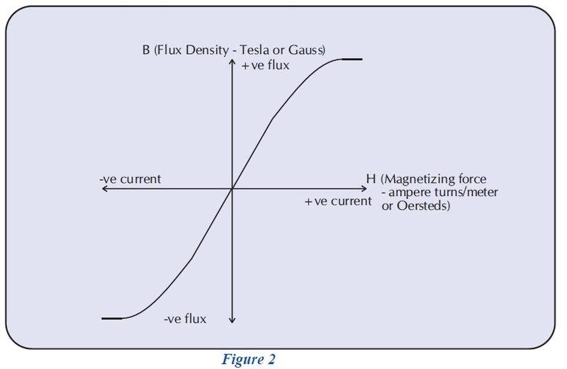

tim9000 said:
-I know you want to push as much flux through your core as you can, to get value for money, so you opperate it at the knee point. But if the maximum permiability of the core is at the steepest slope point along the BH curve (a bit before the knee), then wouldn't the flux be biggest there, and the inductance highest at that point too?
You're speaking of a "slope". When such words are used, it's usually in a discussion about "small signal" performance.
Yes, when the slope of the BH curve is steep, the incremental flux will be largest there, but not the overall ("large signal") flux.
Likes dlgoff and jim hardy
  • #31
A picture to go with Electrician 's observation
Where would
flux be the biggest
Where would flux per amp be the biggest ?
Likes dlgoff

On your curve I'd say it'd be at zero, but I was thinking more of a BH curve like this:
https://upload.wikimedia.org/wikipe...Permeability_of_ferromagnet_by_Zureks.svg.png
Where the point would be μmax

Ok using the model (with Rp and Xp still present):
https://www.physicsforums.com/attachments/transformer-jpg.84964/
So using that BH curve at the point of μmax, with respect to: LM= μN2A/Length = N2/reluctance
Assuming we had some arbitrary constant cross sec area and number of turns, then μ is higher than when opperating at the knee point,
So I'd conclud that the inductance Lm is bigger and so Io is smaller. But since also Lm = Φ*N/Io than for the dependant variable:
Φ = Lm*Io/N
I'm not quite sure if this stays the same or not? (Given Lm has risen and Io has shrunk) So I can't really compare how the TX differs from use at the knee point...maybe I'm just tired atm...(packing boxes to move/tending to yard all day)
My use of the word slope is due to my lack of technical discipline/awareness.
Could you please elaborate on 'small signal performance'? Sounds interesting: By incremental flux do you mean like the rate of increase of flux? (but by 'large signal' do you mean like the end result peak flux?)

Yes, look at your model that is the magnetizing current IM .
What i think is the point of confusion comes from imprecise terminology in the industry.
A transformer core doesn't operate " at " a point on the curve.
That is a DC curve and only shows one quadrant.
The transformer flux is a sine wave swinging between some positive and negative value of flux every line cycle.
In my BH curve that'd be upper right and lower left quadrants.
Yours omits the lower left, so just imagine it's there.
Flux swings from above to below the horizontal line, mmf swings left and right of the vertical one, at line frequency.
When we say a transformer is operated "at" certain flux we usually mean that's the peak flux. value.
Flux is a sine wave with that peak value.
So the core is operated not "at" but "out to" those two peak values, and flux crosses every point in between them 120 times a second.
Flux 'walks the line' , the gray one, crossing all points between its peak values twice per line cycle ..
The blue permeability line in your BH curve is just slope of the gray flux line, as electrician noted.
Its purpose is to demonstrate iron's nonlinearity
which is why magnetizing current gets that pesky distortion as flux traverses the knee.

tim9000 said:
But the question was relating this to the opperating point on the BH curve, I suppose what I was eluding to is that if you're opperating further back down the left side of the curve is Io smaller?
You're not operating at a point you are operating between two points positive and negative peak.
In most power transformers those points are symmetric about zero.
Variations in incremental permeability will more affect the shape of magnetizng current than its amplitude..
Its amplitude is set primarily by how far out the B axis you push the core.
A search on "Barkhausen effect" might help cement the B-H curve in your mind.

Now that is food for thought, I suppose that is one of those things I probably did realize at one point but since I'm not working in industry yet my synapses haven't solitified.
Ok, so the knee point is the peak flux point, it doesn't really opperate there. So does this mean that the famous Xm we've been talking about is the peak magnetising impedance?
Right so about the whole "peaky distorted" magnetising current when it goes nonlinear: so the flux will have a nice sineusoidal shape up as we run up (or down, +/- quadrants) the BH curve, because BH is kind of linear there and in a linear core the flux will have the same shape as excitation supply? But when the flux wants to follow the shape of the supply (90 deg lag) but it can't because the core is saturating, the flux sort of flattens off.
I'll be keen to hear your (always appreciated) response/evaluation of my development.
You're getting there.
Back to stepwise thinking.
What have you selected for your independent variable? The one you control ?
I like to use voltage.
"it" meaning the BH curve, so each incremental bit of flux beyond the knee requires a disproportionate amount of magnetizing current
If we chose voltage for our independent variable then flux must equal its derivative , whoops, integral jh sine and cosine have same " sineusoidal "shape
Have you leapt again ?
"excitation supply" voltage? Their respective shapes are set by math - derivative function.
If the core is linear, MMF will have same shape too because reluctance is constant.
MMF is amp turns. So the the BH curve sets the relation of current to flux , not the relation of voltage to flux.
Again, what did you start with as independent variable?
In ideal inductor(or transformer) Flux and Voltage must keep that derivative relationship.
When the core begins to saturate , more magnetizing current must flow to push flux through the core which is becoming increasingly reluctant to accept it.
Again you have switched independent variables on me - from voltage to current to flux and back.

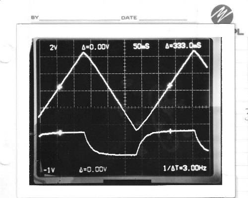

Here's a real inductor with not-sinewave excitation.
Top trace is 20 milliamp peak to peak triangle wave current.
We controlled current as our independent variable.
Bottom trace is induced voltage .
Observe voltage approximates d/dt of current
corners are rounded and top is not quite flat because iron is imperfect - eddy currents and creep(as in barkhausen)
flux was too small to get anywhere near saturation
and this was only 3 hz
It is not clear to the eye that a derivative relation exists when looking at sine waves
this 'scope trace was an eye opener for my technician (who questioned much like you do)
what would voltage do if we reached saturation? Remember we control current...
i think voltage would taper off to zero between current peaks.
because flux would flatten instead of following mmf.
Learn to think in terms of slope - that's derivative...
