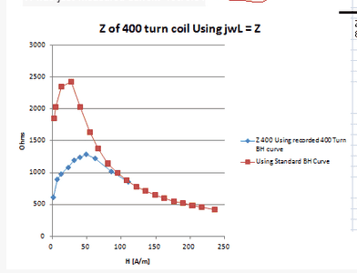

This is probably my most important point of interest at the moment, because when I create an expectation of impedance for a 400 turn curve using the mu curve from the 840 turn BH curve, it is different to if I use a mu from this curve to generate an impedance curve for a 400 turn. (as in Z = wL as a function of B/H)
I find it crazy they're not the same shape BH curve, I can't explain it.

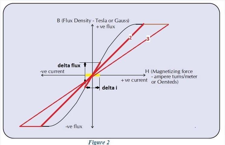

tim9000 said: ↑ But even fundementally, even if we had perfect equipment, I still don't understand the tangent slope, or the red line slope, what the difference between the two means, or rather, specifically why the tangent to the curve is V / I, any more than the red line is Z. Case-in-point see post # 205.
and here's 205
You may recall I've made mention that I'm still confused regarding ΔV/ΔI I can kinda see why it's the tangent on an actual BH curve because V/N = dΦ/dt However the VI curves I took my excitation V goes up only, it didn't waver, as did my current, now if I take V/N = Area*(B2-B1) points on the BH curve that V/N number will decrease as the curve flattens. So that V is what? the voltage on the core excluding coil? Regardless if I take Area*(B2-B1) / (current2 - current1) from the BH curve it will give me numbers which don't mean anything to me, don't look like impedances I recognise. As I've said if we were taking the direct V / I of the V vs. I curve I could see how that would give us the impedance of the mag amp, but I don't see why the tangent to the curve is relevant...[Anyway I posted some Z comparison curves before.] Thanks
hmm we must be on parallel but not congruent trains of thought .
i'm going back to basics.
cause i try to think through each question and i get confused,
This is a BH curve
horizontal is ampturns per meter and since turns and meters are constant, it migt as well be amps
vertical is B, Teslas, if area is known it could as easily be Φ , Webers
If i sweep amps back and forth about zero, at line frequency, flux will sweep up and down the curve also at line frequency.
Definition of inductance is flux linkages per amp, NΦ/I,
and every point in that red line segment has same ratio of N to I
so inductance L in that region is constant and given by slope of red lineWe don't have a flux meter so we'd have to jump through hoops to reproduce that curve.
But before we leave it let's recall way back from post 17
nobody said we had to sweep about zero amps
we can push flux midpoint away from zero by adding dc amps(amp-turns), via same or another winding
and we observe that slope of ΔΦ / ΔI decreases as curve flattens out.
We don't have a flux meter but we do have a voltmeter.
since the core is enclosed by some turns,
the changing flux will induce voltage into those turns
so a voltmeter will report n * delta flux in webers per second
since n is constant, voltmeter will report rate of change of flux.
so an AC voltmeter would report our delta flux dimension at any operating point on the curve.
and an AC ammeter would report the delta I dimension
and the ratio of the two meters would give inductance
Now we make a big assumption that let's us move from that swept DC graph to an AC graph.
That assumption is we have sinewaves
sinewaves have the unusual distinction they don't change shape when they get integrated or differentiated, just their phase shifts 90 degrees and amplitude changes by ω, 2Πf .
That allows us to use AC volts as a measure of flux's magnitude not just its rate of change.
Volts = -n dΦ / dt
if flux is a sinewave sin(100Πt) then voltage is a cosine wave 100Πcos(100Πt)
so if we know volts instead of flux , we know flux has magnitude (volts /100pi)
That let's us plot volts versus amps using sinewave voltage excitation (which has to produce cosine flux assuming no IR drop)
And since we're using AC there's no negative, and we make a single quadrant graph like yours
from post 86
they look strikingly similar to one quadrant of the DC curve.
Since volts is proportional to flux (on account of our sinewave assumption)
we might as well use this plot with the caveats:
1. Current will distort from sinewave but the ammeter will report with accuracy good enough for our purposes...
2. The meters report RMS assuming sinewave form factor, so peak flux is maybe 41% more than our numbers suggest and current peaks may be much more than the numbers suggest. Remember those horrendous current peaks in post 92
To produce the numbers for those two plots you swept current and voltage about zero
so you extracted numbers from sweeps like these and plotted rms delta flux measured by volts versus rms delta amps
and what was plotted won't flatten out on the wings so severely as does the B curve
because we swept across the entire curve , through zero.
But it's the best we can do with meters.
Recall inductance out on the flat part is less than in the steep part because μrelative becomes so small.
so after we cross the knee BH flattens out
had we swept only between current 2 and current 3, Δvolts would be miniscule
and that's why impedance out on the wings is the slope.
Actually it's the slope over the range of current sweep .
So, for your plots with no DC, impedance is volts/amps because you swept symmetrically about zero
WITH DC, your AC meters will still report volts and amps over the range of sweep, maybe from red line 2 to red line 3
and their ratio volts/amps is the slope over that range of sweep

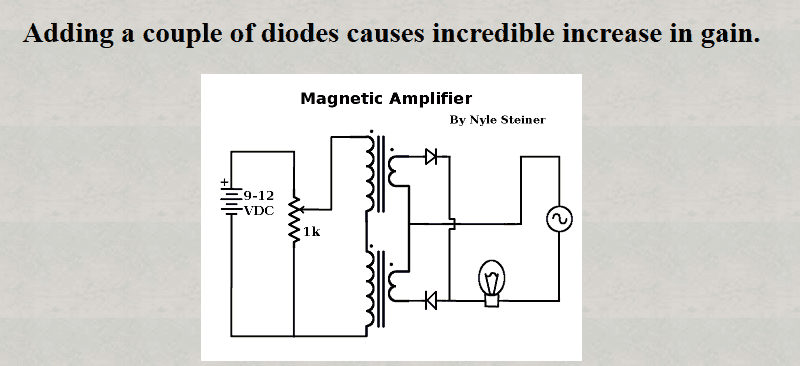

this is from post 192

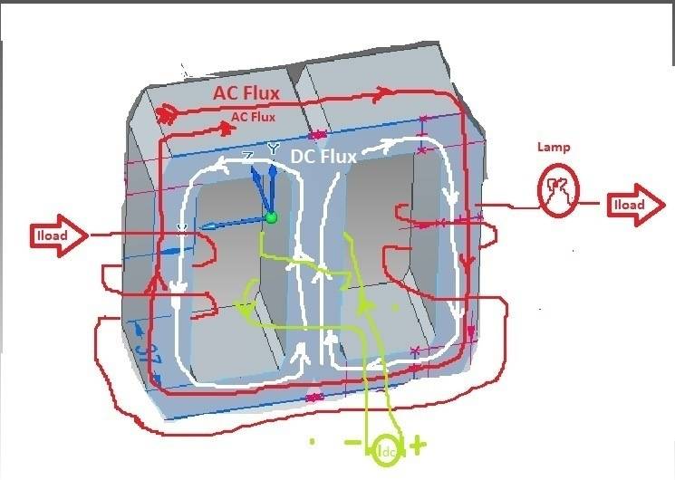

I thought this may be of help, I took extracts from my large data set where I was exciting the two series 200 turn coils, for values where the DC was off, remember V3 is the voltage across the Amp:
is current really 0 to just 100 microamps ? I have to think you meant 100 milliamps...
and was this with a lamp load or just the coils across a supply ?
Lamp load will not allow big current peaks , the voltage will shift from coils to lamp during that part of wave, meaning we no longer have sinwave excitation voltage nor do we have cosine flux.
That's my best guess right now...
If you had no lamp load
then we must take a look at flux in the core again
DC flux zero, Rlamp zero, windings in series aiding
reluctance of path should be sum of those legs
only imbalance will traverse center leg
if instead they're in series opposing
now flux takes the white path instead of red path
iirc center has 2x area of outers, so saturation should be sharp because B is same everywhere

R.E. post #216: It's like shunting between the two excited 200 turn coils (the centre leg), has lowered the peak permeability and increased the necessary H [A/m], making the BH Curve for 400 turns much more linear. And yes, as you say they are series adding so only imbalance will traverse the centre leg, so I'm not sure why the BH curve of my 400 turns is so different.

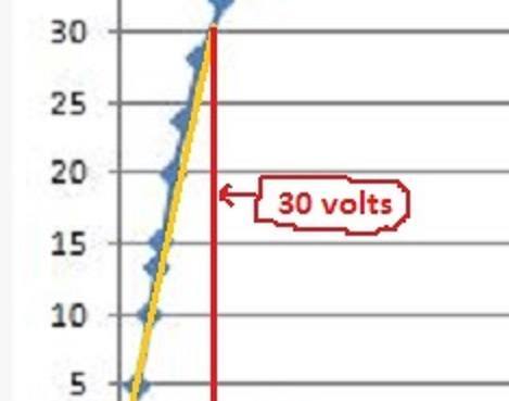

tim9000 said:
That was for the lamp in series with the 400 turns, with the DC control OC, V3 was the voltage just on the 400 turns, but the current was ofcourse going through amp and lamp-load.

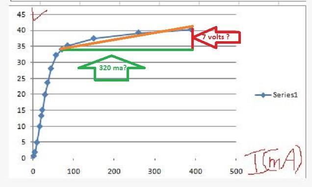

this curve ? Taken with lamp load?
compared to this one, with no lamp load?
Let me take that lower one which goes to 500 ma
and stretch its horizontal axis to about same as upper one that goes only to 100 ma
that places 100 ma on both plots at at about four fingers out on horizontal axis, on my screen
and 35 volts per coil about two fingers high
still , in your upper curve out past the knee current rises more slowly with voltage, which i'd attribute to load resistance reducing peak currents.
can you rescale your plot and see what it looks like?
View attachment 87965Let me take that lower one which goes to 500 ma
But this also looks like it's effecting the BH curve BEFORE the knee! As it rises slower
So the BH curve is only useful for telling the knee point value, everything else about the curve shape is variable? The more resistance in series with the amp, the less inductance I can get out of it? That's cruel.

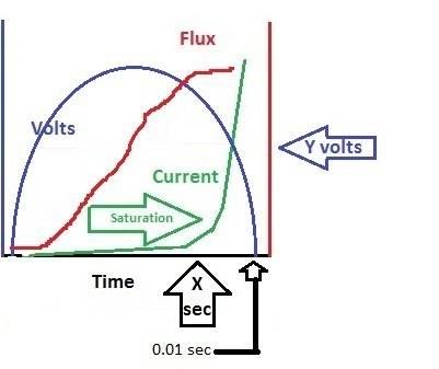

i am crcumspect of calculations because of the fact when we get to the knee, inductance changes every cycle and current depatrs from sinewave.
Recalling that for modest excursions past knee, saturation happens late in the half cycle so voltage collapse will distort voltage less markedly than current wavewave especially with some load to limit the current spike

i saw ~30 volts per coil at 50 ma on both graphs, but that's by eye
  • #225
What was the name of the Transducer book again?
So does a true rms meter with an actual iron vane inside still show the actual RMS of a non-sinusoidal current or voltage? But if it's not sineusoidal we're up the creek as to knowing what it's actual peak is?
jim hardy said:
tim9000 said:
But this also looks like it's effecting the BH curve BEFORE the knee! As it rises slower"
Which graphs are you talking about? The 200 turn and 400 turn? Is that just a coincidence? Well what I mean about the load affecting the curve shape slower rise before saturation too, is:
These are the BH values calculated from V and I with no load for the 840 and 200 turn coils, but with the load on the 400 turn coil. The Voltage used to calculate B for the 400 turn was V3 directly over the amp, not the supply:
You can see it's resulting curve at the bottom below (as I have posted previously) Zbulb is in Ohms:
However the curve above that uses Vexcitation (a.k.a V1) and Zamp and Zbulbs, to calculate a new value of H:
H = 400*(V1/(jwL-ZBulb))/0.31
to try to create a value of current as if there was no load bulbs, so it'd be recreated like the other data curves. You can see the shape is pulled back, so that it is steeper, however it seems to cross the 1 T point at over H = 120+
whereas before it was near 100 [A/m], and for the other 840 and 200 turn curves it was a bit over 50 [A/m]
The new permeability calculated with the new H still doesn't resemble the 200 or 840 turn coil. One other strange thing is that when I give the same treatment to calculating B400 turns, using voltage divider to calculate the voltage on the amp, rather than just using the measured voltage on the amp, it changes the shape of the curve a bit. but I don't know what to make of it, just adds more questions (it doesn't even get to 1 T):
I see in your sketch as the amp saturates and it's impedance collapses, so does the voltage on it, but as the current starts to spike the resistance of the bulbs surpresses it, but that's during saturation, what about before, when I want to get maximum gradient on the BH curve, and maximum inductance. Can you explain by what mechanism is actually stopping us from reaching that same permeability we thought the material of the core offered, anymore?

jim hardy said:
from his page
each of your outboard legs would see halfwave not full rectified
jim hardy said:
mmmm i think that's why they add diodes to make it self saturating. That's positive feedback, gives much higher gain.
What's happening to the dΦ/dt abovee compared to whole cycle? I assume it's the same?
I don't really understand the gain aspect, or you saying that "self saturating...positive feedback". How so?
I understand that there's a loss in re-orienting the grain of the steel, so feeding it in only one direction cuts out on the magneto-strictive waste, but how else is it positive feedback, how else is the grain improved and how is it self-saturating?
I'm not convinced there is noticeable difference below the knee.
That was basis of my remark above, 'both curves are two fingers high on volt axis at four fingers out on current axis'
I could only resize the two graphs to same scale by stretching with Paint and you see the results.
So long as Vsupply remains too small to push flux into saturation region, current does not spike and bulb remains very minor player.
What were raw measured volts-per-coil at 30 ma with and without lightbulbs ?
I still haven't accepted there's a difference,

But I've had a think and I may have made a bit of progress regarding the BH of the 400 turn, I think I was using a wrong magnetic path length, increasing it, it looks like this:
You can see it's closer to the 840 and 200 turn BH curves, HOWEVER I also had to change the 200 turn magnetic path length from 0.2274 to 0.28m, to get it to sit exactly over the 840 turn BH curve as you see above. BUT the 400 turn curve IS STILL FORWARD a bit and I'd like to know why! So it's permeability still isn't quite right, which is infuriating. You can read in the blurb in the picture, I think that as you said the non true RMS meter becomes dodgier and dodgier as the voltage gets higher and KVL is no longer represented truely. So I think that the current is probably pretty accurate and each voltage reading gives an 'ok' impedance when divided by the current, but still not great, and if you add the voltages up to get a resistance value than you're compounding the inaccuracy, as demonstraited if you used a calculated expectation of the bulbs:
Zload = 50.4 + 2008.8*current [Ohm]
That will give an even more dramatic divergence in the 'indirect curve' shape:

So there really isn't a ΔV/ΔI, infact Z*N = V/I = dΦ/dI ?
That is to say, 'the tangent to the BH curve IS the direct V/I curve value'?
However I don't understand how "and an AC ammeter would report the delta I dimension", unless 'delta I' is the same as = " H*length / N " because that's the conversion between BH and VI curves if I'm not mistaken?
You can see the big black current meter in the picture in post #93, I'm pretty sure it was a true rms ammeter, don't you think? So how would that show the current if it was very not sineusoidal?
This logic I would like to hear more about:
I concur about that being the part where the sweep takes place, that area is caused by the BRMS adding and subtracting from the BDC, so it won't be too big and since it's in each leg and they're symmetrically opposite they should ballance out to just BDC shouldn't it?
{When you're looking at the VI curve Z = V/I, when you're looking at the BH curve Z*N = dΦ/dI }?? Unless you're saying that doesn't hold because the instruments measuring are inaccurate because of the non sinusoidal voltage and current?
i'd thought maybe we needed to visit path lengths , and i see from later posts you did.
for each condition of excitation
we need an equivalent magnetic 'effective path length'
i just guesstimated to center of core cross section from the drawing, you can actually measure more carefully and contemplate flux .
^^^^^ that sketch there tells me that 200 and 400 turn readings will have a different approach to saturation.
Remember the parallel with Ohm's law: MMF = Flux X Reluctnace,
Let us consider a single 200 turn coil on left leg, pushing flux clockwise.
Effective peth length is series-parallel combination as in sketch, and check my number...
1. Flux in leftmost three segments flows through area A.
2. At junction with center leg, that flux splits 3 ways, some going down through area 2A and the rest continuing to right through area A.
3. So long as we're in linear area of core, mmf drop across each segment of the core is in proportion to flux/area X length
4. As soon as leftmost three legs approach their knee, they absorb larger share of MMF. Center leg and rightmost Dsection are not anywhere near saturation.
So i'd expect 200 turn curve to be pulled to left and show slightly higher flux at saturation?
Did it do that? Check my thinking, I'm famous for dyslexic thought reversals.
Repeat for 400 turn, ie both outside legs excited
Effective path length is sum of outside pieces
Flux now flows clockwise around outer loops, middle leg sees only unbalance so it's not abig mistake to ignore it (a big shorted turn around it would keep flux out of there).
Significant difference is now the whole path has same flux and same area so it hits knee all together instead of piecemeal.
That'll surely give a different approach to saturation ?
Repeat for 800 turn.
Path length is now parallel combination of the two D-sections
Again flux density is same everywhere so approach to saturation will be well behaved, maybe even better than 400 turn because center leg is no longer an unknown.
Now back to your curves
Should volts per turn vs current curves differ by ratio of path lengths ?
But when corrected for path length, agree pretty closely, but 200 turn curve affected by non-uniform B around its magnetic path ?
Your last graph looks really promising in that regard.

With addition of the diodes and swapping from series to parallel,
let's look at what happens in each core.
First,
observe that load current (if any) is pulled out the dotted end of the load windings
making the dotted end of the control windings positive
which makes the dotted and of the control winding positive, opposing control current source.
From an old Navy training booklet, http://www.themeasuringsystemofthegods.com/magnetic amplifiers.pdf
it'd be easy enough to make your three legged core slf saturating.
Anyhow here's what happens
Control current holds core well down below center of BH (or volts/amps) curve
amplifier remains cut off because it has enough core to not saturate on a half cycle's volt-second product.
That is, when it started from significantly negative flux.
Now if i raise control current gradually
i'll come to a point where the core no longer can hold off applied voltage
and load current will commence to flow, copiously.
1. No longer in series,, the opposite coil is no longer demagnetizing that leg by load current. Diode blocks any current that would try to demagnetize it.
2. Load current now drives core further into saturation , so impedance collapses allowing more current yet and that's positive feedback.
There's no opposing voltage from other coil's being driven against control coil flux, remember they're no longer in series
The collapse happens over a much smaller range of control current , hence we say gain is higher.
Gain in practice is so high it's almost a bistable, and a bistable is just a high gain element with teeny amount of positive feedback.
To get manageable gain they add another coil where load current opposes saturation(negative feedback), with a lot fewer turns than load coil. That's negative feedback. So you see, they create a high gain element using positive feedback(self saturation)
then surround that high gain element with some negative feedback to make gain predictable.
Remember G/(GH+1) ? In opamps G is a million, in magamps probably hundreds.
Anyway that's why almost all magamps are self saturating (dammot italics sticking again)
and what you are building is a saturable reactor, precursor to magamp.
old jim

tim9000 said:
OR is does maximum inductance point depend on V.s/N and Area?
?? inductance has to work back to n2 μrelative μ0 Area / Length of path
and only thing not a hard constant is μrelative, which is a function of flux...
inductance curve should be identically shaped scale model of permeability curve ?
hmm italic worked okay here.

Hi Jim, Thanks for the replies!
jim hardy said:
Path length ? Didnt you already come to that conclusion in above graph ?
I Don't think so, because path length doesn't enter into the data here:
Isn't μrelative actually a function of B and not flux?

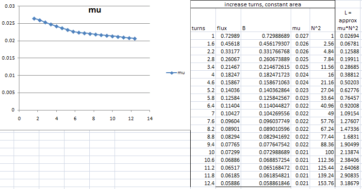

Thats what I thought (about inductance curve having the same shape as μ curve), then I remembered Brms = Vrms/(N*A*2*pi*f)
So Say I was using my 400 turn coil at 50Vrms, we saw that was it's V.s value for 400 turns that gave maximum value of inductance 7.8 H, maximum μrelative,
if I increased or decrease the voltage amplitude we'd move up the BH curve and away from μrelative, (and we saw the impedance of the amp droped under or over 50V) But say I want more inductance for the same 50V supply; so I think I'll increase N because L = N2 μrelative μ0 Area / Length of path
well N2 has gone up, but since B = V/(N*A*2*pi*f), B has gone down, and thus so has μrelative. Same decrease in B if I increase A. So hasn't the overalll inductance gone up, but μrelative has gone down?
Ah, I see the postitive feedback, you explained that well. I can see that you're aspousing that you can get full dΦ/dt by starting at the bottom part of the linear region in the bottom quadrant and moving up. But I don't see how the control current is starting from the negative quadrant of the BH curve, why isn't it starting at zero, or why is it "falling back"? If the conrol current acts to drive you up, how did you get down to -ve flux in the first place? Were you magnetically biasing it there with outside flux injection?
[The way you said "the control current holds it well under the BH" implies that the control current green line would move down as the control current was increased, but that would mean that the load current would desaturate the core, thus would be negative feedback, which you said wasn't the case.]
The Series analogue of that parallel circuit, would it be this:
I conceed that it wouldn't be as good as the parallel one but is that correct in principal? So each leg is only ever magnetised in one direction? Wouldn't the dΦ/dt of that picture be half that of the saturatable reactor we've been discussing (that I built)?
  • #240
Control current opposes load current. You'd make control current negative, load current positive .
Observe that the diodes make the core see only positive half cycles , so we're back to why does a transformer saturate on first half cycle if you close in tight at zero crossing..
Remember when we looked at definite integral of sine, the result depends on where in the line cycle you start ?
If you take integral starting at zero, ∫sin sweeps from zero to 2 not from -1 to +1.
Flux being ∫volts does same thing, recall that conversation pages back.
If i have a core that saturates at arbitrary flux of +1 volt-second
and i apply a 1v peak sinewave starting at zero,
it'll saturate in first half cycle when flux crosses +1 on its way to +2.
I could make the core twice as big so it'll handle twice as many volt-seconds, then at end of first half cycle it'd have integrated right up to the point of saturation 2 volt-seconds.
or
i could apply negative DC to the control winding so core's rest flux is at -1, and the first half cycle would push flux positive by 2 , to +1, just the edge of saturation. That'd be "off" state for magamp.
I could reduce negative control current say 10%, now flux integrates from -0.9 to +1.1 which is saturated by 10%..
It's a balancing act much like goes on in your saturable reactor. A little control current controls a lot of load current, but with addition of the diodes load current never aids control current.
Control current drives you DOWN.
Load volt-seconds push you UP.
When you cross the brink of saturation, copious load current pushes you further into saturation.
Gain is quite high right around the balance point . Just like an op-amp.

(μ) mu or mu relative on the BH curve I just think of as being where the RMS B is operating at, that's the corresponding point of μ or μrelative:
Ok back to my friend the ferris BH permeability curve:
https://upload.wikimedia.org/wikipe...Permeability_of_ferromagnet_by_Zureks.svg.png
I assume when I was putting on to the 400 turn coil and load the 50V rms at 50Hz, that I was at μmax because that's when we got maximum impedacnce (theirfore max inductance). But say I was to slide onto the core more sheets of lamina: increasing A, Than would B not drop because of Brms = Vrms/(N*A*2*pi*f)
Or if I wound more turns, increasing N, than V.s/N would drop wouldn't it?
So L = N2 μrelative μ0 Area / Length of path might
increase OVERALL, but haven't we moved from μMAX down to the left, to a lower point on the BH curve, closer to H = 0?
so L is up but μ and B are down, the A and N terms of the equation outweigh the drop in μ?

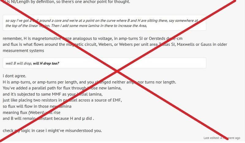

I assume when I was putting on to the 400 turn coil and load the 50V rms at 50Hz, that I was at μmax because that's when we got maximum impedacnce (theirfore max inductance). I'm with you this far.

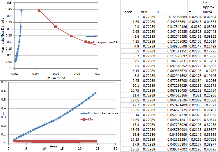

Yes B would drop. Flux would remain constant.
Or
I agree , keeping excitation at 50 V rms, volts per turn would drop.
That means flux would drop. So would B since area wasn't changed.
Yes.
That can only be answered by applying numbers to real data. Is your graph above from actual measurements,
and is it to scale or conceptual ?

OK so the green line DOES move DOWN when you increase control current. And the Red line moves UP the higher the AC voltage.
yep.
tim9000 said:
So looking at the right side of the two cores as the AC excitation draws a load current that will produce a demagnetising MMF in the cores. But at the same time, if you think of the dot-convention, the AC excitation produces a pair of dots on the bottom of the cores which pushes a current that increases the control current (the positive feedback) by like transformer action?
Dont understand sentence starting with "but". Which picture are you referring to ?

"So L = N2 μrelative μ0 Area / Length of path might
increase OVERALL, but haven't we moved from μMAX down to the left, to a lower point on the BH curve, closer to H = 0?"
Yes.
"so L is up but μ and B are down, the A and N terms of the equation outweigh the drop in μ?"
Conceptually and practically they should be the same should they not, that's the point of design?
Well let's look at some data:
Those curves are wL = 2*pi*f*50/0.6 *400^2 * (B/H)
so everything is constant except permeability (B/H). I got max impedance to be 1260 Ohm at 50Vrms at 50Hz, (and you saw the BH curve in post #233) implying that we get maximum impedance when B = 0.72988689 T
I imagine that if current is controlled to be the same that THEN you could just wrap heaps of turns around the core and get heaps of flux. But if it's V.s that is to be the same, then it doesn't seem like I can do that.
Say I wanted to design an inductor to be as big as possible at a certain voltage and frequency, to get to the biggest it's like I want to design to stay on μMAX to make the most out of my steel, we were able to do that before by using the cross sectional area of A = 0.000555 m^2 but say I want even more inductance.
To get more inductance I'd need more turns, but if I do that the flux will drop, so to maintain μMAX I'd need to drop the area, but I don't want to do that, infact I want to increase the area.
This is my point, is there some fundamental limit on how big an inductor can be for a given V.s at μMAX? {I think I recall you saying that the inductance curve always matched the permeability curve, however that only seems to be true for a constant current, not a constant V.s}
Is it like that inductor we were talking about for 1260Ohm that is as efficient as you can get for 50Vrms@50Hz, any bigger than that you're doing so with a smaller flux density? So like μ gets down after an increase of heaps and heaps of turns to stay at μinitial (where μ is at H = 0) and you can only increase the inductance with μ = μinitial?
Fair Anne's?
I'm referring to Mr Steiner's picture in post #234 for example, re: load current causes demagnetisation MMF on right side and also the positive feedback to control current, by like transformer action, on left side?Also, what did you think of this:
