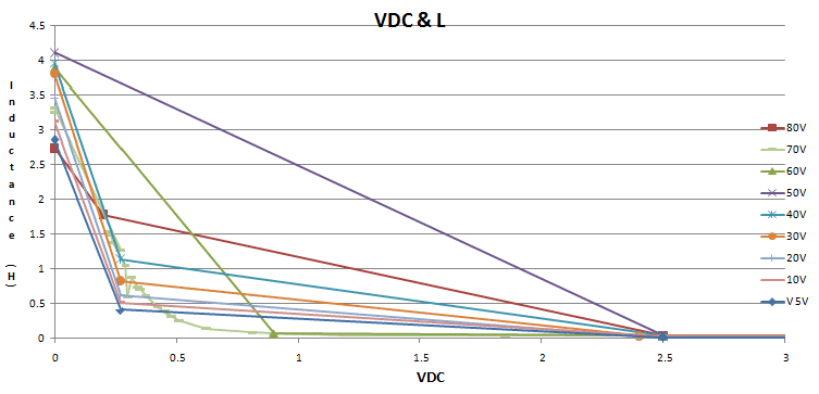

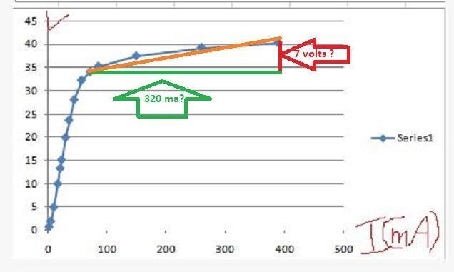

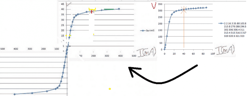

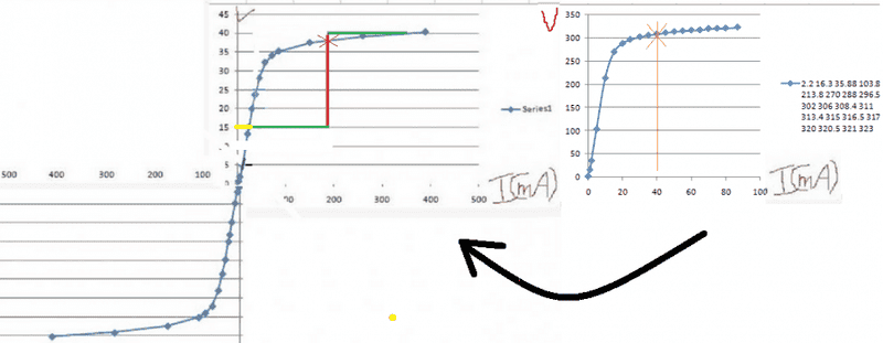

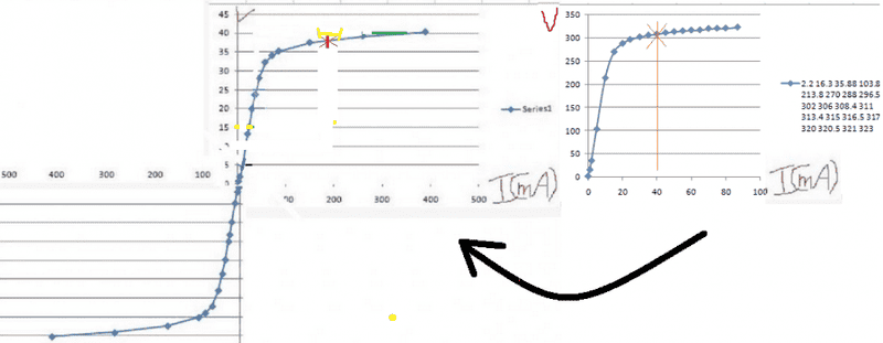

tim9000 said:

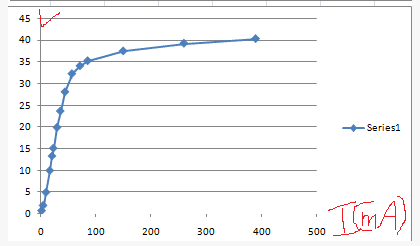

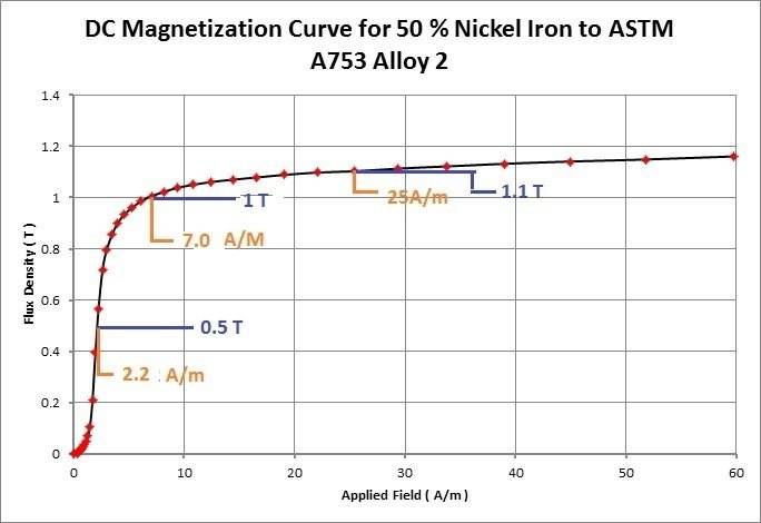

So the maximum point of inductance would be something like at the top of the linear part, something like L = 0.8/3?
Ok, that's why we operate inductors below the knee, but can you remind me why we operate transformers just below the knee and not lower down, why is this getting the best 'value for money out of our steel'?

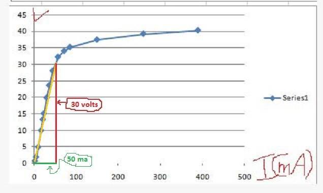

well 0,5 T looks like ~2.2 amps, 0.23 h
maximum inductance is down in the linear region where curve is steepest, remember it's flux per amp-turn...
So a transformer(or motor) with way more steel than it needs will operate cooler and draw less magnetizing current.
From a buyer's perspective that's what i'd want
but in the shoes of somebody who has to beat his competition's price, i couldn't afford to buy and ship that extra steel and the extra copper required to encircle that larger than necessary core. Unless i was selling to audiophiles...
Ah, yeah, so it's about material minimisation.
YES! The point where the linear part is steepest is point of maximum inductance! That's what I theorized a few weeks ago!

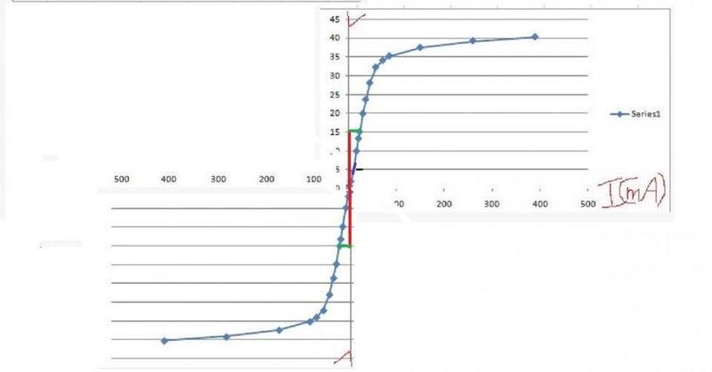

Ok, so you need a high-speed graph to record a DC flux sweep (current over time) of the core.
What about that graph of yours:
i'm between oscilloscopes right now
drew this in paint
of course that assumes ideal wire with no resistance so all the applied voltage causes induction dΦ/dt
and current becomes whatever is necessary to push that flux around the core.
We okay so far ?

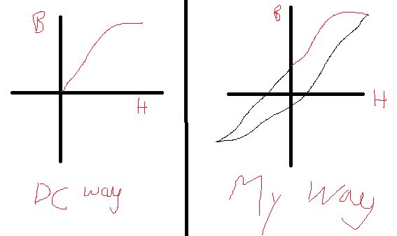

I think so (on both counts), so there would be no practical use using a magnetic core lower down the curve than the steepest point of the linear section, because it would have a low B and a lower inductance? You could say that an operating point at the steepest point of the linear section would be ideal.You did say it was ok to say that H = NumOfTurns* open circuit current, for the method I was doing my BH graph didn't you?

I think we're okay there, except ideal meaning best behaved transformer to you - bean counters will see ideal as one pushed nearer the knee.
Remember our model pages back ::: An "ideal" transformer has a BH curve that's infinitely step - zero magnetizing current.

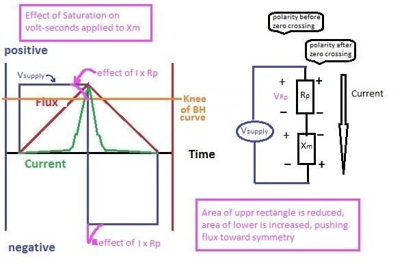

Ah I'm having a brain failure: So when the core is saturating the magnetising current is going up because it needs more current to...get the same change in flux? What wording would you use to say why the magnetising current goes up? Also when it's saturating, I suppose the amount of current going into the ideal core has dropped because the voltage on the ideal core has dropped because of the voltage drop on the primary coil impedance has increased?
I've been looking forward to our foray into AC because I have an interesting comparison question to ask about inductance soon.
dosn't this picture answer that ?
how about
As the saturating core becomes increasingly unwilling to accept flux, more current is necessary to push flux through it. ?

Yes, XM's increased current IM increases the drop across RP as you said earlier. So EPdrops.
I'm still thinking freeze - frame, instantaneous, like DC ... that's valid because at any instant AC has only one direction.
If you apply DC to a transformer it will soon saturate .

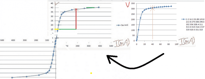

transformer datasheets often give the number of volt-seconds that will drive the core to saturation. It eases some calculations.
That's going to be useful to remember, what did you mean by "if it's a core you're looking at that's volt-seconds per turn'?

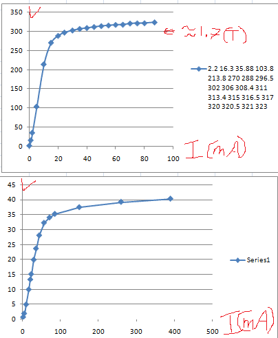

I take it that the diagram represents excitation voltage. This is what one of the things I was going to get at before: So the area of the integral is zero, so the flux goes to zero, I get that mathematically, but in reality, say I could see the current flowing AC into the coils of the transformer, and see the arrows of the flux moving and getting stronger over the half of the cycle, surely the flux would change direction in the core? Otherwise it just goes in the direction of which way the initial AC magnitude was going?

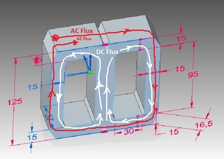

P.S, These are the curves I plotted the other week, they are from the same E core, the one at the top is the centre leg, which was twice as thick as the outter legs, the bottom is one of the side legs. I think the steel might have been M4 grain oriented silicon steel, I measured it as 0.27mm thick. From my brief looking on the net I think the max relative permiability or affective relative permiability or whatever is 14, but I'm not sure, what do you reckon(?):
Thanks!

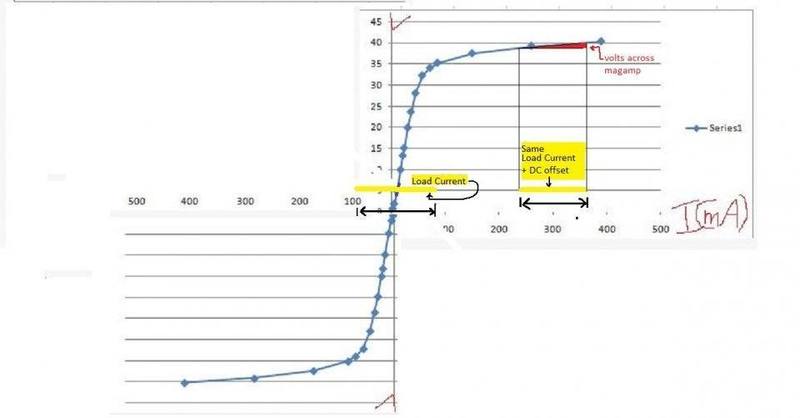

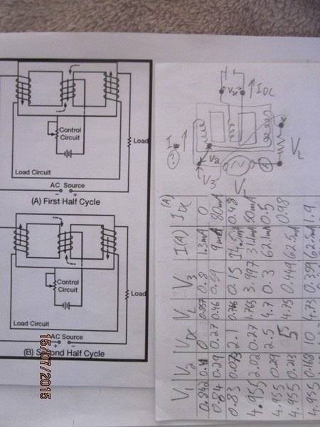

Thanks!
Are vertical scales really 10X different ? What are they -- volts ? millivolts per turn? Was this at line frequency ?
judging by shape of your curves It takes maybe 20 ma to saturate when driving center leg
more like 80 to saturate when driving an outside leg ?
When driving the Outside leg, it will saturate first because flux goes from it into the 3x greater area of the other two legs
so you have a core that's part saturated and mostly not saturated.
A picture or sketch of your setup would be informative.
How did you calculate effective permeability?
There's some error introduced by using AC meters to measure non-sinewave current after the knee. An oscilloscope would be really handy.
  • #92
Now let us add saturation to this picture
voila, look what happens to current
observe current goes sky high when we exceed the volt-second capability of the transformer(inductor)
and observe it's late in the cycle , just before a zero crossing
in real transformers that happens when you close the switch at or real near the sinewave's zero crossing, maybe one time out of ten.
Here's a real 'scope photo from that PF thrfead i mentioned
https://www.physicsforums.com/threa...ansformer-inrush-current.811131/#post-5094110
note his 40 amp initial peak is about 160X steady state.
Note his 10 amp second peak is 40X steady state.
Remember i said a real transformer will settle itself to symmetry, but not in the first cycle as evidenced by this trace.
note also asymmetry - no spike on negative peaks
it's asymmetric meaning flux has DC content...
flux and current both get a DC component when you close near zero crossing !
I think I calculated there were about 200 turns on the outside legs, and 840 turns on the inside leg.
The vertical scale is Volts, the horizontal scale is mA; sorry: the line frequency was 50Hz.
Yes that's what I thought, so H = 0.02*840 [A/m] on the knee of the centre leg?
I didn't, I just tried to look at some other curves on the internet to match it with mine...
I didn't use a digital current meter (analogue), just a digital voltmeter.
It shouldn't matter, this was an experiment to understand how Mag Amp deliberate saturation behaves. Ok here is a picture of my setup:
Other pictures we've discussed have shown the flux of a sineusoidal flux flattening off, but here it appears that the increase in current drawn due the decrease in change in flux (back emf) is exactly enough to accommodate the flux increase to maintain the relationship of it as the derivative of the flat voltage amplitude, is this because the situation above is ideal and in reality it would flatten off but due to the excitation flattening off because of the impedance drop on the primary coil, and whatever voltage excitation was left on the core, the increase in current would be exactly enough to accommodate the relationship of it being the integral? (gee this is complicated, no wonder I was confused) Hence your 'willing to draw whatever it needs to', it will draw exactly enough current to maintain the relationship, by chance, by the nature of the universe. And by another coincidence that will be by nature of circumstance the amount of voltage on the core will drop as it saturates.
I see the in-rush current in the CRO picture, but that's a sineusoidal supply isn't it? So why is the current only positive? Wouldn't it only be positive like that if it was a square-wave supply?
good we know volts, current and number of turns. Weshould be able to get flux, and with an stimate of area , B.
Gotta run now thanks for your interest ! back in the morning.
Work on that sinewave exciting voltage plot instead of my square wave. It's important to work that derivative . integral in your head, and to believe that math says we can get DC current from an AC voltage without a diode.
  • #97

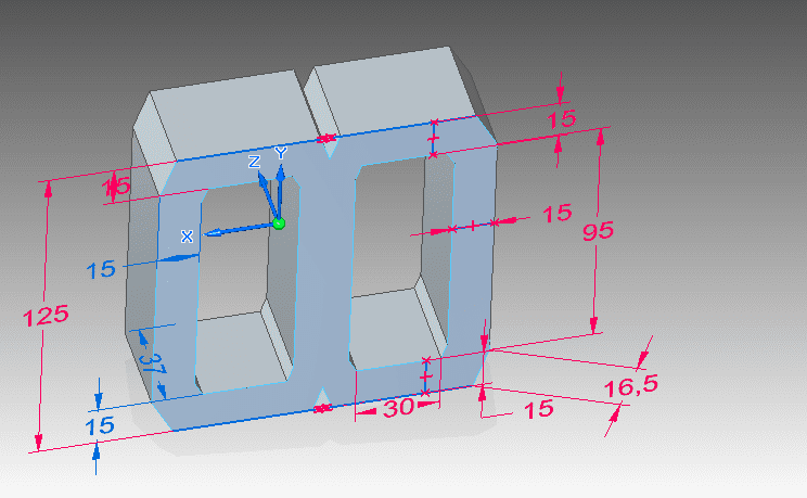

well, The dimensions of the core were roughly (mm):
jim hardy said:
Self saturating magamp ?
Not self saturating, I was putting/controlling some DC voltage on the centre leg to control the amount of current through two parallel light bulbs, the outer legs were in series that went to the bulbs (load). If you're curious, the outter coils were 0.835 Ohms each and the centre coil was 10.7 Ohm, the load was about 50.4 Ohms.

i think we worked this one out first post today
  • #103
so cross section of outsides is 15 X37 = 555 sq cm
and center leg twice that , ~ 1110 ?
and the fourth dot on top curve
looks like 213 volts at maybe 15 milliamps?
15 milliamps through 840 turns is 12.6 amp-turns
and 213 volts in 840 turns is 0.253 volts per turne = n dΦ/dt , 1 turn, so dΦ/dt = 0.253 webers/sec
assuming sinusoid, dsin(wt) = wcos(wt) and at 50 hz w is 100pi
so
.253 = 100pi X Φ
Φ = .253/100pi = 8.05E-4 webers
in an area of 555 1110 cm^2 , = 555 1100E-4 m^2
8.05E-4 Weber/1100E-4m^2 = .007 Tesla ?
sounds too low
Hmmm where did i go wrong ?
edit-- !
Ahhh got it - you gave millimeters and i ciphered for centimeters
make that 0.7 Tesla,
that's more like it !
  • #104
bottom curve 35 volts in 200 turns on 555mm^2 ?
.17 volts per turn ?
what do you get for flux?
.17/100pi = 5.4E-4 weber/555E-6m^2 = .97 TDontcha just LOve it when math works out !
  • #105
You're lucky to have a core like that with windows big enough to pass wires through.
Maybe a ten turn search coil on each one would be handy - makes enough volts to see on a meter and it's easy to figure volts per turn.

This i think you'll enjoy -
Try exciting the center leg to about 1/2T
measure volts in both outside legs
Next place a single shorted turn around one outside leg, You'll be surprised how small is the spark it makes.
Then measure voltage in both outside legs again.
You'll see the shorted turn has pushed flux from one outside leg over to the other.
MMF at work !
