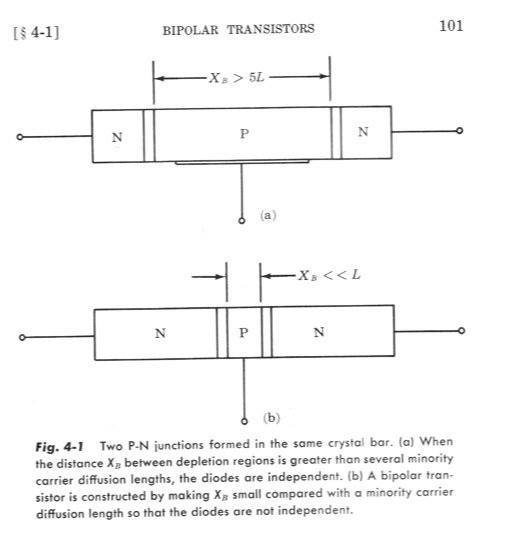

A bjt w/ a thick base is merely 2 back to back diodes w/ no transistor action. Ebers-Moll equations include alpha to account for bjt action. With alpha near or at zero, Ic is near zero. Vbe can be 0.85 volts, but Ic is about 0. Without high alpha, Vbe matters not.

The thin base region resulting in carriers yanked into collector before recombination can occur is simple, less involved, & requires no advanced math. Your website article chastises the whole science community for not explaining bjt action well enough. As I said, I've had hundreds of colleagues enjoy great success as an EE in hardware development, whos understanding of bjt is based on OEM app notes & uni teachings.

There is no base lead terminal, but there is a base region internally. Emitter region emits electrons which are yanked into the collector via the E field of the reverse biased c-b jcn. Have I answered your question.
Your last question is a good one. "Control by emitter injection" is how I describe the bjt in general. Emitter electrons injected towards the base quickly become collector current. Base holes injected into the emitter recombine there w/ electrons in the emitter. But base injection does not directly produce collector current.
The reason the base is doped w/ acceptor ions (for a p type base, i.e. npn bjt device), is to improve c-b reverse breakdown voltage & leakage current. A heavy doping of acceptor atoms into the p base results in more base current for a given collector curret, an undesirable thing. But doing so reduces Ico, a bad thing, & improves c-b junction blocking voltage ability.
What function does the injection component of base current serve is as follows. THe lower the doping density in the base, the lower the base injection current & the higher the beta value. Superbeta bjt's at op amp inputs use these devices. But the c-b blocking voltage ability is a few volts, & the leakage current from c-b is horrendous.
For bjt devices that are to operate w/ a Vce of 50, 100, or more volts, w/ low leakage current c-b, i.e. Ico, the base must be doped heavier than is optimum for high beta. Thus current gain is sacrificed for low Ico & high c-b blocking voltage.
It's all about tradeoffs. Ic is produced by Ie. Ib is needed, but we wish to minimize it. If we minimize Ib too much, Ico goes through the roof, & Vce,blocking plummets. So base doping is optimized according to how high Vce must block, & how low Ico needs to be. Higher voltage devices have lower beta. Can't get around that. Did I help?

The best method I used to teach this concept to non-electrical majors (civil, machanical, chemical) when I taught at uni, was as follows. Make the base region so wide, say 1.0 mm, that every e- (electron) emitted recombines in the base region with an h+ (hole). Here we have 2 back to back diodes & nothing more. There is no transistor action whatsoever.
But there is a potential barrier, a depletion zone, & an exponential I-V curve.
Ie = Ies*exp((Vbe/Vt) - 1).
Ic = alpha*Ie = 0, since alpha is zero for such an arrangement.
We have no transistor action at all, nothing but a fwd biased b-e jcn diode, & a rev biased c-b jcn diode. The logarithmic/exponential relation holds steadfast because it is a diode relation. We still have no bjt functionality.
Reducing the base region width results in an increase in collector current Ic since alpha is now increasing. When the base region is very thin, on the order of 1.0 micron, Ic is almost the value of Ie.
In the 1st case we had near zero Ic, the 2nd case shows Ic almost equal to Ie. What changed? NOT the potential barrier relation, not the I-V "Ohm's Law" relation, not the Shockley diode eqn. What changed is alpha. When alpha is near zero, we have a pair of back to back diodes per the exponential eqn above.
Ie is exponentially related to Vbe, Ic = 0. In the 2nd case, alpha approaches 1 & Ic = alpha*Ie = alpha*Ies*exp( ).

Cabraham's approach in stressing the width of the interdepletion region is excellent and fundamental - or at least it was when I learned about transistors back in the 1960s. (post#68)
Pierce devotes several pages to calculations of the effect of base width on carrier density, potential diagrams etc and has an excellent diagram on page 101, which I have appended.
For expansion of these formulae (posts #68 & 69) I also recommend the monograph by E H Cooke-Yarborough of the Atomic energy Research Establishment at Harwell
An introduction to transistor circuits (1957)
go well
