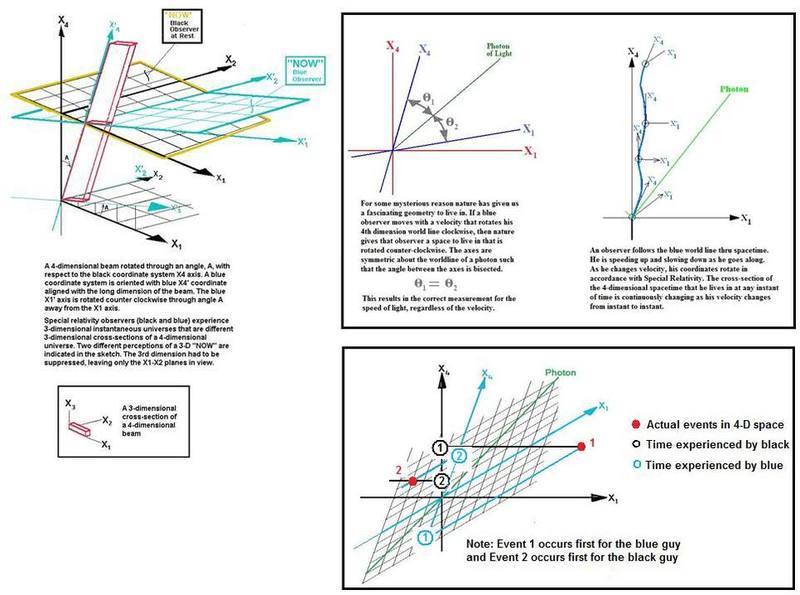

aawahab76, here is a sketch of the so-called Penrose Andromeda Paradox. The sketch illustrates just what JesseM has been explaining to us. Two people walk past each other very slowly (your example of relative velocities so small that you might think you could approximate the situation with the Galilean concept without any problems). Way out in the Andromeda galaxy, in one person's "NOW" the aliens are having a meeting to decide whether to attack earth. But, in the other person's "NOW" the decision has already been made and the alien fleet is already on its way for the attack.
Credit: "The Emperor's New Mind" by Roger Penrose (OXFORD) - page 260 paper back edition.

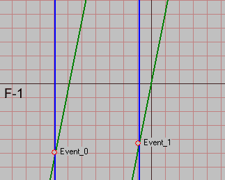

The diagrams show the worldlines of the ends of a green and blue ruler of equal length that pass each other on the x-axis. Event 0 is the coincidence of one end of the rulers, event 1 is the coincidence of the other (leading) ends. In the blue frame event 0 happens before event 1, while in the green frame it is the other way round. The diagrams are accurately scaled, the relative velocity is 0.197c and the rest length of the rulers 6 light years.
If the clocks were synchronised at event 0 so t = t'= 0, the the time of event 2 on the green clock is negative.
It seems clear that if we increase the length of the rulers the time difference between the two clock readings of event 1 will grow.
There's nothing weird happening, it is consistent.
