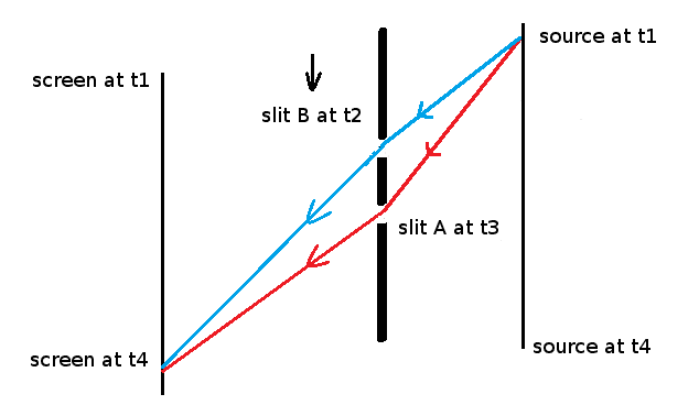

I posted this thought experiment in a previous thread before 4 months or so, but I would like to reiterate it now:
A frame of reference (FOR) has double slits moves relative to a ground FOR. Let`s make an arrangement so that when the 2 ends of FORs coincide, 2 small slits of moving FOR are opened at the same time relative to the ground observer for a brief moment to allow just 2 photons to enter from an electromagnetic source put on the opposite side of him. Let `s make the distance between the 2 slit small enough comparable to the wave-length of the photons to cause an interference pattern.
For the ground observer, he sees 2 slits open at the same time and therefore the 2 photons entering the 2 slits and create an interference pattern on a screen on his frame.
But according to SR interpretation, the moving FOR`s observer sees the front slit opens for a brief moment and then shuts before the rear one opens,,, so at one time, only one slit opens and therefore no interference pattern could ever occur. But when he looks at the screen from his window, he will see an interference pattern on the ground screen.
Can the train observer now explain why this interference pattern occurs when just the slits open one at a time?

The idea behind my experiment lies not just on the expected classical explanation based on the light transmission but instead on the expected puzzle enforced by Quantum Mechanics Interpretation. If the interference pattern forms because of the invariance of wave-phase or the coincidence of 2 worlds line representing the photons and the screen as in Mentz work, the issue might be easier, yet not solved still
The challenge is what QM predicts that no pattern could ever be formed if one knows which slit the photon passes through. This can be inferred from the famous Wheeler`s Delayed Choice Experiment or Delayed Choice Quantum Eraser Experiment which both of them have been confirmed. Seeing the slit-A opens and closed before slit-B opens relative to the slit-observer is the exact way to know which slit allows the light photon to go through and consequently will destroy the pattern. There is no counterpart in the classical physics, therefore attempt to explain the pattern based on light transmission is either incomplete or wrong
Furthermore, the QM allows the experiment to be done on electrons for example and still has the same result regardless the need to use photons because of its possible exploitation in synchronization of the time the slit open

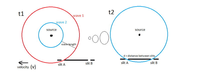

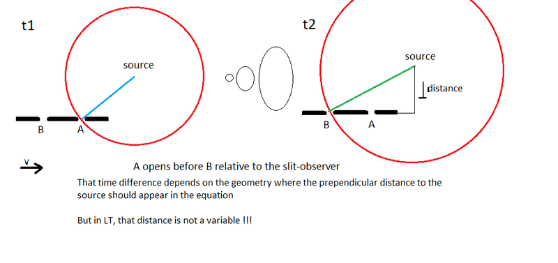

I don't think that this is correct. Can you derive the wavefunction and show this?

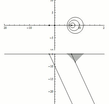

The diagrams are coventional ST plots with time on the vertical axis ( you've used my program so you'll know how I made them )

  • #46
Mentz114 said:
For a light beam traveling from one observer to another, the number of wavelengths on the path is invariant. The diagrams show this happening from the perspective of both frames. It would be the same under an arbitrary LT.
Yes. I think I see what you are doing.
Are you showing 7 explicit events on the null-path interval, and how those events do not disappear when you do a Lorentz Transformation?
Are those events are tied to nodes and peaks of the wave-form of a single photon?
Or are those nodes and peaks marking the locations of 7 individual photons along the same null-interval?

No photons, please. We're doing classical wave optics. Yes, those events are equally spaced along the null direction representing complete wavelengths.
[edit] removed a non-sequitur. Phase must be invariant because it is a scalar.

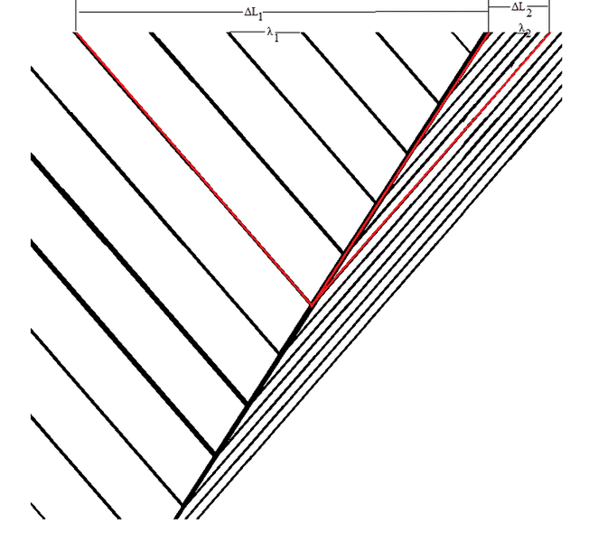

  • #50
I think I've found a clearer way to make my point
The number of wavelengths between the source event and destination event are not associated with the events marked in red in the diagram.
The number of events marked in red would be invariant, but the number of wavelengths between emission event and absorption event are observer dependent; they're not really events.

I think I understand what you meant now. The phases (peaks, troughs, etc.) of the wave each have their own worldlines, and where those phases intersect with each other, are events, which happen in all reference frames.
I see now the OP's question is basically answered, but I was still confused about what quantities are actually invariant, and trying to figure out what you meant by "scalars" being always invariant. I can see that an event that happens in one reference frame must happen in every reference frame, so an event that represents, for instance, the superposition of phases of a wave, and a wall must happen in every reference frame.
But I didn't understand for sure what is meant by "scalar," though I've seen it used like that in other places, too, i.e. "all scalar's are invariant." Now I see though. They did change the definition:
On Wikipedia http://en.wikipedia.org/wiki/Scalar_(physics )
It says: In physics, a scalar is a simple physical quantity that is not changed by coordinate system rotations or translations (in Newtonian mechanics), or by Lorentz transformations or space-time translations (in relativity).
So the number of wavelengths is not a scalar, the period is not a scalar, the distance is not a scalar, the time is not a scalar; I was trying to figure out what was a scalar?
The existence of the phase is Lorentz Invariant, but what numerical quantity about the phase is invariant? And now that I ask the question, I smack myself in the head, and say, AH, of course, the phase, itself, is a numerical quantity, somewhere between zero and 2*Pi.
So the phase of the wave-fronts meeting the surface are invariant. I agree with you, you are totally right.

Thanks, Mentz.
Thank you for providing the mathematical proof, though. It is helpful in understanding your meaning.
I would have expected the length and wavelength to be given as shown in this diagram...
I see you have defined, at least, the ΔL parameter in an interesting way I wouldn't have expected. You actually use ΔL^2 = Δx^2 + Δt^2.
I would have used just ΔL = Δx.
Edit: Whoops. You defined ΔL= k (Δx^2 + Δt^2.), as it is a 45-45-90 triangle, so k is calculable constant. My bad. I have it printed out, now; it's easier to read.
  • #55
I am making myself late for work, maybe, but in equation 4 of your pdf, you have +/- signs. I'll verify myself when I have time, but are you sure you aren't turning them around?
Because you can see in the animation:
The wavelegth goes down as the ΔL goes up, even if we use YOUR definition for ΔL. So the quantity ΔL/λ can't be constant.
That is, unless you've also defined λ in a way I'm not familiar with.
