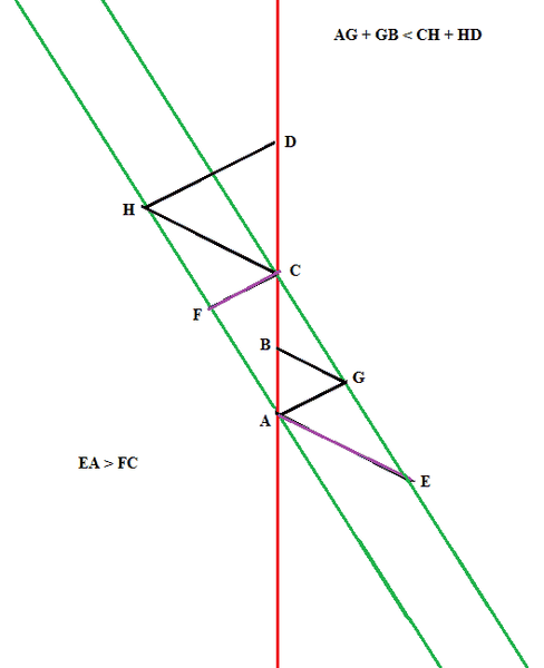

The matter will be much easier if there is no relativity, as from the diagram, the light sphere reaches A and B at the same time both for the ground and the slit observer,,, The phase will be equal too
thttps://www.physicsforums.com/attachment.php?attachmentid=43214&stc=1&d=1327756868oo

consider the last diagram post in 88, and the attached diagram ( the left hand diagram is for slit A and the right hand is for B)
The source is also moving relative to the slit-FOR with -vt`
(cta`)^2 = s^2 + (ab`/2 - vt`)^2
(ctb`)^2 = s^2 + (ab`/2 + vt`)^2
where ta`and tb` are the time received by A and B relative to slit observer
after some transformation the quadratic equation yields the value of ta` and tb` as follow:
ta`= -ab` v +/- √[(ab`v )^2 + 4 (c^2-v^2)( s^2 + (ab`/2)^2] / 2(c^2-v^2)
tb`= +ab` v +/- √[(ab`v )^2 + 4 (c^2-v^2)( s^2 + (ab`/2)^2] / 2(c^2-v^2)
So clearly the s will disappear from the difference as you said,,,
But still the time difference Δt` = ab`v/(c^2-v^2) = ab`v/c^2 / 1-v^2/c^2
But for LT , Δt`= abv/c^2 / √(1 - v^2/c^2)
sorry for the bad shape,,, again you are right that s will disappear but still there is a difference

  • #125
I got it :
Still ab` should be transformed also according to LT and the final time difference will be the same Δt`= abv/c^2 / √(1 - v^2/c^2)
Final i suppose :)
  • #126
in conclusion:
1) The time difference between 2 slits is the same as measured by LT where no s appears
2) The phase is the same at A & B
Oh at last it becomes clear,,, thanks DaleSpam for inspiration
