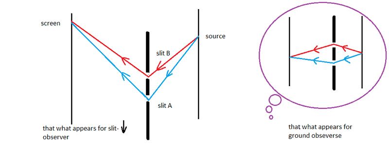

Adel Makram said:
https://www.physicsforums.com/attachment.php?attachmentid=43147&stc=1&d=1327565161
It is a bit different from the original experiment, but still need to work it out.
The source emits 2 beams of light at the same time. For the ground observer, her sees the slit A and B open simultaneously, so the pattern will form on his screen at the defined point to the left side. For the slit observer, the slit B opens before slit A initially to receive the beam from its right hand labeled in red. While, ultimately, the slit A should open first to release it to go to screen.
So which slit should open first?
Your image is wrong. See attachment for corrected version. You are forgetting that source and screen are in motion.
you are right, i was about to change it any way,,, but there is still another challenge:
The accumulated phase between the source and the screen is the same for both ground and slit-observer, yet the phase at the slits is different. For the ground observer, the phase at A and B must be the same, while it is not the case as recorded by the slit-observer!
So if the phase is a scalar quantity, its value should be invariant at the time the light leaves the slit?

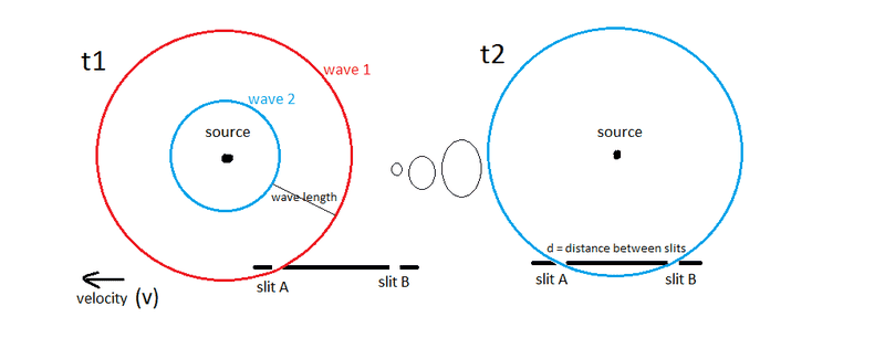

https://www.physicsforums.com/attachment.php?attachmentid=43153&stc=1&d=1327589224
The phase will be the same at 2 slits ( A & B) only and only if:
λ/c = d/v
where λ is the wavelength of the light, d is the distance between 2 slits relative to the ground observer and v is the velocity of the slits
But this is a special case only which ensures the phase of 2 light beams will be equal at the time they hit the 2 slits, while for a ground observer, the phase will always be equal

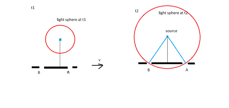

MikeLizzi said:
That doesn’t read like what I was showing. I my reference, the slits would have to be opened at the same time (according to the FOR of the slit observer). That’s because I chose a wave front that was created when the source was directly opposite the slits and equidistant from both (according to the FOR of the slit observer). Of course the geometry is different in the FOR of the source.
Also the Lorentz transformation does not apply to light. In my reference the geometry/speed/time of source and slit are transformed using the Lorentz transformation, but not the geometry/speed of the light wave.
And, in general, I avoided writing about interference patterns because I don’t believe an observer would see anything on the other side of the slits. The material from which the slit is made is not reflective. The instrument would not work if it were. The material is supposed to be completely absorbent, no? So only photons with a clear line-of-sight path through the slit will make it out the other side. Trying to get an interference pattern from your setup where the source is moving with respect to the slits would seem to be impossible.
https://www.physicsforums.com/attachment.php?attachmentid=43180&stc=1&d=1327671188
Here is the setup of my experiment

  • #84
DaleSpam said:
I haven't checked Mike's math, but again, so what? Differences in time are not frame invariant, so the fact that they are different in two frames is not surprising.
If the accumulative phase given the whole paths and the absolute value of the phase at A & B are invariant, then the different time of opening of slits would depend also on the geometry of the setup including the perpendicular distance to the source which is not a variable in a LT
  • #85

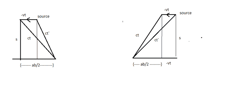

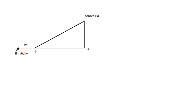

for sake of simplicity, consider the attached diagram
the time to A = 1/c (sA)
the time to B = 1/c (√(sA^2 + (AB – vt)^2))
where AB is the distance between the 2 slits
In LT, Δt= AB * v/c^2 (√(1-v^2/c^2))
That would be correct if slit A were at rest and slit B were moving, but I thought that you intended for the slits to be moving in the same direction at the same speed. If the location of the source is the origin, and the location of slit A is (vt, s) and the location of slit B is (ab + vt, s) then the flash from the source at t=0 reaches A at
[itex]0=c^2 t_A^2 - (vt_A)^2-s^2[/itex]
and it reaches B at
[itex]0=c^2 t_B^2 - (ab+vt_B)^2-s^2[/itex]
  • #94

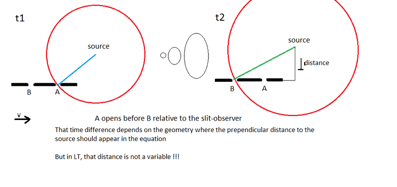

MikeLizzi said:
Update to my previous comment about your recent diagram. You have a “v” with an arrow that seems to indicate that the Double Slit is moving. So the two diagrams appear to me to be a sequence showing a single light wave at different times from the FOR of the light source. And yes, the single light wave will intersect the two slits at two different times in the FOR of the light source. I don’t have to know physics to recognize that.
But, as DaleSpam said, the differences in times are not frame invariant. You are not entitled to declare that the intersections take place at two different times in the FOR of the Double Slit. You have to calculate that. And what if it turns out that they do? Again, as DaleSpam said, “so what”? You conclude that this fact contradicts an equation. I don’t know what equation that is, but I doubt it was derived for the condition where the light source was moving perpendicular to the orientation of the double slit.
the derivation of the difference between the time when the light front hits the 2 slits depends on the geometry of the setup shown. But as the ground observer watches the slits open simultaneously, the LT tells that there should be difference in the time of slits opening relative to the moving one by an amount related only to the distance between the 2 slits and the velocity of the slit not the geometry of the setup.
no, both of them moving,,, actually you should imagine the diagram as a projection of 2 diagrams in 2 different time where the source is fixed in location
  • #96
Understood, so your math is incorrect. See the corrected math I just posted above in post 93.
it is the same like mine but with different orientations,,, any way (s) appears in your equation as well while it should be s-free by LT
  • #98
Why? The LT certainly does not imply that light travels instantaneously in the y direction.

  • #104
DaleSpam said:
What 2 calculations? So far there is only one.
:)),,, ok let's see it from side of the ground observer this time,,, he watches 2 slits open simultaneously, but the slit-rider records 2 different times,,, this is the first calculation
From the source side now: when the light front reaches the 2 slits in different time ( given the same phase),,, the slit calculate that difference considering (s),,, this is the second calculation
  • #105
Show your math, please. Just because the Lorentz transform doesn't involve s doesn't mean that it doesn't show up in the equations. That is why it is important to actually work things out and not simply make assumptions.
