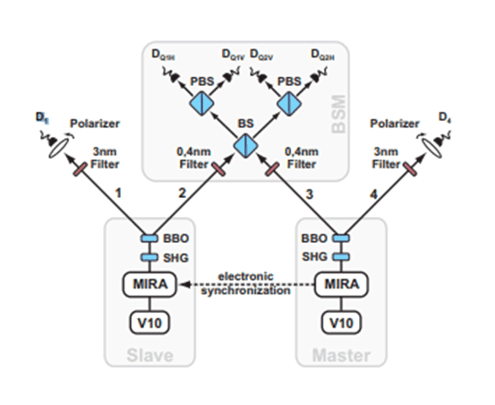

I think a reasonable experimental reference is:
High-fidelity entanglement swapping with fully independent sources
https://arxiv.org/abs/0809.3991
Rainer Kaltenbaek, Robert Prevedel, Markus Aspelmeyer, Anton Zeilinger
"Entanglement swapping allows to establish entanglement between independent particles that never interacted nor share any common past. ..."
I'd like someone to explain how this specifically works under MWI without invoking any kind of nonlocal action or global variables. And if the answer is to deny the published paper, well, that doesn't really explain anything in my book.
I'm perfectly good with starting out photons 1/2/3/4 having some kind of spreading wave function. I am also good with the idea that a polarization measurement of photon 1 (say) splits things into 2 versions (worlds, universes, histories, wavefunctions, wave states or whatever we want to call it). In one world, the Photon 1 polarization is now H> and in the other world it is V>. According to one source on MWI: "The wavefunction obeys the empirically derived standard linear deterministic wave equations at all times. The observer plays no special role in the theory and, consequently, there is no collapse of the wavefunction."
Presumably, if MWI is local (or localized or whatever you might call it): during their short life span, photons 1 & 4 never come close to each other. They are not synchronized (entangled) with each other initially. The swapping operation on photons 2 & 3 can occur distant to both 1 and 4. So how do 1 & 4 become entangled when they are far from each other (and far from 2&3 as well) ? In other words, at what point should we expect to see worlds in which the 1 & 4 photons are showing entangled outcomes? And at what point did their "deterministic wave equations" overlap or interact with each other in a manner that allows them to be synchronized?
Thanks,
-DrC
PS Keep in mind, I don't know how it really works in any interpretation, other than I believe there is a nonlocal component of some kind involved that explains one or more of the criteria I presented.
I'm not sure that would be possible as you state it here--the wave function would play a role similar to a "global variable", since it contains entangled degrees of freedom which can be widely separated in 3-dimensional space. (But, as has already been noted, that is true of any interpretation since they all use the same underlying math, which contains the wave function playing that same role.)
The first thing one would have to do to describe any experiment using the MWI would be to get rid of anything that says or implies that measurements have single results or that wave functions collapse. For example:

DrChinese said:
As to e), it is really difficult to get around the experiment I referenced as doing that.
No, it isn't. I just explained in post #29 how the MWI accounts for the correlations without any "influence" having to travel between the photons during the measurements: the correlations are enforced by the wave function. Of course, as I noted, that still doesn't make the MWI "local", since it's hard to see how the wave function can be "local" in 3-dimensional space. But it does provide a way to account for the correlations without "remote influence".
