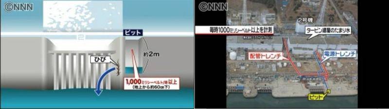

Trench dimensions:
3x4x76 meters.
Source: http://www3.nhk.or.jp/daily/english/28_h37.html
3x4x76 = 912 m3.
Lets say 70% is full of water = 638 m3 of water. That is a lot of water...
I would like to learn:
1. Did it fill up from the Tsunami wave? Plausible.
2. When did last time inspect it - i.e. has it been dry after the Tsunami hit?
3. The article above talks about "a poodle of water" - which is VERY different from other stories of "filled to the brim".
Bottomline:
1. We don't know how much water is in the trenches
2. It would be good to learn how water rthere is
3. And if the trenches has been reported dry since the tsunami
and
4: Has these trenches been regularly checked for water seeping out of the containment?
The questions you ask are very legitimate. I have a hard time imagining that those trenches don't have been to some extent filled with seawater during the tsunami above them...
On the volumes of water in the trenches, if i look at this picture of the Tepco press conference, I see m3 written in the last column at the right side of the board, and if i sum up the volumes indicated for reactor 1 to 3, i end up with 13 300 m3 (3100 + 6000 + 4200)...
(click)
http://www.netimago.com/image_183582.html
This would be much more than your calculations.
As said before, a shame these conferences are not translated or transcrypted to english?

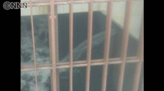

This NHK report (with an expert interview) was very clear that it was just centimeters from the brim and still rising.
http://www.youtube.com/watch?v=G3QJ8mxZOxA"
At least some of the water must come from the turbine building - for >1000 mSv/hr I'm tempted to say most of it. Tsunami water is generally not radioactive. If they did a radioisotope analysis (as done for the water in the turbine buildings) it would be very clear how much of the water is from the turbine building.

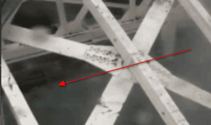

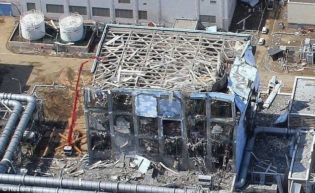

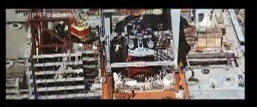

TCups said:
In part, from above reference:
"Dr. Sekimura of Tokyo university pointed out the possibility of damage to the fuel in the spent fuel pool of unit-3 since it would appear that the heavy crane have dropped into the fuel pool in this movie. (05:40, March 28)"
I wonder if this makes sense:
1) vertical shaft
2) SFP3
3) Fuel rod handling equipment in SFP3
4) Region of the transfer chute and gate
TCups,
Do you realize that is a view from the north - the opposite side from which you were previously suggesting the SFP was on.
  • #1,818
AtomicWombat said:
TCups,
CORRECTION
[STRIKE]It is a view from the north, looking into the south end of Unit 3, I believe. [/STRIKE] The SFP's are in the southeast corners of Units 3, 4. The original screenshot I annotated WAS NOT the SFP. It was a shot of the equipment pool on the north end of Bldg 3. The original post has been corrected. Sorry for the error.

TCups said:
It is a view from the north, looking into the south end of Unit 3, I believe. The SFP's are in the southeast corners of Units 3, 4.
I personally can't say with any confidence where the SFPs are in any reactor building, but I'm fairly confident the layered structure beneath the fallen gantry crane beam is the northern external wall of the primary containment. Indeed the smoke appears to rise through the broken roof frame work very close to the northern edge of what's left.
I don't know how to do thumbs so I won't attempt to repost your image.
