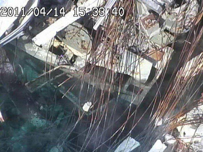

tsutsuji said:
A new batch of pictures (some of them taken on April 14, 2011) is available at http://cryptome.org/eyeball/daiichi-npp8/daiichi-photos8.htm
and these solve the mystery of the "ballistic" fuel handling machinery in unit 3, submerged in SPF3
[PLAIN]http://k.min.us/imMKhK.JPG
  • #3,804
Any idea what the half round concrete plate may be (top half of the pic, left of the middle)?

From the latest cryptome images, http://cryptome.org/eyeball/daiichi-...hi-photos8.htm
Is it just me, or does the semicircular item with a stepped edge look a bit like the half of the concrete plug that usually sits over over the reactor?
It is of course difficult with possible perspective and scale unknowns
Edit1... AntonL you beat me to it !
Edit 2 the actual plug appears to be approx 6.5m radius. Can anyone identify something to scale from in the photo?
[PLAIN]http://k.min.us/imMKhK.JPG[/QUOTE]
Sure looks like part of a big green machine in SPF. Maddening that there isn't a wider field of view. The round thing looks to be too small to be part of the primary containment plug, but it's hard to get an absolute scale from this perspective.
  • #3,810
The white roof panels - aren't they 70cm wide? Not sure anymore.
I have problems to correlate this pic with the other areal pics of R3.
  • #3,811
Funny, too that exposed rebar seems to be partially in and partially out of the pool. How does that happen?
Hey Anton! I've got it! The FHM broke in two pieces and one of them fell back into the SFP! Amazing! :rolleyes:

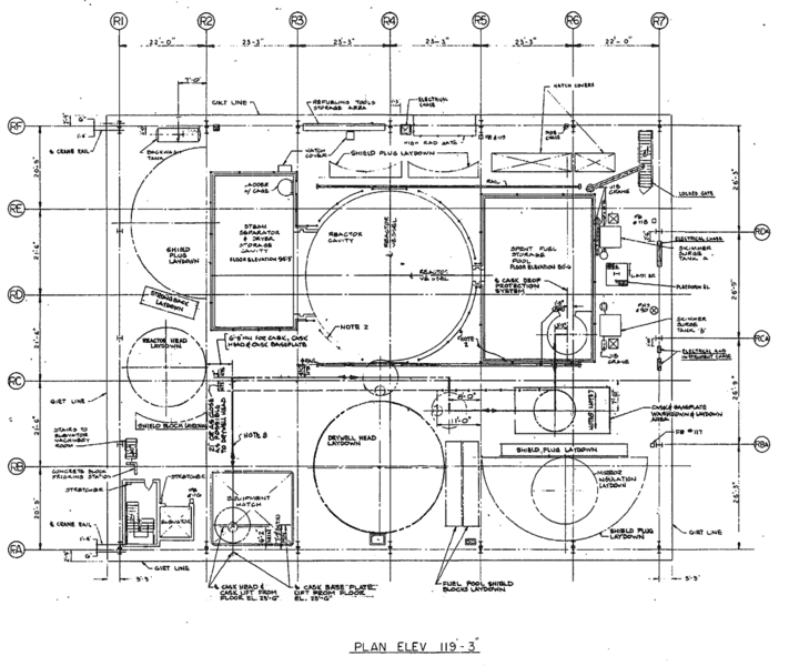

http://www.houseoffoust.com/fukushima/blueprint.html
Take your pick. The "chimney" is either the depth of the SFP or the "neck" of the reactor's primary containment, depending on whether one believes the vertical blast originated from the SFP or the primary containment, I suppose.
Surprisingly, in the drawing, they are about the same size, so it may not be that much different.

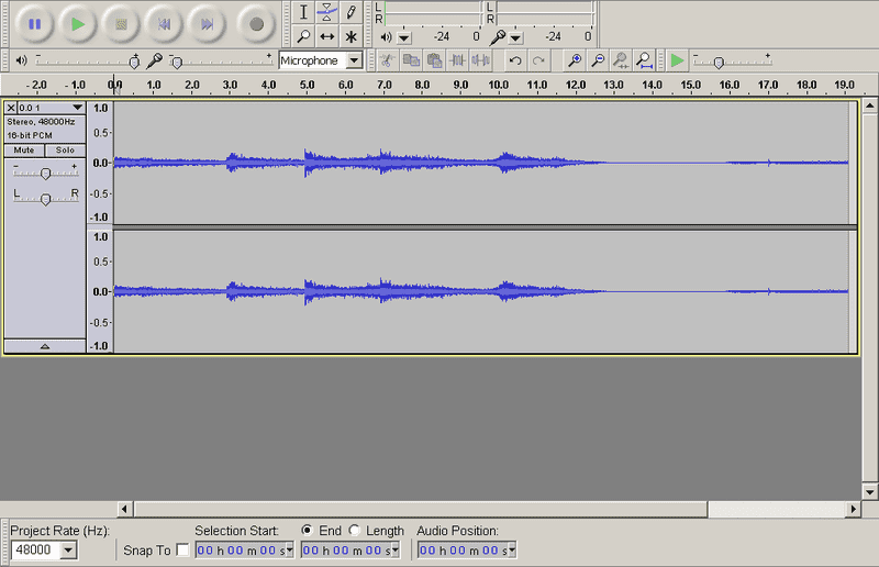

You could also look at the audio file to try and confirm the energies.
This is my best guess alignment of audio to video with the middle blast corresponding to the visible explosion. Best estimate of camera distance 2.25 KM.
Video Link :
Audio wave table :
Video Link :
Audio wave table :
Also audio file in ac3 format:
MB:
Confused -- what happened to the third "boom" in the original audiovideo file? Was it cropped from the beginning of the video? Was there really a third boom or was the original sound track altered by the news production crew? Do you think there were really only two blasts?
  • #3,818
TCups said:
MB:
Sorry you hear the third and second boom, but the first got cut with audio alignment. There was more to the video than was available in the clip I had available.
You can tell it was thrown back together because the audio potion is only 12.77 seconds and the video is approx. 13.25. There's also no way to be sure about distance, but if you like here's the alignment from first boom and visual, but it doesn't seem to match as well.
Bear in mind youtube remixes so audio may not match as nicely.
P.S. it makes more sense for the first explosion to be somewhere in containment, the second would be oxygen and hydrogen +, and the third from the SFP. This would also explain why a large object (FHM?) would appear to be on a delayed trajectory from first visible blast. The second blast column would shroud the third directional explosion inside.
So, if the "two boom" synched audio/video match you first posted is correct -- it does seem to match the video -- sharp fireball blast (from the primary containment?), secondary blast of the whole building just a bit lower pitch (accumulated hydrogen in Bldg 3 exploding), a continuous background rumble (of the rising vertical steam/smoke column?), and mechanical transients at the end (falling metal debris?), then what was the first boom, in your opinion? Was it real (some sort of internal explosion within the building not seen by the camera), or perhaps an artifact left from editing the sound track from the original TV news production (overlaying the audio of the first boom and following sounds again, matched to the visual of the first explosion, but sounding like a second boom then a third?) or something else?
  • #3,820
TCups said:
So, if the "two boom" synched audio/video match you first posted is correct -- it does seem to match the video -- sharp fireball blast (from the primary containment?), secondary blast of the whole building just a bit lower pitch (accumulated hydrogen in Bldg 3 exploding), a continuous background rumble (of the rising vertical steam/smoke column?), and mechanical transients at the end (falling metal debris?), then what was the first boom, in your opinion? Was it real (some sort of internal explosion within the building not seen by the camera), or perhaps an artifact left from editing the sound track from the original TV news production (overlaying the audio of the first boom and following sounds again matched to the visual of the first explosion, but sounding like a second boom?) or something else?
Sorry look at edit above. First explosion inside containment. Second hydrogen +, and third from SFP.
To address your other points. 1) there are five distinct sounds in the audio file. a) an event that is decaying at the start of the video (possibly steam escape). b) first explosion. c) second (highest peak energies) d) third (possibly from SFP). e) combined roar and or additional steam escaping. Each audio element is unique and I've found no evidence of clipping/ pasting or the like. Doesn't mean somebody isn't smarter than me though.
I also have a stretched and pitch adjusted version of the audio file where distinct echos from each blast follow between reports. All this would be very difficult to fake while rushing to get the scoop. Seems some of the file sizes are too large to upload here.

Regarding the 6th photo that shows all the rebar and what appears to be a plug laying just below the number 15 on the time readout.
I offer this cut and paste from another forum.
The writer has had a full Navy Nuclear Career and worked for a couple decades+ in the US Nuclear industry. From his posts I judge him to be intelligent, knowledgeable, conservative and more balanced than simple pro-industry.
My own knowledge is nada.
So take this with appropriate skepticism.
However, it would seem worthy to paste here at this time.
(It is called the) "shield plug, I agree. IMO the Drywell head and Reactor Pressure Vessel head are still bolted on. Unit 3 had Reactor Pressure and Drywell Pressure indicated after the explosion.
It looks to me like it could be part of a concrete shield plug. We call these the cookies. Smaller to larger diameter stacked concrete shield plugs are normally located on top of the Drywell Head, and stack up flush with the Refuel Floor.
I believe containment pressures, according to what I have heard (not seen printed) may have been as high as 120 psig. Most Mark 1s in the US have a 56 psig Design Pressure. It is conjectured that 2x design pressure results in stretched Drywell Head closure studs. Resulting in self - venting of the Containment inside the Reactor Building. Steam coming from the shield plugs should be observable and Reactor Bldg Area Radiation Monitors should alarm.
MELCOR analysis study of Peach Bottom was computer modeled in the 1990s - predicting that beyond design basis severe accident the Mark 1 fails at the Drywell Head Seal at 132 psi.
http://www.iaea.org/inis/collection/NCLCollectionStore/_Public/26/012/26012080.pdf
Page 9, MELCOR model calculated DW Pressure reached a max of 910 kpa = 132 psi. With variation centering very nearly on 120 psi.
Evidently dead nuts accurate. So our procedures throw in a substantial margin and require us to vent to maintain below 56 psig. Japanese didn't do this, or couldn't without power. This is in contrast to US plants which can vent under any condition. Air / Nitrogen operated containment vent valves can be operated with a SCBA bottle and an air regulator without ANY station power.
If containment venting doesn't occur, pressure builds. Once the flange and head get separated, the Drywell pressure will vent off through the clearance. (Self venting ) This would produce steam escaping with zirc water reaction generated Hydrogen.
Note all three Reactor Buildings appeared to explode on the Refuel Floor.
IMO - purely conjecture - some Hydrogen still trapped below the shield cookies, probably went off and lifted them up."

RE: BUILDING 4, CASK TRANSFER POOL & FUEL ROD ASSEMBLY LOCATION(S), AND CURRENT THERMAL IMAGES
A second diagram found here, source: PowerPoint Presentation - "Anatomy of a Tragedy: Fukushima Dai-lchi March 2011", downloaded from UCS website, here:
http://www.ucsusa.org/nuclear_power/nuclear_power_risk/safety/disaster-at-fukushima-anatomy.html
. . . this diagram:
http://i306.photobucket.com/albums/nn270/tcups/Picture3-1.png
and the previous schematic:
http://i306.photobucket.com/albums/nn270/tcups/Picture63.png
would both seem to confirm the location of a separate, gated "Cask Transfer Pool" (CTP) in addition to the larger Spent Fuel Pool (SFP) in the Mark 1 BWR design.
I don't think you can point to a couple of diagrams and conclude they represent "the Mark 1 BWR design". For instance, slide 7 in Lochbaum's powerpoint presentation shows the operating rector buildings 1, 2 and 3 have a diameter. The buildings in question are not round, however. On slide 24 there is a diagram that more closely resembles the ubiquitous GE color marketing drawing of a Mark I secondary containment. It does indeed show a cask storage area with gates, but I submit that that area is within the overall volume of the SFP. I have attached a picture that depicts the arrangement of the refueling floor at Oyster Creek for comparison. The NE corner of the SFP has just such a walled-off compartment for fuel casks. The Oyster Creek floor plan also shows the travel path for casks being transported in and out. Note that the equipment hatch is about 90 feet away from the cask storage area in the SFP, in the SE corner of the building.
If you want to call that a separate pool, fine, but the distinction at Oyster Creek is tenuous at best. I think you are relying too much on a few generic Mark I building drawings floating around the net. The Oyster Creek blueprint fragment is prima facie evidence that the layout of a reactor building can and does differ from the diagrams everyone is using to "prove" their points.
Video Link :
Audio wave table :
Good effort MB.
Castor plug?
Looks too small to me to be a reactor plug. If any, then one of the lower ones.
It is not known at all. You have posited electric-powered pneumatic seals for the reactor-cavity/SFP connecting passage, but I don't recall seeing any other documentation that confirms that. Even if there are designs that use such seals, that would not automatically mean that they were used at Fukushima Daiichi. In the other Oyster Creek drawings I have, there is no reference whatsoever to pneumatic seals of any kind.
Thanks, Mice & Men. A thoughtful critique is always helpful
I don't have much of an engineering background - a year of ME/Automotive, and I don't claim to be a structural engineer or nuclear engineer. But I don't think it implies anything on the scale of a bad hallucinogenic trip would be required to imagine a difference, perhaps like the first vs the second variations on a theme of the Mark I design. In fact, if one considers the likelihood that SFP storage space was at a premium at Fukushima, and what the photographic and video evidence since day 1 have shown, I don't think variation 2 is much of a stretch at all.
Maybe that presumes too much, but it seems at least to me to fit the visual evidence and might help explain some of the things I and others seem to be struggling to understand.
As for the seals, I didn't make it up out of thin air. I believe this was discussed in some detail back around post 600 or so. See reference:
http://allthingsnuclear.org/post/3964225685/possible-source-of-leaks-at-spent-fuel-pools-at
And as for a the couple of diagrams, I will claim responsibility for having given the impression that perhaps I had only looked at two diagrams. Instead, I have scoured almost every diagram, photograph, and reference posted here since day one, as well as all the other reasonable sources I could find in the process of coming up with several of my wild conjectures.
Does one of these look like what we have been seeing at Fukushima Unit 3 & 4 to anyone else? I think I commented on the apparent incongruity of the elevator shaft on one of the earlier diagrams. I believe the Fukushima photographs pretty clearly demonstrate the alternate position of the elevator shaft and access tunnels in version 2.
Oyster Creek:
http://i306.photobucket.com/albums/nn270/tcups/Picture1-6.png
Fukushima (?):
http://i306.photobucket.com/albums/nn270/tcups/Picture2-6.png
