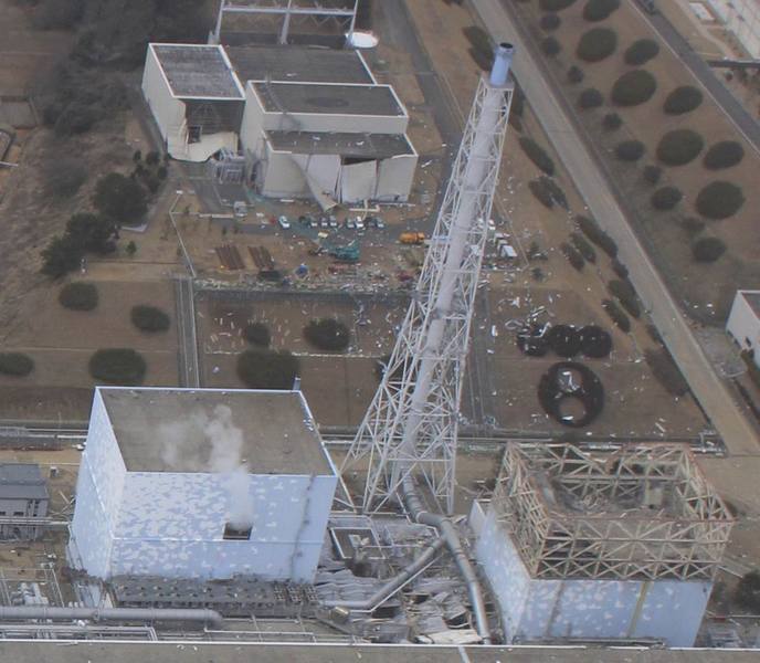

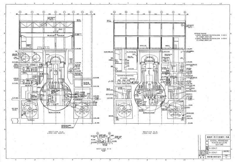

I couldn't find it either. Try starting with the building heights. From the #1 blueprint ground level is OP. 10000 and the roof is OP. 54750 giving about 45 metres.
I measured the height of building 2 in pixels (252) on the SW corner and did the same for the nearest stack (682) - using pythagoras theorem. I could not get a clear line of sight on building 1. So the stack is 2.70 times the building height. This is about 120 metres, assuming a 45 metre height, or 135 metres if you assume building 2 is 5 metres taller than 1 (they seem almost the same).
So start with a stack height of 120 metres. Now estimate the height that the heavy debris reaches in the explosion. This is hard because you can't see ground level, but to my eye it's at most 3 times the height of the stack or around 360 metres.
My two estimates are in rough agreement. I earlier estimated 245 to 280 m plus the building height, giving 290 - 325 metres.
http://www.youtube.com/watch?v=haUawwm7l4k"

hmm i got about 115 meters with similar calculations so that'd be it... now onto the cloud's velocity estimation, and cloud's temperature estimation (for it to rise this fast), and the thermal energy... going to take a while. And all that work to show something bloody obvious, that you need lot of thermal energy to make mushroom cloud, to provide scientific substitute for common sense of 'omfg mushroom cloud, really bad'. It would of been so much easier for military which probably got premade tables for this sort of calculation to estimate yield.
edit: going to take a while. I'd rather hope someone here can find how military would estimate energy given mushroom cloud width and rise speed, using experimental data. That'd give more confidence.

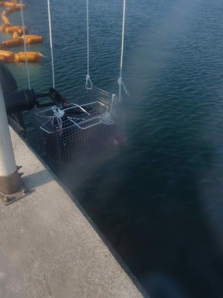

Zeolites have uses in advanced reprocessing methods, where their micro-porous ability to capture some ions while allowing others to pass freely allow many fission products to be efficiently removed from nuclear waste and permanently trapped. --Shooting location: the south side of the screen of Unit 3 of the
Fukushima Daiichi Nuclear Power Station -
-From 2:30 pm to 3:45 pm on April 15th, TEPCO installed 3 sandbags containing
zeolite (as an absorbent material) between the screen pump rooms of the
Unit 3 and Unit 4.

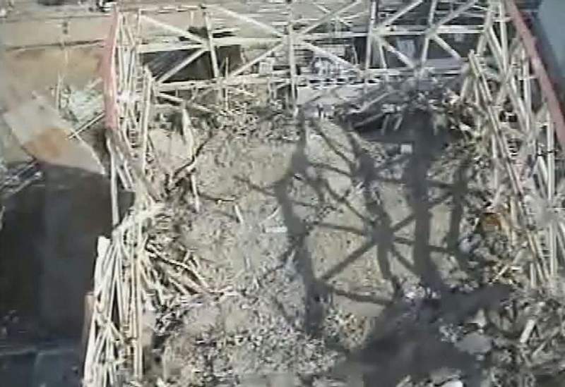

  • #3,878
shogun338 said:
We have found one thing out for sure . That the T-Hawk drone is not worth the money that has been spent on it . I can't believe how bad the pictures and videos taken with it are .
Assuming video that was published is really the best they have. Could be they don't want to reveal the high quality footage - for number of reasons.

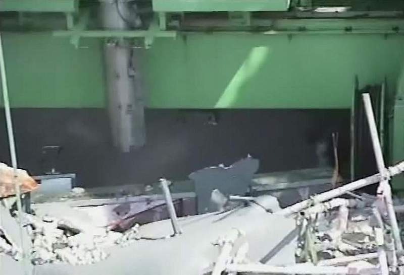

Addendum: and perhaps most importantly, all of the explosion at Unit 1 originated from the upper level only, and that superstructure was steel beam and sheet metal, not reinforced concrete. Also, a bunch of the "new batch" of images are concentrating on the northeast corner of Bldg 4. I wonder why . . .
http://cryptome.org/eyeball/daiichi-npp9/daiichi-photos9.htm

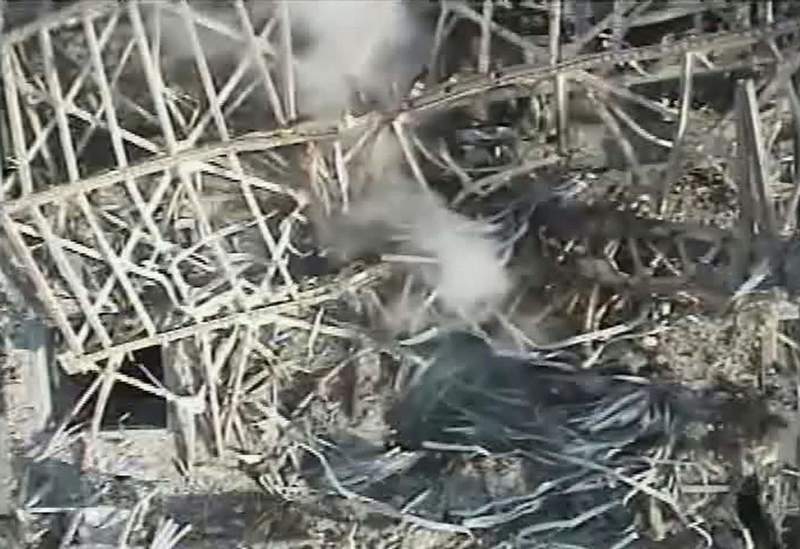

And pict32 is a very interesting photo of FHM 4. The FHM has been "de-masted". Perhaps pretty strong evidence something violent happened within the confines of the SFP?
Pict25, Bldg 3 looks pretty similar to the elevator shaft, cask transfer pool, SFP layout suggested earlier. Steam still venting from the general area of the fuel transfer chute?

In reverse order:
We can see the 'shield plugs - cookies' off the containment in #3. One of the explosions can be just from the containment and not from the reactor. If, IF there still is reactor pressure that would strongly tend to indicate no explosion in the reactor. Just venting from under great pressure.
My sense as a fire fighter is that there is far more energy released in the Reactor 3 building than from #1. #3 took out all walls and roof.
Now this could be just a component of the size of the buildings or different construction methods later on.
Or it could be different explosive materials ...
Well, in special effects, the #1 would of required a dynamite stick, movies wouldn't even do that, too dangerous. #3, a very small charge inside condom with fuel. In CG, special effects, the first, you just instantly make a lot of air hot, it expands and cools, big cloud, doesn't rise. The second, you vent in giant amount of steam, or approximation thereof (magical air that does not cool down) and you get beautiful mushroom cloud. You can also color some of it burning. But no actual chemical explosion, just a burn. Movies barely ever do explosions like #1 . We really brainwashed everyone about explosions, haha. An explosion in movie is not even an explosion very much, just big fireball. It's also easier to do in CG.
  • #3,887
Or it could be different explosive materials or the amount of in a larger space ...
it's because of different material.
Unit 1 has been built without reinforced concrete in the top part, as you can verify in the pictures.
So far less energy got absorbed by the walls, they just popped out and pulverized, leaving the steel girderwork almost undamaged.
  • #3,888
look at the videos again, really. The #3 explosion was reported as much more loud from the distance. The #3 explosion had immense volume of air rising at very high velocity. Try explain that with the building material differences.

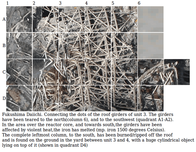

I've stuck together the pieces of the roof structure of unit 3, by locating the single parts, then putting images of those in a 6 by 4 matrix, in the positions they were in before the hydrogen, and the following steam explosion. The result of my effort is this:
There's an html version of the same thing with the images in the original resolution, at
http://www.gyldengrisgaard.dk/fuku_docs/roof3.html
