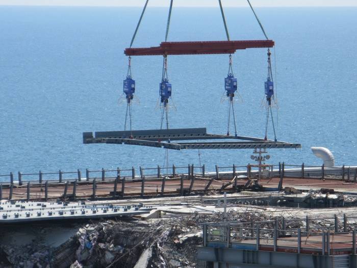

Update: All the spent fuel has now been removed from SFP 4. 180 new fuel assemblies remain to be moved.

From the Tepco site:
Efficacy of dust-fixing resin
In Japanese, but mainly photos. Simple but convincing (I think) report on an experiment that shows how dust scattering is prevented by the agent they are spraying now on the operating floor of Reactor 1 building.
turi has already reported this one:
One page report about the end of spent fuel removal operation at SPF of Reactor 4. In Japanese. There are some photos revisiting the road to this result. The 180 new fuel assemblies are scheduled to be moved too, until the end of December.
Bigger and better photos here. Some of the photos are said to depict the handling of one of those deformed spent fuel assemblies. (Just in case somebody notices, parts of the photos are blurred by Tepco, this is clearly stated.)

New Tepco report (in Japanese) on the investigations and operations related to Unit 1:
http://photo.tepco.co.jp/date/2014/201412-j/141219-01j.html
The focus of the report is on the monitoring of radiation during the partial removal of the building roof. Apparently the dust-fixing resin sprayed in the building helped prevent further scattering of radioactive dust.
Page 7 shows the locations of the operating floor where the camera was lowered to take photos, as well as the direction of the camera views.
They have a general idea of what is some of the debris that should be removed first.
SFP - no visible sign of damage to the fuel assemblies.
The ceiling crane has fallen and is supported in part by the FHM, pretty close to the surface of the SFP water.
Page 10: walls, pillars and roof debris
Page 11, 12: state of some wall metallic structures. Some bolts have failed, girders sustained damage.
Page 13: remains of the collapsed roof. Photo 3 shows the concrete slab over the reactor well. Photo 2 shows the FHM, hanging pretty close to the SFP water surface.
Page 14: part of the fallen ceiling crane (girder); photo 5 = displaced concrete cover of the "new fuel storage room" (it held no fuel at the time of the accident).
Page 16: radioactivity level values (77 mSv/h seems to be highest value)
Page 19: infrared photo of the operating floor (no signs of heat).The photos are also listed individually here:
