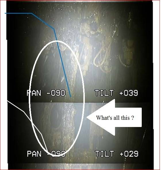

Quick report again (only in Japanese for now) about the Unit 3 PCV investigation of July 21st:
http://www.tepco.co.jp/nu/fukushima-np/handouts/2017/images2/handouts_170721_09-j.pdf
Photos: http://photo.tepco.co.jp/date/2017/201707-j/170721-01j.html
They sent the robot inside the pedestal and took some images.
They identified "what appears like once molten mass(es), now solidified", as well as "fallen objects". (Separately on NHK TV I saw a Tepco representative stating that these solidified icicle-like masses have a high probability of being "molten fuel and various parts", which mixed and later solidified.)
Same as in the first day, they saw damaged structures and fallen support fittings of CRD-housings.
During today's operations too they couldn't see/confirm the grating platform where it should have been.
Tomorrow they will try to go down into the basement of the pedestal. Due to many obstacles and fallen objects they think they might not be able to retrieve the robot.

It has certainly made the news.
http://abcnews.go.com/Technology/wireStory/melted-fuel-time-fukushima-plant-48769520
It is difficult to know at what one is looking. The CRD housings are clear in some pictures (looking up from underneath), but in others it's not clear if one is looking up or down. Certainly there is a lot of corrosion and corrosion products. If there were chunks of molten fuel below the pressure vessel, then I would expect somewhere there should be a relatively large hole in the pressure vessel.
Azby said:
Once again, English version of the brief report has been posted here: http://www.tepco.co.jp/en/nu/fukushima-np/handouts/2017/images/handouts_170721_01-e.pdf
In one image described as the CRD housings under Unit 5 (CRD housing at Unit 5 and CRD housing supporting clamp), there seems to be a lot of rust on some of some of the components.

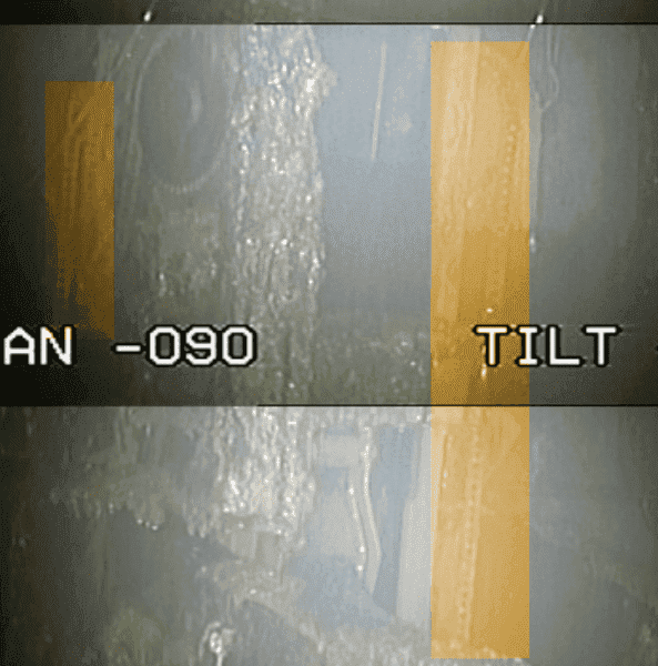

Far more interesting than expected.
First and foremost; the water level. The water level in Unit 3 is remarkably high. The probe results from the other 2 units show water levels much, much lower.
At 1:40 in the video we see the probe swimming close to submerged control rod drives.
[COLOR=#black]. [/COLOR]
Knowing that the CRD bottom ends are located at the top of the pedestal and that the bottom of the pedestal is openly connected to the outer pvc area, that means the entire unit 3 Primary Containment 'light bulb', must be flooded to an amazing level (Similar to the light blue area below but also including the outer area).
Considering that the unit building is above the water table and sea level, they must be pumping water into keep it flooded.
The second interesting thing is the structure of the deposited fuel melt. Anybody experienced in lava or melt flows would be able to say whether these globular formations were formed in air or in water, i.e. did the fuel melt burn through the reactor onto a dry floor where it could burrow further or was it quenched as it entered an already flooded containment.
Lastly, muon results. It will be interesting to see when they are released, how they match up with what appears to be visible fuel deposits in the Unit 3 pedestal area. That could give some information as far as the lack of results from the scans on units 1 and 2 i.e. is the fuel in units 1 and 2 higher or lower etc.
Unit 3 being so heavily damaged but still holding that much water is definitely the most surprising thing to see though.

Various news organizations are publishing pictures purportedly being 'likely molten fuel'. Unfortunately, there is no scale or reference, so it is impossible to judge the size of what is considered to be molten fuel, or a mixture of molten steel and fuel. The orange/brown is likely corrosion products from steel. The dark or black material could be molten fuel.
http://www.japantimes.co.jp/news/20...fuel-bottom-reactor-3-fukushima/#.WXVM8HlK2po
https://www.bloomberg.com/news/arti...ted-fukushima-fuel?utm_medium=bd&utm_campaign
I would hope that the robot can grab some samples for analysis of the composition.

There's a new quick report (in Japanese) regarding the third day of investigation in Unit 3 (22 July)
http://www.tepco.co.jp/nu/fukushima-np/handouts/2017/images2/handouts_170722_05-j.pdf
Pages 1-2 show new photos from inside the pedestal.
Page 3 lists short conclusions: The investigation of 22 July aimed and succeeded to obtain information regarding the lower part of the pedestal and surroundings. Once molten and then solidified masses were observed, as well as fallen objects such as pieces of grating, and sediments/deposits. The analysis will continue.
The photos can also be seen here:
http://photo.tepco.co.jp/date/2017/201707-j/170722-01j.html
Likes jim hardy

  • #1,316
Hey Jim. I hadn't even noticed that! I couldn't have played it at work anyway, but now I am home and I just looked at it and it's awesome, much more suggestive than the still photos. The swimming robot did a great job, I just wished I understood more or what I see. Reminded me a little of Titanic - and also of those scenes in which a paleoanthologist says "see here how well this bone is preserved" and all I see is a rock. The large pipe corroded (melted) so bad that it is missing a few patches (01:37) through which we see a smaller pipe inside? The blue-greenish stuff that we've seen in another unit too (00:48). The mix of materials at 01:20. The amount of light, floating sediment that is raised by the robot's propellers.
By the way the clickable folder name in the link given by Jim is something like link1 / link2, link1 is "play the movie" and link 2 is "download the file".
Edit: Then I found the video images of 21st too. Totally as impressive! Take a look (I only know this way to access them : http://www.tepco.co.jp/tepconews/library/archive-j.html?video_uuid=f1ak69jq&catid=69619)
Especially intriguing moments: 00:12 and 00:53, that can't be steel corrosion, too conspicuous and non-uniform? they rather look like blobs of material splattered over structures. What's that at 00:19, a little current of water - under water? Or bubbles? And at 00:44, a large irregular mass near the still nicely rounded pedestal wall.
Likes Charles Smalls and jim hardy
Thanks Sotan
my Windows is dyng of update poisoning, Microsoft's preferred means of demise. It downloaded the file but refuses to play it. Perhaps i'll try the other machine tonight.
Splattered ? As in perhaps thrown against the walls by expanding steam ? That might explain a lot.
I would be very interested to see upper head area of the drywell (or is PCV correct term? The big light bulb..) Do you recall any photos ? . .
  • #1,319
Got it to play
THANKS, Sotan and Charles ..
I see what you mean. Around 1:21 and 1:50 could pass for slag.
but speaking for myself I have to resist the natural tendency to speculate whatever is most exciting . So at this point i wouldn't assert that it's less benign than melted plastic cable insulation. .
Maybe someone who's been under a BWR will recognize the mechanical parts.
Astro nailed it - got to get a sample of the stuff.. Activation products in it will tell a lot.
  • #1,320
I think it is at 1.18. That's something dense and solid hanging down (!) from CRD support.
The outside of the upper head of the drywell requires you to drain out the spent fuel pool and upper cavity and remove the shield plugs.
To see the inside of the drywell head you need to go to the upper elevation of the drywell and open some bellows hatches. Not something a robot can accomplish.
