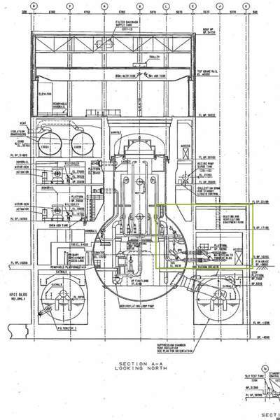

http://www.tepco.co.jp/nu/fukushima-np/handouts/2014/images/handouts_140428_06-j.pdf
(in Japanese)
This PDF document presents the planned investigation of floors 2 and 3 of reactors 1-3, using two robots, one equipped with a radiation measuring devices and one with a gamma camera (also both bearing normal cameras and lighting). One is radio controlled, one has a 300m long cable. The investigation is probably ongoing right now in Reactor Building 1, then will move to Reactor 2 in late May, and then to Reactor Building 3 in mid June. The results are expected to be useful for the decontamination/shielding/decommissioning activity.- And this is the daily report from TEPCO issued on April 28 (again, in Japanese).

zapperzero said:
Could have been caused by steam explosion, I think. Here's a nice schematic btw:
http://fukushimaupdate.com/wp-content/uploads/2014/01/containmentvessel.jpg
ZZ the schematic isn't very helpful tbh.
What Tepco is reporting here is in the "MSIV Room", outside of containment.
Related to this are reports from January and April regarding the U3 MSIV room which I had missed.
http://www.fukuleaks.org/web/?p=12208
http://www.fukuleaks.org/web/?p=12907
This is a more indicative view. (Allegedly U1 but same as U3 as far as the general location of the MSIV room and the HVAC room above it goes). Shows MSIV's inside and outside of containment.)

It looks like a containment penetration or guard pipe is leaking. So this could be a drywell leak or a reactor leak. Considering the reactor is likely breached, any reactor vessel leak IS a containment leak.
The location of the MSIVs is in what is called the "Main Steam Pipe Tunnel" or "Pipe Chase". This is where the steam lines go out, and the feedwater lines come in.
Anyways...looking at this some more:
The steam lines in a BWR have double isolations. There are 4 steam lines in the BWR reactor type at Fukushima. Each steam line has 1 MSIV inside the drywell, and 1 MSIV outside the drywell in the pipe tunnel. The MSIVs are spring loaded, and require air to open against spring pressure. They fail closed on a loss of air (the springs push them closed). De-energizing their air solenoid valves will also vent the air off. The valves are reverse seated, this means the valve seat has the reactor's pressure behind it, helping to push it shut.
If either the inboard or outboard MSIV is closed for a steam line, there should be no leakage. The leakage in the video is in the pipe tunnel, between the inboard and outboard MSIV. However we cannot see the main steam line itself, we only see the containment penetration. The most likely source of the leak is through the containment penetration (the hole in the wall). The Mark I containment design does not support water going all the way up to the main steam lines via containment flood, and it is very likely the MSIVs have remained in their closed position with little to no leakage during the event. This is my best guess though, based on working in similar BWR models.
