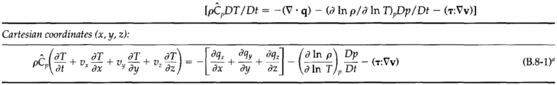

Side note - I am also including this energy conservation equation that was previously flagged as being useful in solving this problem:

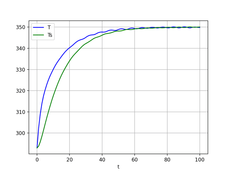

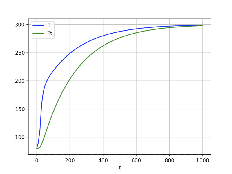

So taking the energy conservation equation:
Assumptions:
1)
No temperature variation along the bed in any direction for both the fluid and solid (dT/dx,dT/dy,dT/dz) will all be zero)
2) No pressure variation (Dp/Dt = 0)
3) The velocity gradient is small enough such that shear stresses will be zero (shear stress term will be zero)
4) We're dealing with a single phase
Point of confusion:
I'm going to say that q here is due to only convection, not the sum of convection and conduction. The reason I'm confused here is because the the temperature in the bed is constant. So this might mean there is no conduction between solid particles. Is this correct?
So for those reasons, I think the answer to model 2 is the same as the original equations I posted, minus the dTf/dx fluid term, the conduction terms in both equations, and the losses to the environment term. I'm going to write the equations out using LaTex (I haven't done this before so I guess it'll take a few attempts to get right):
$$\epsilon\ * \rho_{f} *C_{pf}*dT_{f}/dt = h_{fp}*a_{s}*(Ts-Tf)$$
$$(1-\epsilon) * \rho_{s} *C_{ps}*dT_{s}/dt = h_{fs}*a_{s}*(Tf-Ts)$$
These equations say the following to me:
LHS: The temperature of the fluid/solid will change over time
RHS: The temperature change is driven by convection (the difference between Tf and Ts)
Note: f and s subscripts are fluid and solid
Is this the right direction? I will edit this if I see any corrections!
I'm now going to look into how to adapt this for the phase change case. My initial thought is that it seems that it might be possible to have an 'if statement' of sorts, where we check the boiling point of the fluid. For T>Tsat we use the gas parameters, and for T<Tsat we use liquid parameters. This could avoid the need for a phase change term. However obviously it tells us nothing about the phase change itself.
I'm going to think about the addition of a phase change term now.

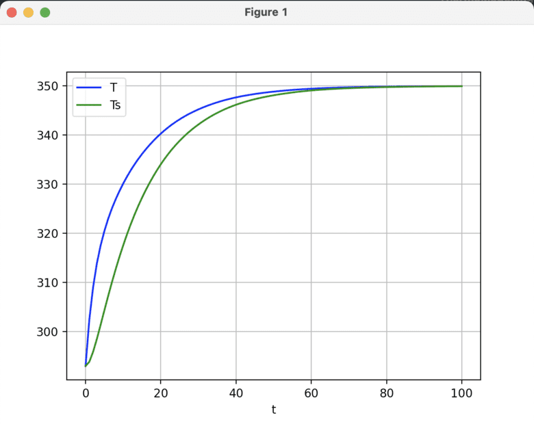

For the lumped parameter model I described, in the case of no phase change, the overall mass balance on the gas is $$\frac{dm}{dt}=\dot{m}_{in}-\dot{m}_{out}$$and the enthalpy balance on the gas is $$\frac{d(mh)}{dt}=\dot{m}_{in}h_{in}-\dot{m}_{out}h-UA(T-T_S)$$where m is the mass of fluid in the bed at any time ##\left(m=\frac{pM}{RT}V\right)##, ##\dot{m}_{in}## is the mass flow rate into the bed, ##\dot{m}_{out}## is the mass flow rate of gas out of the bed, U is the heat transfer coefficient between the gas and the solid bed, V is the total pore volume, and A is the heat transfer area between the gas and solid bed. Note that, in this crude lumped parameter model, all the gas is well mixed, so the exit enthalpy is equal to the uniform gas enthalpy in the bed.
Combining these two equations yields:
$$m\frac{dh}{dt}=\dot{m}_{in}(h_{in}-h)-UA(T-T_S)$$Substituting for the enthalpy ##dh=C_PdT##, we then have: $$mC_p\frac{dT}{dt}=\dot{m}_{in}C_p(T_{in}-T)-UA(T-T_S)$$
For the solid bed, the corresponding heat balance is $$MC_S\frac{dT_S}{dt}=UA(T-T_S)$$
So, for this very crude lumped parameter model, we have two simultaneous ordinary differential equation in two unknowns for the gas temperature T and the solid bed temperature ##T_S##. Note that this simple formulation accounts for the changes in gas holdup within the bed as a result of temperature induced density changes.
If it were me, I would run some calculations using this crude model to see what it predicted.
Extending this model to cases in which there is vapor condensation would be the next step. How do you think the equations would change in a region where vapor condensation is occurring at constant temperature and pressure.
Likes casualguitar

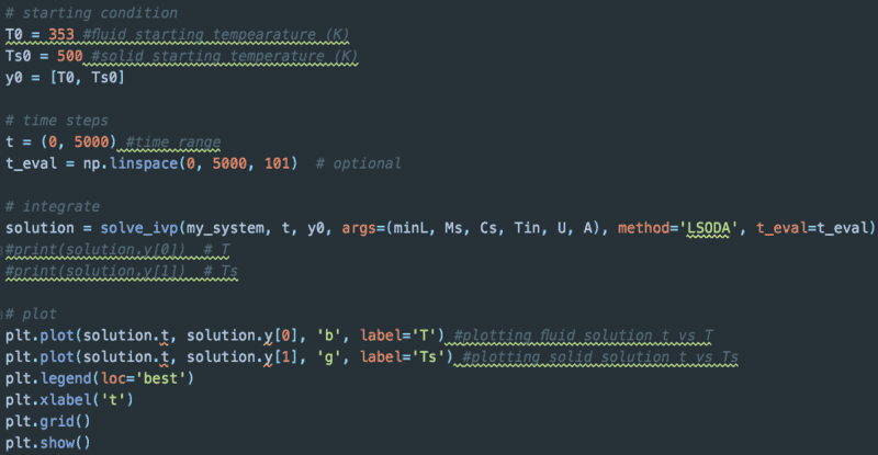

Wow ok I was way off. I fully understand how you got the final solid/heat balances though. Again thank you for the comprehensive responses.
I'll put together a simulation for this model in Python.

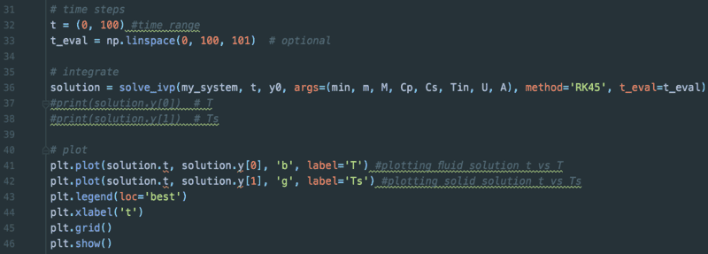

Hi Chet, to our original two equation, single phase question - I've got a solution for this. I'll post the code plus the output below. The values of U and A and arbitrary so the solution has very little physical meaning but the main thing is that the solver seems to work! I'm going to save all of these models as they do all add value even if they're simplifications of the goal model.
The code:
The output (quite basic but it shows the solid and fluid temperature both trending towards the inlet fluid temperature):

What are the units of time on the figure?
The mass flow is kg/s so the time should be in seconds I believe. No?

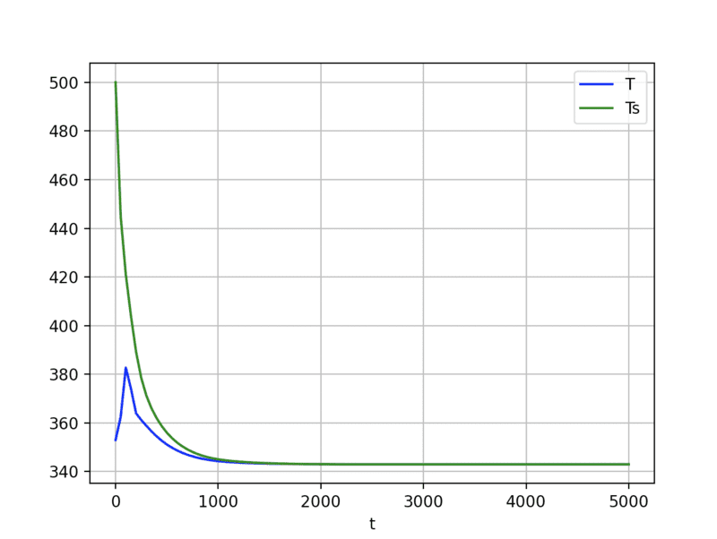

Why are there wiggles in the time response of the fluid?
I’m actually not sure, I’ll look into this. Its related to satisfying the stability criteria I think. I had this issue when I tried modelling the PDEs in my original question. When I approached the max stable time increment it started wiggling like that

Agreed. I checked and RK45 - or Runge-Kutta 4th and 5th order - the method used by solve_ivp in this case is explicit. The package offers implicit methods also (just involves changing the method = 'RK45' keyword).
I switched to LSODA, which is a wrapper from the FORTRAN solver ODEPACK, and the instability issue was fixed:

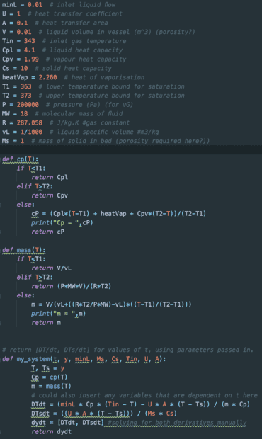

Hi Chet, phase change model code below with a graph of the fluid and solid temperatures over time. I could tweak the inputs until the graph looks nicer but in the interest of saving time I wont. Basically the code is exactly the same as the last model, except now we just take m and cp as variable rather than constant (as shown in the mass and cp functions).
So looking at the graph, initially the fluid temperature and the solid temperature jump towards one another, and then gradually both reduce to the gas inlet temperature. This happens slowly though, meaning that the mass flow in is small relative to the volume holdup. We also have the linear increase/decrease in temperature between T1 and T2 (shown by the straight line sections on the blue curve)
How does this look to you? What are your thoughts on adding in temperature variation along the direction of flow? Is this a reasonable development?
This doesn't look anything like what I expected. I was expecting to see something like the previous graph. Wasn't the initial temperature of the bed supposed to be < 80 K, and the gas temperature supposed to be about 300 K? What did you use for T1 and T2, for the inlet gas temperature, and for the bed-filled-with-liquid temperature? Also, on the graph, please show times from 0 to 1000 s only.
Likes casualguitar

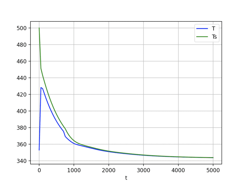

Ah my apologies, the ##80K/300K## temperatures refer to the liquefaction of air model. I just chose water/steam for the model above to test this phase change model. I've switched it now so the initial temperature of the bed and fluid in the bed are both ##80K##, and the gas entering is ##300K##. I used ##T1 = 100K## and ##T2 = 110K## to approximate a boiling range. Range adjusted to ##1000s## also. I've also switched the input values (cp, vL, etc to reflect average air properties).
My apologies for the confusion there. What are your thoughts on adding in temperature variation along the direction of flow? Is this a reasonable development?
