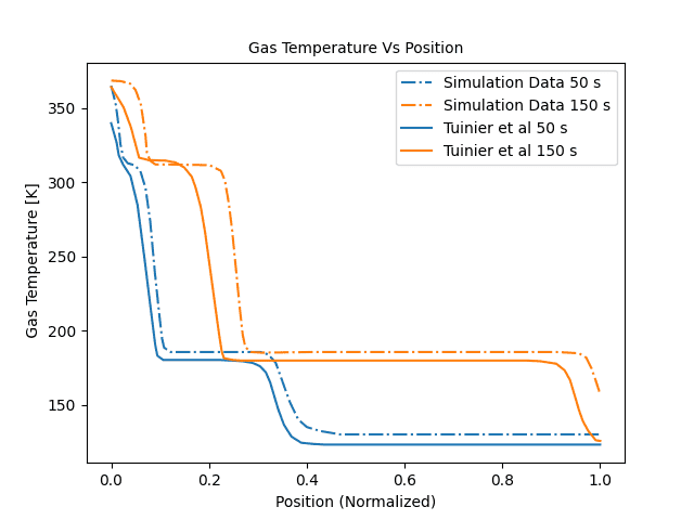

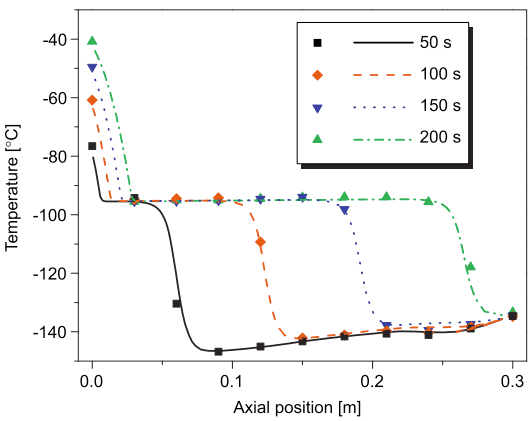

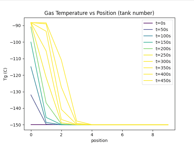

Whoops my mistake. I changed that and now yes I'm getting 0.00012 moles also for a single tank
Here are the plots with the correct bed length:
What I noticed was that this 'max levelling off temperature' of around -85C is not constant. If I zoom in:
The temperature at the inlet seems to actually slightly decrease over time
These plots are definitely quite a bit closer to the Tuinier plots though. The main things that are not the same are the temperature profiles near the inlet (not sure why the temperature doesn't increase further than -86C, and also possible the max mass deposition in our simulation being about double what is seen in Tuinier et al

This looks much better. Please cut the calculated results off at 200 sec so we don't get distracted from their results.
Please run a calculation with the mass transfer totally turned off (k=0). This should tell us a lot about the temperature profile issues.

Temperature plot for k=0, much closer to Tuinier et al again:
The temperatures near the inlet are now very close to the Tuinier values. We just don't have the constant temperature phase change section yet. Would we expect to have this though for k=0?
Yes. This is about what I expected to see. The speed at which the profiles are advancing along the bed is on the order that I expected. How do the bed temperature profiles compare?

Why is the abscissa 0 to 29? Why isn't it 1 to 30? Also, let's plot the points at the coordinates of the center of the tank in cm: 0.5, 1.5, ...,29.5.
It seems like there is something wrong with the mass transfer description in the model. We seem to be getting much high heat releases from the desublimation than Tunier. Try scaling back the k's in the model until we get a better match with Tunier. Keep track of the scale down factor.
So are you saying to start with the k values I was using previously and keep dividing by say 10 for example until we see similar solid mass buildup profiles?

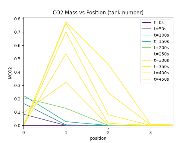

ki/100:
MCO2:
Zoomed in on the relevant section:
Tb:
Tg:
Note: the legend doesn't seem to show up on some plots. It is the same legend for all plots

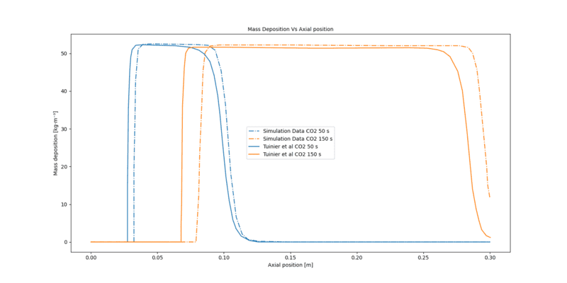

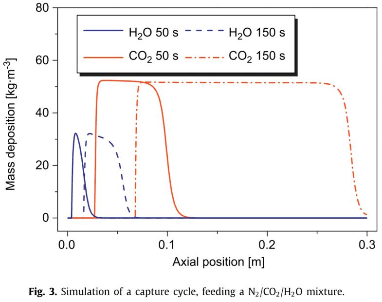

Here is a plot of the rate of desublimation of CO2 for the same selection of times:
The MCO2 plot seems to suggest that there are two plugs of CO2 moving through the bed rather than one. However the dM_CO2_dt plot doesn't suggest this

  • #301
casualguitar said:
k/30:
So what is your interpretation of what is happening here?
Please provide a documentation of the finite difference equations for heat and mass transfer that are currently being used in the model.
I had turned both the MCO2 value and the dM_CO2_dt values to zero in the case where the solid buildup goes below zero, but really its just the MCO2 value that needs to be zero I think
Changing this (so now in the case of negative solid buildup the value is set to zero), here is the output for k/30:
Just checking some more ki/x values now to try the solid deposition to peak at a similar value to Tuinier et al

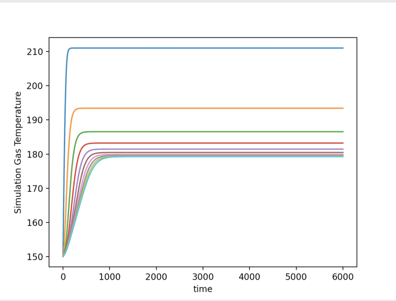

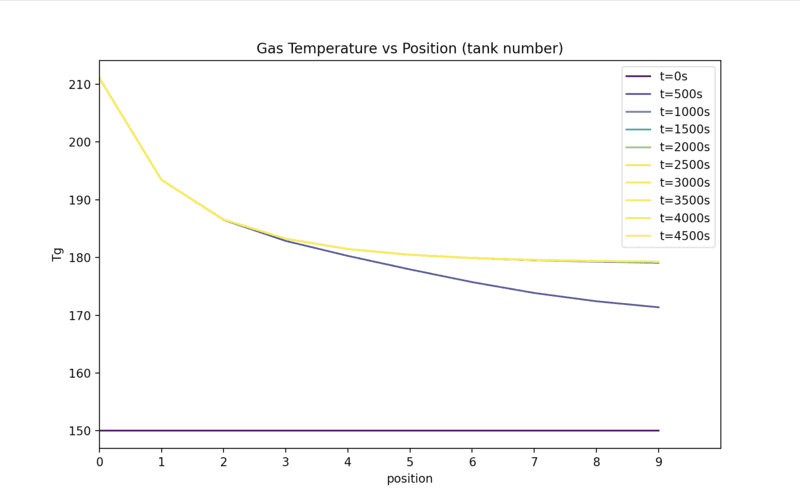

Adjusting the heat transfer coefficients:
If Ug and Ub are both = 100000 we get the plot below for Tb (I think very high Ub and Ug approximates the Tg=Tb assumption made in the Tuinier model?):
And here's Ub = 100000 and Ug = between 20 and 50 (calculated for each tank):
For the MCO2 plot, is their 'fudge factor' as you previously called it coming into play here? The max solid deposited seems to be in the ballpark of the Tuinier model, however our rate of sublimation of this solid seems to be a lot lower (their peaks are sharper).
Lastly, when Ug is not a very large number the constant temperature zone seems to appear for Tb, but not for Tg just yet
Refresh my memory. What do you use for Ub in the standard situation, and show its calculation.

Here is the output for ##U_b## calculated as above, and ##U_g## calculated at each interval
I think generally the output above is similar to the Tuinier output. The main two differences seem to be:
1) the rate of sublimation of the solid buildup (solid to gas) is lower in our model (gradually tails off rather than immediately sublimates
2) there is no constant temperature gas section showing up in our model

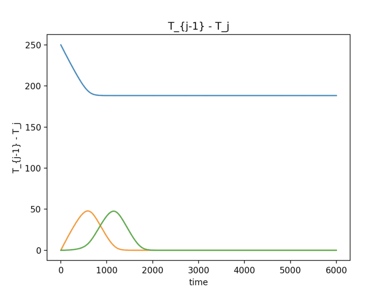

Checking the dTg_dt plot shows that there is no section where the value of dTg_dt reaches zero (a constant temperature section):
In the Tuinier model, what is the driving force that actually keeps the gas temperature almost constant while the phase is changing?
  • #308
View attachment 305254View attachment 305255View attachment 305256View attachment 305257
Is it correct to say that these results were obtained using the corrected mass transfer description together with all other parameters standard?
I think the difference is that we have heat transfer resistance between the gas and bed and a different mass transfer parameterization (and different dispersion parameterization). We can make our results more like theirs by increasing Ug (I think). You can see that the bed temperature is closer to constant than the gas temperature at -90.
We can also decrease the dispersion by adding more tanks, holding the length of the column constant.
  • #309
Yes these results were obtained using the Tuinier dimensions, flow and initial conditions as much as possible, with the corrected mass transfer coefficients of ##k_{CO_2}##/100 and ##k_{H_2O}##/100. The ##U_b## value is calculated according to the equation in post 305, and the##U_g## value is calculated using the correlations from BSL
Ok I see what you're saying. If we increase ##U_g## then the gas temperature will more closely follow the bed temperature. Checking a value of ##U_g##= 100000 gives this ##T_g## profile which is visually identical to the ##T_b## profile:
As a note, if I calculate the ##U_g## values at each interval (which gives a range of about 20-50W/m2.K), then ##T_b## starts to show the almost constant temperature section, which doesn't happen at high ##U_g## values. The ##T_g## profile is unchanged from the one above:
Running the opposite (calculated ##U_g## and a high ##U_b## value gives identical output to the ##T_b## and ##T_g## profiles above)
Checking n=100 now for calculated ##U_g## and calculated ##U_b## values (no very high values). This will take a fair while to run so I'll post these results once it finishes
Is this considered 'model tuned'? I guess this is a judgement call rather than anything but it seems pretty close. If this is 'model tuned' I was thinking about taking what was learned during debugging here and applying it to the original liquefaction model (I'm guessing I can find some bugs in that now, and the model is simpler in comparison)
But besides this, I was thinking about some other things. The Tuinier paper (in my view) isn't that useful for a new reader because it doesn't actually say how good the system is (or can be), but rather just shows output for the system they used. What I mean is that they don't define performance parameters that would allow someone to compare this system with others or get a feel for how good this system actually is
To do something like this would involve (I think) answering questions like "what performance parameters are actually useful to calculate here?", "what simulations best show how these performance parameters vary with varied input" and lastly "does the model need to be developed further to be 'different enough' from the Tuinier model". Or something like these anyway
Regarding the performance parameters, I guess there are standard ones. However, possibly one meaningful parameter is the separation efficiency (how good can the system get at separating CO2 from both N2 and H2O in theory).
And lastly one other thing Tuinier didn't do is vary the ICs/BCs to arrive at an optimal solution (optimising the performance parameters). This sounds interesting to do and would also be novel as far as I can see (just trying to think of ways to further separate this model from Tuinier and make it of use to a future reader)

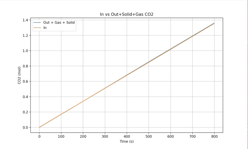

I think we should also check the overall mass balance on the CO2 at the selected times. Please calculate the total moles of CO2 that have flowed into the bed up to time t, the total number of moles of CO2 that has exited the bed up to time t, the total molar holdup of CO2 in the gas phase in the column at time t, and the total molar holdup of CO2 on the bed at time t. In addition to these giving us a check on the CO2 mass balance, they will also tell the fraction of the CO2 that is captured by the bed up to a given time.
  • #313
$$M_{IN,TOTAL} = \dot{m} * t\tag{1}$$
Hmm. I think we could do that using the total molar holdup and the inlet flow, something like this:
$$M_{OUT,TOTAL} = \sum_{t=1}^{t}{\dot{m}_{IN} - m_{HOLDUP}}\tag{3}$$
Which I think is the sum of the outlet flows at all times in the bed
Hmm so we have to consider each tank individually here given the temperature profile.
The molar holdup of a single tank is ##(P/RT)(A_cdz\epsilon)##
So the total molar holdup would be:
$$M_{GAS} = \sum_{j=0}^{n}(P/RT_j)(A_cdz\epsilon)\tag{4}$$
I guess this is solid phase only, so:
$$M_{SOLID} = \sum_{j=0}^{n}(M_j)\tag{5}$$
When you say 'fraction of CO2 captured' what does this mean? Do we define 'captured' as meaning solid phase? So the fraction would be the solid mass of CO2 at a point divided by the total mass of CO2 at that point?
I'll work away on the above calculations and if they're incorrect I can adjust
  • #314
I'll separate these plots out, however just for an overview these are the values mentioned above plotted versus time (note I've assumed CO2 captured is the mass of solid CO2 in the column divided by the total mass of CO2 in the column):
  • #315
This needs to be multiplied by ##y_{in}## for CO2
This assumes that the mass balance is truly satisfied. The objective of this exercise is to check to see if that is the case. If ##\dot{m}_i(t)## is the total molar flow rate out of tank i at time t, then the total molar amount of CO2 leaving the column up to time t is$$\int_0^t{\dot{m}_n(t')y_{CO2}(t')dt'}$$
The total molar holdup of CO2 in the gas would be $$M_{CO2} = \sum_{j=1}^{n}(P/RT_j)y_{j,CO2}(A_cdz*\epsilon)\tag{4}$$
Note that the summation is from tank 1 to tank n, the mole fraction of CO2 multiplies the total number of moles, and that you multiply by the void fraction rather than dividing.
Again, the sum is from 1 to n.
Yes
I don't know what this means, but it doesn't sound correct.
