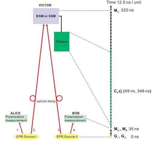

b) We consider the P2/P3/P4 a textbook case of quantum teleportation from P2 to P4. That is a reasonable description, no doubt, and I am pretty sure everything can work out fine in that view. Let's agree to this.
Except for one problem. Quantum teleportation is a one-way protocol. The P4 final state must occur after the BSM on P2 and P3. But we already know that it is possible to alter the timing of the measurement of P4 so it occurs BEFORE the BSM. That changes this setup into the Delayed Choice Entanglement Swapping case. If that happens, there is no teleportation from P2 to P4 possible. And yet, the large number of perfect correlations between P1 and P4 remain - just as in our b) option above. In fact, there is nothing to connect these photons at this point at all to each other other than random chance.
Now, to encode the possible perfect correlations between P1 and P4 in this Delayed Choice version, we would need a very large (possibly infinite) amount of information to be embedded in their partners P2 and P3. OK, that's reasonable. But that won't fly either. That's because the BSM cannot distinguish more than 4 cases (one of the 4 Bell states). And there are actually only 2 different relevant outcomes from those 4 states: either P1 and P4 are correlated, or P1 and P4 are anti-correlated. One bit of information is all that can be extracted from the BSM. So how can P1 and P4 be perfectly correlated based on a single bit of information.
In other words: As you vary the detection time of P4, to follow your reasoning, there must be a change in the statistics when P4's detection occurs prior to the BSM. That's because at some point there is no teleporation possible since teleportation is one way only. But we know those statistics don't change. We learned that from the Megidish et al experiment and one the papers it references, the Ma et al experiment. In both cases, the statistics are the same - just as I have written in post #117. So the b) option must be ruled out too. QED.

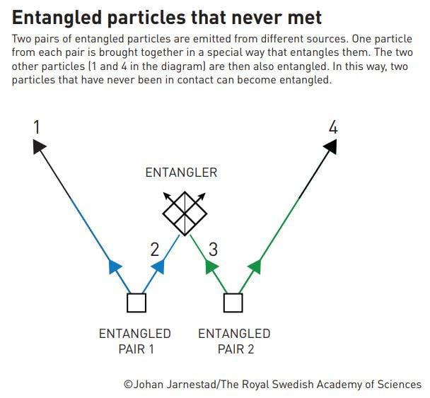

@PeterDonis: our substantive disagreement is not about what we call the states, but their physical reality. You claim that a "pseudo-Bell state" is physically real. I and two others (@A. Neumaier and @mattt) disagree.
Well sure, *I* think the pseudo-Bell state is physically "real" - but I don't mind the distinguishing label so we can discuss it in more depth without everyone dismissing it out of hand. There are plenty of angles to consider.
1. To me, it's as real as *any* entangled state created in a swapping realization. We agree: The general format of the entanglement swapping experiment yields identical predictions regardless of measurement order. So I guess I would ask everyone: Does the garden variety Entanglement Swap (not temporal, no delayed choice) lead to a Bell state that you would label "real"? Some people reject that label and think it is merely statistical knowledge gained after the fact, but does not represent a physical state of entanglement between distant photons that have never interacted. Consider High-fidelity entanglement swapping with fully independent sources (2008): "Here, we fill this experimental gap and demonstrate high-fidelity entanglement swapping between entangled photon pairs emitted from time-synchronized independent sources. The resulting correlations between particles that do not share any common past are strong enough to violate a Clauser-Horne-Shimony-Holt(CHSH) inequality."
2. I personally don't see what is so different about the case where P1/P4 never co-exist. To me, one of the key elements is that the P1 measurement is done before the BSM. That is also the case in the Delayed Choice version: Experimental delayed-choice entanglement swapping (2012)
So I guess I'm asking in 1 and 2: Are the Bell states physically real in these experiments in which P1 and P4 co-exist? I guess this is somewhat interpretation dependent, although I am not trying to drift into that arena. Perhaps you, Arnold or someone else would care to weigh in on this.
For people who don't insist on a realist interpretation, there isn't. The statistics are the same.
The only reason we're having an issue with this at all is that you are using a realist interpretation, but you keep ignoring the fact that the math of NRQM and the Schrodinger equation, which is what your realist interpretation is supposed to be interpreting, does treat this case differently from the case where the photons do coexist, since in the latter case there is a Bell state wave function including both photons, and in the former case there isn't. Neither you nor any of your references have explained how your realist interpretation deals with this inconvenient fact.
  • #94

I am adding some references that I hope will demonstrate the development of the ideas of Temporal Entanglement over the past 20 years. A number of papers have explored NRQM and QFT considering various elements of this. The general conclusion is that the time dimension should be placed on an equal footing with spatial dimension in QM. The approaches to this are quite varied, and there is not complete consensus on every single point. So the literature is much smaller than that of the usual spatial entanglement. I will place these in a few different posts as I present them.
Ref. [1] Quantum Entanglement in Time (Brukner et al, 2004):
"Conceptually, as well as mathematically, space and time are differently described in quantum mechanics. While time enters as an external parameter in the dynamical evolution of a system, spatial coordinates are regarded as quantum-mechanical observables. Moreover, spatially separated quantum systems are associated with the tensor product structure of the Hilbert state-space of the composite system. This allows a composite quantum system to be in a state that is not separable regardless of the spatial separation of its components. We speak about entanglement in space. On the other hand, time in quantum mechanics is normally regarded as lacking such a structure." ...
"Because of different roles time and space play in quantum theory one could be tempted to assume that the notion of “entanglement in time” cannot be introduced in quantum physics. In this letter we will investigate this question and we will find that this is not the case. We will explicitly derive temporal Bell’s inequalities (the notion of temporal Bell’s inequalities was first introduced by Leggett and Garg [3] in a different context; see discussion below) in analogy to the spatial ones. They are constraints on certain combinations of temporal correlations for measurements of a single quantum system, which are performed at different times. We explicitly show that quantum mechanics violates these inequalities. While mathematically two-fold correlations in space and in time are equivalent, the general spatial and temporal m-fold correlations can have completely different features." ...
"It is clear from our work, however, that it is very difficult to extend the tensor product structure beyond the two neighbouring instances in time without altering the basic principles of quantum mechanics. In fact, one of the features of entanglement in time is exactly a consequence of this difficulty: two maximally entangled events can still be maximally entangled to two other events in time (a principle we may call “polygamy” of entanglement in time). This is in contrast to the spatial entanglement which can only be “monogamous” [19].The difference between the spatial and temporal structure may ultimately be fundamental, or it may be an indication that we need a deeper theory in which the two need to be treated on a more equal footing (quantum field theory does not suffice in this sense)."
The paper discusses the concept of temporal entanglement without touching on entanglement swapping at all. It has a different approach, and there is an exact analog to CHSH as well as the Ciril'son bound. Both of these are essentially the same as with spatial entanglement. They acknowledge some of the basic issues that have already been touched on in this thread. Specifically, that QM treat time and space as different in certain respects. The Schrödinger equation is an example of that.
Interestingly: Some of you probably noticed in other thread posts that I have used the idea of Monogamy of Entanglement (MoE) as a tool to demonstrate how entanglement swapping cannot involve pre-existing correlation of the initially entangled photon pairs (P1 & P2) and (P3 & P4) with each other. In other words, there are no instances in these cases where a subset of such 4 photon systems initially have any entanglement between P1 and P4. That would violate MoE, as that would mean P1 is maximally entangled with both P2 and P4. (This is generally accepted conclusion.)
However: There is a problem with MoE when it comes to temporal entanglement. Assuming temporal entanglement is as is claimed in the paper of Megidish et al: We would need P1 to be maximally entangled with P2 at the time P1 is measured, because at that time P4 doesn't even exist. However, we also need P1 to be maximally entangled with P4 at the time P4 is measured, if a successful BSM occurred at some time. Wouldn't that violate MoE? Wouldn't violation of MoE then be proof that the Megidish paper's assumption of temporal entanglement must be false?
In Ref [1], Brukner et al discuss this point, see quote above. They claim (keep in mind this paper was 8 years before the Megidish experiment) that temporal entanglement is polygamous, even though spatial entanglement is monogamous. Funny how that works out, if correct. :smile:
