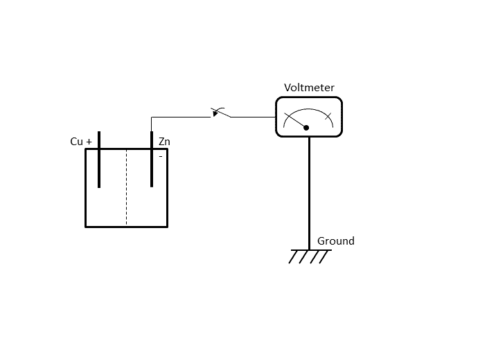

We had a similar thread some time ago. I'd like to reconsider some aspects.
Consider a 9V battery just to fix ideas. The chemical electromotive force inside it establishes an amount of positive charges on its positive terminal and an exact same amount of negative charges on its negative terminal.
Suppose the battery is at 1mt from the Earth surface. The charge distribution on the Earth plus the charge distribution on the battery terminals will be the sources of a static conservative electric field ##E##. Hence one can calculate the elettric potential evaluating its difference for instance between the battery's positive terminal and the Earth. So far so good.
Now suppose to attach a voltmeter between the battery's positive terminal and a Grounded metal rod. The voltmeter will not measure any voltage since it requires a current flow even though its ingress impedence in very high.
In any case I believe there is a voltage difference between them even though a voltmeter cannot measure it.
Does it make sense? Thanks.

No.
If the voltmeter has a real internal resistance, measuring the voltage between ground and the floating battery will rapidly bring the voltage of the battery terminal down to ground, with a reading of zero volts.
If the voltmeter has infinite resistance and zero current, no current will flow through the voltmeter, which will read whatever floating voltage was on the battery terminal, relative to ground, when the meter was connected.

A voltmeter is used to measure the voltage difference between two conductors that are part of a complete circuit.
Your components are floating. You have no circuit.

What is it?
What is the circuit?
This is the schematic: there is no closed circuit at all.

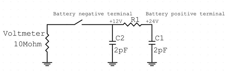

What is the voltage on the negative terminal of the flying battery, relative to ground, before the ground switch is closed?
Likes cianfa72 and Lord Jestocost
Without battery terminal capacitance to ground, there will be no battery current flowing during the flying to grounded transition.
If the battery terminals have 2 pF capacitance to ground each, then as the negative terminal approaches ground, so will the positive terminal. The 2 pF on the positive terminal will be discharged through the battery, the same current will flow from the negative terminal, along with the negative terminal capacitance current. Those currents will flow through the voltmeter resistance, assumed to be about 10 megohm.
If the positive terminal of the battery starts at +24V, with the negative terminal at +12V, then the current flowing through the battery and meter will be about 0.5 uA. That current will flow for a period of about 2pF * 10Meg = 20 us.
That current has nothing to do with the battery charge, it has everything to do with the terminal capacitance. Replace the battery with a copper wire and exactly the same thing will happen.

Here is my understanding of what you said
Let's say the battery is 9V and suppose that the positive terminal starts at +24V w.r.t. ground and the negative terminal at +12V w.r.t. ground (is it consistent with a 9V emf battery ?). Each terminal has a 2 pF capacitance w.r.t. ground/earth (so one plate of each capacitor actually represents the respective battery's terminal while the other is the common ground). I placed the resistor R1 in the model to account for battery internal connection.
If the above model makes sense, when the switch is suddenly turned on, there will be a flow of electrons from the terminal plates of capacitor C1 e C2 through the voltmeter towards the ground. Why did you estimate a current flow of 0.5 uA through the battery and the voltmeter ?
The RC current decays exponentially. The negative battery terminal capacitor starts out at +12V, so the maximum initial current through the 10meg meter will be 12 / 1e7 = 1.2 uA. The positive terminal capacitance must be discharged through the battery to the voltmeter. That will charge the battery.

Ok, therefore though the 10meg voltmeter will flow the sum of two currents: the discharge current from the negative battery terminal "capacitor plate" + the discharge current from the positive battery terminal "capacitor plate". The latter flowing through the battery will also charge it.

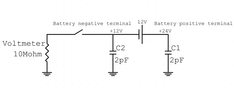

A battery is NOT a capacitor.
An ideal battery maintains a chemically defined voltage while it is being charged or discharged. The voltage may not change, but the charge is being stored in the chemical cells of the battery. In the example case, discharging the terminal capacitance through the battery, will charge the battery. An ideal battery is a fixed voltage source, with zero series resistance.
A capacitor, on the other hand, has a voltage directly proportional to charge. C = Q / v.
You cannot model a battery as a capacitor.
Ok, so in post#16 schematic, the resistance R1 must be replaced by an ideal voltage source of 12V emf.
From the differential equation system for this circuit, starting at time t=0 with those voltage levels w.r.t. ground, one can calculate the current through the 10meg meter. As you pointed out, its initial value will be actually 12/1e7 = 1.2 uA (at the start no current from the battery positive terminal "capacitor plate" will flow through the 10meg meter).

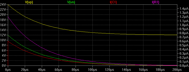

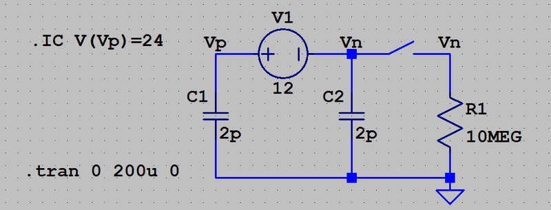

Here is my schematic. Load is drawn on the right.
The initial condition is that V( Vp ) = +24 V; Then V( Vn ) = +12 V.
When the switch is closed at t = 0; Currents flow clockwise.
Note that I( C1 ) = I( C2 ). Capacitors are both discharged through R1.
Initially; I( R1 ) = +12V / 10Meg = 1.2 uA .
Since dv/dt of capacitors are the same; I( R1 ) = I( C1 ) + I( C2 ).
Initially; I( C1 ) = I( C2 ) = I( R1 ) / 2 = 0.6 uA .
Series connection implies; I( V1 ) = I( C1 ).

Ah ok, you did a simulation using LTspice. C1 and C2 are both discharged through R1 since the current through R1 is always the sum of I(C1) and I(C2).
However my doubt is: who is responsible for the initial "charge" on the battery's positive and negative terminal "capacitor plates" ? I believe it is the battery's emf that build up an excess of electrons at the negative terminal's "capacitor plate" vs a defect of them at positive terminal's "capacitor plate".
cianfa72 said:
However my doubt is: who is responsible for the initial "charge" on the battery's terminal "capacitor plates" at positive and negative terminal ?
You are required to specify the initial conditions for the simulation. It will be some initial voltage, and everything will follow in an orderly and predictable way from that. How you held the battery, and what shoes you were wearing when you assembled the circuit, is quite irrelevant to the analysis of the discharge process.

I believe that's the point. The SPICE directive .IC V(Vp) = 24V sets the initial potential of node Vp (i.e. of the C1 plate) to 24V w.r.t. ground. Is the associated charge on the C1 plate actually due only to possibly electrostatic process/sources (i.e. it is not the charge stored there from the battery) ?

Since there is not a closed circuit involving the battery and the Earth
You can always make a closed circuit by including the capacitance with the ground.
  • #33
Ah ok, you mean the capacitors C1 and C2 in post#22 schematic when the battery is flying. Therefore, as you pointed out, the effective charge on battery's terminals depends on battery EMF and the "history" as it flies around the space.
Simulation programs can be a snare and delusion because they tend to make assumptions about those components in a circuit that you don't specify (or even notice). You should hesitate to conclude that the software 'got it wrong'; it just tried to help you by filling in the gaps in your data with its own estimates.
It's incredibly easy to find a disagreement between what your basic theory and a simulation tells you. So beware and choose the direction of what the basic theory tells you. When there's a problem then start looking for something that your basic approach has missed or failed to specify. EMFs can be difficult to quantify.
  • #50
With reference to the simulation in post#22, from my previous work, LTspice uses a Thevenin voltage source with a series resistor of 2 mOhm (or 500 Siemens Norton conductance) to drive the node referenced in the .IC V(nxx)=<value> global directive.
In this case the node Vp is driven with a Thevenin voltage source of 24V with a series resistor of 2 mOhm. With .tran simulations, LTspice evaluates first the Initial Transient solution (aka initial DC solution) opening the capacitor and shorting the inductors. Therefore in our case (before the grounding switch is turned on) the Initial DC solution for node Vn is 24 -12=12V w.r.t. ground. It is also the state initial condition for the numeric integration of the C2 capacitor voltage.
Said that I believe, as @Dale pointed out before, that even the battery EMF is "responsabile" for the charges stored on the battery's terminal/ground capacitors (i.e. C1 and C2 in the model). Consider the following: suppose no external charge is placed on the battery terminals and the inter-terminal capacitance is negligible. The PDs between each terminal and ground cannot be both zero. Hence the battery EMF must charge someway the battery terminal plates.
