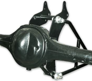

I know this is off topic but i have tried everywhere else to no avail. Does anyone know of a company other than Howe that can provide the pictured bracket? Howe has discontinued it.
  • #461
Carso,,,look at
http://www.speedwaymotors.com/search-bracket-rear.html
or left hander chassis, Port City racing
speedway engineering..
the y all can whip up a copy if you give them good dimensions..

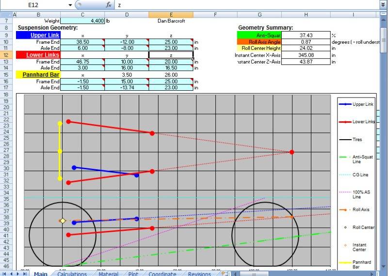

Hi Guys, slightly off topic this one, as in where the discussion is at present & not strictly being a race car (allbeit an offroad racer)
Im building an off road truck at the moment, I've already put together a 3-link setup on the front which ran airshocks. I'm re-designing it to run coilovers and also for better link geometry, at the same time I'm going to be 3-linking the rear running coilovers also.
The main issue I have at the moment is with the Panhard rod (trac bar?). Initially I was going to go with both PH rods running the same direction so they shift the same way over bumps etc, but looking closer its going to make for a much cleaner install if I run the rear opposing the front. When I thought about it a little more, wouldn't it be more stable when tipped over (side hilling) with them opposed.
I think any differences with regards to shifting track would be minimal with the PH rods pretty much horizontal at ride height, and due to an 8" side wall on the tyres.
Is there a definitive answer on this one or is it a compromise one way or the other?
Many thanks in advance, Nik..

Thanks for the input Mike.. I'm getting there with my numbers.. This is my existing(ish) setup..
And this the proposed(ish)..
I'll probably aim for a bit more vertical separation at the axle end (top link up a bit). The main query however was running the PHrods 'crossed up' any thoughts on that?
  • #474
i like set up 2 a lot better..less anti squat...roll axis a lot better...upper link still not centered but a lot better..
all in all..I think it should be a lot better than what you are running now
  • #475
Thanks!
Yea the top link is constrained by the chassis rail..pretty much runs along at the same angle & has maybe 80mm to slot into on upwards travel between the chassis and sump, I should have more scope for mounting on the rear. That's sparked another thought actually, is there any benefit/disadvantage of running the top links (front & rear) on the same, or opposite sides of the chassis? I'm guessing if you aim for rollover/understeer around 0 there's no real effect?
  • #476

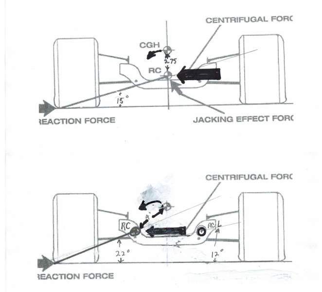

I will try to better explain the importance of Roll Center (RC) offset since I have had a lot of private messages about this.
Some of you are harping on my over zealous fixation on knowing where your Roll Center is on your race car. My answer is that if you do not know, you are only band-aid racers and the path to victory lane will be along hard road. Trying to make a car handle at the track and reacting all the time gets old. You have to be PRO Active.
There is no such thing as "Weight Transfer". The only way to put more weight on the right front tire is to place weight bars on that corner. Everyone uses weight transfer but what really happens is the car has Momentum and Inertia. Momentum is defined as the tendency of a body to remain in motion. In simple words, momentum is your force or speed of movement. Inertia is defined as the tendency of a body to oppose the change in its position. In simple language, inertia is what keeps you going. Both of these are lumped together time and time again. Think of momentum as a straight line force that resists change in direction. So this fictious "weight" is traveling in a straight line until the car hits the corner. This force is then countered by many things like ARB (sway bar) and the cars springs, tires, Track surface. So I will continue to wrongly use the term weight transfer for the remainer of this discussion.
Rule number 1 – In a turn we have to deal with weight transfer. We can not change this fact. We can only control and direct where it is going. This weight transfer consists of lateral weight transfer and body roll. If we cut down the amount of body roll we increase the amount of lateral transfer and vise versa. Both must add up to the same total regardless of proportions.
Rule number 2 – We need vertical load on the right front tire to properly turn the car. Top illustration shows stock car production chassis as it came off the production line. Pretty good compromise for grocery getter. RC is stock height centered and 2.75 inch from the Center of Gravity. Note that 50 % of the weight of the sprung weight will transfer through the RC. This transferred weight is in the form of lateral weight transfer ( large black Arrow) and body roll of CG thru the 2.75 inch lever.
Lateral Transfer – The large black arrow is pushing straight on the RC which in turn is pushing straight through to the tire contact patch and to the track at a 15 degree angle.
Body roll transfer – We also have weight transfer due to body roll acting thru a 2.75 inch lever which will slam this weight onto the right front tire increasing traction.If everything was left the same and we lowered the RC height but kept it centered, we would have a longer lever between the CG and RC. We would need stiffer springs to counter the roll. We also would have less than 15 degree angle from RC to tire contact patch and would lateral transfer would be less.
Bottom Illustration shows effect of RC offset 3 inch to the right of the car. Now 55 percent of the left side sprung mass is transferring through the RC. We have increased the distance between the CG and RC. So we have more weight being transferred through a longer lever to the right front tire.
We have increased the angle of transfer to the tire contact patch to 22 degrees. This means we are more effectively countering the lateral weight being transferred and we have less lateral weight being transferred and more roll weight transfer ( longer 4 inch lever). Don't forget, both must add up to the total sum of weight transferred. The right front corner will “ jack up” on corner entry.
If we offset the RC too much to the right we will be carrying the left front wheel through the turns ( old sprint cars ran on three wheels most of the time).
If we have the RC offset too far to the left we don’t have enough body roll to stick the right front tire. The angle between the RC and tire contact patch is 12 degrees which means we should have less lateral weight transfer than the stock set up but we do not. Only 40 to 45 % of the sprung weight will be passing through the RC. Not enough to stick the right front tire and we will be shredding the right front tire tread because too much weight is LATERALLY transferred. We we won’t have enough lift on the left front tire to hook up the right rear tire on corner exit. Car will push going in and be loose coming off.
Summary – We need to lower RC that is offset to the right side to kill off jacking effect and reduce camber build. This means a longer moment arm from RC to CG but we can use the body roll transfer to properly plant the right front tire. Too stiff spring rates, huge ARB and the use of bump stops turn the car into a giant Go Kart. Wrong move. You need some degree of body roll. As with everything in racing, it’s a compromise.
