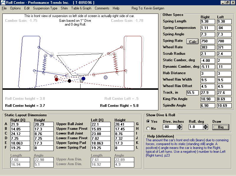

  • #309
Here is info on Street Stock class round track car
3100 pounds, full size 76 Impala front and rear
50% rear weight, 60% left side with 58% cross weight
82.5" LFT rear tire, 85" rt. rear tire
A-Arm and coil spring frt. 64.7 inch track, 1.5 degree camber over 3 inch
Lf ft 900# rt ft 1000# springs
rear has panhard bar 61" track width
Lf rear 200# rt rear 175# spring
Ft RC is about right height but we have not offset it to plant more weight on Rt ft to help steer thru the turn
Performance Trends is software..nice packageif we raise the right top ball joint to 20.9" the RC moves 3.0 to the right but is now 3.3 Inch height
If we lower the left top BJ to 2.8 Height the RC is now 3.3 inch to the right and 2.8 inch height and we improve chamber ( less gain)

  • #310
I was just playing with the same software...lol
Seems Iwill have to raise the upper ball joints and inner moumts to get what I want... (Or what I think I want...lol)
How do you feel about upper control arm angles? Better to keep the shafts perpendicular to the centerline of the chassis or match their angle to the pivot angles of the lowers?

  • #316
wow... the RC sure move around a lot when the car dives and rolls...
It seems to want go to the left side... is this bad? Compromises as usual...
My suspension actually measures very close to the demo street stock...
So, since I can only move upper mounts, should the roll center be calculate with the suspension at rest, or while down and rolled?
Starting to think that drawing the lines on the floor might be less time consuming...lol

  • #318
rick..excellent point..you nailed it..In my haste to post a reply, see post 309, i did not do a good job following thru..I assumed the post i did on the RC location was for a car that you could tweak to keep the RC close to its static position..the migrating RC has always been a problem..but..in my opinion. if you can keep it some where to the right side and reasonably low during first inch or two of travel..you will put enuff load on the rt ft tire to turn the car...
...the set up you have, if it is like the attached, is pretty good for a stock class racer..about as good as you can get on the front end restrictions the rules dictate..
RC ends up about 2.1 from ground and 5 inch offset to right in 2.8 inch dive...not too bad
you are far more better off with this set up than the guy who starts out with it centered and high and it moves to the left when in dive
