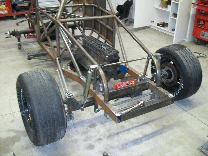

Hello
Several months ago, I started reading many posts from the race car suspension class trying to get answers on how to make a late model perimeter asphalt race car driveable on the street
I have to blame myself for once again letting my long time friend Larry talk me into another great idea which at the time, sounded pretty cool but had I known the grief combined with literally 100's of hours and several thousands of dollars down the drain, I would have told him to tell someone else
I know there is a lot of knowledge regarding physics being applied in this forum because I have read many posts and have learned a lot, but I am at a point where I can't go any further without asking some questions regarding these suspensions direct
I have the chassis symmetrical from centerline now with matching upper and lower control arms in place with a set of tubular spindles from the car that had different king pin angles that I modified to 10 degrees and 9-1/4" tall that is the norm for road racing asphalt cars
The new arms have a 20 degree inclination due to the tall spindle and the ball joint comes into the top of the spindle close to 90 degrees and what I can't figure out is how that would be done
I've looked at some pictures and you can clearly see the top ball joint area is flat instead of at an angle and looks to be square to the spindle pin
Probably something simple, but I'm toast and can't think straight
Thanks for listening
  • #1,311
Actually, your present situation is pretty common to that of a racer after a serious hard fought race season. Car is banged up pretty bad. Frame in question. Do I rebuild it or sell it and get a straight chassis.
you sunk a lot of green into the present cluster fake. Regardless of how you got here, you are here. Spend the money and buy the chassis suspension software that can help you.
The software will save you hours of trial and error fitting different A-arms and measuring.
then you can see where you are and map out a logical path to getting the car in shape.

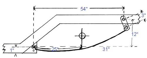

hey there everyone, been on this forum for some time now, lots of good information, i love it. now for the question, Ranger Mike or anyone with some good insight. I run a super stock car at a 1/2 mile track, been at same track for a lot of years, car specs below
3100 lbs 55% left and 48.5% rear stock front lowers and tube upper A arms
Have a decent handle on the geometry and such (performance trends software)
without going into huge detail, full tube chassis with modified front camaro clip, we were one of the only rear coil cars in the field and they made us switch to leaf.
have had some good runs but car could hook better out of corner. i am not the driver but owner / chief
lf 550 rf 600 ( large 1 1/4" bar ) soft set up but not to soft
lr 200 rr225 Hoosier tires
temps
lf 145 av rf 198av
lr 166 av rr 190 av ( higher some days) spin off corner, lots of driver induced
the real thing i am asking is short shackles and lots of lowering blocks or very little block and longer shackles, it seems that they are using lots of blocks and making spring deflect of help limit wheel spin then as spring moves back to unloaded the car is straight and able to use all the pedal, or am i completely out to lunch? i currently have in the car less block and longer shackle set up, it seems i need to change those longer shackles are starting to bend a bit even tho they are 1/4 thick. please advise
thanks in advance
  • #1,318
Good to hear from you. I have to dig out my old notes as last leaf spring car was old Plymouth Baracudda.
Tire temp averages look like rt ft to lft rear avg. = 182
Ft avg is 171
Rt side avg is 178
The diagonal avg should be 6 to 10 ° cooler than either of these and it is not. Indicates too much cross weight.
RR to Rt ft temp avg should be 10 to 15° cooler. It is borderline.
The lft ft avg should be 10 % cooler than the rt ft avg. NO way. Lft ft not carrying its weight. Way too cool.
Shackle- we want the shortest possible shackels we can use. This prevents lateral distortion between the spring and housing.
You want the rear spring eye to be slightly to the rear of the frame shackle hole. It is acceptable to have it directly under the frame hole but slightly angles is better. You need this to prevent suspension bind.
One thing to measure is to see if you have rear steer. How much and is it rear over steer or under steer?
How you mount the springs relative to the track will make big difference

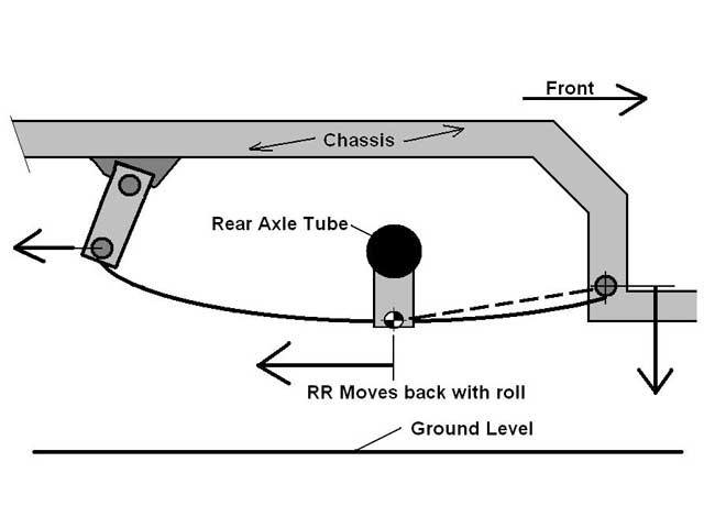

  • #1,319
Thanks for the insight on the shackles, have them with front spring eye up 1 inch from parallel to ground and long shackles in rear, took easy way out by bad advice and time in off season was short from the time they outlawed rear coil in our division. rear eye are splayed outward from lower eye by 1 inch each side, so to act as at trailing arm, i saw slight offset / twist in long shackles on both sides and knew i needed to do something to help, right now it is easier to do the work with the fiberglass body off, thank for the insight, 20 years of racing coil springs and forced to go back to leafs was a kind of kick in the pants. any other thoughts please feel free to tell me, never to old to keep learning
  • #1,320
shawn, i do not like the splayed setup as it will produce different arc movements. I recommend parallel mounting. Put some rear roll over steer int he car to help it turn. Get the front roll center offset correct. Shackle twist is not foe the competitive racer. We want clean droop and no bind on left side, smooth compression and longer wheelbase on the right rear.
  • #1,321
with no splay does this not allow for lateral movement when in the turns? not allowed a panhard bar or such, or will that be reduced when using the short rear shackles with near zero deflection, like i said i am learning this design as i go, please be patient, pic below is similar set up except for upper frame rail/ tube is very high therefore long shackles, and top view came from someone who raced in my division and he gave me this to go by...did i get hosed a bit? HAHAHA
  • #1,322
Before you do any changes, bench mark the car and see exactly what the wheel base on each side does at max left side droop and max right side compression per your shock bump stops. once yo u have this then you can start to record changes as you make your adjustments. Again, i am not an expert on todays trends so i like things straight, parallel and moving in two axis arcs. To me long shackles are not the hot setup. short thick shackles are the best.
In the case of leaf springs, twist is very bad as it changes the spring rate of the spring. Also any non square mounting will effect the spring rate as the spring compresses and droops. We want maximum tire contact and the link below is truly is the hot setup on this. Do not forget, a little rear roll over steer is very useful. great videos below

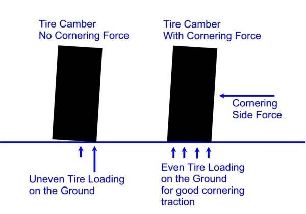

  • #1,326
Shawn
In racing it is all about tires, Tires, TIRES. The rules say you must run leaf springs but no monoball mounting. You are stuck with stock parts. Looking at the track transition diagram below, we see the distance from turn in (yellow to blue) to gentle acceleration is a very short distance but it is the most critical distance you encounter 4 times a lap. (ok i know they are turning Right but you guys are smart enough to hang with me on this) We will concentrate on the rear tires only during this discussion. This short distance is unique because it is when we have maximum left side droop and maximum right side suspension compression ( max bump/droop). If we were to set up the race car statically, to replicate the maximum right side bump travel and maximum left side droop (max bump/droop), we would be a lot more competitive than the other race cars out there. Since we can not use monoball mounting devices to self-level the suspension to the track surface, the next best thing to do is camber the rear end housing to be “ level” to the track surface when it really matters.Let’s look at what happens to a tire when you set it up so the tire tread is on the garage floor and you grab both sides and slide it. Viewed from the driver seat. Note the red chamber thrust arrow is the track gripping the tire. The race car is pushing the tire to the right can the tire tread bulges to the left side. Not the ideal tire contact scenario, right? When we bend the rear end housing by heating the top of the axel tube, the negative camber we build into the housing will apply downforce more perpendicular to the track surface and we have better tire contact.
You can run 1.5 ° negative camber in a Ford 9” differential reliably. A floater is a lot better and you can add camber snouts and 2 ° is optimum. Is this cheating? Well factory specs for the rear end is + 0.75° / 0.5° per side so yes , you can run camber legally. Herb Adams book “Chassis Engineering” has a great read on adding negative camber on page 81. When you go over 1.5° you had better run crown tooth axel splines and not the normal square tooth. You risk tearing up the differential mating teeth over time. Think of the Allen wrench with the little ball end on it.But wait a minute! When we are at maximum droop and bump we really need more than 2° camber! Like all things in racing, our setup is a compromise. Looking at the transition diagram, we are at max bump/droop at only one point in the short distance but we are at a point where 2° camber will greatly effect handling at two points. One point is the lead up to max bump/droop and the point just after max bump/droop. Another critical factor is the fact that we will be running on less than 100% tire contact patch racing down the straights. See final photo. Viewed from the front looking to the rear of the car. Since it is all about lap times, I am for a handling car that maybe a tad slower down the shoot but quicker to the flag stand!

This car is a metric chassis w stock rear links and ford 9".
We are only allowed 3 holes on bottom of rear end for adjustment. W 3 inches from axle tube being furthest measurement .
That huge amount of rear steer is used in mods and latmodels. And yes, as a former driver of a mod, it was a huge factor in going fast.

Ok Street Stockers, I am not an expert on this series having never raced it. The closest was Hobby Stock class where we had a whole lot of latitude in car modification. Raced a 64 Ford 390 and was a blast when I was 15.The Street Stock class is very limited on modifications you can make LEGALLY. Most rules cover Midsize Metric cars made by GM from 1978 to 1987. Monte Carlo, Chevelle, Camaro, Firebird, Nova, Malibu, Cutlass, Grand Prix, Regal. The Full size Metric cars are Cadillac Impala, Caprice. Can be a good choice but so heavy not worth it on the crummy spec tires we have to use. We will concentrate on Monte Carlo and the Camaro.To win we need a very good edge and the front roll center is the number one thing we can change to give us that edge. We have to relocate it and make it work to plant the hard spec tire so the car will turn.
A subset of this is the camber build for optimum tire contact patch. Once we rework the front suspension to get these two we are on the way to max handling Street Stocker. These modifications are labor intensive but pretty cheap compared to dollars spent elsewhere.You need chassis software. Buy it. Map the front end and find out what you have with Roll Center location. Do not pass GO and collect the Win $$ if you are not doing this.
When you plug in your stock chassis numbers in the software program you will to find the present Roll Center.
Next you need to start gaming the software by changing BJ heights and locations.
Two things we need to know. Lower A-Arm lengths and spindle height. It is assumed the rules let you use aftermarket ball joints and aftermarket bushings in the A-Arms. It let's you use custom Upper A-Arms as long a location is stock. Let us assume you have the talent to ream out taper holes for bigger tie rod and ball joints and i assume you can modify the drag link to get proper bump steer. If you do not know how, learn to or be happy with being a back packer. Racers are innovative mechanics, not part replacers!GM short light metric spindles that came on all midsize GM cars from 78-87 and 2wd S-10 trucks are 7 ½” tall and these spindles have 4 3/4 bolt pattern and 11” brake rotor.
All of the short spindles dimensions are same relative to ball joint location and tie rod centers. Pay attention to the differences in outer bearings depending on what year and model. Tie rod taper may not be the same so ream it.All of the Full size Metric cars have the 5 on 5” bolt pattern and 12 inch rotor. Came on heavy duty applications like limos, station wagons, and mid-70s full size cars like Cadillac Seville , Fleetwood, Buick Riviera, Oldsmobile, Pontiacs Chevrolet, Buicks.
These are way too heavy sprung weight and not worth the effort.The Chevy Impala spindles are the " hot set up " on a mid-size metric chassis. Big Chevy Impala and Caprice 1980 to 1990 full size metric spindle is 8 3/4” tall used 11 diameter brake rotor on 5 x 4 ¾” bolt center.
Options I found are Ford Granada, Mustang II , Ford Pinto spindle is 7. 625” height. These are E mod options not recommended for heavy Street Stocker.Let’s look at a 4th generation 1981- 88 Street Stock 1986 Monte Carlo.
Stock chassis suspension mounting points front and rear, stock lower A-arms. After market upper A-Arms.
We add aftermarket longer ball joints in lower A-arms to raise the spindle .75" and we add longer upper ball joints to add up to an inch more height to the upper tube A-arm. This raised the front Roll Center to about 3 to 3.5 Inch we wanted but only moves the RC to the right about 1.5 inch. We need at least 3 inch offset to plant the right front tire.
The other factor was our camber build curve was pretty poor and bump steer needs fixing. The car is drivable and a lot better than the way it was but not as good as we can make it with these lame rules.Lets look at a project car in Steve Smiths books “Street Stock Chassis Technology”. Stock 1978 Camaro has front Roll Center of 0.487” above the pavement. Bad negative camber gain 2.9° in 4 inches of bump and neg. 1.17° in 4 inch rebound (droop).
Bump steer needed work too. After lowering the car 1 inch and adding 1” longer ball joints to stock Right side upper and lower A-Arms the RC was 2.75” height and better camber change. Next the right front lower BJ was moved out ¼” and the left lower BJ was moved in ¼”. Lowering the right front upper A-arm inner pivot points .5 inch each and lowering the right front tie rod end down 1 inch got us front RC of 3.375” height and right front camber gain is 1.47° per inch. They added a taller AFCO lower ball joint on left front lower A-arm to put camber gain in ball park, We still have bump steer to fix and need rework drag link and the front Roll Center location is left about 3 inches. A lot better but not as good as we can make it with a little more work.Goal – move Roll Center to 3 inch height and 3 inch offset to the right (paved track) 4 inch offset to right on dirt.Looking at the stock A-arms on GM metric cars we have 14.25” length from the frame mount to the ball joint center, this is for 1978 and up GM metric cars like Monte Carlo,
1978-1987 Metric Impala lower control arms are 16” length , 15.31” wide and these work on 73 to 77 Chevelle, 70 to 81 Camaro and 75 to 79 Nova.
1967 – 69 Camaro, 1968 – 1974 Nova lower A-arm is 16” length but 13.25” wide.The Nova lower A-Arm conversion on a Metric car will move the lower ball joint out 1.75 to 2 “ and forward 1.5" to 2" to correct camber gain. You will make the front end wider by about 3 inches. You need a full custom upper A-Arm with adjustable upper A-Arm screw in ball joint or similar. It is possible to retrofit the Nova 16” center to center lower control arm to a Metric frame using proper control arm bushings. You will need to modify and change several things on your car to use these. These control arms use 5" OD springs, longer tie rod ends (which get very close to the control arm. Use custom fab Upper A arm as the typical metric upper control arms will not work. The stock Metric ball joint cannot be used with this control arm so reaming of the spindle for different upper and lower ball joints will be necessary as well. Installing these control arms on a Metric car is a complete front suspension redesign and certainly not a bolt on swap. Be prepared to move the lower ball joints toward the frame or away from the frame before you weld in the screw in ball joint thread ring.
Finally, you need to use Impala spindles to compete the camber gain and end up with the 3 inch roll center offset. The 1 inch taller spindles mean you can run level lower A-arms and angle the upper A-arms for the proper RC offset and still have good camber build.Tips for the metric rear end. Figure out how to put some rear roll over steer in the car. You want the wheelbase to shrink on the left side and grow on the right side when the body rolls in the turn. Start with left lower trail arms a little uphill on the low left side and right side level. Soften the bushings in the trail arms so the left side moves forward and the right side moves to the rear. Rubber bushings can be drilled so they collapse in the direction you want. The rules may say you can use metal bushings here but the obvious advantage means you use rubber bushings. Put in 5 to 8 ° pinon angle down.I might have missed something in the research but this is as good as I can do without building one in the garage.
