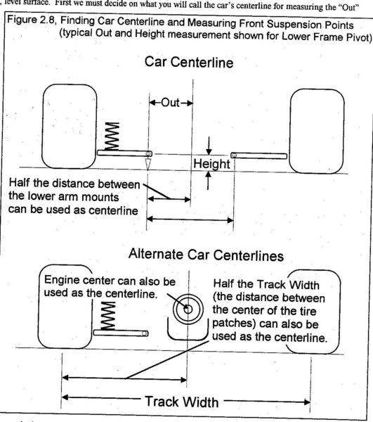

With the off-season upon us and time to make our cars better, I have a question. I have and will again measure my front to plot out the roll center in hopes of improving our performance. But before I embark on that task I have a question concerning determining the correct center line.
When laying out for the roll center should I use half distance between the frame rails or the midpoint between the tread width. When reading through the posts here I have seen both mentioned but not in a clear manner to understand the correct method. The reason I ask is we have a asphalt modified and not only is the chassis is offset several inches the wheels differ in offset by 2+ inches.
We also have different length lower control arms to compensate for the chassis and wheel offset. I am trying to get the most accurate determination of the roll center and make the car better for 2019.
Thanks in advance
  • #1,376
I always used the center line determined from the lower inside A-arm mounts and painted a center line on the bottom of the frame and top at several locations. This was done with the wheels and A-arms off the car when I was going thru the rebuild process annually. I liked to see just how much offset the car really had. Real easy to do if the air cleaner center bolt is sticking up like a flag on Iwo Jima up and the center line is 4 inch to the right of it!
I always put a piece of roll bar foam over the top side marking. Just paranoid crew chief thinking I guess.
Another advantage is the center line travels with you and can be used to rebuild the car at the track if you wad it up. Down side was that a sharp competitor could see this too if he got close enough while the car was in the pits. The Track width method is ok as well but remember to set aside a complete set of tires and wheels marked SET UP so you will have the same set up each time.

Thanks Ranger Mike, To me it was the most logical place but in seeing other references I was wondering if I was ding it wrong. As always great info here to keep referring back to.

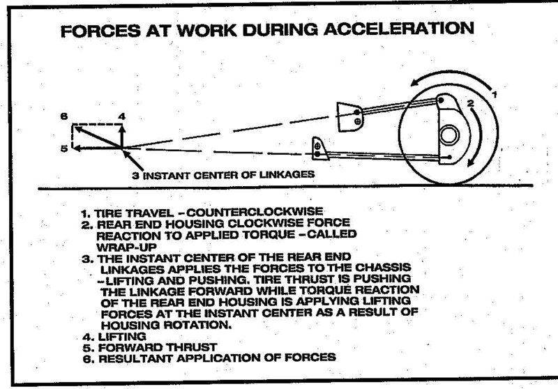

  • #1,379

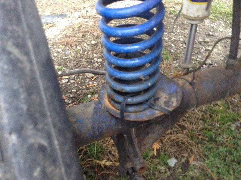

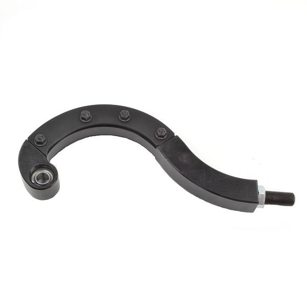

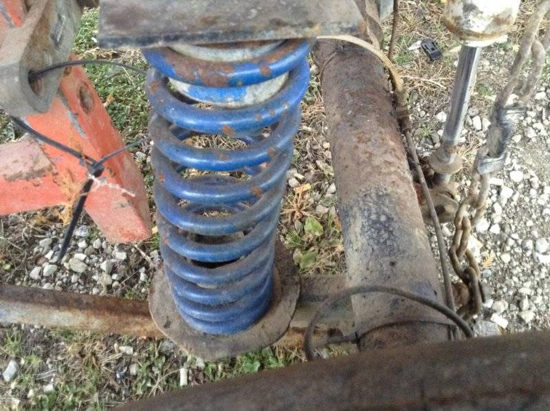

Hello, name is jc. I have a question and I’m hoping Someone can possibly answer. There are these new trailing arms for a 3rd link setup. And they are the center pull style that mount to the back side of the rear end housing. A few guys run them and basically say that the forward bite is great. So my question is why is the center pull so much better then the traditional trailing arm mounted with the shock on the bottom, any info will be highly appreciated.
  • #1,380
do you have a manufacturer name or website i can look at? I assume you are NOT talking about the top link. you are talking about the traditional truck type trail arms that are made up of threaded tube and two rod ends. And the new style has a spring that compresses built into the trail arm
  • #1,381
No I’m not talking about the top link. But yes to the truck arm style. And I know about the spring loaded ones but this goes over the rear end and mounts to the back side. Mainly made by port city. Here is the link to the website. https://www.portcityracecars.com/Center-Pull-Rear-Suspension/ also a picture https://goo.gl/images/g5VFNy
  • #1,382
Josh ,
Good catch on evolving technology. There are a few definite advantages for this J-Bar rear mount linkage on the asphalt rear suspension. I think 1962 Citroen 2cv pioneered this rear suspension with the rear mount concept to the point of actually mass producing it successfully. Note attached diagram for the Paved Track Stock Car Technology by Steve Smith. Every racer should have a copy of this.
  1. It is easier to pull a chain then push it. This means pulling forces are easier to manage then trying to control the same forces pushing the same load. Looking at the typical 3 link suspension we have a single top link being puller as the car accelerates. The two trailing arms are pushing up on the cars suspension. The trailing arms must be beefier much the very nature of the forces they are dealing with. The mount location of the top link is critical as it must be mounted at the proper location proportional to the percent left side weight for maximum traction.
  2. The J-Bar mounting handle force vectors twice as effective as you have two links transmitting the pulling force instead of just one top link. These two links offer a lot more adjustment and chassis tuning.
  3. Braking may suffer but in round track racing, braking seldom wins races, acceleration and traction does. Road course racing usually means you have one maybe two places on a 12 turn track to PASS but many opportunity’s to out brake the other driver. I doubt braking will suffer with this J-Bar suspension.
  4. It is indeed quite curious that the aluminum J-bar style mount has metal housing surrounding the J-bar. Speculation and rumors will abound I suspect. Could there be a compression spring device hidden? Could the wheel base actually be changed under acceleration because of this? The verbiage in the catalog says “This Style Allows You to Run The Trailing Arm Behind The Axle Tube For Less Roll Steer” and some cynical crew chief may take that to mean you don’t need STATIC roll steer with this device. But you can take out all the rear steer in the traditional 3 link set up. Hhmmmmmm?

Ranger Mike and all other members of this very informative thread I would like to say thank you.
I just picked up a mini mod that I'm going to go threw from front to rear , top to bottom.
The car has gone threw 3 to 4 pit crews , so it will be interesting to see what has been done to the car.
It has a 3 link with j-bar located to the driver side.
Rack pin steering
Double A arm

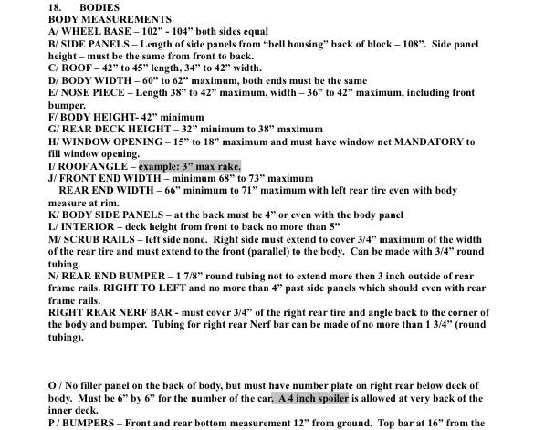

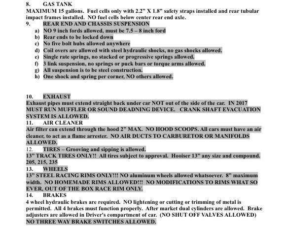

I have cut out a few of the rules specs for review
I can get measurements in feet of the tracks corners and the one straight. Track is in the shape of a D
I also have located an excel spread sheet for your review
http://www.super7thheaven.co.uk/wp-content/uploads/2014/09/SuspensionCalculator.xls
This is my winter project . I'm in the process of stripping the car down.

welcome wwillie
you have a good start to a winning ride
Likes Wild Willie

Another question ,how does off setting the rear coils effect turn in , if RR coil is mounted atop the axle , LR mounted 4 inches out front of the axle and down one inch.
  • #1,395
Here's how they have the rear coils setup

  • #1,398
Mike I got informed by one of the builders that rear coil setup was, to put the weight back on the LR faster
  • #1,399
WWillie
The longer the rear suspension Instant Center lever is, the less geometry error introduced due to the arc swing. Longer means less arc movement and more stable cornering.Anti-squat is the linkage taking up rotational movement thru the linkage and adding traction.
No anti squat means the springs will take any front to rear “ weight transfer” until compressed and we go to the drag racing funny car status of no anti squat and wheelie stand.
Read post # 314 on page 16 and post # 327 on page 17 before proceeding. Anti-squat is expressed in percentage. 50% anti squat means 50% of the rearward Pitch or “ weight transfer” is handled by the 3-link set up you have. 100% means 100% of the pitching or weight transfer is handled by the linkage and the body is actually lifted (wheelie time). Percentage is figured as the distance of Center of Gravity (COG) is compared to the Instant Centers location. Do not that the other point of origin of the IC is the tire contact patch. The COG perpendicular bisector to the pavement is crossed by the IC vector and gives the % anti squat. In the case of Duke Southard diagram from “Short Track Chassis Set-up” we see 20% on the 3 link figure #2.
I always used the camshaft center line as a good approximation of COG and worked for me. Production cars usually have COG between 20 and 22 inch above ground level. Round track cars will have it 18 to 20”. Street stock metric cars that have been worked over and lowered have 16.5” COG and super late model dry sump outlaw cars can be as low as 15” COG.
On our Formula car we ran low % anti squat mainly because the independent rear end was not the solid axle that you have, but has independent springs and swing arms on each side.
The rear pitch would load the individual springs unequally and the tire contact patch could shrink due to camber change. You do not have a lot of options on long links with these cars so 15% is huge.
Add to this the very low COG these cars have, and you are limited to % anti squat.
Likes Wild Willie
