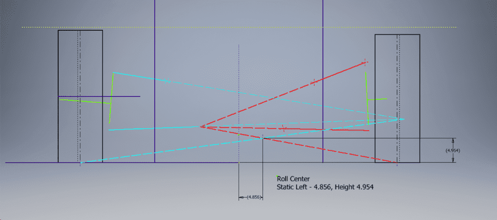

the photo of the car and tire temps all point a classic push going in-tight off condition. Where is the front roll center height and offset?
  • #983
Roll center is 3-3/4" above the ground and 1-1/8" to the right.
  • #984
the front roll center needs to move to the right two more inches. There is not enough down force on the right front tire with current position. We need more down force to increase traction with body roll. The right front is plowing and the rt frt spring is too heavy. The left front can not lift under acceleration to plant the right rear tire. So we have a push going in lose off condition.

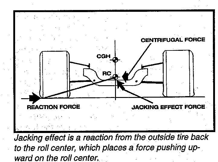

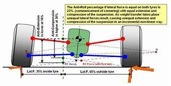

Can someone explain why a vehicle's roll center axis is typically not HIGHER than the center of sprung mass?
Can we discuss some advantages and disadvantages in designing a race car with the roll axis higher than the center of sprung mass?
Thank you, in advance.
  • #992
welcome goneracin
pls see page 12 post #229
RC over the COG ..not a good idea
  • #993
Thanks Ranger Mike.
I have read the post.
The part I am having difficulty understanding is, "If the roll center goes over the Cg, the chassis will actually "jack down" and start to roll to the inside of the turn."
Why would this be a bad thing?
Please note that the roll center would always be higher than the Cg, not "flipping" over the Cg.
Thanks again.
  • #994
When the RC is intentionally over the COG you have just turned a cars suspension into a very smooth riding Go Kart.
The lateral force is shearing the tire patch and not being scrubbed off in a controlled manner with the cars suspension springs and dampers (shocks).
Yes, the body rolls, and compresses the springs ON THE WRONG SIDE.
You are helping to plant the left front tire and unload the right rear tire in a left hand turn. Pushes going in loose off the turn.
The ‘”hot setup” on short track cars is to offset the roll center to the right (below the COG) so the body roll produces download of the right front tire and increase grip of that tire. It should be the hottest tire temperature on the car followed by the right rear tire, lft ft, ft rear tire.
If you did have a super sticky tire on the right front that could handle all the lateral shear force because the RC is so high the angle of jacking force from the RC to the tire contact patch would be 55 degrees and you would lift the left front tire.

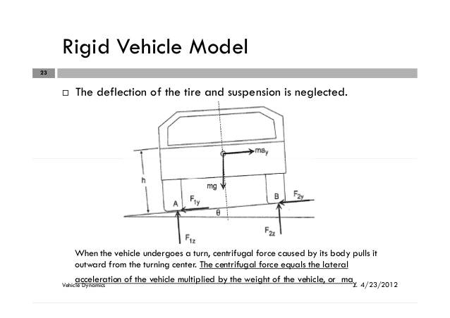

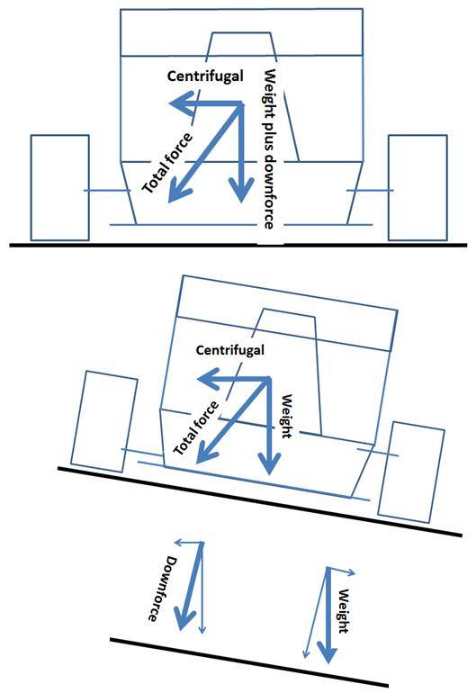

Let me ask a similar question, but in a different way.
Most of the textbook examples of roll couple distribution, roll axis, etc. assume the the roll axis is centered and the chassis will roll toward the outside of the corner.
Now, knowing that the roll axis can be offset and that it moves dynamically, it seems that it would be possible to roll the chassis INTO the corner. (Similar to a motorcycle leaning INTO the corner.)
An example would be a circle track car with a low Cg and high left side weight % on a very high banked corner with stiff springs on the right side, soft springs on the left side and a roll axis located near the right side tire contact patches.
Certainly this chassis could lean INTO the turn and not roll toward the outside.
It seems to me that there could be some advantages to leaning the chassis INTO the turn.
What would be the disadvantages?
  • #996
My assumption is that it is easier to explain these chassis dynamics with a symmetrical set up. Laziness on part of the books author.
A motorcycle rider can shift his weight ( COG) to counter the effects of momentum ( in this case cornering force). A race car can not shift its COG as it is fixed.
A circle track car with a low Cg and high left side weight % on a very high banked corner with stiff springs on the right side, soft springs on the left side and a roll axis located near the right side tire contact patches WOULD PUSH LIKE A FREIGHT TRAIN.
Certainly this chassis could lean INTO the turn and not roll toward the outside. YOU HAVE TO HAVE GRIP TO DO THIS AND YOU WILL NOT WITH THIS SET UP.
It seems to me that there could be some advantages to leaning the chassis INTO the turn. SUCH AS?
What would be the disadvantages? NOT USING THE SUSPENSION TO HANDEL THE CORNERING FORCES TO THE DRIVERS ADVANTAGE.
I think you have not grasped the basics of handling regarding a left turn race car. Some how you got it in your head that a car will handle better if the chassis leans to the inside on a left hand corner. Take time to draw the force vectors and you will see this.
  • #997
Hi Ranger Mike.
Yeah, I guess your right.
It was just more of a thought process, for me.
I had been told that the car would ALWAYS ROLL and we had to deal with some of the associated "disadvantages".
I was trying to think of a "new" way to get the car to lean into the turn by moving the roll axis.
