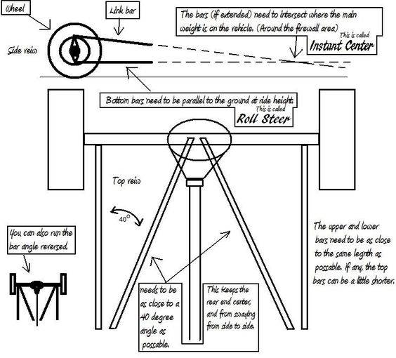

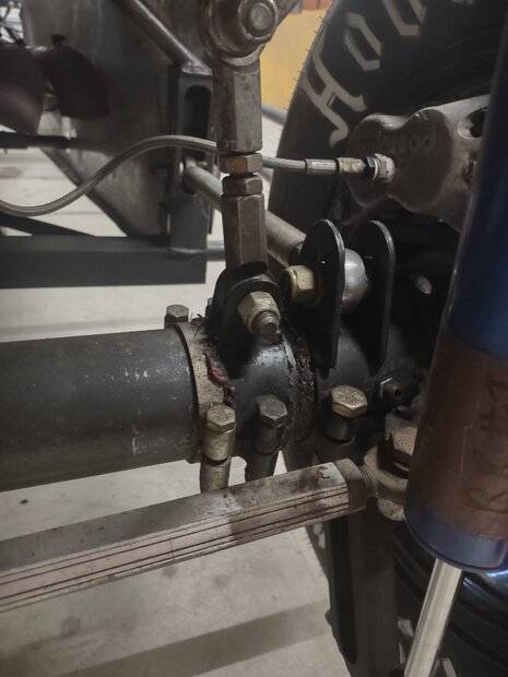

Outlaw, This is what we did , probally different rear than yours but hopfully it may help.

I sincerely thank you both..please let me work up a teaching point from you racers but you both are sure as hell going to the winners circle soon!

  • #1,604
Thank you Racerman,,exactly what I was talking about! 3rd link properly connected. Good job!
Why is top link mount so critical?
The top link is the rear end link that pulls the race car. This is why the spring type top links have a compression spring to lessen the rear end loading when you get back on the gas at corner exit. This top link directs all rear end force to the chassis. The rear tires grip the track and try to pull the rear end to the rear as the trailing arms on the bottom push the car to the front and try to climb up under the car.
Why location matters- In road course car set ups you want everything set up 50/50 % weight bias, so all front tires scale close to equal and the rear end tires scale equal.
Not so on left turn racers where you want a left side weight bias. When in a turn you want the left side weight rolling over to the right side to assist the car with better traction (tire grip).
Correct location of the 3rd link mounting is a real help so the tires are pulling on the third link equally otherwise when you step on the gas, one tire will bite more than the other and shoot you toward the outside of the track or the inside.
Think of a shipping pallet on the garage floor. You hook a chain on the pallet , not at the center but a foot to the right of center. Now pull the chain, The pallet will cock to the right.
The pallet example is a way to show that you must hook up a locked rear end so both tires bite the same. The pallet example above shows that the right side moves first because there is less weight on that side. Remember down force! We do not really cock the rear end but what really happens is more force is added to the side of the car the link is closest to. In this case we have more force added to the left rear tire ( same as adding a lot more wedge) so we create an off corner PUSH condition.
If you run a 10 year old chassis check the 3rd link mount. When it left the chassis factory back in the day the car was set up with about 52% left side weight. Today you may be running 58% left side weight. This means you can be 2 to 3 inches off the correct location. It is so easy to cure and eliminates one huge rear end traction problem, so fix the 3rd link mount. So screw the chassis builders old specs. They are no longer valid as the chassis has been hacked on so much over the years.
So you need to mount the top link as my post 81 on page 3, post 253 on page 8, post 707 page 21 show.

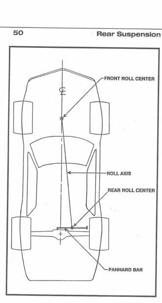

@Ranger Mike
I've looked( and probally missed it lol) but could you tell me your thoughts on a panharb bar running from left rear just inside the wheel and about 2 inches infront of the axel housing to the right side chassis about 10 inches in front of the axel . So roughly 8 inches forward on the right as compared to parallel to the rear. I have seen this on a few pavement oval track cars and have thought it may give added bite on throttle.

  • #1,611
RAceman
A level panhard bar ( same mounting height on both sides) means force is vectored laterally to the tires. Any angle up hill to the right rear will cause upward force on both tires and unload both tires. Now you have to compensate with spring change. A 1/2 inch height change from level can make significant handling changes.

@Ranger Mike ,
What I was refering to is acually being forward on the right side compared to parallel with the rear on both sides. Most of the panhard setups we have run are infront of the rear equallyon both sides and some of the new cars have the right side chassis mount ahead of the left rear mount that is on the axel housing by 8 to 12 inches and they run it with a j-bar.
Thanks !!

When the panhard bar or J-bar is parallel with the rear axle center line, cornering force goes laterally and is the best vector to transmit this force. Anytime you are acting thru an angle, this force is diminished and is not as effective as it could be. Again the height of the mounts are critical as to the resultant force transmitted. A difference of heights can help or hurt rear traction.
I can think of one advantage to use this angled set up. Look at the attached drawing. Think of the wood box and the chain discussed above. The body will be pulling on the J bar when cornering as momentum causes body roll. The tires are sticking on the track anchoring the car. When the J bar is parallel, the force is directed straight to the tires.
J Bar mounted at an angle -
What happens to the rear end when the J bar pulls on the rear end mounting bracket attached to the left side of the rear end housing? It will pull the rear end into rear over steer. If you have made provisions to accentuate this (slotted the mounting brackets or put a spring on the trailing arm) , your right side wheelbase will lengthen and the left wheelbase will shorten up. You will be able to maintain tire contact better than the other racers going into the turn before backing off.
Remember 1/2 inch of oversteer will change the performance noticeably. A 1 inch change will be a definite edge and is totally legal!

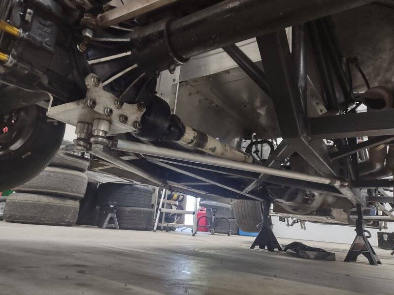

Evening Ranger Mike. I'm using a triangulated 4 link on the rear of my vintage modified. Can you explain to me how changing the bar angles will affect the handling?

This set up has advantage of more lateral support for the rear end. You have vectors acting to each chassis mounting point as well as the Panhard bar. I suspect the pivoting in rear roll over steer will be quicker as the forces are acting at an angle to the lateral forces and not at 90 degrees as the traditional 4 link does.
The upper links can be adjusted same as the traditional upper links are.
see post 132 on page 4 for details on 4 link

Hi Vintage 13! How can you have two points of lateral control, on the center of the rear, one on a arc and one in a straighjt line perpendicular to the bottom of the frame, and not have a bind when it goes into roll, or straight up and down movment?

I don't have a good enough understanding of why it works but it does. The car I copied has won every feature but 2 this year and won the championship last year. The car rolls the center very well and also doesn't have a panhard bar. With this setup I feel the panhard would cause a bind. To me it essentially the same as the A or G body GM suspension that is used in street stock racing. I would love to see it modeled in a software program to see how it actually works

V-13 sorry I thought you had a panhard bar. what is the octagon bar on the right side in your pic . With a closer look I see it is not connected to the frame. Your bottom rods mounted so close at the bottom of the rear is almost triangulated. That would give you a very low roll center, for the rear, that would travel close to a straight line perpendiclar to the mount points on the bottom of the frame. It will move slightly to the right if you have left rear leed and the opposite with right leed. The roll center hight should be at the heims on the rear.
The bar you see is a toe bar to keep the axle tube straight

SDavem- Panhard bar roll center is the center of the bar and is the easiest to tune due to both side mounting point adjustments. You have a small 8 inch tire so traction is going to be everything. The rear roll center is very important here. You need a lower roll center to improve bite. Roll center should be between the bottom of the ring gear (assume Ford 9") and just below the rear axle tube. 10 to 11 1/2 inch is ball park. How much wedge or cross weight % do you have? From your description you have a short panhard bar that will place the rear roll center at a diagonal to the front end.
Note- If your front roll center is located at the center point of front tread width. If it is offset 3 inch to the right side, I try to make the rear roll center offset three inch to the right. If you have the fronmt RC other than described, you must add more spring rate to one side just to compensate the car handling. I personally do not like this as the roll center will not be in line and this adds complexity to the spring tuning. I like a very long panhard bar mounted at the rear of the housing. Longer levers throw much less chassis bind in the setup. Can you relocate? What is the mounting point location of top link relative to the track width? What % left side weight do you have? Photo from Steve Smith book Paved Track Stock Car Technology
