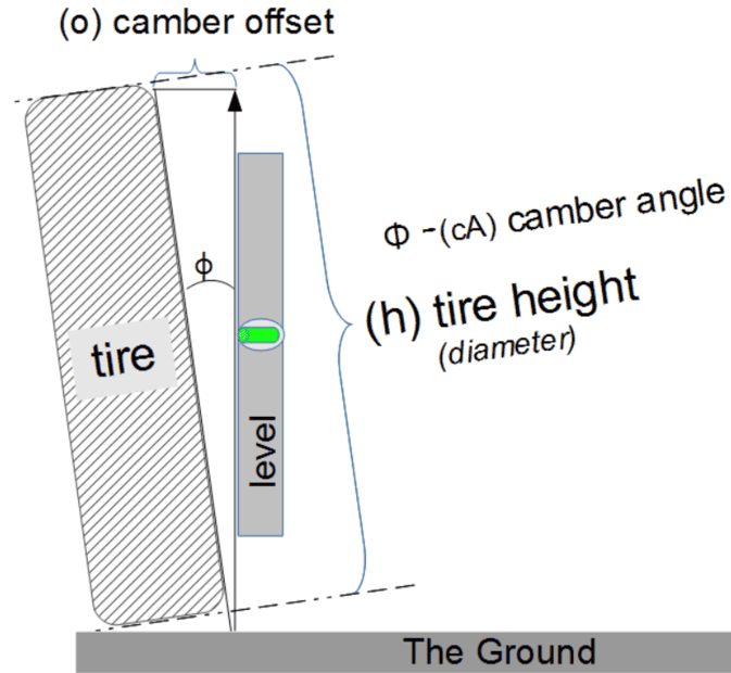

Performance Trends Circle Track softwarte shows -
Camber- We run camber to maintain the maximum tire tread contact patch. Typical front end specs are right side camber is - 3 ° and left side is + 2.5° Static. The old Sportsman class of Chevelle or Monte Carlo cars go to dynamic of -7.5° right and -1.83° left when in 2 1/2 inch dive and 2° roll.
A super late model will have same -3° rt. and +2.5° left static but this goes to -5.0° rt and -.9° left in a 2 inch dive and 2° roll.
Now look at the camber pic attached. I ran some numbers using Hoosier F tire, 8 inch wide and diameter of 27 inch.
1" offset is 2.1°
1.5" offset = 3.1°
2 inch offset = 4.2°
2.6" offset = 5.3°
3" offset = 6.3°
3.5" offset = 7.4°
No wonder these hard spec tires on a Sportsman, do not grip when the car is rolled over. You are only using 4.5" of the 8 inch tire for grip at max dive and roll. Not really since the tire carcass can move some. But what this does do is cause a heck of a lot of heat. And heat kills tire grip and life span. If the tire sidewall flex can be reduced or eliminated we have more grip and a longer tire life.
All the above use short A-arms on top and longer lower A-arms on the bottom. So if you can keep the tires planted with minimum camber change and the other drivers are twice the camber, you have a real advantage.

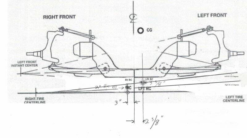

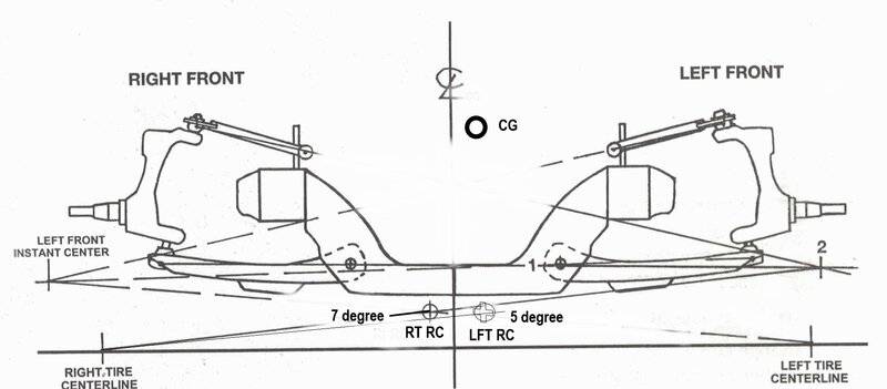

Body roll and RC location
Back on Page 14, post # 479 I used an illustration not to scale but relative to the point. The front Roll Center location matters greatly in the performance of the race car. Below illustration has the RC way up there at about 13” above the track. The Center of Gravity is about 16” above the track. Not to realistic. The pic below is a lot more real world with the Roll center up about 3 inch and 3 inch to the right of center. The CG is offset to the left 1 inch as most rules permit it.
Down force quick tutorial - Take a tire ( mounted on the wheel of course) and stand it up on its wide tread. Now facing the wheel Grip both sides like you are going to put it on the wheel lugs. Slide it on the garage floor. Slides pretty easy, right? Now have Lumpy the fat neighbor kid, sit on the tire and try this again. Sliding a 40 pound tire/wheel was easy but sliding a 165 pound tire/wheel/ fat kid set up is way more difficult. This is what happens when you add DOWN FORCE. More grip.
Increasing the amount of vertical downforce on the right front tire increases the available traction, but in a non-linear way. When you increase loading on a tire, it will gain traction, but not in constant multiples. Adding 706 lbs down force adds traction but if we double it the results will not double the traction. The amount of traction will be something less than 2 times.
Big Bar and Soft Spring setups - This setup limits body roll in an attempt to place more load on the left-side tires, leading to more equally loaded sets of tires to produce more traction. One major factor is to limit the air under the car and kill off lift. Initially when this set up developed ride heights were about 4 inch track to chassis now it is 3 inch. Everyone is going lower. This and a more aero body adds downforce on the car body to provide tire loading. You still need to take advantage of RC location to properly load the right front tire.
Per attached pic note - IT is not to scale so pay little attention to the appearance as it is not to scale but close approximation.
Left RC has a 5° angle to the right front tire contact patch. The Right side RC has a 7° angle. This is the jacking effect that can lift the left side tire if it is great enough. Remember the sprint cars carrying the left front tire off the ground thru the turns. This happens when the roll center is placed too far to the right of centerline.
Note the moment arm or lever length between the CG and the Rt RC are very close, less than 0.40 " inch length.Now let us look at what happens during cornering. Momentum will continue to travel in a straight line until another force changes the direction. In this case the tires will do this through the suspension linkages.
Now let us look at the MASS that will have Momentum and must be dealt with before the car starts pushing like a freight train. Typical Late Model car min wight limit is 3000 lbs.
Of this, Unsprung weight of quick change, coil overs (50% unsprung weight, sway bar (ARB), upper control arms) amount to 400 lbs. We need to handle 2600 lbs. mass.
On a typical race car the front to rear weight is 52-48%. Caution- the calculations here are not going to be accurate but are close enough to demonstrate the need for proper location of the front roll center. In this example 52% of 2600 lbs is 1352 lbs.
This Mass will continue forward or diagonal once the tires cause opposing force on the MASS. One force vector is from the right front tire to the Roll Center.
If we know the Angle Sine of the left RC has a 5° angle has SIN of 0.087. and we multiply this by the 1352 Mass we have 118 lbs. acting on the tire contact patch thru this vector and the remaining 1234 lbs. moving laterally to the outside of the track. But wait a minute. What also is happening during the cornering process.
The typical late model car has 34” between the front spring upper mounting points. Our left roll center is offset 3 inches to the left which means 42% of the body roll will act on this RC. We have 42% of the Mass moving thru the RC rotating and planting the right front tire with 518 lbs. downforce. The remaining 716 lbs. is moving laterally and pushing directly on the tires.
Now let us look at the Angle Sine of the right RC, 7° angle has SIN of 0.121 and we multiply this by the Mass we have 164 lbs. acting on the tire contact patch thru this vector and the remaining 1070 lbs. moving laterally to the outside of the track. But wait a minute. What also is happening during the cornering process.
The typical late model car has 34” between the front spring upper mounting points. Our right roll center is offset 3 inches to the right. Now we have 58% of the body roll rotating thru this RC. We have 58% of the Mass moving thru the RC rotating and planting the right front tire with 690 lbs. downforce. The remaining 500 lbs. is moving laterally and pushing directly on the tires.
Feature ................................ Left RC......................Right RC
Downforce on rt ft tire......518 lbs...................690 lbs or 25% more downforce
Force lateral thru tire...........716 lbs..............500 lbs or 30% less side load
Jacking force rt ft tire............118 lbs.................164 lbs
I would prefer 25% more down force on the right front tire and handle the momentum with this set up as opposed to the left side roll center method.

  • #1,657
Left RC has a 4° angle to the right front tire contact patch. The Right side RC has a 6° angle. This is the jacking effect that can lift the left side tire if it is great enough. Remember the sprint cars carrying the left front tire off the ground thru the turns. This happens when the roll center is placed too far to the right of centerline.
Note the longer moment arm or lever between the CG and the Rt RC.
If we know the Angle Sine of the left RC has a 4° angle has SIN of 0.07. and we multiply this by the 1352 Mass we have 95 lbs. acting on the tire contact patch thru this vector and the remaining 1257 lbs. moving laterally to the outside of the track. But wait a minute. What also is happening during the cornering process.
The typical late model car has 34” between the front spring upper mounting points. Our left roll center is offset 3 inches to the left which means 42% of the body roll will act on this RC. We have 42% of the Mass moving thru the RC rotating and planting the right front tire with 528 lbs. downforce. The remaining 1402 lbs. is moving laterally and pushing directly on the tires.
Now let us look at the Angle Sine of the right RC, 6° angle has SIN of 0.10 and we multiply this by the Mass we have 135 lbs. acting on the tire contact patch thru this vector and the remaining 1217 lbs. moving laterally to the outside of the track. But wait a minute. What also is happening during the cornering process.
The typical late model car has 34” between the front spring upper mounting points. Our right roll center is offset 3 inches to the right. Now we have 58% of the body roll rotating thru this RC. We have 58% of the Mass moving thru the RC rotating and planting the right front tire with 706 lbs. downforce. The remaining 511 lbs. is moving laterally and pushing directly on the tires.
Downforce on rt ft tire......528 lbs...................706 lbs or 25% more downforce
Force lateral thru tire...........1402 lbs..............511 lbs
Jacking force rt ft tire............95 lbs.................135 lbs

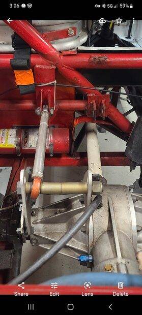

Discussion
The car probably had 1 inch engine offset to the left as this was pretty universal. The factory car was set up with at most 52% left side weight. This is still the norm, I think. The majority of racers today are running these older chassis unless you have cubic money and buy the latest greatest new chassis. The big problem is your race team decides on where to put the weight and what wheels to use.
Wheels - factory chassis guys like Howe, Port City , Left Hand ship the car with standard wheels on all four corners. Normally the wheel has 4 inch offset measuring from the back of the wheel to the wheel backing plate. Saves money and is a good baseline. If you take the 4-inch offset wheel off the car and put 3 inch offset on the right side of the car and 5 inch offset on the left side of the car you gain left side weight. You can gain 2% more left side weight doing this. Now you are at 54% left side weight. Now you add a 1-inch spacer between the hub and the backing plate so you can get up to 56% left side weight. Some even go radical using 6 inch offset wheels. Next you find out the track has a 58% maximum left side weight rule, so you move weight around to do this. Now you are at the legal 58% left side weight.
The problem
The location of the top link on any factory chassis is about a 52% left side weight set up on the standard 4 inch offset wheels and the tire track width. A very logical and safe starting point. Unless you ordered it with a specific requirement to change these settings. No one does this because no one knows about this Post!
The problem is the 3rd link is mounted at the original 52% weight location and should now be at the 58% location and it is not.
Why is top link mount so critical? The top link is the rear end link that pulls the race car. This top link directs all rear end force to the chassis. The rear tires grip the track and try to pull the rear end to the rear as the trailing arms. On the bottom, the trailing arms push the car to the front and try to climb up under the car.
We are discussing left turn race car where you want a left side weight bias. When in a turn you want the left side weight rolling over to the right side to assist the car with better traction (tire grip). Correct location of the 3rd link mounting is a real help so the tires are pulling on the third link equally otherwise when you step on the gas, one tire will bite more than the other and shoot you toward the outside of the track or the inside.
If the 3rd link is offset to the left more than the right side, the left will have more load and the right rear tire will have less load. Exactly opposite of the muscle car scenario above. What really happens is more force is added to the side of the car the link is biased to. In this case we have more force added to the left rear tire, so we create an on gas, corner exit PUSH condition.
The Cure
Mark each rear tire centerline. Measure the distance between them. This is the track width. Let's say 66 inches so the mid-point is located at 33 inches. Now measure the right-side tire centerline to the middle of the top link. Let's say it is 34 ¼ inches. 34 / 66 = 52% left side weight. If you are scaling at 58% left side weight we multiply the total track width time the % so 66" x .58 = 38 ¼ inches. The top link mount should be at 38 ¼ " so, move it left 4" then the push goes away. It is that simple to fix.
See attached photo a forum member, RaceMan12 posted on page 46 post 1602 this post. You can make this happen.​
Look at photo below. Notice the original top link mount was offset about 1 ½ inch to the left of the quick-change housing centerline. The racer relocated it about 4 inches more to the left.See post # 1576 page 46
post 1602 page 46
post 1604 page 46
this explains things in a lot more detail.

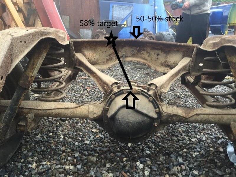

Street Stock or Hobby Stock Rear end width and 4 link problems
3100 pound max weight, 58% left side weight is max. 78” total tire width, must use stock suspension locations and stock brackets, 8 inch wheels, 9 inch tires max width, Ford 9 Inch rear end permitted.
We are talking about Chevelle, Monte Carlo with metric front end clip race cars. Let us look at what we legally can do to gain an advantage over the other racers.
Front track should be considerably wider than the rear track. The wider the front track, the more resistance to diagonal and lateral load transfer. Thus the car will be less likely to push when you nail the throttle on corner exit as the inside rear wheel won't be driving as much. Because the lateral weight transfer formula is - W x gs x H / G x T
where T = track width, H = height of Cg, G= cornering force we can simplify the formula by factoring in 1 G of cornering force to reduce the equation to WH/T so if we got a stock car with CG 20 inch tall, 3000 lbs. weight and 70 inch track width, we have 857 lbs. lateral weight transfer. If we have the same car and reduce the track width by 4 inches, 3000 x 20 / 66 = 910 pounds transferred and
Wider track will reduce the roll angle, weight transfer, and reduce all the ill effects but if we can gain traction by using the 58% rule the small 52 lbs. going lateral is worth it.
Is there an advantage to change the rear end to a narrower track width. Not really in this class.
Let us assume we have managed to get the 58% left side weight through battery and fuel cell location and ballast weight. For this discussion we will not address the front-end suspension and concentrate on how to best hook up the hard spec rear tires with the stock configuration rear end design.
Note the rear end below. We are locked into the 4-link suspension. The two top links are mounted at an angle 5 inch from the centerline of the rear end housing and at 40 degrees to the body and are connected by 10 ½ inch trail arms.
If we have a 70-inch track width the center is 35 inches. If we use the 58% formula, then 70” x 58% = 40.6 inch** should be where the center point is located so each tire gets equal loads. In reality we are pulling at the 35-inch mid-point and adding more load to the right-side tire. Typical top link with the torque spring on a 3-link rear suspension for car of this weight and these tires is 1200 lbs. spring rating. The car is going to load on the right side 14% more (768 lbs. total.) more than the left side (432 lbs. Total) and push the car to the left when you gas it. Build in loose condition.

Note the rules say you must have Stock components and they must be mounted at the stock locations. Nowhere in the rules does it state you must use stock bolts OR the stock bolt size! It does not say you have to have them connected or hooked up in the factory manner. Removing the right upper arm will help a little but the rear end would sway sideways too much and the pinion angle would change a lot because the rear end would rotate too much. Not the hot setup.
So, what happens when you replace the stock bolt 9/16” diameter bolt with a smaller diameter bolt? And if you do this at both mounting points on the right-side top link you now have over 1/2 Inch of play before anything happens. Again, the rules say you have to use stock components but can substitute bushings. If you decide to leave in place the really worn-out bushings that have a lot of slop and play, you now have about an inch play on the right-side top link. You turn the right-side trail arm into a slider that will stop at the same place every time.
Note photo below- Mark the frame at the 50% track width center point, Mark the frame at the 58% target and you now have the ideal setup. When the rear end is slid to the full play position, project a straight line from the rear end housing centerline to the frame. It should move closer to the 58% target as depicted by the thick black line. The closer the line gets to the 58% target, the better the traction to 50-50 rear tire load. I cannot tell you a specific angle as there are just too many variables but if you do this you can directly measure the actual distance.
In the photo and my half ars depiction, I make the angle to be pulling at 75° angle and the sine is .96 so the force is1200 lbs. time .96 9 sine of 75° = 1152 lbs. and should be spread equally on the rear tires.

Offset bushings - these can add static angle to the left side top link and give the rear end even more tilt toward the 58% target. On the lower training arms they can add in rear roll over steer. Many options and almost mandatory these days.

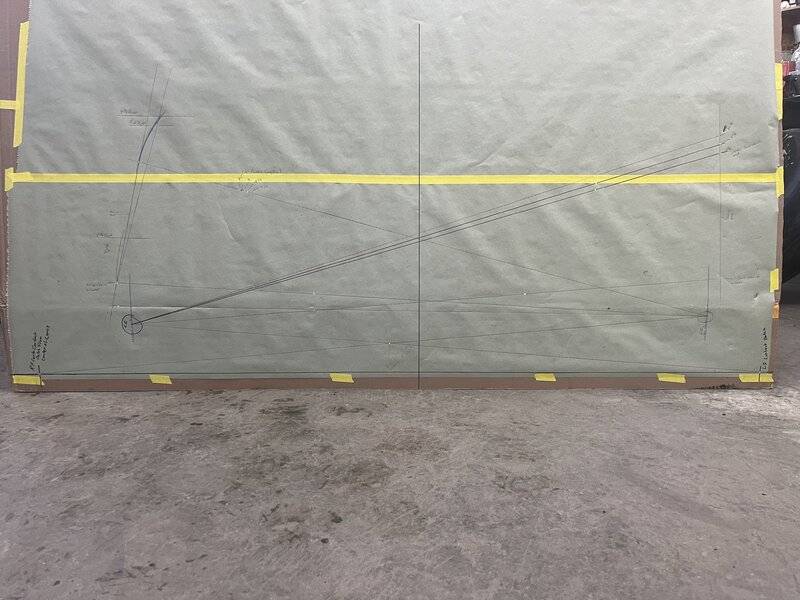

I’m looking at roll center geometry there two different styles. A traditional or conventional roll center and jacking force which one is more consistent or better on tires and why ?
  • #1,667
What is a "traditional roll center"? If the roll center is above ground, there is always a jacking force.

Well RM I am conflicted right now because I’ve measured out my role centers and currently I’m sitting at 2 5/8 left of the centerline and 3 5/8 above ground and I know that you recommend 2 inches to the right of the centerline and 2 inches above ground, but I’ve heard some conflicting arguments about having the role center too far to the right as the car would last like 10 laps and go away versus the role center being to the left and giving the car longevity. Very unsure if I should move them or leave them where they’re at what would you recommend?

Actually, I recommend front roll center to be 2" to 2.5" above the ground and 2.5" to 3" to the right of centerline. This is for traditional or BBSS set up.
Are you using chassis center line of tire track width center line?
Can we agree that your 3 5/8 rc ht is a bit high for a paved track late model on 8 inch tires?
Can we agree that those spec tires need more down force to stick?
do you have tire temps for last long race?
You said -
RM life lesson- ifin you want to keep getting what you been getting , stay in your lane and do nothing.
You want to WIN, take the chance, you only live ONCE. Winning is NOT for everyone.

Hahahaha Great point RM . I’m going go with your recommendation. Full fab perimeter chassis . Yes 8” tire durometer is around 70 . I’m going say we are bbss but not 100 %. And yes we can agree the tire needs more down force to stick . I’m going re map roll centers and get back to you . Also I will include photos of my work. Thanks for the words of wisdom Rm . Till next time have a beer on me !

Here are your numbers
If we know the Angle Sine of the left RC has a 115° angle has SIN of 0.190 and we multiply this by the 1352 Mass we have 257 lbs. acting on the tire contact patch thru this vector and the remaining 1095 lbs. moving laterally to the outside of the track. But wait a minute. What also is happening during the cornering process.
The Your late model car has 34” between the front spring upper mounting points. Our left roll center is offset 2 5/8 inches to the left which means 49% of the body roll will act on this RC. We have 49% of the Mass (1095) moving thru the RC rotating and planting the right front tire with 460 lbs. downforce. The remaining 635 lbs. is moving laterally and pushing directly on the tires.
Now let us look at the Angle Sine of the right RC, 5° angle has SIN of 0.087 and we multiply this by the Mass (1352) we have 118 lbs. acting on the tire contact patch thru this vector and the remaining 1234 lbs. moving laterally to the outside of the track. But wait a minute. What also is happening during the cornering process.
The typical late model car has 34” between the front spring upper mounting points. Our right roll center is offset 3 inches to the right. Now we have 52% of the body roll rotating thru this RC. We have 52% of the Mass (1234) moving thru the RC rotating and planting the right front tire with 642 lbs. downforce. The remaining 592 lbs. is moving laterally and pushing directly on the tires.
Downforce on rt ft tire......460 lbs...................642 lbs. or 40% more downforce
Force lateral thru tire...........635 lbs..............592 lbs. side load
Jacking force rt ft tire............257 lbs.................118 lbs.
You are running just about 3 times the jacking force with current set up.
I would bet you are running a stiff right rear spring (300#) to keep the left front from lifting. keep an eye on this! may need change.
The side loads are close but on those hard spec tires you need more down force to out corner the other racers to plant the right front tire and pivot the car in the turn.
Finally, have you ever heard of these hard spec tires going away in ten laps? Adding 182 pound down force and taking away 140 pounds jacking force is going to burn a tire in 10 laps...
Granted, this example is NOT for YOUR car. It is an example of RC location and impact on a spec tire car. So take it worth what it is worth. Opinions are is free. nuff said?

I have to admit RM most of the calculations are you putting forward to me are beyond my pay grade let’s say I’m not too familiar with trigonometry, but I’ve watched a few videos on what sin is and the calculations of it but not 100% confident on understanding of it. i’ve mapped out the role centers and tryed posting a picture for u .ill try again . I bought the Steve smith book u recommend laying the front end just it states in the book . I set the roll center at 2 5/8 off the and 2 5/8 right of the center line as I can move theses a with the upper a frame angles if need be . Figured this would be a good starting point.

There some additional line here just figure out different a frame lengths and height I have lower frame set a correct heights . The thing I most curious about is how much migration I will get . I’m assuming I don’t want much .
  • #1,677
AN EXCELLEANT START. Racers on this post. Attention! This is how you separate being a car driver and a winner! Understanding handling on YOUR track with YOUR car and what has to be done to change things to win! More on this later but please let me do some research and break it down on the SINE TRIG thing..
Face it people..todays education system in schools can tell you about Earth Day but lack basic educating of students on the friking basics!
C10 Good job. Hold the 2 5/8 " on both for now. Right in the ball park!

More on RC migration later but as long as the roll center stays to the right of the centerline and orbits within 3 inch of original position, you are good.

Regarding Roll Center acting on right front tire contact patch.
Look at the diagram. We have a block placed on a slope. The forces acting on t his block are its Mass and Gravity.
Parallel force can be found using the formula: Fparallel = m * g * sin(θ) where:
Fparallel is the parallel force, - m is the mass of the object, g is the acceleration due to gravity (approximately 9.8 m/s2 on Earth), and θ is the angle of the inclined plane with respect to the horizontal.
For this exercise we can leave out G as gravity will effect both Roll Center setups the same. This leaves the equation Fparallel = m * sin(θ). or W times Sine θ
Note - θ is Theta angle in degrees.
For our race car we have the sprung weight of the car going into the corner and pushing from the Roll Center to the rt ft tire contact patch. If we know the total mass as previously calculated in the above example post # 1674, we have to deal with 1352 lbs. pushing directly on the rt ft tire contact patch at an angle of 11°
Sine of θ from Trig tables -
Sine of 90
° = 1
Sine of 45° = 0.70
Sine of 30°= 0.50
Sine of 11°= 0.19
Sine of 5° = 0.08
So you see when you multiply 1352 x 11° angle with Sine of .19 = 257 lbs.
Now compared to 1352 x 5° angle with Sine of 0.08 = 108 lbs.
the smaller the angle, the less force results, everything else being equal.

C10 ,where is the 3rd link or top link located (attachment point to the chassis, not the rear end.) on the rear end? Mark the center lines of both rear tires. Now tell me distance the 3rd link is from each center line.
  • #1,683
Morning RM yes I’ve read your literature on this and our track width is 64 inches and our left side weight is 57% so we do 64×.57 which equals 35.91. I had to do some specific modifications to the third link area on the CHASSIS which I’ve done and it’s exactly right where the third link needs to be and we’ve actually run the car one time with this way and I will tell you, it makes a significant difference on handling. I’ve got it I’ve gotta get back to work. We’ll chat later. Thank you RM.

Excellent work! good job!!

read post 562 on page 17 about Polar Moment. In my opinion, making a race car back into a go kart is stupid.
This is what not properly using the Suspension makes the car as well as Bump Stops...why have springs??
Many post here on this as well. That has to be one tight paperclip track you race on or else it is the Mount Lawn baseball Diamond! Anyway, figure out your roll center and set up car from there. let the monkey see monkey do crowd waste their time on trends and gimmicks, you study the basics and then get the checker.
Look at the current trend of having the front roll center to the left of center line.
It is acting thru a lever that is 11 degrees to the right front tire patch. Think it won't jack up the car??
darn sure will. The proper location is on the right of center line acting at 5 degree angle. Will still scrub off some cornering momentum but not lift the left side of the car. Adding lead to the left side a-arm is a bandaid not a cure.

I have been reading a lot from Bob Bolles publications and he mentions a lot about matching front and rear roll angles, not the roll centers themselves front and rear but the actual chassis roll together so the chassis wants to roll the same going through the corners. I may have missed this, but I have looked some thoroughly through this thread and haven't found this concept discussed much on here and was curious if that theory holds true. And if so, how can I find out how much the front and rear is rolling on my chassis as I know shock travel indicators aren't the most accurate and I def. don't have the money for a data acquisition system, if I have missed it, my mistake I honestly tried looking!
Also, in a prior post it was mentioned that for an asphalt car it is best to start at 52% Rear percentage. The car I have now came with a 17 gal. fuel tank. We run 40 lap - 50 lap races, so I was thinking if it was better to maybe put an 8 gal. fuel cell in that I have already have and take that 55lbs difference and put it lower onto the frame rail just behind the rear axle so I can maintain the higher rear percentage but have it lower in the car. Would this sound like a good idea if I can keep 52% rear? Or should I measure out the polar moment that RM mentioned and place the extra weight there, but lose the 52% Rear? Any suggestions would be appreciated. Thank you.

Yes I do. We ran last year around 50.5% Rear with a no ride height jacking force based setup that we were told most everyone else ran . 600 LF 250 RF 600 RR and 150 LR with a 1 5/8in. Diameter sway bar. Around 56% cross. and 56.8% left. Never paid attention to roll centers. Was competitive one night with good pace but turns out we were way light when we were on track scales and once I added the extra weight we slowed right down the last races of the year. So I am hoping to change everything this year and start fresh

Go to the smaller fuel cell. You are very close on left side 58%. I would try to mount weight close to polar moment but shift back to try to get 51.5 rear weight. Perfect for 1/4 mile track. Cross wt between 54-57.5%
do not get hung up on target numbers. everything in racing is a compromise. You get it to within 0.5% of target, close enuff. Example - 58% left side weight is 1566 on 2700 lbs. car, 57.5% is 1552 or 14 lbs.

So my rear tread width is 65 1/2 (max allowed is 66") and my left weight percentage is 56.8% as mentioned above (max allowed under rules is 57%). Multiplying them comes out to 37 1/4" I measured that over from RR tire centerline and my current third link (solid bar) is an extra 3/4" farther to the LR tire, so I can remount it closer to the 37 1/4" mark. As described in your previous post. I will change to smaller tank also and move around the lead. Also looking into changing the lower links to level, parallel to centerline and making them longer.
  • #1,693
65.5" times 58% = 38"
i would wait until you can actually get the 58% left side before final 3rd link change. Yes even 3/4 inch on those hard spec tires will make a big difference when you step on the gas.

On a prior post it was briefly discussed but what would be the ideal engine mounting location on an unequal lowers chassis in conjunction with Roll Center location if I have longer RF lower control arm than LF, should I place the engine in the center of chassis and then have the 3" RC to the right or should i move the engine as far over to the Left as rules allow and keep the RC location at 3" right or change that so the engine's weight doesn't have as big effect as the chassis goes through the corners?
  • #1,695
Ideally we want the maximum left side weight we can get. Do this first then worry about Rc location. We need accurate left side weight % , this is critical. We can check the rear 3rd link location and correct.
Next, we want to use an offset roll center to put more downforce on the right front tire to add traction. On asphalt we want 3" offset to right , on dirt 4" offset.
Likes Savem c10 and Cape15

please read post 1660 on page 48 and tell me the location of your 3rd link. i suspect the 225 rt rear spring is on the car because the 3rd link is not properly located.
