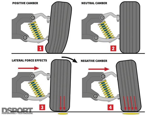

Rear axle camber bending on stock rear ends.
You can bolt on camber snouts to the quick change rear ends and get up to 2 1/2 ° camber. Now here is a trick to bend the stock Ford rear end and gain 1/2 ° camber. This is about all the stock splines and gears will take but adds significant performance when running hard spec tires. Note the tire contact patch on the diagram.
'Chassis Engineering' by Herb Adams came to mind where he describes camber and toe adjustments on a Ford 9 inch by means of heat shrinking. So to gain negative camber one would heat the top of the tube which will initially expand and then contract on cooling more than it expanded on heating causing permanent deformation. There is even a number (just found the book). Mr. Adams says that if you heat a 6 inch section of the tube until it is red hot, it will shrink for about a 1/2 degree bend.
On Ford 9 inch rear ends consider the adding of supports to keep the tubes from flexing.
You can run up to about 1/2 degree of negative camber in a Ford 8.8, Ford 9 inch non floater, and a Chevy 12 bolt by bending up the rear axle tubes with a little heat from a torch. A sharp axle guy can take the end off the tube and reweld it at a very slight different place higher on the tube than before and with a little angle to it. I have seen a Ford 9 in a Camaro Stock class that ran for 8 years with a little more than 1/2 degree of negative camber and the axles looked like new. The inner splines can take that much mis-alignment and there can be that much just in production tolerances. SCCA allow that much negative in American Sedan and American Iron and most guys put that much into the rear ends without wearing them out at all. To get more than that in a floater or non-floater you need to have the axle splines machined in a slight barrel shape which allows them to flex inside the splines at a larger angle. It doesn't take much.

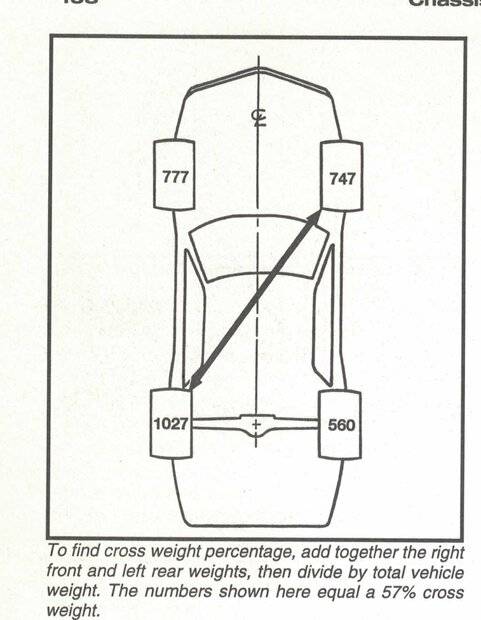

welcome. my first question is what is the rear suspension? 3 Link? what is panhard bar setup? What rear roll steer do you have? what is rear track width? what is 3rd link location relative to the right rear tire centerline?
Strictly by the number you need to get at least 48" rear weight. 2850 lbs. total weight time 48% = 1368 #
you now have 44.3% rear weight or 1262 # so 106 # difference.
You could take 106# off the front and put it in the rear. But, Duke Southard wrote his book, Short Track Chassis set-up and had this nugget of information.
You do not need to go crazy on frame modification to get 48% rear weight. Note where the battery, fuel cell and ballast weight is now and do some calculations.

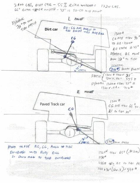

Likes Cape15 and Tom.G

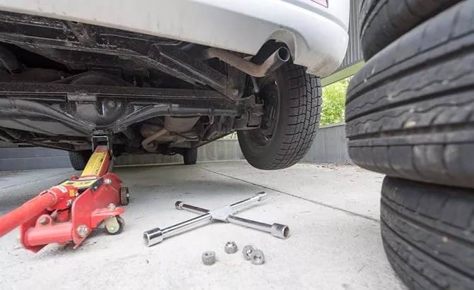

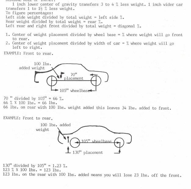

Wedge or cross weight
Checking for Wedge – Crazy! I spent an hour googling and no photos of this. Word picture time. When the race car enters the turn the left rear spring goes into droop because the spring is extending to its max travel and the right rear spring is compressed. The left side droop means the left rear tire has minimum traction. We use wedge (cross weight) to increase tire load on the left rear tire. This increases tire bite off the corner. We attained this with the jack screws we have on the car. We add cross weight or Wedge to force the left rear spring into the track when cornering.
We measure Wedge with a ½” socket placed on the floor jack and center it under the rear end housing to lift both rear tires. The right rear should lift up an inch, 2 inch or 3 inch as the track demands, just as the left rear tire shows daylight under the contact patch.
In the turn, the body will roll over and the wedge drives the left rear to wedge the tires to keep in contact. The % cross weight on street stock is usually 1 to 2 % total weight, Late models with slicks run 2% typically.
Rule of thumb - every inch of wedge is 1% Cross weight. When the wedge goes past the normal amount (and inch more than what the normal amount is) then make a left rear spring change. Then reduce the wedge to under the normal amount and adjust at the track as required. Cross weight is adjustable because the local track will change due to temperature, amount of rain washing off the oil and rubber, etc. You need to have a way to dial the chassis in for new conditions and not use it up for basic chassis setup.

The problem is that this is a static fix. Look at the cross-weight illustration below. We have left rear tire weight of 1027 # and right rear tire weight of 560# when we scale the car. We use the Static measurement of % left side weight to locate and center the 3rd link to provide 50-50% traction.
This remount does not take into account the dynamics of corner exit. Look at # 43 car lifting the front end under acceleration. It is also twisting and throwing left side weight over to the right side. We have to dial this additional left and rear weight into the equation.
Let us say we have 100 lbs. weight coming of the left front tire and dumping on the right rear tire under acceleration. The car is twisting and unloading 25 lbs. from the left rear tire and it goes to the right rear tire
Now we have a dynamic left side % weight of
Lft ft rt ft
677 747
Lft rear rt rear
1002 685
We now have 54% left side weight under acceleration.

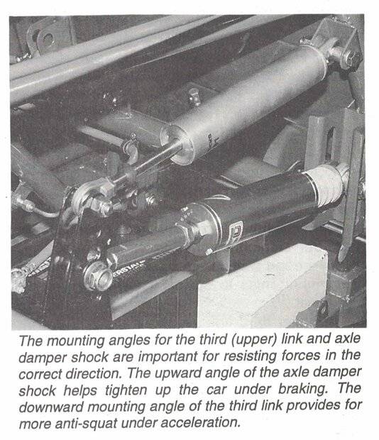

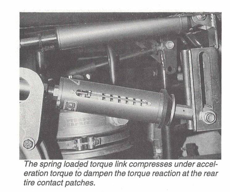

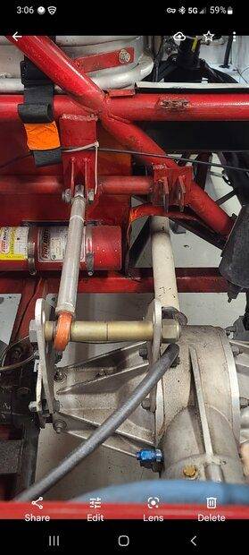

  • #1,724
We use the torque link to help hook up t he hard spec tires we have to race! This lets us dial in amount of rear traction and it is one of the best ways to aid corner exit with the tires we have to run.
Thanks again to Paved Track Stock Car Technology by Steve Smith! A lot of tuning advice on this in this book.
Torque link or 3rd link with spring / shock top link or the toque link should be mounted 12 to 13 " at 3rd link location desctibed in previuods posts. Once you figure this, mount it on top of the axle housing, and 1 to 3 inch behind vertical center line of axle housing.
Angle the top link downhill about 20 degrees. And usual adjustment is between 15 to 25 degrees. On asphalt we run 3 to 7 degrees.
Adding more downhill angle will tighten up the car under power off the corners, but the hook up does not last as long and by using a lesser angle the car will hook up more smoothly but not as quickly.
you may want to add a shock damper to the 3rd link mount. this will control rear end looseness and wheel hop under braking. The axle damper should mounted 5 degrees up hill. Never mount it level or downhill. If the rear end loosens persist at corner entry use more axle damper uphill angle adding no more than 2 degrees at a time. max 7 degrees uphill angle on dirt.
If rear is too tight at corner entry decrease downhill angle.
Lower trailing arms usually mount 3 to 5 inches below axle center line. The most common center to center length for lower trailing arms is 20 inches.
Lower trailing arms normally mount 5 degrees uphill. Uphill angle gives better forward bite. Both links with same angle create slight roll over steer. You can change wheelbase to control rear steer by shortening or lengthening one of the lower trailing arms. Many dirt cars run 20.25 inch right side
lower trailing arm 1/4 inch longer than left side, to increase roll over steer.

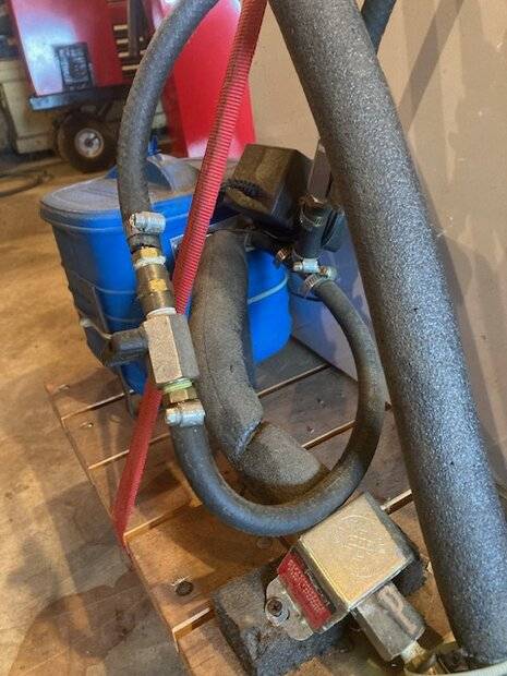

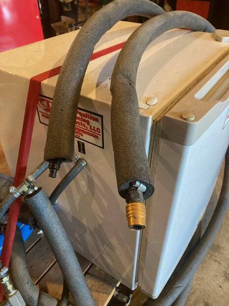

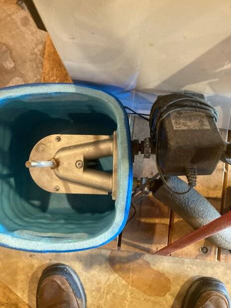

The temperature of gasoline has an impact on how much power an engine will produce. When your fuel is at a lower temperature it will have a higher density level, this allows more to enter the combustion chamber. This increased amount of fuel inside the cylinder will allow for more combustion in the chamber, thus creating more horsepower. Having fuel stay at a lower temperature also will prevent it from moving to a vapor state inside the fuel lines before it enters the engine.
What Does a Cool Can or Fuel Cooler Do?​
A cool can for fuel or fuel cooler is a device that helps regulate the temperature of the fuel in your vehicle's system. By reducing the heat of the fuel, it can improve overall engine performance and prevent fuel vaporization, especially in high-temperature environments. This can lead to a more consistent fuel delivery, increased power, and improved fuel efficiency. Cool cans and fuel coolers are particularly beneficial for vehicles that experience fuel heating issues, such as those with high-performance engines or operating under extreme conditions.
What Is the Difference Between Cool Cans and Fuel Coolers?​
Cool cans and fuel coolers serve a similar purpose of cooling the fuel, but they differ in their design and installation. Cool cans are compact, cylindrical containers that are typically installed between the fuel pump and carburetor. They utilize heat exchange technology to dissipate heat from the fuel. On the other hand, fuel coolers are inline devices that are installed in the fuel line itself. They incorporate various cooling mechanisms, such as heat exchanges or fans, to cool the fuel as it passes through the system. Both cool cans and fuel coolers can effectively reduce fuel temperature, but the specific choice depends on your vehicle's setup and application requirements.
What is desired is a way to improve the volumetric efficiency of the Internal Combustion engine. All an IC does is act as a heat pump. converting chemical energy, gas, into heat and usable power. Te more fuel you can pack into the combustion chamber, the faster you go. For years racers used a cool can to cool the. fuel. It is simply a can with a coil of aluminum fuel line mounted in it. the racer would put ice in the can before a race. Theoretically, the fuel is cooled more than ambient temperature and is a denser mixture of fuel / air thus more power. This is why older cars had chokes on the carburetors, to "choke off" the air supply in real cold weather. The choke had a thermal spring that would kick off once the IC reached operating temp. Cool can, I can testify, after much testing, is not a good solution. There not enough time or cold enough media to cool the fuel. Back when drag racing in the 1960s, we went so far as to run acetone and dry ice in the can. It froze the fuel line up to the fire wall..ran like a bat out of he--... but..our driver was overcome by fumes and started our Super Stock 63 Plymouth 426 Wedge in high gear at the starting line. These cars had the push button automatic transmission. Have you ever heard a 426 cubic inch motor lug down when the hammer is dropped at 7000 RPM?
Cool can with ice does add about 2 to 3 HP on carburetor engine s but not direct port injection setups. The carb setup means charge cooling from just under the carb to the intake valve. The colder gas mixture can cool the air and create a larger charge before entering the cylinder head. Direct port injection just squirts in cold gas with no charge cooling effect.
118° F fuel to a 10 HP gain with 58° F fuel super chilled
Anti freeze freezes at - 34° F
Acetone freezes at - 128° F
Dry ice cools to - 106° F

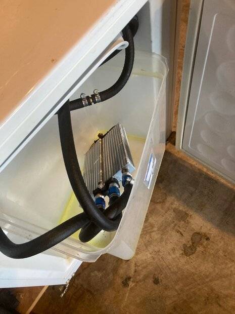

We did not have enough room on the formula car ( like Indy cars ) to mount the cool can and i think it would have been illegal anyway in SCCA. So I designed a fuel system to take the fuel out of t he fuel bladder , cool it down and return in to the fuel bladder. This is for the Qualifying event not the race. I used a Facet 12 volt electric fuel pump an d 120 vac to 12v adaptor. Had quick disconnect fittings and plumbed it into the fuel line and fuel tank vent line. I used a Blue moroso cool can in series with a medical freezer.
A regular freezer will cool to 20° F above zero. A medical freezer will chill to -20° F. Inside the freezer I installed a small oil cooler. It was in a plastic container that could hold a gallon of antifreeze.
Why the freezer? Many tracks are located out in the boon docks and i could not depend on getting dry ice readily. We always had a gas generator to power the air compressor, coffee maker, microwave. So on boon dock tracks the freezer would freeze to minus 20° F and we would cool t he fuel for qualifying. I would put ice in the moroso cool can so the fuel would bet chilled a little before going into the freezer.
When we had dry ice available we would put acetone in the cool can and plastic container ( had to replace it with an aluminum one reall soon after t he first freeze).
Yes it worked and no one caught on. I did not have a pyrometer that would read that low so can not tell the temperature the gas was cooled to before we qualified but i can tell you there was a lot of condesation dripping from the car. We made it a point to wash the car outside the garage in plain sight just before qualifying. I made it a point to have a can of PAM (spray on canola oil you use in the kitchen) stashed under the car while washing. If you looked you could easly identify it! ( Intresting note- soon after we did this and qualified number one at a few races, alot of other racers began washing their car and wanted to know what soap / washing mixture we were using) monkey see, monkey do!

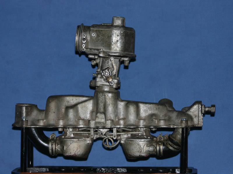

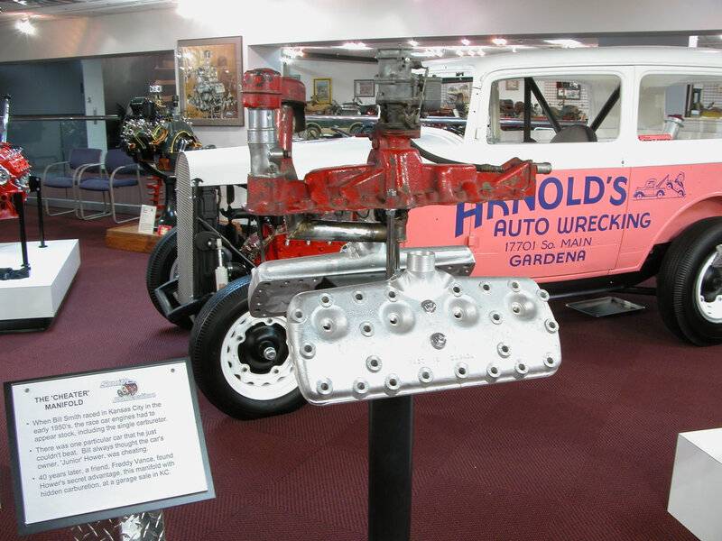

  • #1,727
PART 2 -
Regarding the 2 barrel carb limit - Many have messaged me about racing in the 500 cfm 2 barrel car classes and how to maximize the setup. If the rules state you must run this CFM carb, do it.
You will be surprised to learn your Holley 4412 500 cfm 2 barrel only flows 353 cfm! The new XP 4412 with stream lined air horn and all the new tricks flowed 392 cfm. Both a far cry from 500 cfm.
Can you still get an edge on the rest of the field? Absolutely. I do not condone some of the following but this carb restriction has been in effect since the early 1960s. The math I use here is extremely simplistic as real world results show my numbers go out the window when Rpm goes up and dynamic flow kicks in. I will not be addressing the rework of the carb as you can pick up 50 cfm by just polishing and porting , smoothing things internally. See video below at bottom, on reworking stock carb
Lets look at the numbers. A Holley 500 cfm 2 bbl carb has venturi diameter of 1.3/8". There are 2bbl carbs with 600 cfm and have 1.45 diameter venturi. First thing was to keep open one of the intake manifold holes used to draw vacuum. Tech would make sure these were all capped but is did work. You can run a vacuum gage into the cockpit and if it happens to slip off during the race you may get and increase. A 3/16" hose will yield 0.11 sq inch.
Back in 1950, one race team set up the car so the carb was mounted with springs on top of the carb mounting flange. When the driver mashed the throttle pedal the carb would be jerked rearward and air would enter the intake manifold. Of course they jetted for the fat side and won a lot until TECH caught on. Next the boys drilled the carb mounting threaded bolt holes thru the manifold. Now you can have air enter the intake. The trick here is to use a 4 barrel intake manifold and use a 2 bbl to 4 bbl adaptor plate. Now you have 8 bolts that can be drilled out , cross drilled. It simply looks like the bolts have been cross drilled for safety wire. These holes can access the plenum chamber in the manifold under the carb. Serrated washers look like they are threr to lock the bolts but really can pas a lot of air as they do not mate flush to the carb or adaptor plate. This was pretty obvious once TECH caught on to it. Next thing tried was milling or filing a taper on the carb manifold mounting surface on both front and back sides but leaving the left and right side stock so the carb would mount flat but had a taper air leak under the carb. This gave additional air area to the intake. Bottom line is if you choose to go this route be prepared to be caught!
https://www.holley.com/products/fue...MIpMeNxbnjgAMVeQitBh1OGAXqEAQYAiABEgJIiPD_BwE
Looking at the area the 1.378 bore has 5.9 sq. Inch area. The 1.45 dia. has 6.6 sq. inch. 5.9 - 6.6 = 0.70 sq. inch difference. I will leave it here as you have a major clue about what you can do. Now it is up to YOU!
see below - stock 256 cfm two barrel carb to 300 plus
https://www.vaautoracing.org/oval6.htm
How to hide two carbs under the intake manifold, 1950...
https://www.museumofamericanspeed.org/cheatermanifold.html
hiding carb under the intake manifold.
Regarding hard spec tires read post 572 and 573 on page 17.

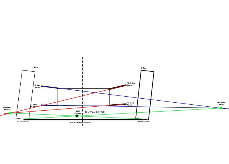

Hey ranger Mike! Looking for some help here.
Understand physics and math pretty well but I’m stumped on this:
Metric dirt street stock has 0 traction mid off on dry slick entry is great.
High bank, paperclip dirt oval 3/8 by my calculations but they claim it’s 4/10.
Turn diameter avg 345’ (330’ on one end, 360’ on opposite)
Springs/wheel offset (15x8 rims)/ tire circ (H500)
LF 750 2” 86” RF 700 2” 87.25”. 1.25” stag
LR 100 (20”) 2” 85.75” RR 225 4” 86.25” 1/2” stag
Front TW- 69”
Front RC 2” up, 3.75” passenger side (photo attached with info)
Rear TW 65”
Rear RC low
RR Upper 13.5°
RR lower 11°
LR upper 18°
LR lower 16.7°

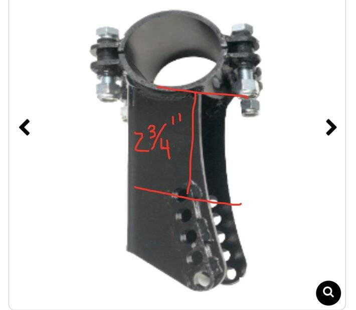

Lowers can be raise but bower moved down. Must bolt within 2 3/4” of bottom of housing.
Scale:
53.2 left LF 711 RF 650
52.5 rear LR 812 RR 691
51.0 cross. LR 5” of compression at ride height
120lbs bite RR 0” of compression at ride height
Ride height front 8.25” ground to center of bolt on lower bushing both sides.
Rear deck height 40”
Dynamic shock compression in inches:
LF 4” RF 4.5”
LR 1.5” RR 4”
Hot Tire temps after 25 lap race
Outside/ middle inside <><> inside middle outside
114 110 122 | 141 145 158
129 135 139 | 215 161 179
Hot psi cold psi
14 20. 11 17
14 18 11 13
160lbs ballast located directly above rear end and forward maybe 6” right under decking (estimate 32-35” to center of lead.
One 45lbs bar location passenger side 12” in front of rr tire
Unknown variables:
Front and rear CGH
Rear RC exact height
Rear ride height to frame / bolt
Issues:
Loose mid of bad in slick
Possible solutions- increase lateral traction by means of:
Increase rear TW by moving to 3” or 2” RR offset
Lowering rear CGH
Softening 225 RR spring to 200 or 175 lbs
Sorry for the long read of details but let me know what you think or if you want to get together via pm for some data analysis!
  • #1,730
  • #1,731
alph, welcome
Issues:
What size ARB (sway bar) in front??? solid sway bar i assume. what diameter, what length? any preload?
What are camber settings?
Have you checked to see if rear end is bent?
Loose mid of bad in slick ?????
Photo of Roll center lay out says it is located to the left of center. You said it was on passenger side???
Lowers can be raise but bower moved down. ?????? what the heck??
please review spelling of your post so we can discuss
  • #1,732
alph
after looking at the set up a few things stick out.
Why is rt rear tire inside temp so high. Is axle tube bent? see post 1326 on page 38. read post 1703 on page 49.
The rt rear tire is under inflated. same with left ft tire. Center temp way low!
rt ft tire has too much positive camber.
diagonal tire temp average is 141
ft tire temp avg is 131
right side tire temp avg is 167
diagonal avg to rt side is 26° should be 16°less, within 10°
not enough cross weight , car is loose off, left rear tire not doing the work.
your spring package and since no ARB, can not really comment
your setup
lft ft 750
rt ft 700
lft rear 100
rt rear 225
the following is recommended setup for 2800 pound dirt car street stock
lft ft 1000
rt ft 1200
lft rear 175
rt rear 250 and with 1.025 diameter arb on ft.
not knowing if the ft rc is offset to the right side as recommended, i can only guess you have too soft a frt spring package making car nose heavy and not enough weight on rear to hook up tires on corner exit.
  • #1,733
Ranger Mike said:
alph, welcome
Issues:
No sway bar
Static Camber settings are on the image
LF +6° RF -7°
Read end is not bent. Brand new car, brand new 60” quick change rear end, rear end is centered and not leading or trailing.
Front Roll center drawing is from a front view looking back, as if you were standing in front of the car looking at it, driver side on right, passenger side on left. Roll center is on passenger side.
The lower trailing arm bracket has multiple mounting holes underneath the housing but can only be a max of 2.5” from bottom of tube to the center of the bolt. I’ll attach an image below. I can not move the mount to a lower bracket hole but I could drill another hole above it.

can you put another spindle nose on the right rear quick change tube that has camber? A 36° difference from inside to outside temps on the rt rear is huge. Should be within 10°
the inside tread edge is burning off!
  • #1,735
I believe I had a small frame rub on that RR. Forgot to include that in my response. That would cause the increase in temp

I would say you are in a very good position. Roll center is ok so corner entry should be good as you u stated. You know the problem on rt rear regarding tire temps. It still looks like a spring change though. cannot tell until the tires are at best camber, inflation so total spread from inside middle and outside is 10° on spec tires. Typically, the right rear temp average should be between 10 to 15° cooler than the right front average. Seriously consider the springs recommended.
  • #1,737

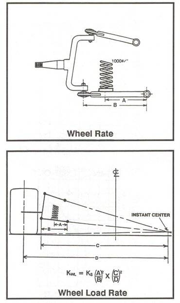

what is motion rate of the spring? Now this makes sense.
i assumed you were running stock A-arms. are you running slider attached at different angles and mount point from stock? look , if you want my help...tell me your setup!
  • #1,745
Ranger Mike said:
what is motion rate of the spring? huge!!

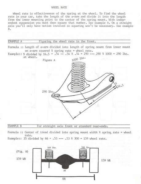

I’ll have to get you that information later tonight or next weekend. I’ll measure middle of inner pivot point -> center of spring then inner pivot to outer ball joint. MR= D1 / D2
I figured that’s what you were getting at because I realized where those spring rates you recommended were coming from. Keeping the car up off the frame.
  • #1,746
If you have GM metric A-Arm and have 700# spring in stock location
not enuff, too nose heavy , loose off

You know me and my fanatic requirement about roll centers!
1. where is the front roll center located, height and offset.
2. Where is the 3rd link located relative to the track width
8 inch slicks tell me you are in spec tire and car class, true or not?

I did get to check the MR on every corner but the RF
LF 2.5” shock travel to 1.5” spring travel(5:3)
LR and RR and pretty close to a 1:1 ratio
RF Guesstimate based on load stick #’s would be a 2” spring travel to a 4” shock travel 1:2
No spring sliders. Springs sit on a cup mounted atop the center of the axle tubes, vertically 90°
The rear shock have a screw stud mount aft of the rear end tubes that comes down from above at pretty close to 90° and mount on the back side of the of the lower trailing arm bracket.
