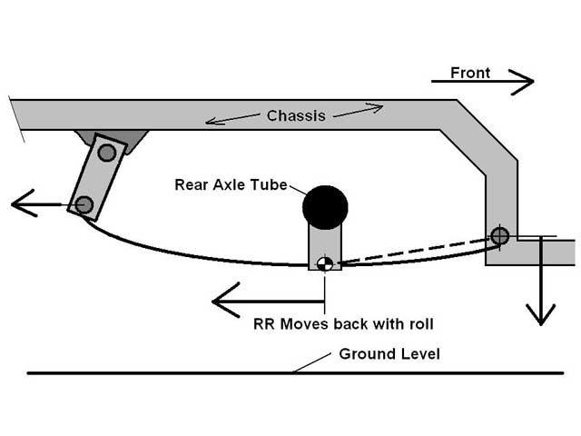

Question: I have noticed that on a (rear) solid axle sprint car or world of outlaw car that the right rear link on the z-link rear suspension is angled up-hill yet they run the upper link on the LR down-hill
Am I safe to "assume" that they are doing this to help generate anti-squat in the RR corner and thus bite the RR tire harder mid corner into the dirt but at the same time remove the anti-squat from the LR and let the weight just kinda of dump backwards from the RF to LR on corner exit?
Curious to hear your take on this
Thanks
  • #1,512
welcome gar eng
think about what is happening on chassis roll. The RR link that was up hill is now level, the LR link that was down hill is now level, so what has happened to the wheel base on each side?
do not get caught up in the anti squat thing. It can help/hurt forward bite or braking depending on how weird you want to get.
no one let's the " weight " dump on its own. Racers are real control freaks and want to control everything ( ask the Ex) so compression/ rebound are very important when cornering

Hey RM,
Every time I have a question I always revisit this forum (have intermittently frequented since 2014). I know you are a big proponent for the performance trends software and that is my next investment. While I'm budgeting the cash for this I do have a question.
While I was mapping out the rear suspension of my dirt late model I was thinking about instant centers. On the dirt cars we do have birdcages on both sides of the rear axle which is where my question lies. In order to calculate the instant centers of the rear end you have to use the lower bars for sure. Although, I'm not sure if you would use any other links to capture the instant centers. Both sides upper bars are angled in the positive direction so you would get no convergence other than aft axle. The lift arm is level at static so that wouldn't be the correct option either. The one given i have is that obviously we do have a positive anti-squat value on the left rear given that it hikes as soon as throttle is applied. Would you suggest just using the just lower bar to map out instant center? I've consulted all of the textbooks I have and have not found much in the way of instant center calculation for this scenario. I'm interested in the theory as it seems to help me conceptualize my direction, execution and optimization.
Also, do you have any reference that would help me understand the math of the instant center? I see a lot of articles referencing 100% but I'm not understanding what the base value and calculated value is that would yield your specific percentage.
I've done a ton of work mapping and optimizing lift bar (torque arm) application and optimization. This is the next piece to the puzzle.
