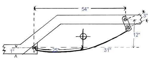

While I was mapping out the rear suspension of my dirt late model I was thinking about instant centers. On the dirt cars we do have birdcages on both sides of the rear axle which is where my question lies. In order to calculate the instant centers of the rear end you have to use the lower bars for sure. Although, I'm not sure if you would use any other links to capture the instant centers. Both sides upper bars are angled in the positive direction so you would get no convergence other than aft axle. The lift arm is level at static so that wouldn't be the correct option either. The one given i have is that obviously we do have a positive anti-squat value on the left rear given that it hikes as soon as throttle is applied. Would you suggest just using the just lower bar to map out instant center? I've consulted all of the textbooks I have and have not found much in the way of instant center calculation for this scenario. I'm interested in the theory as it seems to help me conceptualize my direction, execution and optimization.
Also, do you have any reference that would help me understand the math of the instant center? I see a lot of articles referencing 100% but I'm not understanding what the base value and calculated value is that would yield your specific percentage.
I've done a ton of work mapping and optimizing lift bar (torque arm) application and optimization. This is the next piece to the puzzle.
Keep in mind that on a dirt late model you have a live axle decoupled suspension, so the typical anti-squat calculations you would normally find in textbooks for 3-link suspensions etc. do not apply. You basically have four sources of anti-squat in a typical dirt late model utilizing a 4-link rear suspension.
The forces generated by the 5th arm lift bar, the forces generated by the left set of four bar links, the forces generated by the right set of four bar links, and the forces generated by the j-bar. The 5th arm forces are a direct response from axle wrap, so that reaction force is pretty straight forward. You then have to determine the instant centers for both the j-bar system of links and the left and right four bar systems of links.
The anti-squat from the j-bar system is generated by taking a moment about that systems IC from the lateral forces at each of the rear tires. The left and right four bar links are determined by taking a moment about their ICs as well. The force you use is the force that is generated at the axle tube by the rotating tire. This approach is only valid because the 4-bar links systems (via the rotating birdcages) are decoupled from the axle tube.
Keep in mind that these calculations on their own are pretty useless other than for conceptual purposes. They should be used in a large set of equations that define the vehicle as a whole, where the anti-squat forces are but a small part of the overall picture. As for your question about how to determine the 4-bar link instant centers. You would have to project the links onto a two dimensional plane (i.e. a sideview) and find the intersection of the projected lines from the top and bottom 4 link bar. It will be below the ground plane and behind the tire CP on the left rear for example.

The drawing shows how links and torque arm effect loading on the rear axle and unload the springs with acceleration. The gain in down force on the rear tire is not in addition to weight transfer from acceleration but part of it. The drawing shows a static position, the instant center and force direction and magnitude are changing dynamically and constantly. These are the basic forces, there are more involved.
I think I ran on long enough for one post. Please let me know any opinions on this.
