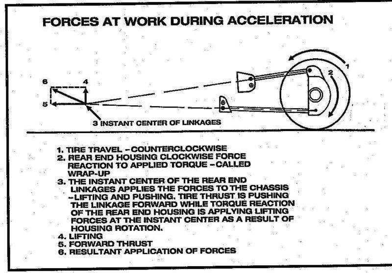

Good catch on evolving technology. There are a few definite advantages for this J-Bar rear mount linkage on the asphalt rear suspension. I think 1962 Citroen 2cv pioneered this rear suspension with the rear mount concept to the point of actually mass producing it successfully. Note attached diagram for the Paved Track Stock Car Technology by Steve Smith. Every racer should have a copy of this.
  1. It is easier to pull a chain then push it. This means pulling forces are easier to manage then trying to control the same forces pushing the same load. Looking at the typical 3 link suspension we have a single top link being puller as the car accelerates. The two trailing arms are pushing up on the cars suspension. The trailing arms must be beefier much the very nature of the forces they are dealing with. The mount location of the top link is critical as it must be mounted at the proper location proportional to the percent left side weight for maximum traction.
  2. The J-Bar mounting handle force vectors twice as effective as you have two links transmitting the pulling force instead of just one top link. These two links offer a lot more adjustment and chassis tuning.
  3. Braking may suffer but in round track racing, braking seldom wins races, acceleration and traction does. Road course racing usually means you have one maybe two places on a 12 turn track to PASS but many opportunity’s to out brake the other driver. I doubt braking will suffer with this J-Bar suspension.
  4. It is indeed quite curious that the aluminum J-bar style mount has metal housing surrounding the J-bar. Speculation and rumors will abound I suspect. Could there be a compression spring device hidden? Could the wheel base actually be changed under acceleration because of this? The verbiage in the catalog says “This Style Allows You to Run The Trailing Arm Behind The Axle Tube For Less Roll Steer” and some cynical crew chief may take that to mean you don’t need STATIC roll steer with this device. But you can take out all the rear steer in the traditional 3 link set up. Hhmmmmmm?

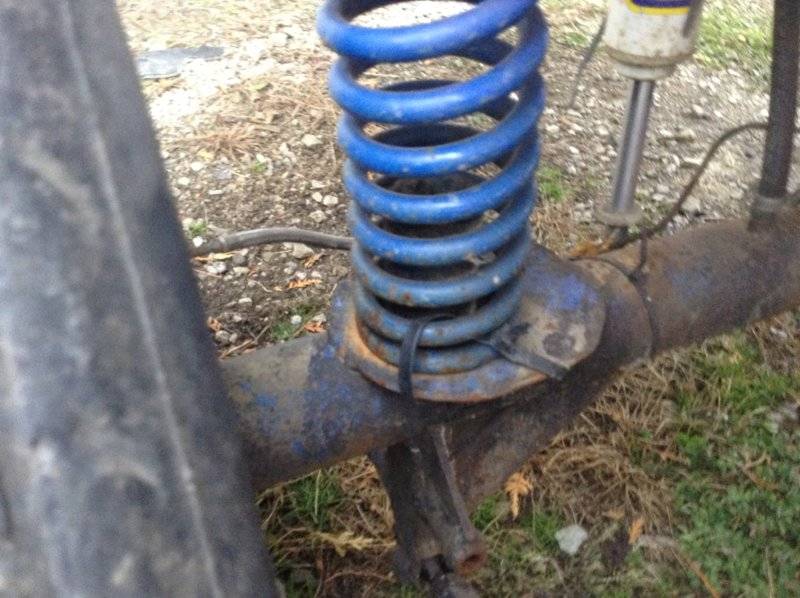

Another question ,how does off setting the rear coils effect turn in , if RR coil is mounted atop the axle , LR mounted 4 inches out front of the axle and down one inch.
  • #1,395
Here's how they have the rear coils setup

look at post # 1382 at top of this page. Take time to look at the force vectors acting on the two spring mounts you have now. I suspect these were fabricated to try to get advantage over the standard stock set up. Or could be case of monkey see monkey do. Is the center of spring to the center of rear end center the same on both springs? You may be dealing with two different motion rates because of the different locations. How much is it worth to you to make them both the same? Or is it worth it?
In my opinion, you can not set the car up to run the top until you have it handling going in, at mid turn and on exit. After you have this then you can adjust to run the high side.

Mike I got informed by one of the builders that rear coil setup was, to put the weight back on the LR faster

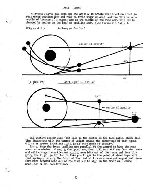

No anti squat means the springs will take any front to rear “ weight transfer” until compressed and we go to the drag racing funny car status of no anti squat and wheelie stand.
Read post # 314 on page 16 and post # 327 on page 17 before proceeding. Anti-squat is expressed in percentage. 50% anti squat means 50% of the rearward Pitch or “ weight transfer” is handled by the 3-link set up you have. 100% means 100% of the pitching or weight transfer is handled by the linkage and the body is actually lifted (wheelie time). Percentage is figured as the distance of Center of Gravity (COG) is compared to the Instant Centers location. Do not that the other point of origin of the IC is the tire contact patch. The COG perpendicular bisector to the pavement is crossed by the IC vector and gives the % anti squat. In the case of Duke Southard diagram from “Short Track Chassis Set-up” we see 20% on the 3 link figure #2.
I always used the camshaft center line as a good approximation of COG and worked for me. Production cars usually have COG between 20 and 22 inch above ground level. Round track cars will have it 18 to 20”. Street stock metric cars that have been worked over and lowered have 16.5” COG and super late model dry sump outlaw cars can be as low as 15” COG.
On our Formula car we ran low % anti squat mainly because the independent rear end was not the solid axle that you have, but has independent springs and swing arms on each side.
The rear pitch would load the individual springs unequally and the tire contact patch could shrink due to camber change. You do not have a lot of options on long links with these cars so 15% is huge.
Add to this the very low COG these cars have, and you are limited to % anti squat.
