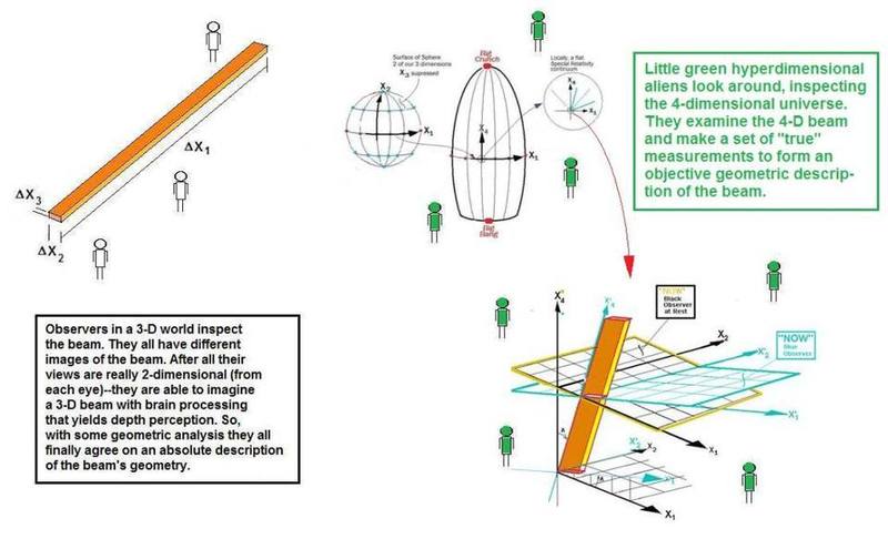

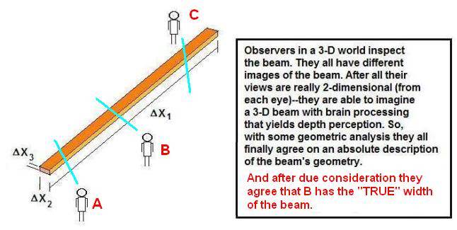

What if Greg prepares a toy universe in his 3-D world with time added? It's like a 16' long 2x4 transparent beam with various bundles of fine fibers (optical fibers maybe?) extending from one end to the other, configured in such a way as to present a geometric causality and having 2-D cross-sections that are consitent with some sort of physics (as you look along the length of the beam with emerging fiber patterns in a continuous sequence of cross-section views). But the 2x4 is just sitting there static in his 3-D space. It exists as a 3-D structure, independent of time as it were. He arranges one collection of nano optical fibers in a configuration that presents itself as a sub-sub miniature 3-D rod inside of his toy universe--in this 3-D configuration it has a rectangular cross-section (maybe 5 nanoinch x 50 nanoinch) extruded along the 3rd dimension, perhaps for a distance along the 3rd dimension of .01 inch (not long compared to the 16' length of his universe.
Now he passes a light sheet (they use them a lot in manufacturing inspection systems these days) along the length of the beam at constant velocity, starting at one end and finishing at the other end. He smiles as he sees a plane of light penetrating his universe beam, lighting up a new cross-section at each new instant (could the excitation of electrons within special fiber groups give rise to consciousness--but I digress). He identifies that with the flow of time. He could even use some nanotechnology to engrave subminiature pictures of clocks spaced along the beam with time readings that correspond to the position along the beam divided by the light sheet velocity. So, now he can tell you the proper time at any point along the beam (which is really his own elapsed time in his own hyperspace 3-D world). His beam just sits there as a 3-D structure, independent of the passing of his simulated flow of time. The rod inside of his toy universe exists with unique cross-section dimensions and an extruded length along the 3rd dimension. Could the long side of a cross-section of the sub-sub-miniature beam be Greg's absolutness of rod length?
He could have several light sheets, each slanted at different angles wrt the length of the beam, all sheets starting together and moving at the same rate along the beam, simulating different observer cross-section views. If his optical fibers have been arranged sufficiently cleverly, he might even have something similar to Lorentz invariance--he's got to be clever enough to produce a pattern that yields groups of transformations with physically interesting invariances.
But, does this picture change the argument in any way? The universe beam maintains the absolute 2"x4"x16' dimensions but still has cross-section views. Likewise for the embedded sub-sub-miniature beam. Does the perpendicular cross-section view of the miniature embedded beam have more claim to a 2-D cross-section reality than the slanted views of that beam? However, all observers correponding to the different light sheet movements could develop an understanding that there existed a 2-D cross-section sub-sub-miniature beam extruded along the 3rd dimension. Or could they? But would they all agree about the "true" length of the beam?
Sitting out here with our birds eye view of it all, do we even agree about the "true" length of that subminiature 2-D beam at some instant of time?
