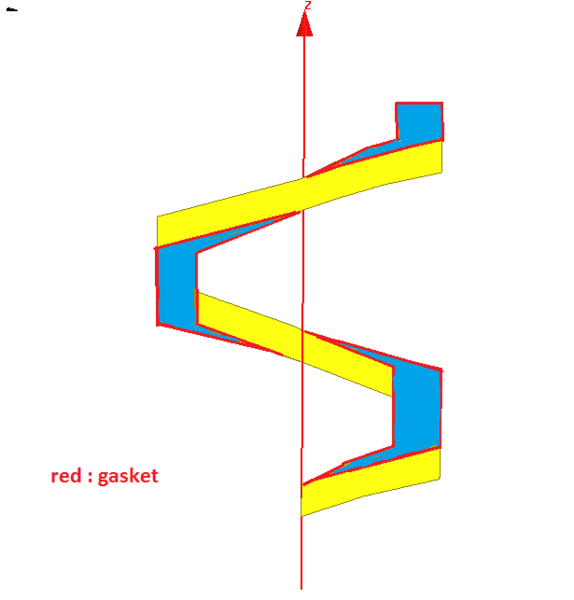

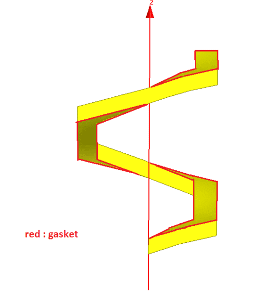

Imagine the gasket like a cord with a radius of 0.5µm for example, put this cord between square thread and fixed thread at up and down surfaces. Sure there is friction in practise but we can imagine no friction in theory. I would like to know where is the torque which cancel the torque give from phase angle of the radius.
I add drawing with gasket and another with gasket and water (blue color)
  • #59
I think I have found the problem but I am not sure how to explain it the best. When the waters are static (the bottom of the film is closed), as it is in your case, at any point on the surfaces, the force is normal to the surface but the surface can not move in that direction. So the force can not do any work for us. Question: What are the opposing forces or torques?  Answer: The combination of forces and reaction forces ( or the due torques) which keep the thread fixed in that direction. So, even without the lower water, the net torque is still zero. Maybe you can explain this better.

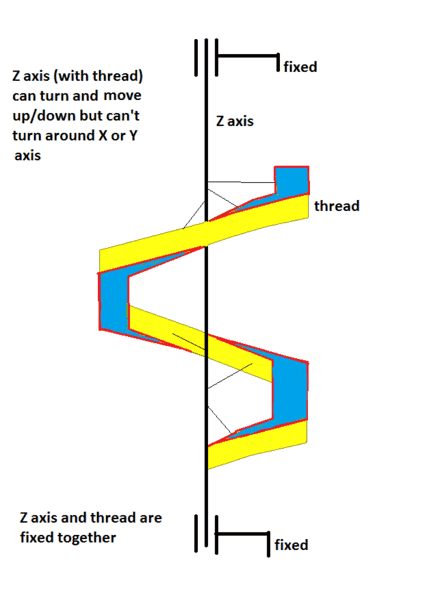

We can put the square thread like the drawing show. There is an axis but the thread can move free up/down. The sum up/down forces is 0. The X and Y axis can't turn.
  • #74
But this has no effect. Since the water films are not compressible, they keep the axis just in the center of the bearing. No radial force then.

Z axis is fixed with square thread. The square thread can only move up/down and turn around Z axis I think. The fixed threads are not fixed with Z axis. Where I wrote "fixed" in the drawing, supports of axis are fixed to fixed referential.
maybe it's the source of misunderstood. The film of water is not compressible, we have only gravity which create pressure.
  • #76
Yes I understand you but again its the fixed thread which cancel the torque not the axis of the thread, because the axis of the tread is not pushing against the bearing.

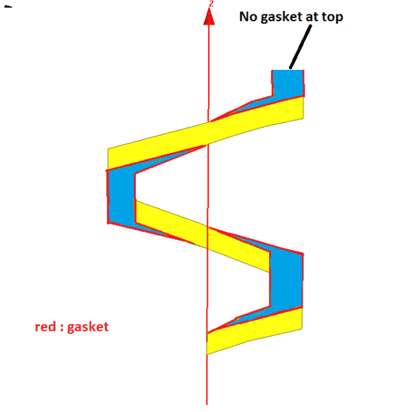

But I give a drawing of the square thread with open gasket at top if you think it's important. The water can't move down.
  • #82
You can even leave the lower gap filled with air. Only the upper film is filled with water. Yo can even fill it to a certain level. Again the axis cancels the torque.
Added: Sorry, in this case, the thread sits on the fixed thread.

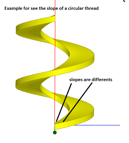

θ change with the radius, it is the slope of the thread. The pitch is the same at every radius but the length is bigger when the radius is increasing. With pitch = 1, when we pass from r=1 to r=3 we pass from sin(θ)=0.707 to sin(θ)= 0.316. The torque is not the same at each point of the thread, bigger if the radius is bigger.
  • #88
I can't imagine the slope of the thread in radial direction correctly. What are the slopes at r=0 and r=infinity?
The torque is bigger mainly due to increase in r itself.
  • #89
r->0, the slope -> 90°
r->infinity, the slope ->0°
See last message for the drawing, the slopes are visible on the circular thread.
  • #90
I don't get it. Normal to surface a any point makes an angle with Z axis. does the angle depends on r?
  • #91
for me yes, you can't see the drawing ?

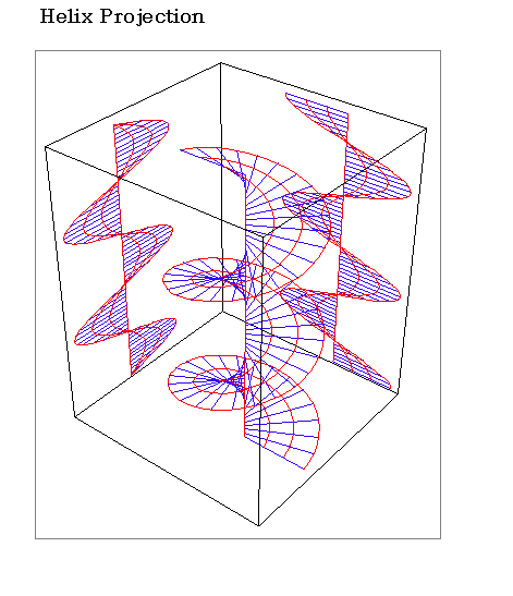

  • #92
I'm working about the angle and the torque.
The equation of a helicoid is:
x=v*cos(u)
y=v*sin(u)
z=u
With u and v reals, v is the radius, u is the altitude
Perpendicular vector or normal vector (n) to the surface is :
n = v1 x v2 with "x" cross product and v1, v2 two vectors of the tangent plane
Vector=(v*cos(u), v*sin(u), u)
v1=dVector/du=(-v*sin(u), v*cos(u), 1)
v2=dVector/dv=(cos(u, sin(u), 0)
n = v1 x v2 = (sin(u), -cos(u), v)
We can see the angle of the perpendicular vector to the surface, it's like we said before.
I'm trying to do the full torque around Z axis.

For the helocoid, you can find a formula by relating the surface element to its projection on xy plane.
How can I do ?
Like the drawing ? maybe sin(a)+cos(a) ?
