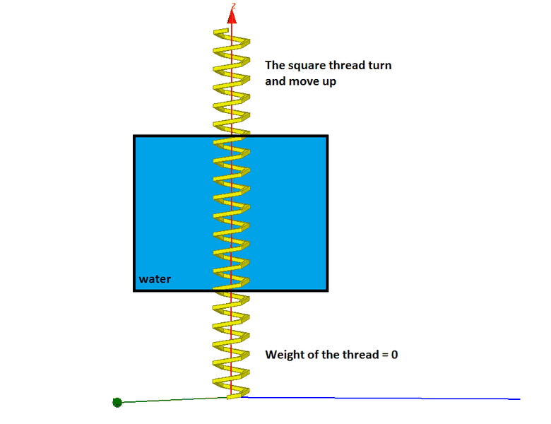

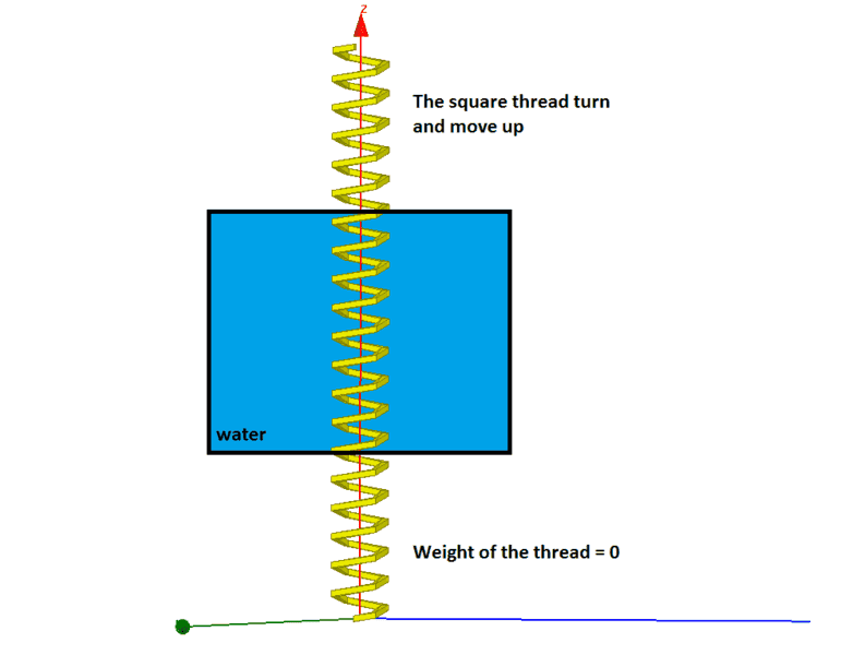

Torque on a square screw full with water
In summary, the conversation discusses the calculation of torque on a color square screw filled with water. The problem lies in finding where the torque at each corner of the screw is canceled by another part of the screw. The conversation covers different views and shapes, such as circular and square threads, and the role of gaskets and water in canceling the torque. The final conclusion is that the forces on the screw are balanced by the forces on the gaskets, resulting in no net torque.
  • #106
Here the code, I have verified with circular thread (cut if in the program), it's ok, with calculator : torque = pi*2*pi*(2*pi/10)*100000=1 240 251 Nm, and with program I found 1 240 412 Nm 5 digits for accuracy. Torque=v*(uLimit-u)/10.0*(sin(a)/cos(a))*pas*pas;
With square thread:
d=0rd/s => Torque=221 544 Nm
d=-0.5rd/s => Torque=223 990 Nm
There is a difference.
I think if we make uLimit half, the torque becomes half too.
If you divided by 2 proof, you divided by 4 the torque because surface is half and pressure is half. With square thread, not exactly divided by 4 because the thread is square (depend of the start and end).
There always a torque with the square thread if the program is good, especially the torque.

  • #107

  • #109
First, In you code, in general, a=atan(1/v) . But for 2pi span, the result is fine.
The equation for local torque is then simplified to Torque=(uLimit-u)/10*pas*pas.
This is due to the upper surface. How about the lower surface. Also remember that the gasket is elastic. If the torque or force from one side causes deformation it, it applies a force on the surface.
  • #110
The upper surface is for example d=0 rd and the lower surface is with d=-0.5 rd. This is what I said there is a torque (I take upper torque less lower torque).
First, In you code, in general, a=atan(1/v) . But for 2pi span, the result is fine. The equation for local torque is then simplified to Torque=(uLimit-u)/10*pas*pas.
For you the result in my program is not fine ? You suppress sin and cos ?
For me the force on the gasket can be near zero. Except the problem of capillary action we can take the film very low as possible. And the square thread fixed the gasket on it so the deformation can be limited. It's only a technical problem.
I don't see where is another torque or another force which cancel this torque.

  • #114
You just calculated a net force due to the upper water.
Not at all, the upper force is give with square thread when d = 0 rd. The lower force is give with square thread when d=-0.5 rd (it's an example).
Show the 2 drawings below (circular thread for understand easily)
First drawing d=0 rd
Second drawing d= -0.5 rd
Third drawing with 2 threads
