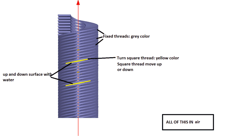

Yes that's the formula for the torque due to surface force at that point. For the total torque, we should calculate the force due to all surface forces, includeing the cut srface. Did you have a reason to ignore the forces on the cut surface? Perhaps you think these forces are parallel with r and cause no torque. But if the were paralled with r everywhere, they wouldn't cancel the hydraulic force on the turning thread surfaces and the surface would move in the force direction.
  • #62
What is the cut surface ? See the message #58 for explain please. The surfaces with water is only up and down surfaces not sides.
  • #63
Only water where you see blue color. The all system is in air.
  • #64
Ok, If you assume the thread to be like what we see in message #58, it has a degree of freedom in directions other than the z- axis. But of course you don:t mean that's all the model. When we consider the thread to be fixed from sides, we are assuming some forces from sides to cancell the lateral focres.
If you assume that the thread is that square only, then the analysis would be different. For a free body, we can define torque?

  • #72
Seems here is your problem: The axis of the thread is not fixed by a bearing or something. It can't cancel any force or torque. In fact the torque is canceled by the fixed thread through the water films. The reaction forces from the fixed thread is normal to the fixed there ( and also to the square thread) , it has x and y components too.
  • #73
We can put the square thread like the drawing show. There is an axis but the thread can move free up/down. The sum up/down forces is 0. The X and Y axis can't turn.
  • #74
But this has no effect. Since the water films are not compressible, they keep the axis just in the center of the bearing. No radial force then.
  • #75
Z axis is fixed with square thread. The square thread can only move up/down and turn around Z axis I think. The fixed threads are not fixed with Z axis. Where I wrote "fixed" in the drawing, supports of axis are fixed to fixed referential.

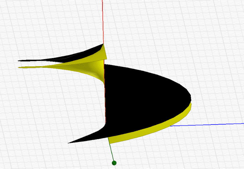

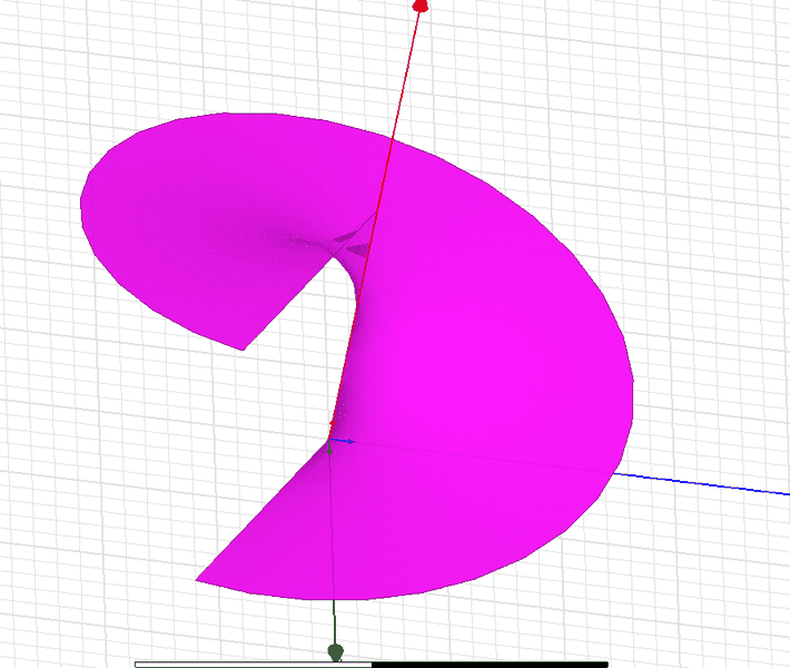

  • #87
θ change with the radius, it is the slope of the thread. The pitch is the same at every radius but the length is bigger when the radius is increasing. With pitch = 1, when we pass from r=1 to r=3 we pass from sin(θ)=0.707 to sin(θ)= 0.316. The torque is not the same at each point of the thread, bigger if the radius is bigger.

I can't imagine the slope of the thread in radial direction correctly. What are the slopes at r=0 and r=infinity?
The torque is bigger mainly due to increase in r itself.
  • #89
r->0, the slope -> 90°
r->infinity, the slope ->0°
See last message for the drawing, the slopes are visible on the circular thread.
  • #90
I don't get it. Normal to surface a any point makes an angle with Z axis. does the angle depends on r?
