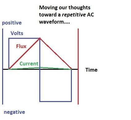

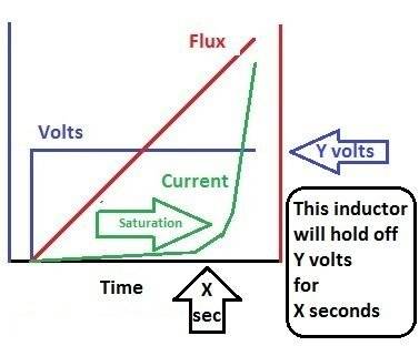

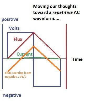

Reason i pushed so hard back there for square wave volts and triangle flux is
1. it's obvious to the eye they have that derivative-integral relationship
2. it's easier to show that you get a DC component when both start at zero.
I was scared to tackle that calculus explanation, and Paint doesn't have sine waves so i had to snip and paste them in but it turned out easier than expected.
Thanks for sticking with me.
Probably next is to figure out why a real transformer loses any DC component it might've picked up in first half cycle.
Then look at what happens when AC voltage to a transformer includes a small DC component.

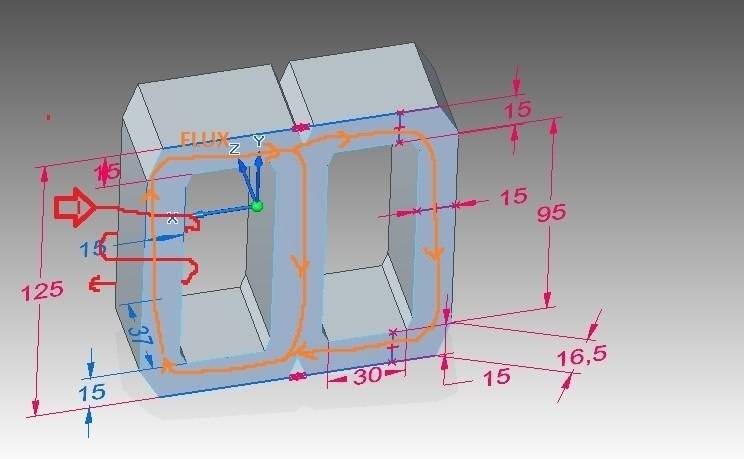

You're lucky to have a core like that with windows big enough to pass wires through.
Maybe a ten turn search coil on each one would be handy - makes enough volts to see on a meter and it's easy to figure volts per turn.
Hmm... if you made your search coils 10/pi turns your voltmeter would indicate milliwebers, wouldn't it ? 31 turns would be within 2%.
One might also factor core area into his number of turns and make the voltmeter indicateTeslas...
But that's just idle daydreaming.
This i think you'll enjoy -
Try exciting the center leg to about 1/2T
measure volts in both outside legs
Next place a single shorted turn around one outside leg, You'll be surprised how small is the spark it makes.
Then measure voltage in both outside legs again.
You'll see the shorted turn has pushed flux from one outside leg over to the other.
MMF at work !

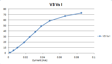

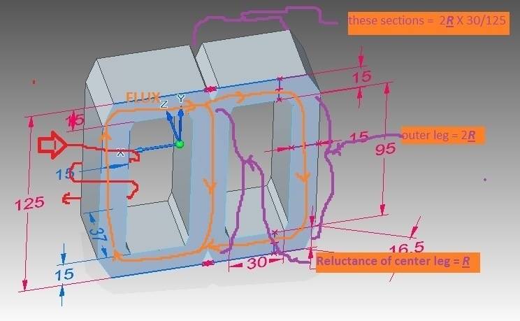

Hey, I only just got onto the forums so I'm still upto post #99.
But unfortunately I'm not going to be getting a chance to see that core/coils again until after my thesis is due, so if I didn't get enough data, tough for me, but it's all simulation from here on.

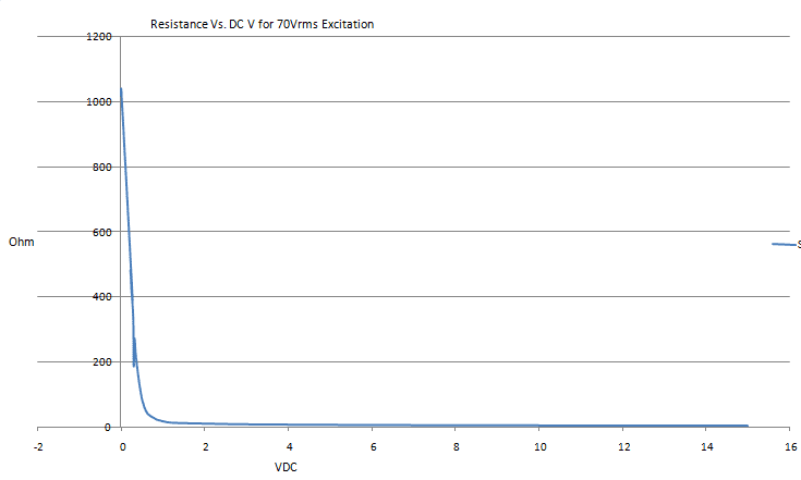

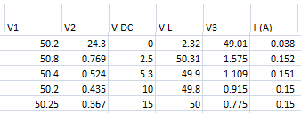

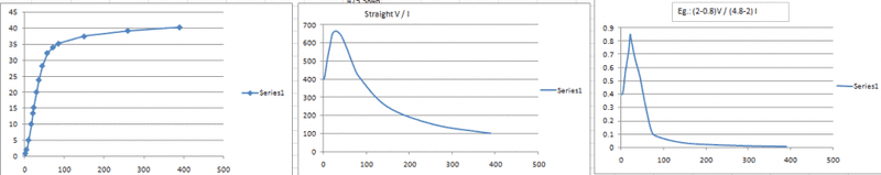

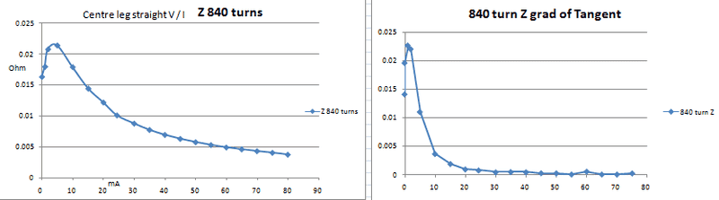

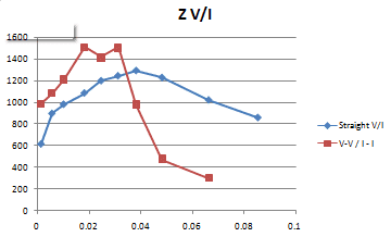

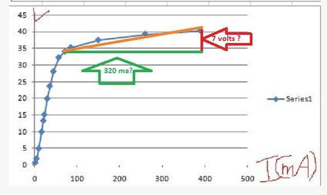

While I catch up I was thinking if you wanted to help me understand about how to know where I was sitting on that BH curve while I was exciting the outside coils at different voltages, I tried to measure inductance at different voltages over different DC centre leg excitations, tell me what you think of the result:

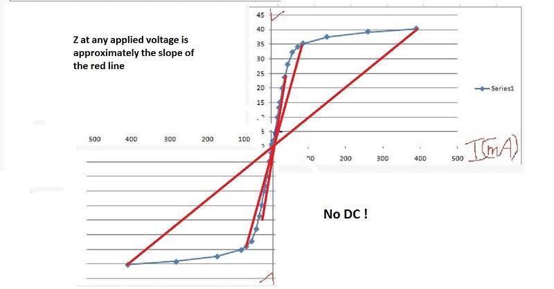

(So I took data in sets of 10VAC increments excitation to the outter legs) I took heaps more readings around 70V between 0V DC and 0.9V DC to the centre leg, as you can see.
At each of those voltages, along the vertical axis where VDC is zero, where am I operating on the BH curve? What is the volts per Hz? (I was thinking about peak B of V/NwA but that doesn't seem to make sense to me yet because that number was lower than I expected from the curve...I still need to read over all your replies so I can learn how volts/Hz actuallly works)

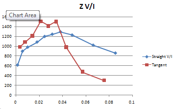

Why does it appear as though around 50V AC excitation has the biggest 0V DC, inductance? Is this the peak inductance: like steepest change in BH curve (flux per amp), we were talking about before?

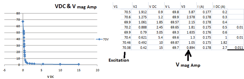

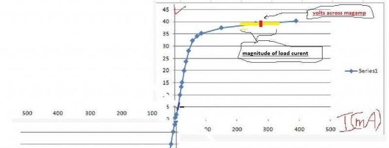

Here's a graph of the AC voltage over the outside coils (vertical axis) Vs the DC excitation voltage applied to the centre leg (horizontal axis) is the independant variable:

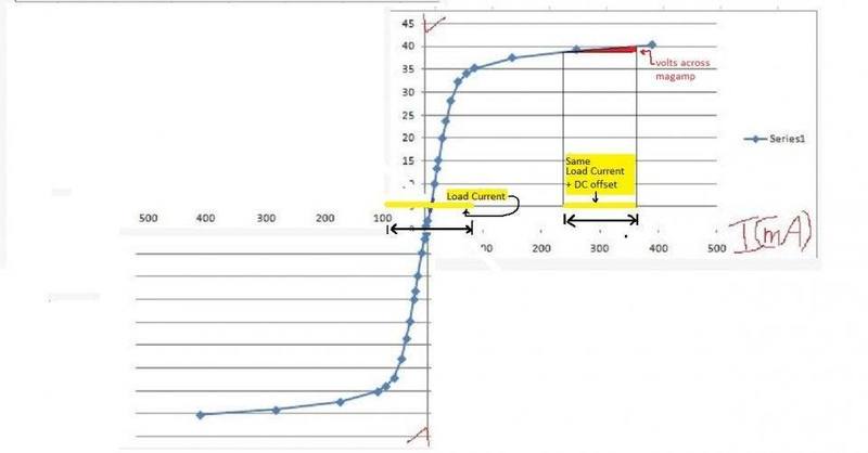

You can see the voltage drops on the Mag Amp (goin onto the load instead).
I'd also like to know here, how as I adjust the DC what is happening to where I'm sitting on the BH curve.
Thanks

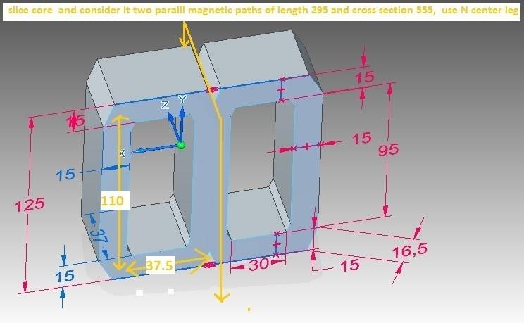

  • #108

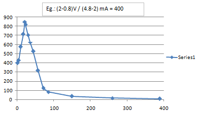

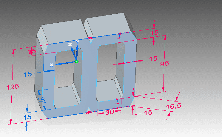

if we take the bottom one, your outer coil V-I measurements i think , as the BH curve
let's think basics
200 turns
e = n dΦ / dt and for sinusoids d/dt of sin(ωt) = ωcos(ωt) and at your 50 hz ω = 100 pi
e = 200 * 100pi * Φ inwebers
so one volt rms would be rms flux of 1/(200 *100pi) = 15.9 microwebers rms at 50 hz,
>>>>sanity check - you saturate around 36 volts, 36 X 15.9 = 573 microwebers
in area of 555 micro-m^2 (from post 104) = 1.03 Teslas, which seems reasonable because peak is higher by √2 . <<<
interesting - 1.03 Tesla at 36 volts = 35 volts per Tesla, a nice round number for this core

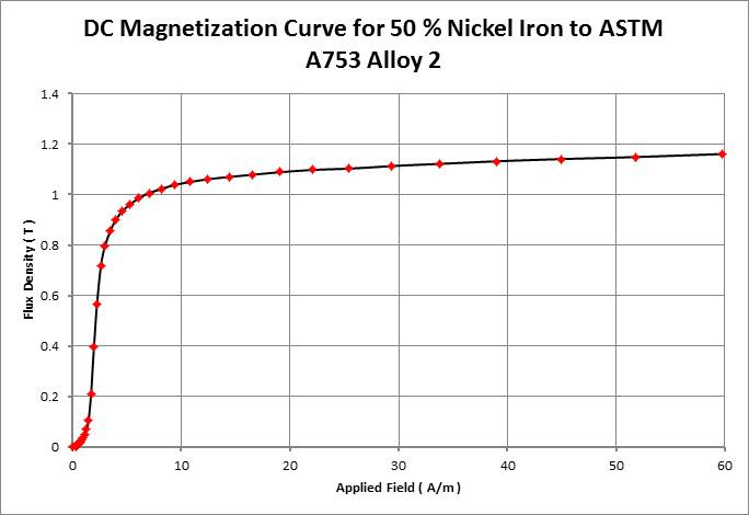

Okay , with no DC you operate from the bottom of your BH curve up to whatever voltage you're applying.
Realizing the BH curve is symmetrical and we're only looking at one quadrant
30 volts would be 0.86 Tesla
you are sweeping along orange line, up and down that curve, same distance into opposite quadrant, at 50 hz.
That conflicts with graph immediately above - you are well saturated by 38 volts so it should be really buzzing if not smoking by 70 volts on one leg.
Perhaps you had the two outer legs in series, aiding ?

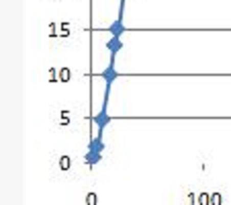

I'll assume the two outboard coils were in series, so your graph shows twice the voltage of each coil - your graph just above was unambiguously described in post 86 as one coil...
Looking at your chart, 40V is next highest, 60 and 30 tied for third place.
That'd cover the range 15 to 30 volts per coil
here's a zoom of your curve , looks to me like the steepest part of the curve.
Not bad for empirical data i'd say.

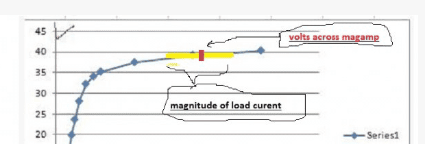

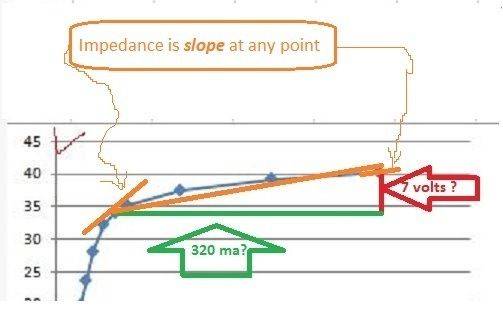

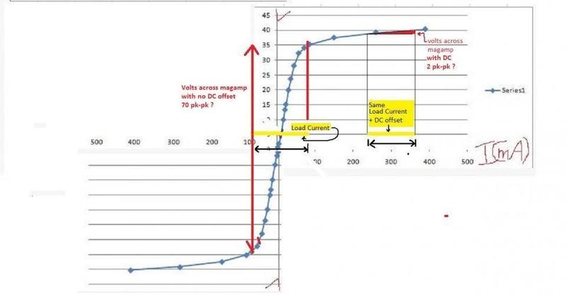

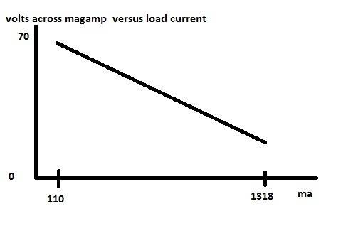

Kinda hard to say without knowing how steady is the current through the middle winding.
If you just have a DC voltage supply across that winding, there might be considerable AC fed into it from the load current. in the outboard legs
You'd like to be operating with small voltage across the magamp, way out here on the BH curve.
remember you sweep that orange line 50 times a second, staying in this quadrant.
and that you dropped to such low voltage across your core says you probably made it.
It'd be interesting to know if there's a DC component in your load current. Do you measure it with DMM ?

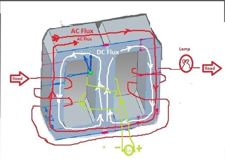

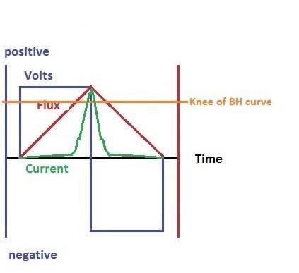

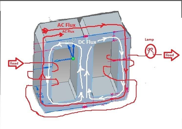

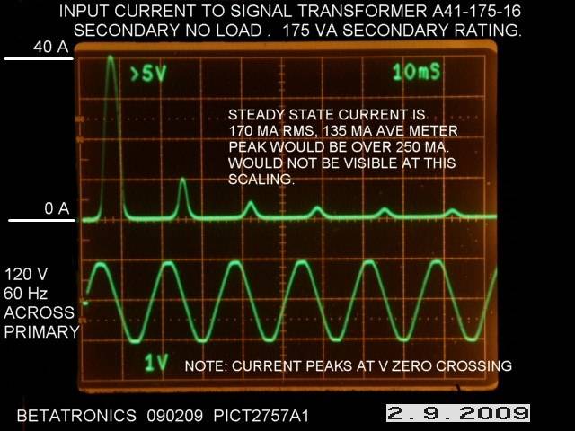

Hey Jim, sorry I've been out all day, I started looking at the calculus (trying to figure/straighten it out in my head) so I'm still way back at that post. But I saw you just replied and I thought I should start to add a few things before they start piling up again.
jim hardy said:
Exactly. It fires at the peak instead of at the zero crossing, or randomly.
Sorry, so why do you fire at the peak for an inductive load?
Indeed I did, and yes they were still buzzing a bit. This diagram is way over due sorry:

  • #113
so you're not starting from flux and voltage both zero, which is what gives you that huge inrush.
Think of it this way - inductor wants flux and voltage 90 deg out of phase.
When they both start at zero they're in phase
start with one at zero and other at peak and you're starting with correct phase between them
the calc exercise shows that
yeah, rms readings so peak flux is on up "round the bend" a little .
looks like you've got fig 8.
Are you trying to make a good magamp? Self saturating has way higher gain, but it's been so many years now i'll have to re-study them myself.
Don't quote me as being certain about this next statement, I think it's basically right but it's not working in my head just now:
CAVEAT from old memories , offered only as a starting place for discussion
... they use rectifiers so each half of the core sees rectified DC voltage, needs only have enough volt-second capability to stay shut off during its half cycle.. Control winding establishes starting flux , once it starts to conduct load current helps it saturate and that positive feedback gives it tremendous gain.
That's on-off control, high gain. If you want to use it as a linear amplifying device you surround that high gain block with negative feedback, just like any op-amp.
Early submarines like Nautilus had magamp instrumentation, as did Yankee Rowe power plant. Only trouble with it is it's so reliable nobody gets a chance to learn how to fix it.
Be aware currents are really distorted , every book I've seen says magamps defy mathematical analysis. Do you guys have a current probe ?

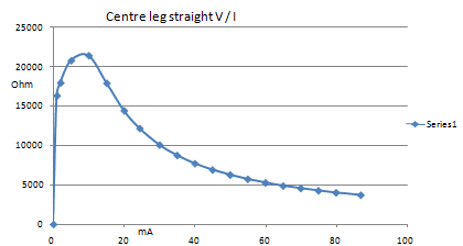

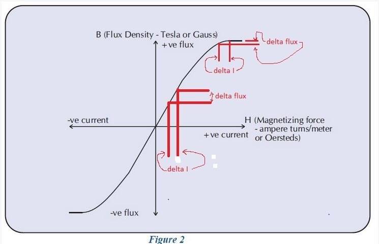

I'm really just experimentally getting some data so I can get my head around how to control the inductance of the core (my project is to use a magnetically confined array to make a better variable inductor). Are you saying that if I wrapped some short circuit turns around the centre and open circuit/short circuited it to control it, that would be self saturating, and would have higher gain?
We do, but I won't be back there until closer to the end of the year when my uni work is finished. So I'm on my own with just the data now.

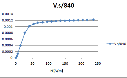

I thought I'd asked you, and that you'd said the way I taken my BH curve data was like this:
(the one on the right is meant to be a hysteresis 4quadrant curve) Because I used AC, not a time sweep DC, however looking at my curves again, they start from zero too. So are my curves just the same as the alternate DC way?
  • #115
Yes. Early on you mad remarks like "flux takes the shape of bh curve" that left me wondering what could he possibly mean
so i started at ground zero
found "the pain of PAINT" excruciating and hard to face some mornings
i hope it's helped you with the very basics.

So a 'self-saturating' mag amp looks like this (?):
Because I tried replacing the AC input (In post #111, on the left where it has the picture of both halves of the cycle) and instead using a rectified ac supply, with no capacitor, so the excitation looked like humps going up to a peak than down to zero only above the time axis:
But it didn't work, it was like there was no inductance, Would you still have the same d(fi)/dt ? Would this have any affect on the inductance?
For arguments sake, say I made a mistake and it looked like this:
Would you have half the inductance? Or next to no inductance? Because there is a possibility this is the circuit it tried accidentially because I didn't really know which way the diodes were pointing :-|Ok, I get that the integral of Sin was started at zero when it should have been started at -1, making it go from 0 to 2; but in practice, if you plug a TX in and start using it, in steady state operation does it work it's way back to -1, +1 oscillations of flux?

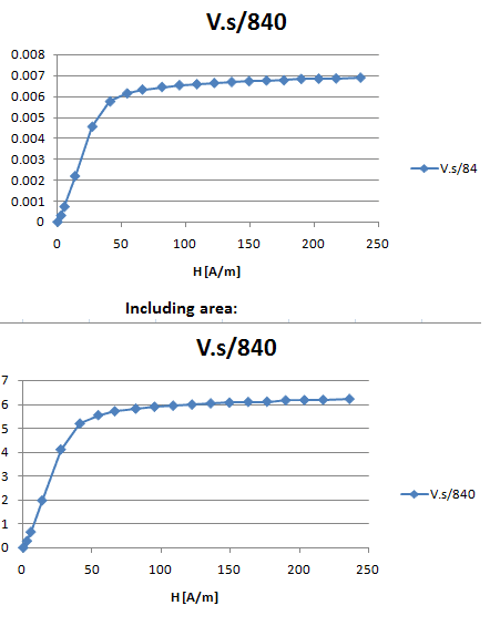

jim hardy said:
15 milliamps through 840 turns is 12.6 amp-turns
and 213 volts in 840 turns is 0.253 volts per turn
e = n dΦ/dt , 1 turn, so dΦ/dt = 0.253 webers/sec
assuming sinusoid, dsin(wt) = wcos(wt) and at 50 hz w is 100pi
so
.253 = 100pi X Φ
Φ = .253/100pi = 8.05E-4 webers
Ok, so RMS flux.
jim hardy said:
bottom curve 35 volts in 200 turns on 555mm^2 ?
.17 volts per turn ?
what do you get for flux?
.17/100pi = 5.4E-4 weber/555E-6m^2 = .97 T
Dontcha just LOve it when math works out !
would that be 0.0097 T after the mm correction?
So what did you think the permeability of the core would be?
So maximum inductance is between: 15 V per coil (two coils) to 30 v per coil (two coils). Which is about 25V per coil meaning H = about 40.2mA*200turns = 8.04 [A/m] in each of the outside legs at maximum inductance.
No I didn't measure the current on the load with a DMM, just the one you saw in the picture. How could there possibly be a DC component on the load?
There was next-to-no AC put on the centre leg, about 0.007 VAC wasn't cancelled, I think the current through the centre winding was pretty steady.
As you can see from the graph I did get a small operating voltage across the mag Amp when there was a DC voltage of 15V, there was a voltage of 0.894V AC on the mag Amp.
So when designing for maximum inductance I need to know the...is it the Volt-seconds, (or volt-seconds per turn?) For a given AC excitation voltage that will give me the steepest point on the BH curve for that particular steel, then design the cross-sec area to be at that point (maximum change in flux per Amp) on the curve for the excitation AC, when the DC voltage is zero. Then I can have full reign over the possible inductive-spectrum for my mag Amp?
EDIT: This is tricky in my head because I always sort of thought, the bigger the core was and the more turns you wrapped around it, the bigger the inductance, but if you wrap too many turns around it you start to move the operating point away from the steepest point on the curve and the inductance actually starts to drop. So it's like you're operating point is defined by the material (μ) and to get to that point for a given voltage you need to design the core size so the area isn't too big or too small.
This is getting very fun

  • #123
You asked how does the flux in a transformer work its way back to symmetry after an unfortunate energization at sinewave zero crossing.
I said i didnt have the words just then ,
well,
they came while i was at monday night poker.
But i still need a picture to convey the thought.
The reason is something you mentioned eons ago - voltage drop in primary winding resistance.
Go wayyyyyy back to our model of a transformer
XM is where we make flux
and voltage applied to XM determines what that flux must be ; flux must be integral of that voltage..
When we saturate we get increased current which lowers voltage EP that's applied to XM and the ideal transformer.
Ip X Rp is that drop
You'd think it'd be symmetric, eh ?
Take a closer look
Since we only saturate on one side of zero , that Ip Rp drop is asymmetrical. Lenz's law gets involved too.
As you know i like square and triangle waves because they make the integral-derivative relation so obvious.
So i marked up one of the earlier ones . It was for ideal transformer, and i added influence if primary resistance to it in chartreuse.
Pardon my awkward drawing, I'm a total klutz.
I hope this picture is worth a few hundred words at least...
Observe when core starts to saturate, voltage applied to XM droops a bit because of drop across RP.
That rounds off the corner of the wave as shown by my chartreuse curve.
When the applied square wave voltage flips negative...
XM , obeying Lenz's Law, also flips polarity to maintain current.
KVL says now voltage across XM must be larger than Vsupply instead of smaller,
so that bottom corner of the square wave gets its corner not rounded but spiked - see my chartreuse "pointy" in sketch above.
So what dos that do to the volt-seconds applied to XM ? It obviously makes the areas above and below zero unequal and in the direction to drive flux back toward zero centered.
The key is Lenz flips polarity of induced voltage but IR drop doesn't flip polarity,
so we have
Ep = Vsupply - IpRp in the positive half cycle
but
Ep = Vsupply + IpRp in the negative half cycle
so - Mother Nature, Calculus, Lenz, Kirchoff , Steinmetz and Tesla all conspired to make transformers that work well..
I wasn't too far off when i said the energy in the DC magnetic field gets dissipated in the winding resistance, and the numbers might work out that way i don't know .
My point is - armed with these simple models we can figure out what is happening, and from there we can figure out the equations.Transformers are cool, eh ?
Had a thought on magamp BH curves too.
I think you can look at an operating magamp as a triangle on the BH curve.
Need to work on words, though...
Here's one pretty well turned "ON"
and this one's pretty well "OFF"
so if your data has AC volts and AC current readings
see if you can figure out a graphical solution - you've already graphed BH curve for your core . Do your datapoints have AC voltage and AC current readings ?

1. So what did you think permiability μ of my core might be? (I assume the value they usually talk about is μ at the knee)
I looked up AL (from your chart, the one with the 'nh' mystry terms) which is apparently the 'inductance factor'. But I'm still none the wiser as to how or what those terms are in relation to the inductance factor.

I had been trying to calculate μpeak from the 840 turn leg before, and I thought I was getting a nonsense result, but I actually think it might be correct, what do you think:
Peak μrelative = 0.7 Tesla / (840 turns * 10mA * 4π*10-7) = 66,3146
Off to bed now I think

no length anywhere in there ?
Φ = μ μ0 N I A / L
Φ/A = μ μ0 N I / L = B
μ = BL / ( μ0 N I )
I think we need to get this core working better in your head.

tim9000 said:
What solution are you tasking me to?
Envision your operating locus on the 2-quadrant excitation curve.
Then from your measurements, draw it on the curve.
You doubtless have numbers written down, i'll have to extrapolate them from the graph
Let us take your AC excitation curve from post 86 and make it two quadrant so it resembles a DC BH curve.
With no DC present, applying let us say 15 volts to both outer legs of your core gives us what, 20 milliamps ?
Now with the two quadrant graph we can imagine current sweeping negative and positive 20 ma at line frequency, and voltage sweeping positive and negative 15..
I'll make current green, voltage red.
Now let's add some DC to your center winding, leave outer ones alone.
That's the same as adding a DC component to your outer leg excitation voltage, is it not ?
So your operating point shifts.
observe the same AC voltage let's through a lot more current.
But - there's a load in series
so the magamp will drop less of the supply voltage, and the load more.
I'd be curious if the voltages across your two outboard coils remain equal to one another.
As you observed in your post # 107
Won't the voltage across and current through your coils tell you where you're sitting on the BH curve ??2am here , off to bed for me.

No, I forgot that; I just used μr = [B/NI] /4piE-7
used the B you calculated (0.7T) and said H = 840*10mA, forgetting the length term (Also, I might have forgotten the decimal point before the last digit (the 6) :-| )
SO, say the length is about 95 + 16.5mm:
It should approximately be μr = [0.7/(840*10*10-3/(0.095+0.0165))] /4piE-7
=7,394, owch! that's low.
That picture explains a jolly lot! Yes about 20mA is about right. That is a fantastic way of thinking about it, with a 'but'.
I suppose when you put it like that, so the magnitude of the green vector plus the current that was flowing at zero DC, is the amount of how much RMS current I'm pushing through the mag amp to the load. That really is fantastic, but I think there's a translation between DC current which would be on the top graph and the green current you drew on the bottom graph.
To my way of thinking, you'd have say an offset of 40mA on the top graph, which would result in the red vertical line, and where that red line intersects the curve, that is the operating point in the outter legs too. I'll elaborate:
Are both those curves the same? Just scaled? (like H scaled by the amount of turns between centre leg and outer leg, and the different path lengths between centre leg and outer leg. And B scaled by the difference in cross sectional area) I had assumed they were the same curve, as a property of the steel but now I'm not sure.
When I tried to do the above I get:
0.175/(100π*555*10-3) = 0.0018 T, at the knee of the outer leg, shouldnt' it be 0.7?
Ok, just assuming the outter and centre legs have the same curve, and we're putting 15V AC excitation on the mag Amp's outter coils, we then have 20mA through the mag amp with zero DC on the centre.
So the outer leg offset is that shifted from the existing current the curve was at, or from zero, (including the yellow line I drew)? I'm assuming it is from the curve itself and not from zero (i.e. how you had previously drawn it).
So the point from 40mA DC on the right translates into the point where the red line intersects the curve on the left (same part of the curve), and you come down that red line and go across the the curve where your 15V AC is and the length of the green vector is something like 200mA - 20mA, and the total current through the mag Amp is something like 200mA?
I could see it was saturating, but I wasn't sure how to think about exactly where I was sitting.
I'm quite confident the coils have about the same voltage, I took the voltage of one outside coil (V2), say for 50VAC applied, from 0 to 15 V DC on centre:
24.3V
0.769V
0.524V
0.435V
0.367V
and the whole mag Amp (V3 over both coils):
49.01V
1.575V
1.109V
0.915V
0.775V
so they seem about even, if that's what you meant about them being equal.

I made this curve in paint by just copy, flip and rotate your AC curve then paste them together
wanted you to think in terms of a DC curve, sweeping independent variable back and forth,
at first symmetric about zero current
then symmetric about some DC offset because that's what is going on in your magamp.
Here i tried to draw a voltage swing of +/- 15 volts (i was shooting for 10 volts rms but lacked resolution of the graph, call it 10 or 11 volts ?)
and to see how much current the magamp allows to flow
and it looked to me like maybe 20 ma
then by shifting the outside legs from zero centered to some point up the BH curve(coulda gone down, won't matter) ,
Whether i made that shift by adding DC to my excitation voltage
or by pushing DC flux into outer legs via DC on center winding is immaterial
so i don't see the need of your center leg curve above - maybe you copied that while i was still trying to get my images squared away,
(WinTenTin gave me fits so I'm back on 7 now)
my point was
adding DC moves you to a part of the curve where sweeping current gives you less counter-EMF so the magamp's impedance collapses
and that's how magamps work
and i think that clicked with you.
Now I'm wondering how flux flows around your core
Since your outside leg AC voltages add, your AC flux doubtless circulates around outside
and since you measured virtually no AC on center leg, AC flux must bypass center leg, which is not surprising since the mmfs of outside leg windings are at the instant i pictured one up and one down so they cancel.
but center leg's DC MMF pushes both outer legs into saturation region.
Observe that in outer legs,
DC MMF opposes AC MMF for half of every AC cycle
and i think that's why the self saturating magamp has so much more gain, its diodes relieve that tug of war. But that's for later on.
But - it's why i was curious about DC components in voltage or current.

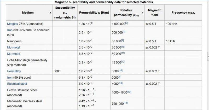

Where was i going ? Probably to try an estimate of your core's relative permeability.
Do you have a published number for it ? Look carefully and see if they give two numbers, one for DC and one for line frequency.
nh/t^2 i am petty sure is nanohenries per turn squared and i remember it as being a clever shortcut
when details come back i'll try to remember to show that trick
seems it somehow took a lot of dimensions out of the arithmetic
but you'll probably figure it out first

Okay i'm, confused about which curves you are talking about.
Sorry, I meant the curve I recorded for the centre leg, and the curve I recorded for the outside legs. They should be the same curve at heart, but scaled shouldn't they?
Speaking of, what did you think of:
yes, same at heart.
Scaled for number of turns and core area.
Is cross section of center leg twice that of outside legs ? I assumed so .
So center leg excited by itself has area of X,
but a single outside leg excited by itself has a longer magnetic path with segments of a couple different cross sections. Smallest cross section will saturate first. If both are excited together aiding so as to leave center leg essentiallly zero, you have uniform cross section around the outside loop.
tim9000 said:
Is there any actual need for the centre leg to be double the Area of the outside legs, what would happen if they were uniform?
well think about how the DC saturates the core. If center leg is to pass enough flux to saturate both outside legs, mustn't center leg have cross section area equal to total of both outside legs ?
Everything saturates in the neighborhood of a Tesla, but Tesla is flux density:: flux/area.
outside legs are 15 X 37 millimeters = .000555 sq meters, so 1 tesla = .000555 webers
The DC flux coming down the outside legs returns up the center leg so it should carry .000555 X 2 = .00111webers
and to carry that much flux without saturating, center leg needs area equal to .00111 m^2, sum of two outside legs.
Your AC curves show outside legs reach saturation at about 4X the current that saturated center leg
and they have about 1/4 the number of turns
so that's consistent
center leg gave 0.253 volts per turn
outers gave 0.17 volts per turn
0.253/.017 edit - oops, 0.17 is a ratio of 1.49
inferring either center leg carries 1.49 X as much flux as outers?
i don't see its thickness on your sketch so don't know its area. 1.49 X thickness of outer legs is 22.3 mm.

You find that value of B on your 4 quadrant hysteresis curve,
okay stop right there.
You have a system consisting of the magamp and its load, assume fixed supply.
You cannot define three things at once. One is the ratio(or some function) of the other two, define two and the third falls out by arithmetic.
You have now only identified a point on the operating curve of that core.
The slope at that point tells you how many volts per milliamp the magamp winding will develop at that operating point..
Volts/current = ohms
so you have a series circuit a loop consisting of Vsupply in series with Z of load and Z of magamp.
now you can calculate expected current in the loop and expected volts across the magamp by ohm's law
tim9000 said:
and the current for the excitation voltage (say 15V) when there is zero DC for an outside leg is the AC oscillation on the offset operating point (yellow region say +/- 20mA):
and i just can't parse that phrase...
So the current put through the mag amp to the load when there is a DC applied to the centre leg will be (200mA + 20mA /√2 )? And the impedance collaps will mean that there is verry little back emf voltage on the Amp, meaning all the power is now being used in the load.
The current will be determined by ohm's law, using Vsupply, Z load, and estimated Zmagamp from slope at the operating point.
It's going to be better determined by characterizing your magamp, as you did, than by calculations.
That was this curve of yours from post 107
wish you'd plotted DC current through those 840 turns rather than volts across them.
The height of your red mark here
will be the volts on your VDC & V3 curve just above.
The width of your yellow mark will be the current through load and magamp's outer legs.
horizontal lines from top and bottom of red mark ought to intersect the curve at ends of yellow mark
so you see, like they said the magamp is an adjustable impedance
and it's probably nonlinear when operated in vicinity of the knee.

I thought "Wow that's more reasonable, though i'd expect lower yet unless it's some exotic high-mu alloy ."
And i thought "i'll try to calculate a number when i get caught up"
Take out the center leg and try calculating volts per turn for air core with both windings energized
relative permeability at 50 hz is that number divided into your measured volts per turn, below the knee.

observe that as AC current reverses direction, it alternately aids and opposes flux in each outer leg
so i expected some AC voltage to be induced into the center leg
and in that textbook i cited they describe adding a choke in series with control winding to prevent that AC voltage from modulating control current.
So i was surprised by your reading almost no AC on center winding.
what's DC resistance of the windings ? Is IR drop negligible compared to AC induced voltage? Could that make volts per turn ou outer legs appear high ? Or do you think the center leg's turns only encircle 1.49X as much flux as outer leg ones ?
Yes you're quite right, and you've just highlited a mistake in my computer generated sketch of the core, the un-numbered width of the core should be 30mm, which it looks to be smaller in the 3D graphic I drew. So the area should be around as you say:
But I'm not sure how that jells with:
jim hardy said:
0.253/.017 is a ratio of 1.49
?? Also, how are you getting near 1T for the outer leg, when I do it I get:
0.175/(100π*555*10-3) = 0.0018 T, at the knee of the outer leg, so shouldnt' it be 0.7? Where am I going wrong?
My way of thinking is that the current will 'wobble' between 0 A and whatever the peak current going through the load is, but the point on the curve for each leg will only wobble around the yellow line a little bit, due to the MMF of the turns on that leg and the current going through it (from zero to peak) because the MMF of that AC is small in comparison to the huge DC MMF passing through the leg. Ok...so on the notion of assessing how much AC current through my mag amp I can expect from applying a DC current to my control winding, what I think I'm hearing from you is, (assuming) constant AC excitation, forget whatever the current through the mag amp would have been at zero DC, when we were sweeping between on the 4quadrant curve, as soon as we are applying the DC we picture the (+ & - depending on which outside leg) B points on the centre curve because the curves are equivilant. So where the B would have been on the centre leg curve (through turns number and area) is where it is on the outer leg curve. We then say the point on the curve for all the legs is the same, except the impedance of the mag amp has collapsed thus V/Z has pushed up the mag amp current, thus the point on the curve for the outter legs will wobble by +/- 200turns*(Vsupply/Zdepending on DC current)
Better?
is the volts on your VDC & V3 curve just above.
Well we should be able to determine the current through the 840 turns, because we have the voltage and the resistance of the turns was 10.7 Ohms.
The resistance of the outter windings were 0.835 Ohms each leg.

i don't know why we got a ratio of 1.49 instead of 2 for center leg vs outer legs driven.
Maybe i;m not reading the graph well? Can you see at what currents you got 2X volts per turn ?
  • #136
No worries:
jim hardy said:
cant do any more tonite
try again in morning
I'd say the knee was actually at 297V, so:
a = 297/840 = 0.35357
b = 35/200 = 0.175
acentre length/ban outer length = 2.02
So the ratio of the 'rate of change of encircled flux' is = 2, so how do we know this directly relates to the actual amount of flux ratio between lengths?
from posts 103 and 104
your -3 should be -6, millimeters2
and when i plug { 0.175/(100π*555*10-6) } into windows calculator i get 1.00369, just call it 1.0
that knee looks like a tesla to me
whn i plug
  • #139
tim9000 said:
Better?
Sounds better, though i still haven't digested it .
Flux will wobble about the DC point on the BH curve
Push to the limit - at complete saturation the current is determined by Vsupply/Zload, let's say RMS as radon your meter
and now i see the error of my ways in earlier attempts...
yellow line has width Vsupply / Zload X 2√2
but flux is offset because of DC from control winding
so we can move it over here
and ends of yellow intersect our volts/amps curve, showing us what will be voltage swing across magamp - just a volt or so , not smallness of red line
slope of blue line is Z magamp
and we slide operating point from steep slope to almost no slope by DC on control winding.
That's a saturable reactor , which is the basic form of a magamp.
  • #140
ahh maybe this helps make it step by step
at some assumed load current
at zero DC offset your magamp would've eaten up 35 volts at that load current
leaving Vsupply - 35 across load
but with DC , practically all Vsupply is across load
you know that, though...
