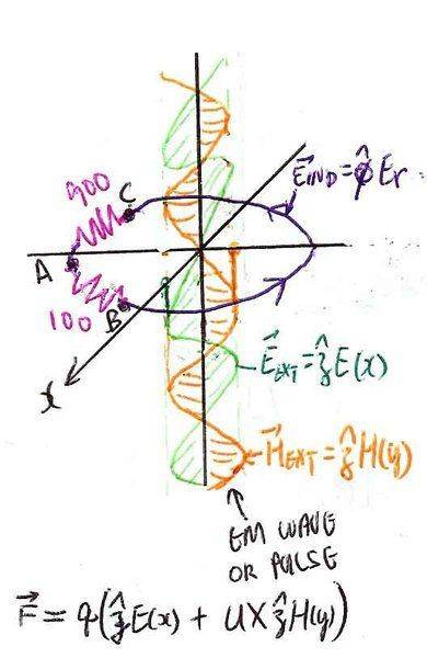

To avoid confusion, I upload a drawing which show Lorentz force:
\vec F = q ( \hat z E_{(x)} +\vec u X \hat z H_{(y)})
Where the \hat z E_(x) \;&\; \hat z H_{(y)} are the electromagnetic wave.
The induced E is \; \vec E_{EXT} \;=\; \hat {\phi} E_{(r)} \; as shown.
As you can see, \hat z E_(x) is normal to the loop and has no effect.
It would be opposit if instead of the loop, we have a straight wire in z direction. In this case, the E assert force on the electrons inside the wire, but here, the B has no effect because B is parallel to the wire.

In an e/m wave, E & H (B) are normal. I'll double check tonight, but I'm perplexed by your inference that the external B & E fileds are both along the z axis. For a transverse e/m wave, E & H/B are perpendicular to each other, not coincident. I'll get back later.
Claude

EM always goes in pair and field has to propergate along the z- axis in his experiment. Yes the E and in the EM wave are normal to each other, they just propagate in z direction.
Also you can look at it this way, \hat z E_{x} is occilating along x direction and it affect the loop both directions and the result cancel out and will not push electron either direction. Only the magnetic field moving the electrons by inducing the electric field along the loop. as shown in arrow on the loop.
I am no expert in EM, this is my understanding. I would not dare to challenge the professor's knowledge on EM, I challenge him on his set up where he drawn the conclusion.

Yes I did look. For a transmission line (2 wire, parallel or coax), the wave propagates in TEM (transverse electromagnetic) mode. So does a space wave. But for a waveguide, TE (transverse electric) & TM (transverse magnetic) modes exist, no TEM mode at all takes place.
For TEM mode, if wave propagation is along z axis, then E is in x axis, & H is in y axis, or any orientation in x-y plane normal to each other. For TE mode, propagation remains along z axis, E is in x axis, but H is in y-axis & z axis. E is transverse (normal) to prop, but H has 2 components, 1 normal to prop, & 1 coincident with prop. So if wave prop is in z axis, E is in x axis, H is in y & z axes. Only E is transverse to prop direction.
For a TM it's vice versa. So in Prof. Lewin's setup, only the TEM mode takes place. If energy is propagating in z direction, then E & H/B are normal to each other in x-y plane, as well as normal to prop.
"Inducing" an E field into the loop is a colloquial phrase. This E field is present in space regardless of whether or not the loop is there. H & E cannot exist independently under time changing conditions. Sorry to be late responding. Christmas season, shopping, fixing up the house, you know.

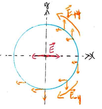

Yungman, please re-read your statements about the direction of E. TEM wave prop is in the z direction, we both agree on that. We both agree that this space wave is TEM. So if power is traveling along z axis, then E & H are normal to each other & mutually normal to the z axis. Thus E & H are in the x-y plane, normal to each other.
The loop is also in the x-y plane. When all charges in the resistors & conductors are at rest, an H field cannot move them since mag fields can only exert force on moving charges. To get these charges moving, an E field is required. Said E field must be in x-y plane tangential to the loop to move charge. The point of conflict seems to be how to associate E with H. I've already pointed out that E & H are normal in the x-y plane where the loop resides. Again, if the loop were removed from the vicinity where the TEM wave is located, there is still an E & an H field in the x-y plane.
Is H inducing E, or vice-versa? We get right back to a chicken & egg vicious circle. These forums have countless threads where this & similar issues perpetuate ad infinitum. E does not "induce" H, & vice-versa. When the loop is immersed into the TEM space wave, the H cannot move the charges since they are still. But the E field can. This E field per FL exerts a force on charges per Felec = q*E. This is Lorentz' law.
But the force will result in motion & once the charges are moving, the H field, which is normal to the charge velocity, exerts a force as well per Fmag = q*(u X B). The total force is F = Felec + Fmag = q*(E + u X B).
Again, under time changing conditions, i.e. the "ac" domain, E & H are Siamese twins as they only travel together. They are 2 arms on the same beast, 2 sides of the same coin, 2 domains of the same energy, etc. The phrase "induction" is used quite loosely. The E field which motivates the charges to move, is joined at the hip with its twin, the H field. Faraday & Lorentz both apply w/o exception.
As far as the lumped parameter emf source being added to the equiv circuit, vs. the distributed parameter version, both give the right answer. But the prof point is all important. I stated earlier that in order to add the emf source into the equiv circuit, we must know its value. To do that we must measure the sum of the voltage drops across each resistor in the loop.
This sum will not always equal zero. The measured non-zero value can then be added into the equiv circuit as an independent voltage source. Then, the sum of voltages around a loop does indeed equal zero.
In order to draw the lumped equiv circuit, you must measure the sum of voltages around the distributed loop, which is usually non-zero. So the distributed circuit non-zero measured value provides the correct value for the included voltage source.
This is way too long, & we've covered it all. No debate is needed, since all phenomena are accounted for. I'll clarify if needed. BR.
Claude

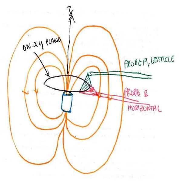

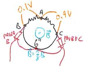

Which part of the wire forming the loop that the flux go through in the middle of the loop like the drawing the professor had in the first video you don't understand? That the loop encircle the flux change that you don't see?
The wire emf is in fact significant, although the potential drop on the wire is insignificant. In this case the distinction is absolutely critical because this so-called circuit does not obey a critical assumption of usual circuit theory because that emf is there.
This is what I proposed to look at this as a superposition of two circuit, one is the resistor voltage drop due to current passing through, the other is the emf generated along the closed loop. I have no way to do the experiment and Sarumonkee said he was going to do it with the resistor setup I proposed in #134. I don't claim I have the answer, I just suspect the experiment will not yield the normal voltage divider ratio because it is superpositon of the FL induced emf along the loop and the voltage drop across the resistors.
A potential drop is measurable, but the emf of this type is not measurable in any loop that does not encircle a flux change. If it were, then Faradays law would fail in the measurement loop. So, if we can move the connection point anywhere along the wire and get the same reading, that wire is effectively a node in a Faraday Law analysis. The topology relative to encirclements of flux change is the important thing here, not physical lengths for connections along the wires.It is the loop encircling the flux in his experiment. Again which part of his drawing on his first video to replace the battery with a short and pulse a magnetic field through the middle between the two resistor you don't understand? You do know he is trying to use the two resistors to form a loop. And my argument is there is no way he can form a loop with just two resistors without having wires to connect the two resistors to form a loop big enough in his second video. I hope you get at least that much before you calling me wrong.
Again, you need to do more than complain and claim. You need to demonstrate with experiment or with analysis. The OP at least started on the experiment path, which I respect very much, but we still do not have his results in any form than can be scrutinized, analyzed and reproduced. If he eventually posts results along the lines he thought he was seeing, I will show him how his measurements are inconsistent with Faraday's law. He would then have to explain this failing. You are in a position to post a full analysis with schematic, identified nodes, scope connections and "claimed" voltage readings on the scopes. If you do this, I will show you why Faraday's law is not upheld in your analysis. Then you will have to explain this failing, and then we would have to see if I could poke holes in that. This is how a productive discussion can be held. You telling us 15 different ways that "he is wrong and I am right" just doesn't cut it. He did the experiment and provided an analysis, while you've done neither.
Did you read #90, that Sarumonkee did the experiment and saw the voltage on the wire? He did see the 9:1 ratio on the resistors. He grounded both probe grounds in the middle of the loop and measure the two end of the wire which I called point B and C. He measure equal and opposite voltage. Then he move the probe around verticle and horizontal to prove the reading is consistence. Which part of this you don't understand?
You cannot blanketly said the ground lead of the probe with cause a loop and pickup the flux no matter what. I hope you do understand that the area of any loop has to ENCIRCLE the flux in order for the loop to have induced emf. That the flux pattern of that set up is very predictable. Call the loop on xy plane, flux in +z direction, the flux will start bending and eventually going at -z direction and curl back to the other end of the flux generator. Or you just think you can shot down his finding no matter what!?
You follow? And if you move the probe and the ground lead so the loop formed by the probe is verticle or horizontal to the xy plane, flux enclosed will be different.You follow so far?
As I said, I did not see Saru's experiment, but by moving the probe in all different position and not seeing any change can tell you that there are at least voltage across the wire.
So you still say the wire is just one node D and need to proof more on this? BTW, what engineering field are you in?
In case you don't get it:
I show the flux pattern and you can see the area of the loop formed by the probe in green for verticle and red in horizontal. You don't get the same amount of flux through the loop in different position. And the flux will not be anywhere close to the flux through the circuit loop unless you intentionally make the loop of the probe onto the middle of the set up, and this is asking for it.
  • #195

This is the copy of Sarumonkee on post #90 in case you have not read it:
I observed a factor of about 1:9 as expected in the two voltages, since this was the ratio of the resistances. Now, the fun part. I connected the grounds of the probes to half way between the long wire, about 3" from both resistors, leaving the probe ends in the same location. Since this is a "node" in Lewin's analysis, I should not see any voltage across it if I make another step function on the primary.
Well, I introduced my step, and both probes read about the same magnitude (one was negative from the other, since it points the other way), and the sum of the two magnitudes (had to invert one because I wasn't using differential probes) equaled the sum of the previous points in standard KVL style, all adding to 0 if you do the loop. I was measuring a voltage across the 6" wire in two 3" segments.
I also held the probes above, across, and in many different orientations, and it still produced the same results. I plan on taking some pictures and maybe making a video this weekend if I have time.
What he was doing is putting the scope ground at the mid point of the 6" wire that connect the two resistors. He put one probe on one end and the other on the other end of the wire. Essentially he take the mid point of the wire as a reference and look at the voltages induced on both end of the wire and it was found equal and opposite. Does that mean anything to you? He actually went out of his way to move the probe up and down and every position to show the reading did not change to prove the probe loop did not significantly alter the reading. Have you stop and think about this? He did a very very good job and the result cannot be more clear that the voltage exist on that wire and that was the voltage that drive the two resistors. Plane and simple.
and yet reads the wire emf. That violates Faraday's Law. How Sarumonkee made a measurement that violates Faraday's law is beyond my explanation because I wasn't there to witness it and see cross checks and verifications. I agree with his conclusion that there is emf on the wire, but I don't understand how the measurement revealed this.
No, what he did did not violate the FL, in fact he proof the FL is in play here. That the voltage was induced into the loop and create a voltage source. AND if you take into account of the voltage, KVL apply perfectly.
What I can say is that after the holidays I'll bite the bullet and do the measurement with cross-checks and analysis and post it. Until then, I'll wait to see if something substantial in the form of checkable experimental results or an actual analysis comes forth.
If you can look at the drawing that I provided in #134 and Sarumonkee said he was going to try last week, I have a suspicion that you are not going to get the predicted voltage ratio across each resistor like 0.9V on the 900ohm. And don't say v=IR fail! I think you have to look at it as super-position of two event...1) voltage from the current passing through the resistors and 2) the induced emf onto the loop made up of the resistors. In this case, there are very little wire, the body of the loop made up of resistor material. I suspect the voltage source induced are distributed inside the resistors and make the reading different from prediction of V=IR. I am not absolutely sure, just a thought. But this will proof the point that if you consider induced emf as a voltage source, KVL work perfectly.
In my book, that prove the point. You have to care about what voltage induced along the wire.
To be sure you know what I am talking about, this is the picture. The wire is between point B and C which the professor call it a node or point D. As shown in red, the ground of the two probes attached in the middle 3" from B and from C and the probe measure point B and C which I called Probe B and Probe C. The professor claimed he measure 0.1 on the 100 ohm and 0.9 on the 900ohm. Of cause, I never disagreed, it is the wire from B to C. As in the drawing,
You know, I never thought of it this way, this is interesting. I don't dare to agree or disagree. I just want to present to you my understanding why E field have no effect. Take a look and tell me your feeling.
In the diagram below, I drew the loop in blue, the E of the TEM in red. Notice it is on the x-axis occilating back and fore as the red arrow pointing both ways. Induced E is opposite direction to the applied E, so I drew the orange arrow of the vector component along the loop for the +ve part of the E wave ie when the wave is moving towards the +ve x direction. As you can see, the induced E want to go both ways, one towards the CCW direction and the other go towards CW. This is shown as \vec E_{+y} \hbox { and } \vec E_{-y}. The result is cancellation. I am not making a strong statement here, this is just how I look at this. Please give me your feedback.
I can see your point even if the E don't keep the current flow, but it would give it a kick start and the B take over. that is a very good question on the FL that who started the motion if B cannot change the velocity. AND the motion of the electrons in the loop is random motion initially.

  • #199
Again, pretty pictures do not replace a full analysis. Also, stating known things that we agree on does nothing productive. You still have not answered my critical question.
It seems you don't even understand the question so I may need to use your drawing to indicate the measurement loop that violates Faraday's law. I'm on mobile now so I'll have to do that later.
I can make one more verbal attempt. Just as you say the wire emf in the main loop completes your version of KVL (not Lewin's version mind you), I can say that the scope leads themselves also have emf that completes your version of KVL. Why? Because Faraday's Law says any loop is valid, and the scope provides a new loop once you hook it up. Do you understand this point? If not, wait for my diagram. If you do understand this, then analyze the loop formed by the scope and the main wire. This loop does not encircle much flux, as you show in your diagrams. FL says that the emf in this loop is zero. Hence, I ask again, how does the scope register voltage in a loop with two equal and opposite EMFs that add to zero (or small really)? If you can answer this question then you would convince me you are right. So, I recommend you concentrate on this critical point.
EDIT: I've attached a pdf for a drawing which may make my point more clear. Note that loop 1 and loop 2 encircle the full flux change. Loop 3 does not encircle very much flux change.
