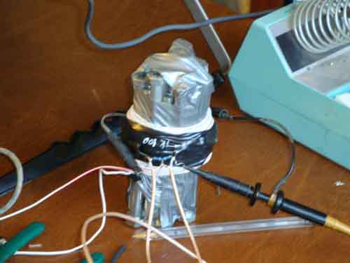

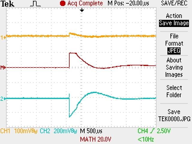

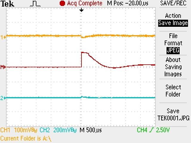

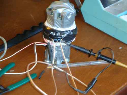

I'd like to post some preliminary experimental results to provide some material for pondering while partaking of your holiday spirits. I want to be absolutely clear that these are preliminary results and I don't expect anyone to accept them until I've provided very detailed documentation and proof of what I've done. I'd also like to be clear that I have not completed all necessary experimental steps. For example, I have not done the exact differential measurement of yungman/sarumonkey. Further, I want to improve my setup to provide controlled current ramps. A final report on all completed experiments is probably about 2 weeks away because of holidays, sick wife and work schedule.
So far, I've carefully designed and built a solenoid to provide the main flux change for the resistor loop. This involved determining calculated and measured values of, resistance, inductance, time constant, magnetic field inside, magnetic field at the coil ends, sampling of external fields and calculation of total flux versus drive current. This then allowed estimation of voltage (20 V) needed to provide a measurable flux change of about 250 mV for the circuit emf. (I will eventually report all details) My setup for providing the voltage step to the main solenoid is still crude in that I use a knife switch. This is unreliable, and as I said I will build a circuit to do this in a controlled fashion. Still, it is possible to use the knife switch and get some useful data. By monitoring the voltage step with a scope and using that to trigger the scope, I can be sure which test cases have a clean voltage application with no transients. Also note that I'm not crazy about using the knife switch because it seems to be stressing my very nice and expensive Agilent power supply which occationally does an overcurrent shutdown when transients are created by the knifeswitch.
I've attached a jpeg file with picture of the coil with a loop attached around it. The loop has a 90 Ohm resistor (made from 3 parallel 270 Ohm resistors) and a 900 Ohm resistor (made from 2 parallel 1800 Ohm resistors) soldered right next to each other, with a wire used to complete the loop. This loop is as close to the solenoid as possible to minimize flux leakage.
I've also attached a pdf showing 4 test cases and the measured values. Anyone who carefully studies the measurement and the routing of the loops will see that these single-scope measurements reveal that scope measurements do not change when the ground clip is attached to either end of the connecting wire, provided that the routing of the scope leads does not allow penetration of the main flux change into the measurement loop (i.e. loop 3 from my earlier post). Yungman does not comprehend the details of what I've done, so please ignore his previous objections and any further ones that are likely to follow this post. In other words, it is clear that two independent and isolated scopes, as in the Lewin experiment, would not care where on the wire the scope ground is, and this wire effectively is a node for measurement purposes despite the fact that there can be an emf on the wire. I've already provided the theoretical explanation for this nonintuitive result using Faraday's law. (Prof. Lewin has as well, and in much better form.)
As I said, I have not done the differential measurement yet, and it is important that I do so because sarumonkee is on record claiming that this type of measurement allows him to determine the emf on the wire. Also, yungman is addament that this is correct. Personally, I am unable to explain this from a theoretical point of view, but the whole idea of experiments is to let you see things you can't visualize yet. Perhaps the differential measurement using one dual channel scope does something strange to the loops. Again, this seems counter-intuitive to me and seems to violate Faraday's Law, but I'll do the measurements soon and we'll see what we see.
Anyway, this is preliminary so I'd recommend doing more pondering than objecting until I do better experiments and carefully document everything in a form that a good skeptical scientist can accept.

  • #216
Stevenb
I don't understand why you do the scope ground lead around the solenoid in case two. You are intentionally introduce a lope using your ground leads. The new loop will be from probe tip to the scope impedence, back to the ground leads to the other side of the 90ohm. That you realling going to circle all the flux giving out by the solenoid. Why do you intentionally do this? You are working, don't you even have a duel channel scope that you can hook up both at the same time?
Or if you only have single channel, try hook up in the middle of the wire so you only have half a loop and see what reading you get, see whether you get 230mV in case two. That would not be too hard to try out, right?
Why don't you try for once instead of spiking me, hook up the right way to avoid any loop creating by scope probe and ground leads, repeat what Saru did measuring the wire with the ground lead in the middle of the wire and measure both end of the wire and see what you get. If what your assertion is correct, then you should not get anything. Just make sure your probe ground leads do not go around the solenoid. You have your setup already, it will only take you less than a minute to do this and take a picture and post it here.

Your post is nonresponsive. You deliberately ignore my repeated statement that these are preliminary results and that I will be doing exactly the things you mention.
You also ignore the clear intent of the diagram that shows the ground leads are routed in a way to not form an open loop that might encircle flux.
And, once again you are unable to comprehend the significance of the information given. You have a clear measurement that shows the same voltage reading with the wire and without the wire. In other words the wire emf can't be measured in any loop that does not encircle flux. I already explained that this is due to FL demanding that the scope leads also have counteracting emf on them. Too bad you consider this "bla bla bla".
In any event I recommend that you ponder instead of object and wait patiently for a full report, as I asked.

OK, after a rejuvenating dinner, I feel obligated to not dismiss all of this. I don't know if it can help to answer, but why not try.
The new loop you speak of is not new at all. It is always there. One if free to think of two paths for the measurements in cases 1-4. One path goes through the 90 ohm resistor and the other path goes through the 900 ohm resistor. One of these paths does not enclose the flux, while the other one does. Faraday's law works on both paths. In one, there is little enclosed flux, so the scope reads the potential on that resistor. On the other path, the flux is enclosed and so you read the potential of the other resistor plus the enclosed flux emf. Both values must be equal. FL always works!
The point of the diagram is to show that you can gradually slide the ground connection along the wire without changing the measurement even if emf is on the wire. The only way to change the measurement is to change the path of the ground lead, not the point that it attaches too. This shows why the emf on the wire need never be thought of. This is the point of Prof. Lewin's experiment. This is the entire point and you miss it.
This is a good example of how it can be frustrating talking to you. So many points get missed, and the task of going back and trying to clarify everything becomes difficult, especially since the clarifications themselves will also be misunderstood. I clearly stated that I used the other channel of the scope to monitor and trigger off of the input step voltage. I needed to do this to make sure that I had a high quality step excitation of the coil. I also, mentioned that I'm worried about damaging my expensive power supply because of my poor switching method, which I will improve. So, I'm trying to do the minimal number of experiments before I build the drive circuit. Once I have a reliable drive circuit, I can use the input voltage on the trigger input, and use the dual channels as you say. This is all planned and will be done.
Of course that would not be hard to try, so (risking my power supply a couple of times more) I will do that and post the result tomorrow. Do you really think I won't get 230 mV with the ground lead routed on one side and 23 mV with the ground lead routed on the other side? Wow, you really miss the entire point.

I have no choice but to dig out my electronics components, scope and all to do this experiment myself. I have to dig through my shed, storage room and all to get the components and setup.
I build my electro-magnet by using a bunch of 5” 3/8” hex bolt and bundle them together to form the core approx. 2.5” diameter. I wound about 50 turns of insulated wires on it. My loop is using 100ohm and 1K 1/4W metal film resistors and a piece of wire to connect them together.
As shown in attachment “SB”, I label point between the two resistors point “A”. It is very short. Going around CCW, the other side of the 1K is point “B”. From B to point D is about half length of the loop. Then from D to “C” is the other half of the loop that connected back to the other side of the 100 resistor at “C”.
I don’t have a power supply nor have a pulse generator. So I just use a 1.5V D size cell as the source. I wind a lot of turns on the magnet to get the high ampere-turns. My theory is when I charge the coil up with about 5A, then disconnecting it will cause a big jump in voltage in the coil and induce a decent emf into the loop of concern. It worked. I have to parallel a 33ohm resistor between the terminals of the coil to increase the time constant of the decay time. My scope is an old Tektronics 465 that has no storage capability. So I have to keep tapping the battery to look at the average size of the pulse height. The voltages posted are only the approximate average. Each pulse do vary a bit. But the information is valid because the readings are very consistence and reproducible.
I can reproduce what Stevenb’s experiment. As shown in attachment “SB”.
The experiments are shown in top row of the drawing SB.
a) Condition 1 show exact what Stevenb did with the probe on “A” and the ground lead go around and connect at “C”. I read about +200mV. See the setup in the picture “Full Loop”
b) Then I start moving the ground lead and when I move the ground lead over the top of the magnet core about half way as shown in Condition 2, the reading drop to about +100mV. See setup picture “Half Loop”.
c) Then I move the ground lead of the probe all the way to the left side as shown in Condition 3 where the ground lead totally stayed away from the magnet core. I read very low –ve pulse. See setup picture “No Loop”.
I gave it some thought and interpret the result. Here is my theory. I draw the equivalent loops on the second roll of the diagram, and the electrical equivalent of the circuit for each of the conditions on the third row of the SB. On the second row of the drawing, there are two loops that can pick up the induced emf from the magnet which I called loop 1 ( orange) and loop 2 ( red). I showed the core in the middle to show where the concentration of the magnetic fields. The magnetic field is pointing out of the page from the core. In each conditions ( 1,2 and 3) the loop 1( orange ) is the same. That is the loop we are interested in. Loop 2 (red) is my interpretation of the loop formed by the scope probe and it’s ground lead.
Interpretation of row 2 of the drawing in SB.
a)In Condition 1: You can see, loop 2 start from scope ground, going CCW to point C, then through the 100 ohm resistor to “A”, then to the probe back to the other side of the Rin inside the scope as shown. Loop 2 enclosed the total flux from the core so the voltage induced into loop 2 is 220mV.
b)In condition 2: loop2 (red) only enclosed half of the flux from the core so the voltage induced into loop 2 is about +110mV.
c)In condition 3: loop2 (red) does not enclosed any flux of the core, so the induce voltage into loop 2 is zero.
The third row is the equivalent circuit.
a)Condition 1: I show the V_{in} as a battery of +220mV. Since the scope ground lead circled the complete flux so it get the full induction of +220mV. The 0V reference is scope ground shown.as “Scope GND”. With scope ground as reference 0V, point “C” is driven to +220mV by V_{SL} . Point “A” would be 20mV below due to drop of the 100ohm resistor. And Point “B” is at 0V simply by voltage drop across the resistors.
b)Condition 2: The probe ground lead is over the top of the core and circled only half the flux by loop 2. This implies V_{SL} is only half the voltage and +110mV. Since the point “C” is really set by the V_{SL}, “C” is at +110mV, “B” is about +90mV. And “C” is actually -110mV reference to scope ground.
c)Condition 3: The scope ground lead is totally on the left side and did not circle any of the flux from the core. V_{SL} is 0V which put “C” at 0V, “B” at -220mV and “A” and about -20mV.
I repeated the experiment quite a few times to verify the observation. Important to node the voltage value is approximation by just observation the average peak but repeating taping the battery. So treat the number only accurate to 20%. But you can see the correlation. The interpretations are up for discussion. I have to set the whole thing up last night, did the observation, think about the reasoning behind the data and type all this by mid day today. My wife was furious when she saw all the stuff in the study room and we are going to have a party tomorrow. I have to tear everything down and clean up by tomorrow morning. So if any of you have other ideas to try out, please post back and I can do it tonight and post back.
There is second part of the experiment where the probe ground hooked up to “D” as what me and Saru talked about. I’ll post it a little later.
The three picture is how I did the experiment:
1) Full loop: the probe ground is going all the way around and attached to “C” as Stevenb.
2) Half loop: notice the ground lead is on top of the core and catch only half of the flux.
3) No loop: The probe ground is totally out of the way from the core and catch no direct flux from the core.
You have to be very careful in doing this experiment on where the scope probe lead is placed. You can really get fool by the observation. In this case the voltage reading is really in reference to the V_{SL} which set the voltage at "C". If you don't think it through, you really think the the measured voltage is INDEPENDENT to where you hook up the ground. In the picture, the ground lead of the probe is just hanging because I have to let it go and stand far away with my small camera in order to stay focus. I played a lot with the probe ground lead and is quite sensitive in some cases. The whole experiment took only a few minutes to go through, but I spent like two hours to just jiggling, tucking the ground leads, squeezing the lead to see the effect of the size of the loop created by the probe ground.
To prove my point. I actually remove the scope probe from the resistor loop, hook up a 330ohm resistor between the scope tip and the scope ground lead to form a loop and place it so it enclose the magnetic flux. I get exactly the same reading as what Stevenb's experiment +200mV. To confirm this, I flip the scope loop upside down and observe -200mV pulses. I concluded this the scope probe setup is the main cause of the reading in Stevenb and in condition 1. As I said, where and how you put the grounding is everything. Please join in the discussion. This is very reproducable. The length of the probe ground it not critical, I really don't see much noticable effect whether I let it hang slopply like in the picture or tuck it very tight around the core. Maybe, like 20% or so. But by moving the probe over the core, you really see a major difference, you can see the amplitude of the pulse just shrink in front of your eyes.

This is the second part where I hook the ground lead of the scope probe at point “D” and measure “B” and “C”. I saw exactly what Sarumonkee described. I saw -110mV on B and +110mV on C. But I did go further to prove because the experiment is very sensitive to the placement of the probe ground lead. I took the probe that was on “B” and start pulling the ground lead tight and closer to the loop on the magnet as shown in
a)Condition 1: of the attachment “ Center tap”. Notice the ground lead ( green ) is hugging the core. The signal shrink and fall off the scope. That cause me to rethink how sensitive the grounding is.
b) Condition 2: I relax the ground lead of the scope and let some loop area appeared. I think with the extra area, it actually caught part of the flux curl back as shown. It showed the flux are point into the paper. This is like introducing a voltage source I call V_R and you can see in the equivalent circuit.
c) Condition 3: Then I did the same thing like the other experiment and move the probe ground lead over the magnet core as shown in Condition 3. The voltage drop. In the equivalent circuit, it is like the V_{SL} decrease because the loop only catch half the flux.
d) Condition 4: When I finally move the probe ground lead all the way to the left side. The output actually change to -220mV. The reason is because now the probe ground is following the wire from “D” to “C” and have –ve 110mV induced into it. The equivalent circuit shown below.
This is my interpretation of the observation. Feel free to put in your comments. As I said, the pulse height is approximation, treat the reading as 20% uncertainty. Right at the transistion, I saw a lot of very high speed ringing, I only look at the part when it started to become a exponential decay pulse. I think putting a toroid onto the probe coax to introduce common mode rejection might help, but I don’t have one!

  • #236
stevenb said:
First I did the Lewin Experiment, but remember his is with two isolated scopes while mine is with one scope with dual channels and common ground tied both at the scope and at the loop.
I can provide the screen capture from the scope for the repeat of the Lewin test.
In the image, the yellow trace (CH1) monitors the 90 ohm resistor, the blue trace (CH2) monitors the 900 ohm resistor and the red trace is the monitor for the applied voltage to the coil. The applied voltage is initially 20V, but then the power supply goes into current limit (set to 10A). All information on time scale and voltage scale for each trace is on the screen.
Based on this, I conclude that the wire routing I use is reasonably successful in closing all possible loops that would capture leakage flux.

  • #237
stevenb said:
The second experiment was more similar to Saru's where I move the scope probe to the other side of the resistors (I believe these are the B and C points) to see if emf on the wire can be measured.
I can provide the screen capture from the scope for the repeat of the Sarumonkey test across the wire itself.
In the image, the yellow trace (CH1) monitors the other side of the 90 ohm resistor, the blue trace (CH2) monitors the other side of the 900 ohm resistor and the red trace is the monitor for the applied voltage to the coil. The applied voltage is initially 20V, but then the power supply goes into current limit (set to 10A). All information on time scale and voltage scale for each trace is on the screen.
From this I conclude that the arrangement and routing successfully closes the loops that would corrupt the measurement. Essentially no wire emf is seen to be detected here. There is a very tiny pickup of emf, but I believe that this is from that little bit of leakage flux which gets into the measurement loop.
