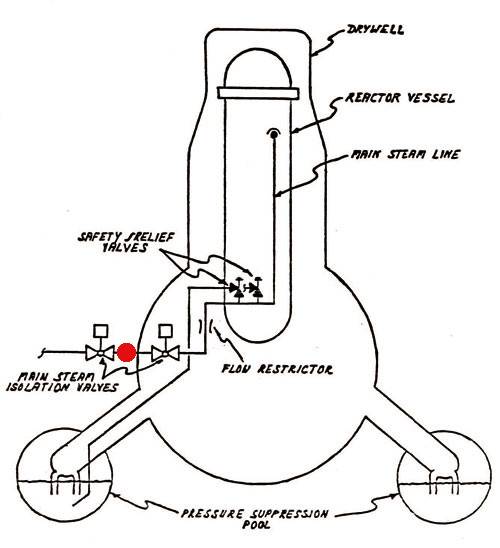

I'm still amazed that so many "emergency cooling" measures don't actually remove heat from the unit, they merely move it around. HPCI, RCIC, they all move hot water/steam from the RPV to various other pools and tanks, and this water eventually goes back into RPV. To me, this looks somewhat stupid.
Only the "old" IC actually does cool the whole damn thing.
  • #913
The RHR heat exchangers are your ultimate heat sink. For a DBA LOCA they are required to be placed in service manually within 10-30 minutes. For LOOP events, you need one heat exchanger in service to prevent exceeding suppression pool design temperature.
My Mark III will get close to 160 degF in a LOOP with one RHR HX in service per our power uprate analysis.
The goal is to always minimize the amount of heat you have to reject to containment. If the condenser is unavailable you have no choice, but even in this scenario the expectation is that you cool down using RCIC taking a suction from the condensate storage tanks to minimize pool heat up. The CST is required to maintain sufficient water to support a RCIC cooldown.
Keeping the pool cooled is a big deal. The operating license has strict limits on pool temp and will mandate a rapid cooldown if you're getting too hot. The EOPs have a heat capacity temperature limit graph, which if exceeded requires immediate cooldown or emergency blowdown to ensure you don't exceed the containment temperature limit during a subsequent line break or emergency blowdown. It's also one of the only places in the EOPs that emphasize containment protection over core cooling, as it mandates exceeding the cooldown rate intentionally to protect the HCTL.

This is the part which I find stupid. What's the point in the design which transfers heat from RPV to suppression pool, so now you need to cool the suppression pool? This introduces more failure points, and false sense of security. "RCIC can keep the reactor from overheating", one might think. Wrong. "RCIC can keep the reactor from overheating *if* and *until* suppression pool overheats". Now you need RCIC to not fail *and* RHRs to not fail.
  • #915
The original design was just the IC.
The IC has no injection capability though, which for long term events is important. So GE swapped it out for RCIC plus the steam condensing mode of the RHR heat exchangers. The RHR HX are designed to handle reactor steam, and used a level and pressure controller to control cooldown rate. Steam from the RCIC steam line would go to the HX, be condensed on the tubes, then would be fed back to the RCIC pump suction. This provided long term heat sink. I know some plants had issues with this, but I have yet to find the details (astronuc if you can find out why please let me know, I speculate tube damage after Humboldt Bay stayed critical on RCIC/RHRHX for over a day). But most plants ultimately deactivated steam condensing mode. HPCI plants can use it for pressure control. HPCS plants have to lift SRVs which sucks. A lot.
Remember that compared to a PWR, where the turbine driven aux feed loses inventory to the atmosphere and will eventually run out, BWRs never lose inventory. If the containment is being vented, you can remove all decay heat that way and never lose RCIC. There are trade offs between various designs. But due to Recirculation seal leakage during loop events, the IC alone will eventually not be sufficient as water level slowly drops. Loop design leakage is close to 50 gpm, or 1 inch every 4 minutes. Given there's 200 inches of inventory, the IC is not going to protect the core for these events. (These are average/typical levels). (50 gpm is a design limit, typical leakage is much much lower)

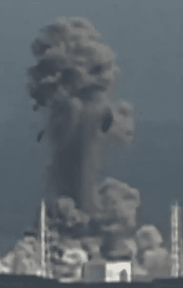

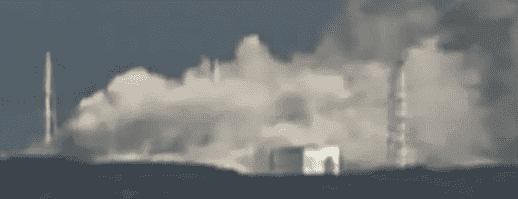

  • #933
Hiddencamper said:
They did violate EOPs in that they did not perform a blowdown at unit 1 when required.
Did they have sufficient control to do so at that point, post tsunami but pre H2 explosion?
  • #934
Looking at the timelines, we get this partial information:
15:30 IC trains A and B manually secured, loss of all cooling to Unit 1
18:18 to 18:25 partial operation of train A
