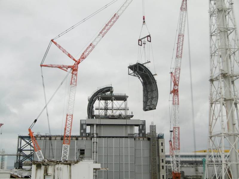

etudiant said:
NHK reports that a sarcophagus structure is under consideration, to seal off the buildings with the fuel inside.
Given the groundwater issues, is this a plausible option for even the relatively short term?
http://www3.nhk.or.jp/nhkworld/en/news/20160713_25/
I like this idea a lot.
