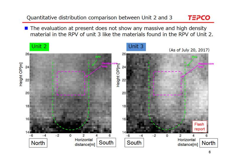

Rive said:
Unit 2 is the most likely of the three to have its fuel remain in the vessel. Between 70 hours of RCIC injection and the shorter delay between debris ejection and commencement of fire pump injection, it's definitely possible that it has a decent amount in the rpv.
