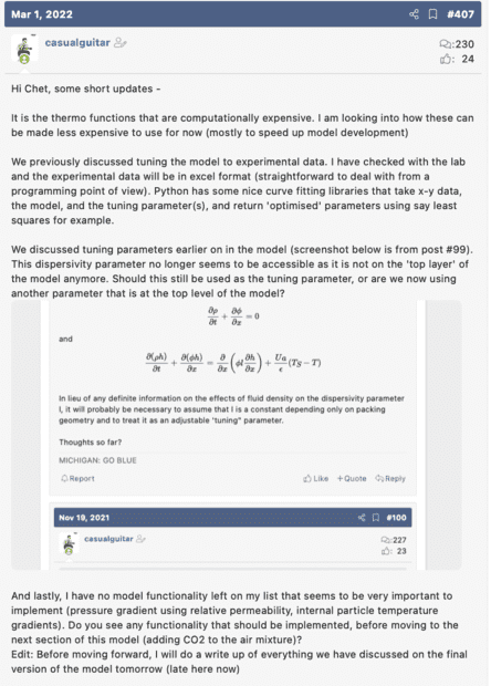

The tuning parameter for dispersivity is ##\Delta x=L/n##.

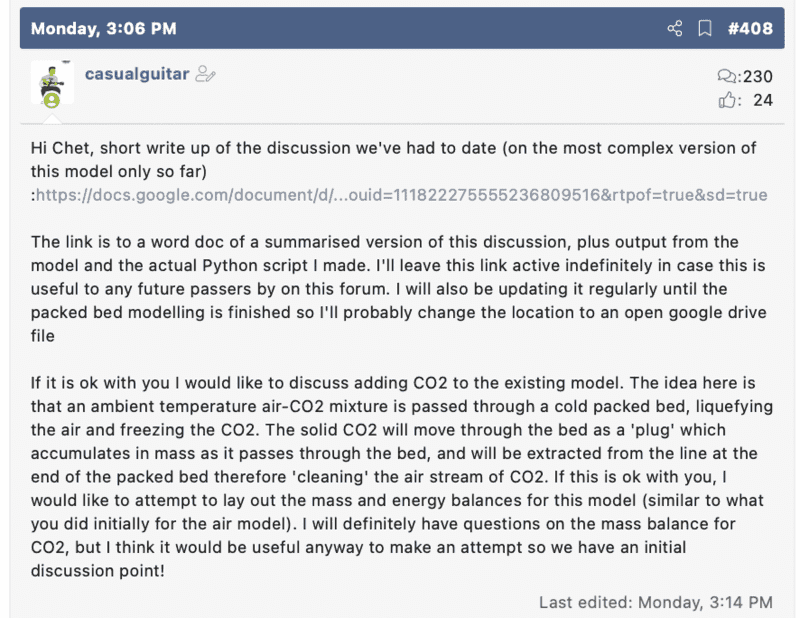

The CO2 would be in the range of 10-20% of the mixture by volume for example. No specified percentage yet however it would be a CO2 enriched stream i.e. much greater than 400ppm.
I don't know actually, but I think you will be right about the CO2 depositing temporarily on the bed. What I thought would happen (assuming a bed colder than the freezing point of CO2) was that the ambient CO2 enriched stream would enter the cold bed and immediately the CO2 at the 'front' of the stream would freeze. The pure air would carry on through the bed.
Then the newly entering stream - which is at ambient temperature - would vaporise the frozen CO2, and the vaporised CO2 plus the CO2 'behind' it in the stream would now be frozen/deposited slightly further downstream. This process repeats until you have a 'plug' of CO2 at the outlet of the bed.
In regards to the time though as you say, I don't know if the CO2 will be immediately vaporised, or if this freezing/boiling process will take time. If it takes longer than instantaneous times then I would guess you would see a distribution of frozen CO2 along the bed, with the most CO2 being deposited furthest down the bed, and gradually less and less CO2 being deposited towards the inlet. Sort of like the left side of a normal distribution curve (or similar).
The idea would be to freeze as much CO2 as possible in the bed in a 'plug' form. Then just sweep the bed with pure ambient temperature CO2 gas, leaving you with 'pure' air (within reason) and pure CO2 streams.
Do you agree on this much?

This thing with the CO2 looks to me like it's going to be very tricky.
If it were me doing this, I would proceed very slowly. I would first spend a lot of time looking at the thermodynamics of the 3 component mixture (in proportions as fed to the bed), off-line from the bed model. I would first look at the vapor pressure vs temperature of O2, N2, and CO2. Then I would do phase equilibrium calculations as a function of temperature and pressure for the 2 phase (and possibly 3 phase) region. I would like to know the mole fractions of the various species in the liquid and vapor phases (and also solid phase) as a function of temperature at various fixed pressures. I would want to see how this plays out by plotting as much as I could about the mole fractions vs temperature all on single plots. But, that's just me. What were you going to do?

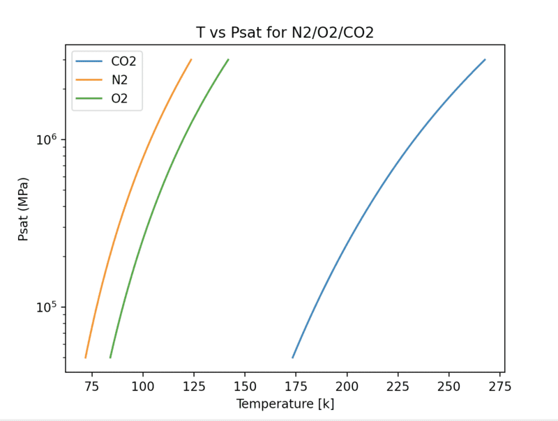

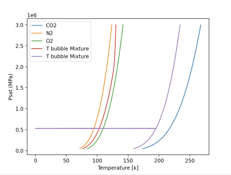

Hi Chet, temperature vs vapor pressure here for pure CO2, N2 and O2. Also included the bubble and dew point curves for a 44%CO2, 40%N2, 16% O2 mixture. These curves match up with what is expected from the CO2 property paper (ignoring the purple horizontal line for now, I haven't cleaned my code to remove that)
There is a big gap between the liquefaction temperature of nitrogen/oxygen and that of CO2 which is probably a good thing
Just thinking some more on how best to represent the thermodynamics, it might be useful to plot the TP curves for all of N2,O2 and CO2 individually for 3 phases, just to see what phases are present for the various ranges of temperatures and pressures
I'll aim to make a TP plot for each component showing the phase present at each T,P pair, and I can overlay them actually to see where we will have more than one phase present
Please have your plotting software show the pressure using logarithmic scale.

Log scale plot:
Actually that horizontal purple dew point line in the previous plot happens because this is the point at which the CO2 solidifies out of the mixture (the liquid/gas correlation being used no longer applies). I'll need to switch out the liquid/gas correlation for a solid/gas one at that point

The units should be Pa, not MPa.

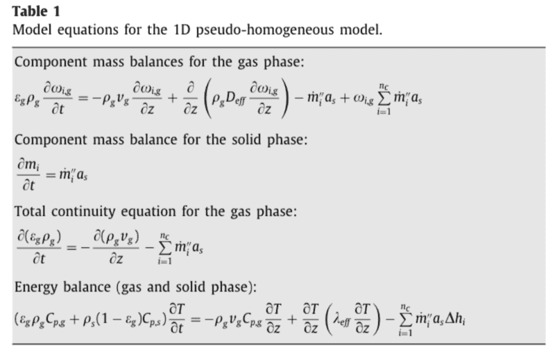

On that front, papers that go in depth on the modelling side for this are limited. However, I did find one highly referenced paper that does do something similar, and which includes model equations:

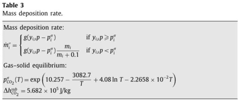

https://www.sciencedirect.com/science/article/pii/S0009250909000852
It does not include relative permeability (or seem to directly acknowledge the difference in gas/solid superficial velocity), so I was thinking a good goal here would be to adapt this existing model to incorporate superficial velocity of the solid directly (I don't think I have the understanding yet to start developing model equations from scratch).

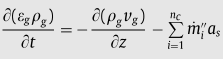

They model the accumulation of CO2 down the bed via a solid mass balance equation (screenshots below). This seems like a valid approach also as we could then backtrack and calculate the superficial velocity of the solid through the bed by looking at the rate of solid buildup along the bed
Do you think it is reasonable to begin by using this existing model as a reference? If so I can synthesise/summarise their model and equations today/tomorrow
Note: I have not included the nomenclature here as I'm just including these screenshots to give an idea of what their model looks like

Yes. But, if this were an ideal gas mixture (which it is not), the partial pressure of the CO2 in the entering stream would have to be lower than(or equal to) the CO2 triple point temperature. Then the CO2 would condense out as a solid first. Assuming that the air is not soluble in the solid CO2, the cooling could continue at lower temperatures until liquid started forming. It is not clear thermodynamically what would happen next (without experimental information on the 3 component behavior). Also, there is a question of what is present in the bed to begin with.
I don't have free access to this paper, because I am not in any organization that subscribes to the journal.
It must be assuming that the solid is totally immobilized on the bed.
This model is definitely assuming that the solid component is (axially) immobilized on the bed. Because of my inaccessibility to the paper, I will need to know the nomenclature. I would also like to see their definition of Re and Nu. Thanks.

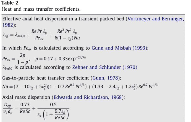

Sure, screenshot here of the nomenclature (PDF of the paper attached to this comment for reference):
Definitions of Re and Nu are from the Dixon and Cresswell reference we previously used:
And here is the Nu we previously used:

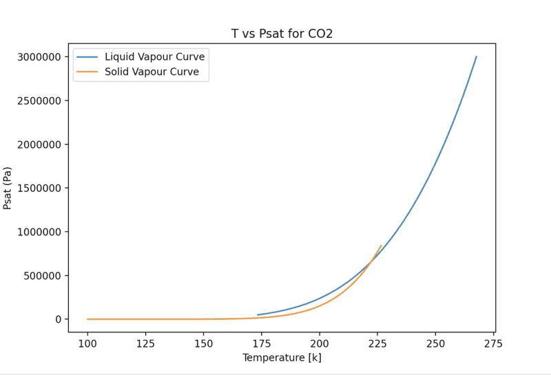

Actually no particular need to get the sublimation curve from literature. This paper already supplies it in table 3:
I'll see what this looks like with the liquid vapour curve

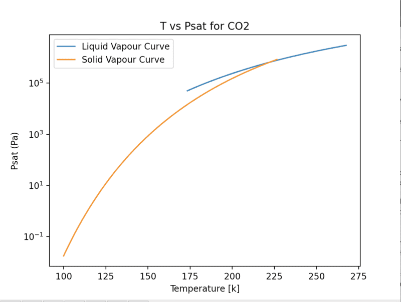

I've added the vapour/liquid and vapour/solid curves to the same plot:
As you can see I have plotted both curves slightly outside their respective 'valid' ranges to illustrate something.
The sublimation curve is really only valid up to about 222K (where it overlaps the VL curve), and the VL curve is only valid down to this temperature (the triple point temperature). However, if you extend the VL plot down through the 'solid' CO2 range, it maps relatively well to the solid/vapour curve. So rather than adding an external polynomial here to check CO2 phase, we could possibly use the extended VL curve to check if the phase is solid or vapour

Please replot this with a logarithmic scale for pressure. You will see that there are substantial differences between the vapor-liquid curve and the vapor-solid curve at temperature significantly below the triple point.

To clarify yes in the previous model the operating pressure was 30 bar, however here for the separation of CO2 from air there is no required pressure in place yet, so we could choose to go with a pressure below the triple point pressure (below approx 5.2bar), that would allow for desublimation.
If we are not considering the phase change of air here (vapour phase only), we could also return back to the temperature derivative approach (as is used here) which may simplify the model slightly. Also, given the pressure will be a low lower here, we may be able to reasonably assume that some parameters like heat capacity will be constant (which would simplify the model again and speed it up if it meant we could avoid using the thermo library for the most part)
Side note - actually as far as I know the liquefaction of air is much more efficient at higher pressures. I am not sure if this applies to packed bed systems. If it does, then it would mean that operating below the triple point pressure of CO2 (to allow for desublimation) would mean lower efficiency liquefaction of air

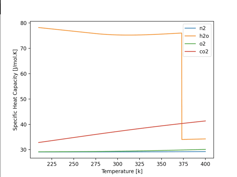

Log plot here:

I haven't fully defined this yet, however the core idea may be to answer the question:
How good can cryogenic packed beds get at separating CO2 from air (and how do they compare to alternatives)?'.
Is this a reasonable question to answer?

Hi Chet. I read through the paper this evening. I have some sections of the paper that I do not understand and would like to clear up if possible
"The rate of mass deposition and sublimation of CO2 was assumed to be proportional to the local deviation from the phase equilibrium"
Is it correct to say that they are saying that the rate of mass deposition/sublimation is proportional to the 'distance' between the partial pressure of the CO2 and the saturation pressure i.e. the further the partial pressure from the saturation pressure, the faster it changes phase?
"The velocity of the condensing front is inherently faster than the velocity of the evaporating front, due to the opposed enthalpies involved in the condensation/evaporation."
It makes sense to me that the vapour phase (condensing) would be faster than the liquid phase (liquid) due to the density difference, however I'm not sure what the need for mentioning 'opposed enthalpies' is here. Why is opposed enthalpies important here?
The model equations:
The rate of increase of mass fraction of a component i is equal to the the rate of change of mass fraction of the component along the bed due to advection plus the rate of mass diffusion along the bed minus the mass lost to the solid phase, plus the gas gained from the solid phase
I think this is the same as above just on a 'total' basis rather than component basis?
This is just the rate of increase of solid component is equal to the mass deposition rate times the specific surface area
This is a gas and solid total energy balance in the one equation . Anyway I think it means - the rate of increase of energy is equal to the loss due to convection plus the rate of conduction along the bed minus the heat lost/gained by change in phase
Two notes here:
1) I used the term advection for the mass balance and convection for the energy balance. Is this correct?
2) Actually, looking at the energy balance and the way they have 'tacked on' the phase change term at the end of the energy balance, this is exactly the question I was trying to ask about in my initial post on stack exchange (before we moved to this forum). The papers I was reading (and did not understand) all dealt with single phase only, and I was wondering if you could reasonably add on the 'phase change term' like this in the energy balance. I suppose this answers the original question. Looking back now I was not nearly in a position to understand that at at the time though (and arguably still am not). Again hugely appreciated for carrying me through this! I will get to the point of being able to do this independently. I'm not there yet but that's the idea and I'm motivated to get there
Are you sure you are not primarily interested in separating CO2 from combustion products (not air).
I was initially thinking just CO2 but actually the applicability of that is quite low. Combustion products does seem a lot more interesting so yes let's go with CO2 and water
The driving force for mass transfer is the difference between the partial pressure of CO2 in the bulk and the saturation vapor pressure of CO2 at the interface. This is a standard way of handling the mass transfer at a phase boundary.
I have no idea what this is about. It looks like they use a fudge factor to make the rate of desublimation higher than the rate of sublimation: a factor of 1.0 vs a factor of ##\frac{m}{m+0.1}##, where the 0.1 represents ##0.1 kg/m^3##.
Mass balance equations:
For each individual component:
Overall mass balance:
If we take this overall mass balance, multiply it by the species mass fraction in the gas ##\omega_{i,g}##, and add the resulting equation to the species mass balance, we obtain a new version of the species mass balance equation:
$$\frac{\partial (\epsilon_g\rho_g\omega_{i,g})}{\partial t}+\frac{\partial (v_g\rho_g\omega_{i,g})}{\partial z}=\frac{\partial}{\partial z}\left(\rho_gD_{eff}\frac{\partial \omega_{i,g}}{\partial z}\right)-\dot{m}_i^"a_s$$This would usually be referred to as the "divergence form" of the species mass balance equation, and is beginning to look in form like the heat balance equation in our other model. There is axial dispersion of the species as well as deposition of the species onto the solid bed.
For the solid bed, the mass balance equation would read:
Is this OK for you so far. I will address the heat balance equations for the gas and the bed in my next posting, treating the two phases separately, including heat transfer between the gas and the bed and relative distribution of the heat of desublimation between the two. The result will be much closer to the model we already have in hand.
By the way, for this CO2 model, there is an overwhelming advantage (that Tuinier missed out on) for working in terms of molar flow rates and mole fractions, rather than mass flow rates and mass fractions. I will illustrate that in the subsequent development I present.

Mostly good so far.
It took me a while to spot but yes I see now you've done a 'reverse chain rule' to get to the divergence form of the species mass balance after you add the component and total mass balances. I think there is an ##a_{s}## term missing at the end of the equation
Two short questions:
1) Why do you add the species and total mass balances? This seems unusual to me in that it doesn't seem like it would have physical significance. What does adding the species and total mass balances give you, from a physical meaning perspective? You mention it actually gives you the species mass balance back in divergence form, but I don't yet see how species + total = species, if you understand my question?
2) Why do you multiply across by ##\omega_{i,g}##? Are you seeing in advance that this will lead you to be able to do a 'reverse chain rule' and get to the divergence form of the species mass balance? If so, I guess knowing to do something like this comes from experience?
Besides this I'm good to move on to the heat balance

You have it backwards. The original form of the species mass balance equation they derived (using a control volume approach) was the equation I wrote down (not shown in their development). They obtained their present form of the species mass balance equation by multiplying the total mass balance by the mass fraction of the species and subtracting it from the species mass balance I wrote down.
What came from experience was knowing how they obtained their form of the species mass balance.

Regarding their lumped heat balance equation, my judgment is that they must be neglecting variations in the molar heat capacity of the gas mixture as a result of changes in the molar composition of the mixture in writing their relationship and in their calculations. This is probably a reasonably good approximation because the molar heat capacities of N2, H2O, and CO2 are not drastically different. Is this your understanding also? I think, otherwise, the heat balance would be much more complicated in form, for very little added benefit.
This is a plot of the heat capacities of N2,O2,CO2 and H20 versus temperature, for a pressure of 5 bar:
The N2 and O2 heat capacities are almost identical (I don't think we have discussed the inclusion of O2 in this model however I've included it here). The CO2 heat capacity is also very similar to N2/O2 while in the gas phase. H20 heat capacity is not similar to the others however if N2/O2/CO2 take up a high enough mass fraction of the total mixture then this constant molar heat capacity assumption seems reasonable
The CO2 heat capacity will jump up when it transitions to solid phase. This plot however is actually the correlation used for the liquid phase (as thermo does not recognise solid CO2 it uses the liquid correlation instead). We can manually add solid correlations where needed. It doesn't look like we will need one here though given the constant molar heat capacity assumption
Chestermiller said:
Did you notice a typo error in the heat balance equation in the paper (it is in the axial heat dispersion term)?
Hmm not an obvious one. Possibly you're looking at the derivative itself? The way they have written them, its really two first derivatives multiplied together, rather than a second derivative which is what it should be
