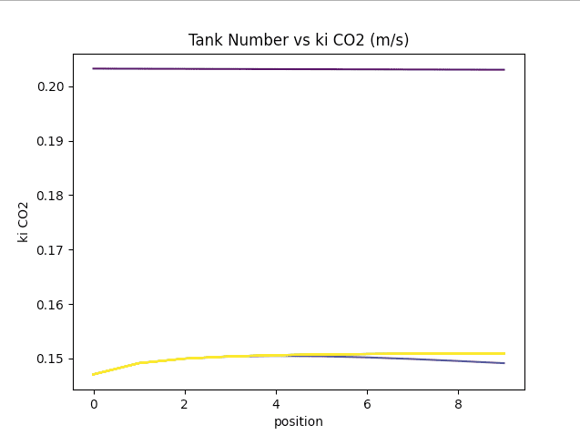

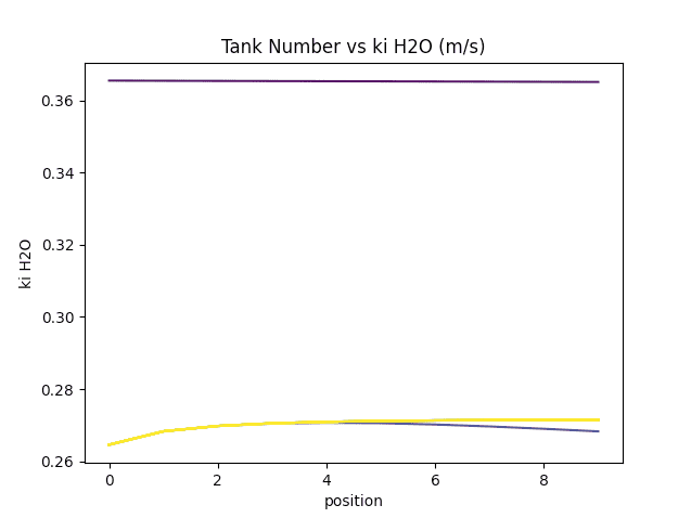

Lastly, regarding the units of ki, any equation with ki in it shows that the unit of ki is ##mol/m^2.s##. However, the molar desublimation rate formula ##\dot{M}_i^"=k_i\left(\frac{Py_i-p_i(T_I)}{RT_I}\right)\tag{1}## suggests that the units are ##m/s##. If this is correct, is there an equivalent molar desublimation rate equation that would use units of mol/m2.s for ki?
For reference, my units are:
##k_i## = ##mol/m^2.s##
##P## = ##Pa##
##y_i## = ##mol/mol##
##R## = ##J/mol.K##
##T## = ##K##

Hi Chet, just to be clear on the ##k_i## units question, what I mean is that all of the correlations say that the units of ##k_i## are ##mol/m^2.s##, but, the desublimation rate equation says the units of ##k_i## are ##m/s##.
Equations that say ##k_i## unit is mol/m2.s:
##Sh_{loc,i} = \frac{k_id_p}{\rho_mD_{ab}}##
##Sh_{loc,i}=\frac{k_id_p}{(1-\epsilon_g)D_i\psi}##
Equation that says ##k_i## unit is m/s:
##\dot{M}_i^"=k_i\left(\frac{Py_i-p_i(T_I)}{RT_I}\right)##

My apologies for the multiple posts. Is it possible that this equation ##\dot{M}_i^"=k_i\left(\frac{Py_i-p_i(T_I)}{RT_I}\right)## is missing a molar volume term on the right hand side (units of m3/mol). If so, then it essentially becomes ##\dot{M}_i^"=k_i\left(\frac{Py_i-p_i(T_I)}{RT_I}\right)*\rho_m## which is ##k_i*\frac{PV}{nRT}##. The brackets are dimensionless and this would mean that ##k_i## would have the same units as ##M_i''##, and this would line up with the units of ##k_i## in the sherwood number correlations
  • #154

If we write the equation ##\dot{M}_i^"=k_i\left(\frac{Py_i-p_i(T_I)}{RT_I}\right)\tag{1}## as $$\dot{M}_i^"=k_ic_I(y_i-p_i(T_I)/P)$$where ##c=\frac{P}{RT_I}##, then we can write $$\dot{M}_i^"=K_i(y_i-p_i(T_I)/P)$$
By analogy to Eqn. 14.5-6 of BSL, $$Sh=\frac{K_iD_p}{cD_i(1-\epsilon)\psi}$$Combining these gives $$\dot{M}_i^"=Sh \frac{c_ID_i(1-\epsilon)\psi}{D_p}(y_i-p_i(T_I)/P)$$

Thats interesting. What you did above shows that ##M_i''## has the same units as ##K_i##. Issue solved then. Great! It looks like you did the same thing I did (there was a density factor I had not considered). I have this written up in code form so we're almost there on the functions front also. I have pretty much everything plotted for ranges of dependent variables also

##U_{g,NEW} = U_{g,OLD}*\frac{\mu_b}{\mu_0}^{0.14}##
Besides that question I think that's all issues solved for now. I just need to code up the last few heat transfer related functions (QgI, QIb, etc)
It's only an approximate thing. The viscosity term is only going to be a minor correction.

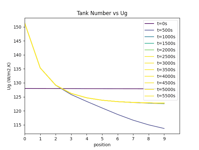

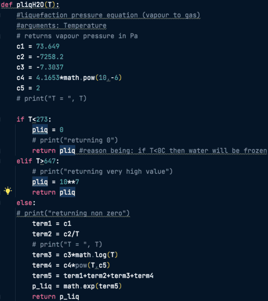

Actually one thing I noticed in writing the code for these functions is that there are 'layers' of functions. For example, viscosity is dependent on temperature, Reynolds number is dependent on viscosity, the mole transfer coefficient is dependent on the Reynolds number, and the molar deposition rate is dependent on the mole transfer coefficient.
This makes defining functions a bit messy in that I have for example the molar deposition rate function as a function of T, the sherwood number, the mass transfer coefficient, the mole fraction and the diffusion coefficient. I am tempted to look for a set of 'basis' variables that all functions are dependent on. For example, if I have every function as a function of temperature and the molar flow, would this be enough to calculate everything in any 'layer'? (assuming constants like P and ##y_i## are defined elsewhere). For now I will finish off these plots but it looks like finding this common basis would be useful for code simplicity

Hi Chet, issue above resolved after chatting with a postdoc. Looks like the standard/OOP approach is to not do what I was thinking of doing above. This is fine as my code is already in this format anyway
One question - did we agree that ##Ug = h_{fs}##? I know in the last model we had the lumped parameter approach where we had ##\frac{1}{h} = \frac{1}{h_{fs}} + \frac{dp}{k*beta}## however here we are saying ##h = h_{fs}##?

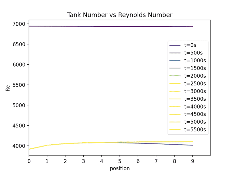

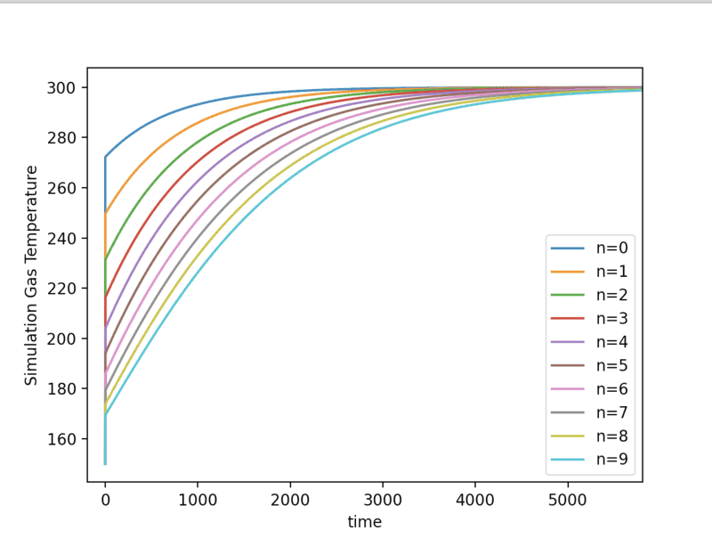

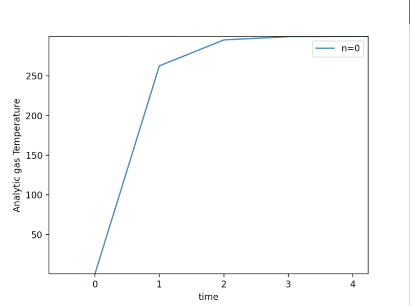

Every function is written up now, and most plots are done. I've been able to check any of the thermodynamic property functions via literature data, however there are some other plots I'd like to check with you if possible. Also, most parameters have a number of dependent variables, so I would like to ask you which dependent variable is most insightful to vary for the plots. Here are my thoughts on possible plots and dependent variables I would vary within a range to create the plots. In the format '(The function output -> the variable being varied)':
Reynolds number -> molar flow
Prandtl number -> viscosity
Sherwood number -> mass transfer coefficient
Nusselt number -> ##h_{fs}##
Schmidt number -> viscosity
Mass transfer coefficient -> Reynolds number
Molar deposition rate -> mass transfer coefficient
##h_{fs}## -> Reynolds number
Working on these plots this morning. If you think there are other useful plots at this stage, or that there are better dependent variables to vary than the ones I chose just let me know

The comparisons that make sense to me are in terms of the dimensionless groups, say ##Nu/Pr^{1/3}## vs Re (say comparing the correlation for turbulent flow in a tube to that in a packed bed).

Just posting some plots here:
Molar flow vs Reynolds number (using system specific dimensions):
Reynolds Number vs Mass Transfer Coefficient for CO2 and H2O:
Reynolds Number vs Nu/Pr^1/3:
If these look ok to you I think it's about time to start adding these functions into the simulation? Would you recommend any general order for adding these functions in? i.e. should I leave out any functions (and leave some constants) for now, or just go straight for adding them all in?
  • #162
What is your judgment on this? My rule of thumb for modeling is always "start simple and build in complexity."
  • #163
I do agree with this, and in addition it would be nice to start with a simple model that we can 'validate' against another model or against what we would intuitively expect to happen.

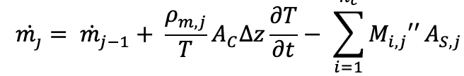

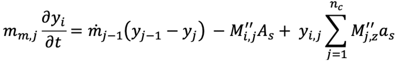

Edit: Lastly just posting the actual equations here to bring them forward:
I think these are OK. Recheck the algebra to be sure.

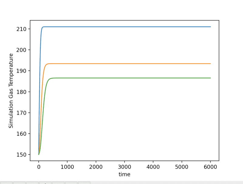

A positive update-
Finally getting normal output for every variable (except bed temperature weirdly but I'll fix that). The time scale is obviously too short to reflect reality but here's an example plot of time vs gas temperature for each position (n=3):
Working on that gas temperature bug now (the bed temperature seems to stay at the initial temperature)

Chestermiller said:
I don't understand this at all. Where do you divide by the molar holdup in your equations? And why does this have to include water and co2?
The first term in the gas phase mole and heat balances ##m_{m,j}## is the molar holdup which is initially zero. When I divide across by this term (I do this when I'm setting up the ODEs in the solver), I'm left with a molar holdup in the denominator which is zero initially, unless I specify otherwise. No?

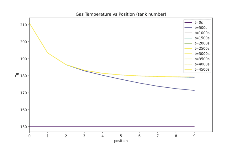

Chestermiller said:
The gas temperature should be high at the inlet and low downstream.
Yep that's also right (completely missed that). Interesting. Weird. I'll check this out
  • #174

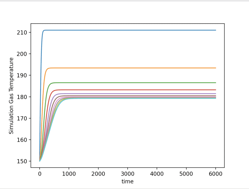

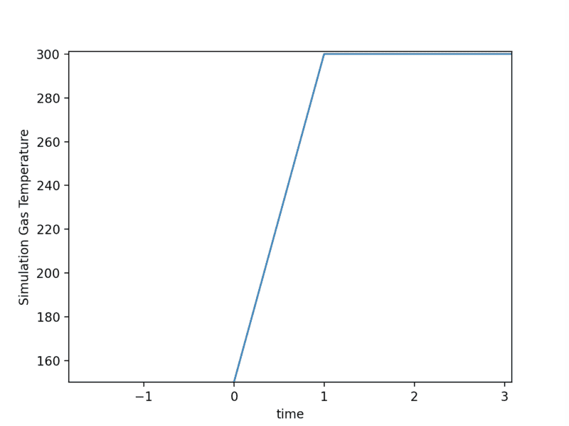

Actually no this is fine. It shows the temperature profile vs time for the three tanks. We'd expect them all to be at T0 at time=0, and the first tank will be the first to rise up to the inlet temperature, etc
However even though the trend is fine, for this simulation my inlet gas temperature is actually 220 so It shouldn't be levelling out at about 174. Bug somewhere
No. $$m_{m,j}=\frac{P}{RT_j}A\Delta z \epsilon$$This is the total number of moles of gas contained in tank j.
