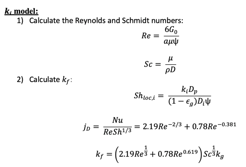

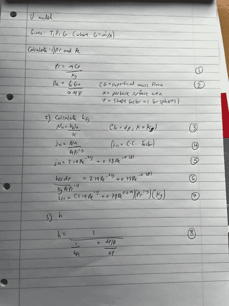

Ok interesting so this flow as done in the previous model:
applies for both ##U_g## and ##U_b## (using the relevant solid and fluid parameters for ##U_b## and ##U_g## respectively). We can also swap out the Prandtl number for the Schmidt number and then this flow applies for the mass transfer coefficient ##k_i## also? If so this makes the coding efficient
Where ##Sc = \frac{\mu}{\rho D}##. The equivalent ##k_g## term from model 1 was found via the thermo library assuming ##k_g## was temperature and pressure dependent. I don't think thermo will give the mass diffusivity so we will need a correlation for ##D## here also. I guess BSL will have this?
Note:
Just looking at the correlation used for ##U## in the previous model, its not clear to me how to apply this separately to ##U_g## and ##U_b## in this model. It seems that we will only need to use the fact that ##T_g## does not equal ##T_b##. Is it correct to say that the only difference between the ##U_g## and ##U_b## models is that the ##U_g## parameters are evaluated at ##T_g## and the ##U_b## parameters are evaluated at ##T_b##?
Or if the above is not correct then maybe we should go with the approach below (outlined in BSL ch.14) where you take the average temperature so ##U_b## parameters would be evaluated at ##\frac{(TI+TB)}{2}## and ##U_g## parameters at ##\frac{(TI+TG)}{2}##?

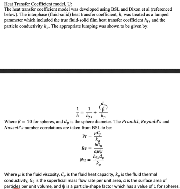

Just one other question - I'll be using the previous HTC functions I made for this (plus a new one for the Sc number). I think there is a bug in one of my functions though. Do you know what the typical ranges for the Pr, Re, Nu, Sc numbers and U in the previous model (model 1) would be? Just to help with the debug!
Also I believe you previously commented on my sleeping patterns (early on in model 1). I see you're also awake at a quite early time of 4am! An early bird or a late night owl?
Edit:

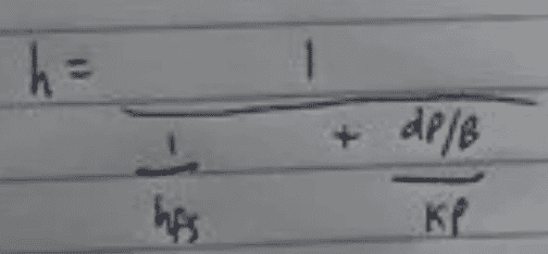

Lastly, we had the lumping of the convective and conductive terms in the last model for U:
Does the same lumping apply for the convective and diffusive mass transfer? Meaning that we would get something like:
$$k_i = \frac{1}{\frac{1}{k_{fs}} + \frac{dp/\beta}{D}}$$
I can't read your handwriting again. Please use Latex or provide a post # from the previous thread.
Just google "diffusivity of CO2 (and H2O)" in Nitrogen. That should be good enough. BSL will have H2O probably.
casualguitar said:
Note:
This is not going to be exact. I would use T at the interface.
This would be adequate too. Like I said, it won't be exact. This is a judgment call.
No. There is no diffusion in the solid bed particles. You just use the mass transfer coefficient for the gas phase. The mass transfer model just applies from the bulk gas to the solidification interface.

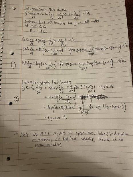

So this is the model I would be using (same as model 1) to calculate ##U_g## and ##U_b##. ##U_g## is evaluated using ##\frac{(TI+TG)}{2}## and ##U_B## using ##\frac{(TI+TB)}{2}##. You suggested earlier using ##T_I## for both. Would this not mean that ##U_g## would be equal to ##U_b## always?

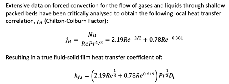

I think I understand. So the mass and heat transfer models are equivalent, except we leave out the final 'lumping' equation as we had in the heat transfer model? Leaving us with this mass transfer model:
Seem reasonable to you?
No. $$Sh_{loc,i}=(2.19 Re^{\frac{1}{3}}+0.78 Re^{0.619})Sc^{\frac{1}{3}}$$
  • #111
Whoops yes I got that result also

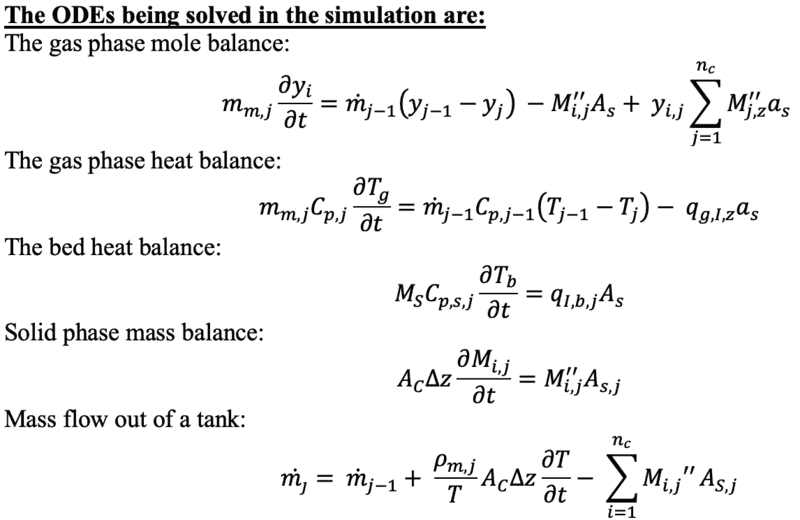

One question - how does this model deal with liquid phase water?

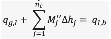

Looking at the heat balances and this equation
there seems to be no reason why we couldn't swap out the heat of fusion for the heat of vaporisation here as required.
However for the mass balances we don't seem to have a way to track the amount of liquid present, only solid deposition, so my thought is that this model effectively assumes that water moves from gas phase to solid phase and back very quickly i.e. fast enough to assume no liquid phase is present? Is this the assumption being made in Tuinier et al also?

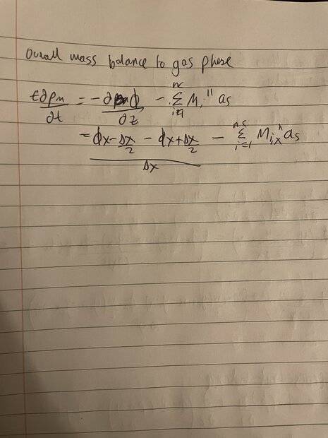

Besides those correlations to be found, it looks like the computational flow is the next point?
Hmm I don't understand at what point we can actually solve for the ##q## values
Similar to the last model we know ##\dot{m}_0## into the bed so we can solve the gas phase mole balance immediately I think. To solve for the ##q## values we need ##T_g## and ##T_b## which we don't have yet, so my guess is that the gas and bed heat balances must be solved simultaneously? Then we can also solve the solid phase mass balance once we have these temperatures and the interface temperature
Once we have ##T_g## and ##T_b## we can solve for the mass flow out of a tank. This cycle then repeats for the other beds
This is a bit of a dilemma. Tuinier are assuming that water deposits as liquid and CO2 deposits as solid. But there is no allowance for the conversion of deposited liquid water to deposited ice in their approach, even if they did switch from the liquid to the solid vapor pressure curve to describe the behavior during the deposition. The heat of vaporization of water is >540 cal/gm, and the heat of fusion of water is 80 cal/gm, so it may not matter much. They may be using a single value for the heat of phase change of water and a single value for CO2, irrespective of temperature. This neglects:
1. Changes is heat of sublimation or vaporization with temperature
2. Heat of fusion of water
3. Changes in sensible heat of deposits.
4. The deposition processes of H20 and CO2 do not interact
This seems to be the approximation they are using in this model, and it may be a pretty good approximation, in view of other approximations that are inherent in the model.
These are expressed in terms of the deposition rates, heats of deposition, bulk temperature of the bed and gas, and heat transfer coefficients by the equations I gave.
This looks OK. I recommend doing each tank in sequence at a given time step using Crank-Nicholson type approximation.

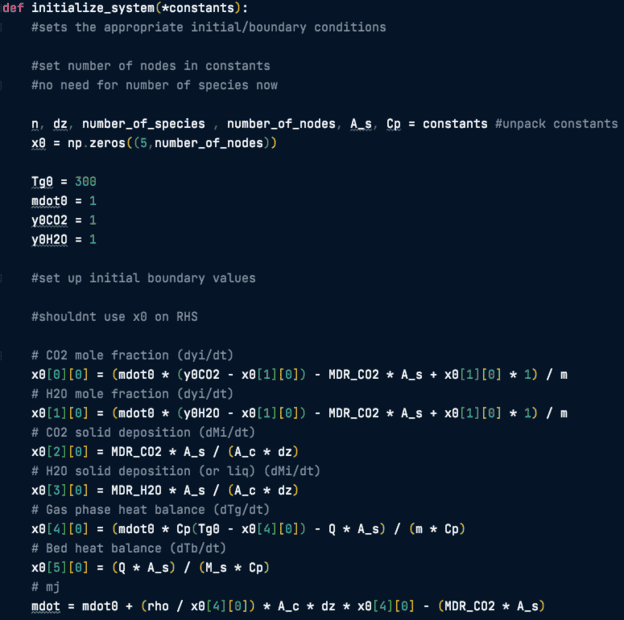

Yes however I'm not sure yet if they are solved at each position/time step independently of the ODEs they are part of i.e. do we solve for the q values first and then use these values in solving the relevant ODEs, or are the q values solved for at the same time as the ODE is being solved (simultaneously)
Previously we used the available integrators (ODEint and solve_ivp). Neither of these have a CN approximation available. Are you suggesting hard coding the CN solution, rather than using an integrator library? I have no issue with that the learning might be good. Is there any advantage to hard coding rather than using an available integrator here?
No. The expressions for the q's are substituted into the two respective heat transfer differential equations.
Sure. That's not a problem right? I'm suggesting solving them for each tank at each time step using predictor-corrector.
The available integrators won't do one tank at a time in sequence.

No. The solid phase heat balance is not solved at all. The heat generated in condensing and evaporation are distributed to the gas- and bed heat balances (by the heat flow equations I gave).
Ah I think this is a terminology mix up. By solid phase heat balance I mean the bed heat balance. So its correct to say the solid deposition heat balance is not solved, but the solid bed (the packed bed) heat balance is i.e. this equation:

The equation F in BSL table 19.2-4 and Exercise 19D.2 seem to suggest that Cp should be evaluated at the existing overall molar composition as ##\sum{y_iC_{P,i}}##.
I should also point out that, in BSL, the molar flux is defined in terms of the mass transfer coefficient by $$\dot{M}_i^"=k_i\left(y_i-\frac{p_i(T)}{P}\right)$$ where ##k_i## has units of moles/m^2s. Under these definitions, the Sherwood number for a porous medium (for use in conjunction with the correlation equation) would be defined as $$\frac{k_iD_p}{(1-\epsilon)cD_i\psi}$$ where, in BSL notation, $$c=\rho_{m}=\frac{P}{RT_I}$$
BSL point out that ##cD_i## is much less dependent on temperature than ##D_i##.
  • #123
Chestermiller said:
This is included in the overall molar balance. No assumptions are made about the composition of the molar flux.
Sorry yes I understand now
Chestermiller said:
The equation F in BSL table 19.2-4 and Exercise 19D.2 seem to suggest that Cp should be evaluated at the existing overall molar composition as ∑yiCP,i.
Ok can do, this seems easy enough to implement anyway.
I could use the tank j-1 position composition to evaluate Cp at tank j as ##\sum{y_iC_{P,i}}##. But yes for now I'll leave it constant to simplify, unless there is a reason not to do this. I'd like to solve the ODEs with as little 'surrounding calculations' as possible
Chestermiller said:
I should also point out that, in BSL, the molar flux is defined in terms of the mass transfer coefficient by M˙i"=ki(yi−pi(T)P) where ki has units of moles/m^2s. Under these definitions, the Sherwood number for a porous medium (for use in conjunction with the correlation equation) would be defined as kiDp(1−ϵ)cDiψ where, in BSL notation, c=ρm=PRTI
BSL point out that cDi is much less dependent on temperature than Di.
Understood. I'll switch to this approach then for the mass transfer coefficient function

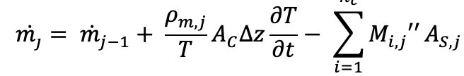

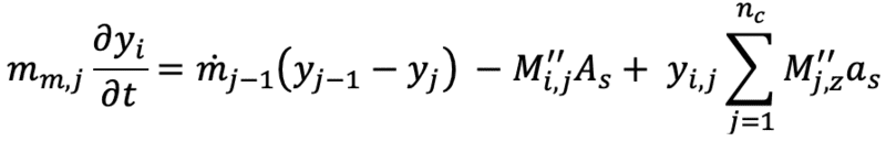

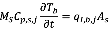

So in summary for this iteration of this model:
Two mole balances (H2O and CO2):
Two solid phase balances (H2O and CO2):
One gas phase and one bed heat balance:
I am tempted to avoid using pythons thermo as much as possible here so save on computation cost and also confusion regarding the solid phase. I think given that thermo can't 'see' the solid phase it will cause some issues down the line so it might be best here to define some other curves manually rather than having to deal with the thermo black box:
- The gas phase N2, H2O and CO2 density curves
- The ideal gas heat capacity curves for N2, H2O and CO2
Is this reasonable?
The only place we will need nitrogen data is in the gas phase heat balance is this correct?
Also we can leave out the CO2 condensation curve completely as we're not in a pressure range that would allow this to occur
As constant in this first iteration of the model (just solving the ODEs really for now) could be the ideal gas heat capacity values, the mass transfer coefficient, component densities, and the heat transfer coefficients
Lastly the initial and boundary conditions are:
ICs:
- molar holdup of H2O and CO2 (both zero initially)
- bed temperature
- gas temperature (= bed temperature)
- mole fractions of H20 and CO2 (both zero initially)
BCs:
- molar flow of each component into the bed
- mole fraction of each component into the bed (or we can calculate this from the above)
- temperature of the flow into the bed
Does the above look reasonable to you?

  • #124
No. These are at the j position. In the derivative subroutine coding for the j'th tank, the solution vector has values for the y's in the j'th tank.
No. Let the automatic integrator do it all for you.

Just some questions on the mass flow out of a tank equation:
This term has a time derivative on the RHS. Is it correct to say that:
1) The time derivative term in this equation comes from solving the gas phase heat balance for ##\frac{\partial T_g}{dt}## and subbing it in here?
2) We will not be including this equation in the integration itself, but just using it to link the flows between tanks
  • #133
Yes, the heat balance for tank j.
Yes. It is the last thing you calculate before moving on to calculate the derivatives for the next tank.
Likes casualguitar

Just to fill you in slightly on where I'm at - I am trying to set up two functions that set up the ODEs for:
1) the initial/boundary conditions
2) the rest of the system

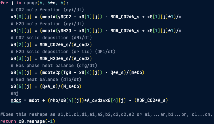

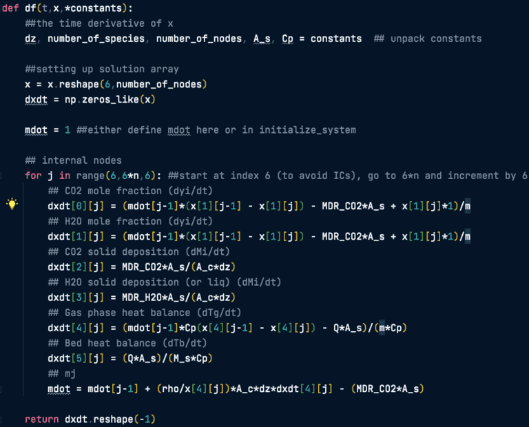

Here is the function for 'the rest of the system'. Note I have left some non constants as constants just because this is really pseudocode i.e. getting the structure right
I should do something similar for the initial/boundary conditions, however I'm a bit stuck as for how to split up the boundary and initial conditions. Working on it though. For reference here is the current 'initial ODE system' code which sets up the ODEs at t=0 which may not make much sense currently:
Working on it

Hey Chet, hope alls well with you.
My apologies, I'm really struggling to set up these initial/boundary conditions. I have found effectively no examples online of solve_ivp being used in this way.
Is it reasonable to implement a simple explicit Euler instead here? I might have to play with the dt depending on the systems stiffness but it would give a first solution. Maybe not too accurate but we could go from there
Are there any big reasons to stick with the automatic integrator?

Just doing the ##h_{fs}## function currently which takes ##Pr##, ##Re## and ##k_g## as inputs.
For the ##k_g## value, is it reasonable to use a mole fraction averaged ##k_g## value here? I.e. take the feed mole fractions of CO2, H2O and N2, calculate ##k_g## of each at the given temperature and then return a mole fraction weighted ##k_g## value?
Edit: This would mean I should write correlation functions for N2 also (cp, mu, rho, etc). I have avoided that up until now because N2 is not present in the ODEs
Edit2: Is it also correct to say that ##h_{fs}## is completely independent of the solid properties?
  • #139
casualguitar said:
Just posting the updates we had over private message -
- boundary condition issues solved
- working on the property/dimensionless number functions
Question:
Where is the Dp?
This is only going to be approximate. In any event, BSL gives mixing rules for k.
This doesn't seem like a big deal.
Of course.

  • #141
For the mass transfer coefficient, I'm confused regarding the reason we need to calculate the Sherwood number. Heres the flow currently:
So we calculate the Re and Sc numbers. Then the mass transfer coefficient ##k_i## seems to be a function of just these two numbers, so why the need to calculate the Sherwood number? And is Sh actually equal to ##k_f##?
  • #142
So I worked back through the mass transfer coefficient correlation derivation (my post above was a load of nonsense in hindsight, apologies). I almost have it but have uncertainty about which Sh number correlation to use. Heres the derivation (I just read back over the heat transfer coefficient derivation you did as its analogous to the mass transfer coefficient):
1) Define Sc and Re
##Re = \frac{6G_0}{a\mu\Psi}##
2) Define the sherwood number
##Sh = \frac{k_id_p}{\rho_mD_{ab}}##
I took this one from BSL. I know you defined another Sh number earlier which was:
##Sh_{loc,i}=\frac{k_iD_p}{(1-\epsilon_g)D_i\psi}##
Its easy to interchange between the two but I am not sure of the reason to use one over the other
Anyway
3) Defining the CC factor ##j_D## as:
##j_D = ShRe^{-1}Sc^{-1/3}##
4) And the same specifically for packed beds:
##j_D = 2.19Re^{-2/3} + 0.78Re^{-0.381}##
5) Letting 3 equal to 4 and solving for k_i:
##k_i = (2.19Re^{1/3} + 0.78Re^{0.619})Sc^{1/3}D_{a,b}\frac{\rho}{d_p}##
Is this correct? I can easily sub in your Sh number instead of the BSL one, but what is the reason you did not use the BSL one?
  • #143
1) Define Sc and Re
Anyway
The approach I'm recommending is based on Reynolds analogy, and I think it is better. I don't think that BSL considered this.
I believe your eon 5 is correct if dp is calculated by the definition in BSL.
  • #144
Hmm I'm taking the characteristic length from the Sherwood number ##l_0## to be ##d_p##, the particle diameter. Why would dp be calculated using the BSL definition? Or have I misunderstood. The units for ##k_i## I have are ##mol/m2.s## not ##m/s## so I guess I am mistaken somewhere here
Also I'm effectively finished the function write ups and plots. I have the mass transfer coefficient one to confirm correct, then the mass deposition one is built on this so I have that also. Besides that I have two small questions regarding ##U_b## and ##U_g##
So ##U_b## will be a constant times the thermal conductivity divided by the particle diameter. This constant is ##\beta## I presume, which is equal to 10 for spheres, meaning that we would get ##U_b = \frac{\beta k_p}{d_p}##?
For ##U_g## we can evaluate this at the bulk gas temperature. I have taken the exact same correlation as we had in the previous model. However you mentioned we would have a correction factor involving viscosity at the interface this time? Why would we have this?
  • #145
I had this worked out a few weeks ago, but don't quite remember now. You need to look at the table in BSL that has various versions of this in there. If I remember correctly, it is almost certainly the ##mol/m2.s## that we should be using. You need to play with the different versions until you arrive at the one that makes sense to you.
Yes, I think so.
See BSL section on heat transfer for turbulent flow in a pipe.
  • #146
Ok got it I think. So using BSLs Sherwood number is ok, however the Reynolds analogy approach you used is better, meaning that ##k_i## would go from this with the BSL Sherwood number of ##Sh_{loc,i} = \frac{k_id_p}{\rho_mD_{ab}}##:
$$k_i = (2.19Re^{1/3} + 0.78Re^{0.619})Sc^{1/3}D_{a,b}\frac{\rho}{d_p}$$
To this, with your Sherwood number of ##Sh_{loc,i}=\frac{k_id_p}{(1-\epsilon_g)D_i\psi}##:
$$k_i = (2.19Re^{1/3} + 0.78Re^{0.619})Sc^{1/3}(1-\epsilon_g)D_i\frac{\psi}{d_p}$$
How would I assess which Sh correlation is better? I could plot one against the other for a range of ##k_i## values and see if they are almost equivalent. However if one returns appreciably higher values than the other I am not sure how to assess which is the better of the two
