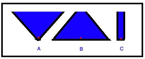

  • #114
chingel said:
How do the walls exert a downward force?
Hi chingel. Maybe I could help explain what Doc Al is trying to say (not to put words in his mouth) but take a look at the picture OmCheeto posted:
These three containers have the same pressure on the bottom where the red dot is because the height of the water in the containers is the same. In C, the pressure on the walls of the container results in a horizontal force, so the walls don't pull up or push down on the bottom of the container (other than the weight of the walls of course). However, in A, the pressure on the walls is again perpendicular to the wall and it has a vertical component of force. That force is downwards and is transmitted through the wall and into the bottom of the container. This is the downwards force Doc Al is referring to.
For the sake of better understanding, let's say A and C have the same area on the bottom of the container and let's neglect the weight of the container and just look at the force downwards due to water pressure. In C, it's simply the pressure on the bottom times the area of the bottom. The horizontal component of force on the walls can't contribute to the downward force. On A however, you could break it up into the force down on the bottom of the container (pressure times area of bottom) plus the additional downwards component of force due to pressure on the walls. The pressure is integrated over the area of the wall (PdA) to get the force, and that force is acting on the wall at some angle. The downward component of that force (the force being a vector) puts stress in the wall and that stress in the wall is what is transmitting the pressure force down to the bottom of the container so that it weighs more than C.
In B, there is also a force on the walls due to pressure, but this time it's actually pushing UP on the walls. That upwards force is transmitted through the walls and down to the bottom of the container. So although we might think the container force downwards is the pressure at the red dot times the area of the bottom of the container, there is also a force UP on the bottom of the container due to the pressure exerted on the walls. That upwards force due to the pressure on the walls (which is transmitted through the walls as stress) results in a force up on the bottom of the container so that the total force due to the walls and bottom of the container is exactly equal to the weight of the water (plus container).

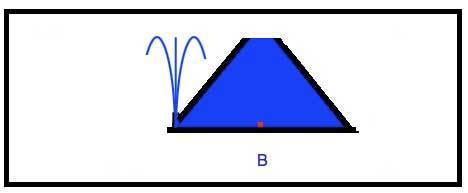

  • #115
Excellent diagram!
And if there's any doubt that the walls of B are applying downward pressure on the water near the edges, imagine what would happen if we removed that pressure that the wall is exerting!

Another problem I have is that if I apply a 1kg per cm2 pressure through a small piston to a closed tank, why does the same pressure get applied to every cm2 of the tank? Isn't the only way that the force can transfer because the water molecules bump into each other and apply the force. But if one water molecule pushes two water molecules, shouldn't the force be divided by the two of them?
In the case of a solid block, the force gets divided by the area of contact at the other end. What is different with a liquid? The water molecules themselves are solid, and shouldn't the force transfer like in the case of solid objects? I can understand why the force goes in all directions in a liquid, because water molecules aren't exactly on top of each other and they are allowed to roll out to the sides if something pushes them at a slight angle.

  • #135
DaveC426913 said:
Hm. I concede, though I do not quite yet get the logic.
Counter-intuitively the movement of a mere 4m x 2mm x 1cm of (80mL/80g) of water is enough to support a 10kg load.
I agree, Pascal's law of hydrostatics (pressure varies with depth of fluid, independent of the shape of the container) is counterintuitive till you "get used to it".
Here's another scenario that might help. Suppose the boat is the lake and resting on the bottom, but just at the point of floating off. Now add 10kg to the weight of the boat. To bring it back to be just on the point of floating, you have to add enough water to raise the level of the whole lake by 1 cm.
In the tank, the physics of situation is exactly the same, but you need a much smaller amount of water to raise the level by 1 cm.
I think you could make a first version of the experiment with something as simple as a glass aquarium tank and a suitable sized watertight box (e.g. make a wooden box and cover the outside with plastic film). Weight the box with sand so it floats at a suitable depth. With a glass tank, you can (literally) see what is happening.
  • #136
That’s the principle of a hydraulic ram.
In the end it all comes down to energy. For example a miserly 1 joule of energy can in principle lift a vast amount of mass. Not very high but it will lift. Of course pretty soon we get into practical troubles but in theory it can be done.

Not really. The buoyancy is not involved in the functioning of the hydraulic press (if this is what you have in mind).

No, as an owner of swimming pools and fish tanks, I'm comfortable with the concept that pressure varies with depth, not with shape or area.
I got it with nasu's explanation. When the water level in the tank rises 1cm yet the boat does not, that means the boat is now displacing 10 more litres of water. As he points out, it is not essential for 10L of displaced water to actually go anywhere.
We just proved that in the part A of the experiment, where we started with naught but a bucket of water in the bottom of a giant vat, and dropped a cubic metre vessel into it. There was no cubic metre of water to move in the first place, so it's not like we had to actually move a cubic metre of water to get the boat to float. The whole point of the entire experiment is that we only need to move a tiny amount of water to effect* buoyancy. I had just forgotten that, by the time I got to Part B is all.
*No, I did not use the wrong word.
