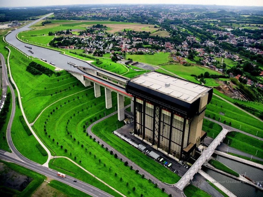

The forum would be useless, if nobody ever learned anything new here. Here is a related question:
Let's say you have an elevated water way on pillars like the upstream entrance to the ship lift:
http://3.bp.blogspot.com/_N7rE_MLfr...1600/Strépy-Thieu+on+the+Canal+du+Centre.jpg
Does the vertical load on the pillars increase, when a heavy ship passes overhead?

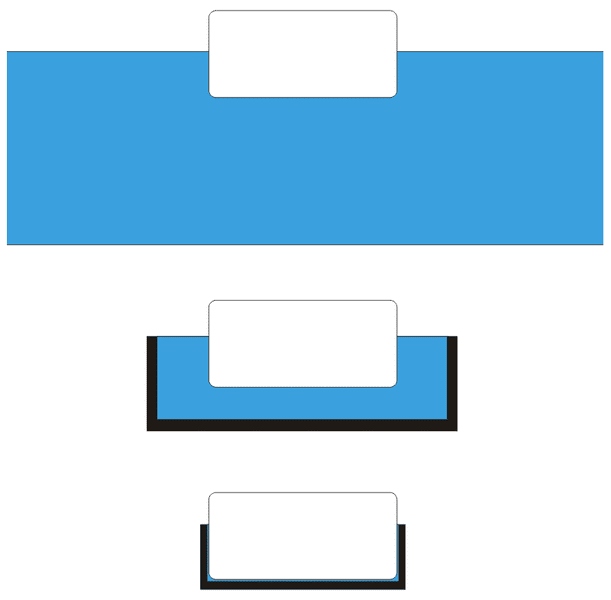

So where exctly between drawing 2 & 3 does the body stop floating?
xxChrisxx said:
In your drawing the top is shown as being open to air, so the water will not increase in pressure,
The pressures at the floating body are the same in all 3 pictures. They must counter the weight which is the same as well.
No. If we view the volume it takes up in the water as 'water-equivalent' (because the ship displaces the water, and only the water, equivalent to its mass), and also that the water level remains the same, so you can see there is no change.
If the vessel is traveling fast, however, the dynamics are more interesting. The water is being pushed up against the bow of the vessel, and therefore the vessel will rise out of the water (this effect directly shows why you can interpret buoyancy in terms of the liquid pressure on the hull). There will also be a bow-wave. We therefore have both more water and less water displaced by the boat (i.e. not only water above the common line, but a boat there too). If the vessel went fast enough and the sensors in your bridge were sensitive enough, you'd see an increase (above the normal) in load as the bow overpasses. A decrease (below the normal) as the stern follows is self-evident because there will have to be an 'average-normal' over the time interval that the vessel passes overhead.
The pictures are not helpful becuase they have no information associated with them.
The condition that something does not float is when:
Upthrust < weight in air.
upthrust being = volume displaced * density of water.
So in case 3 there visually appears to be less volume of water necessary to achieve this condition.
If there is, then the pictue is wrong and the object should be touching the bottom.
If there is only 1 gallon (4.5 l) total. The maximum upthrust of fresh water is 4.5 kg. As you can't displace more water than you have. The maximum weight you can support is 4.5kg.
EDIT: This thread keeps changing too quickly, people sticking caveats in everywhere that changed the nature of the question.

Chris, you are going through EXACTLY the same thought process that I did. I vehemently opposed the correctness of the concept of floating a battleship in a bucket of water, but when you have thought it all through, you will realize, as I did, that it does indeed work.
The graphics, by the way, are selfcontained and have all the information you need to figure this out.

  • #70
A.T. said:
The volume of water is irrelevant to the above condtion, because it doesn't appear in it. I explained that already to you:
volume displaced = volume of the ship below the water surface
In case 3 the volume displaced is exactly the same as in the other cases.
I know that.
A.T. said:
Wrong, see above
But that doesn't make sense.
I come from a background of designing buoys in open water. Which is easy becuase volume sat in the water = the volume of water displaced. So for me volume displaces is the volume of water. So I've always worked in terms of total WIA and net and gross buoyancy.
I'm sure there's things I'm missing, but I can't see what.
