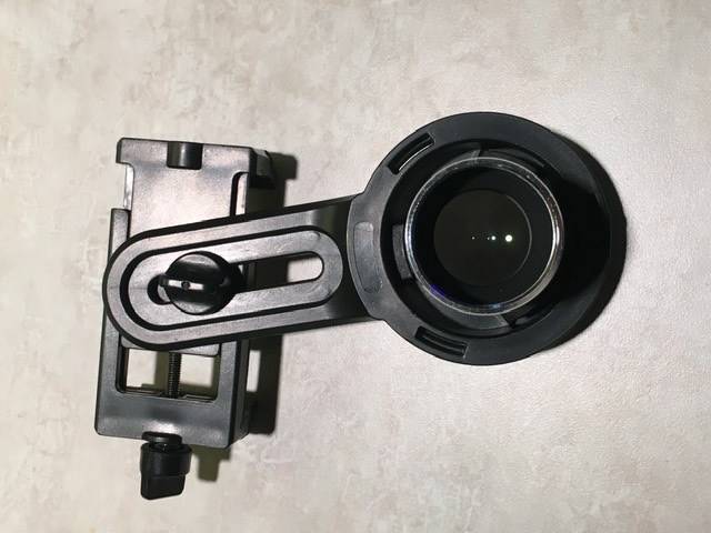

Bru,
like this...
Look through the eyepiece backwards and center the camera that you see when the cameraphone is mounted to your adapter.

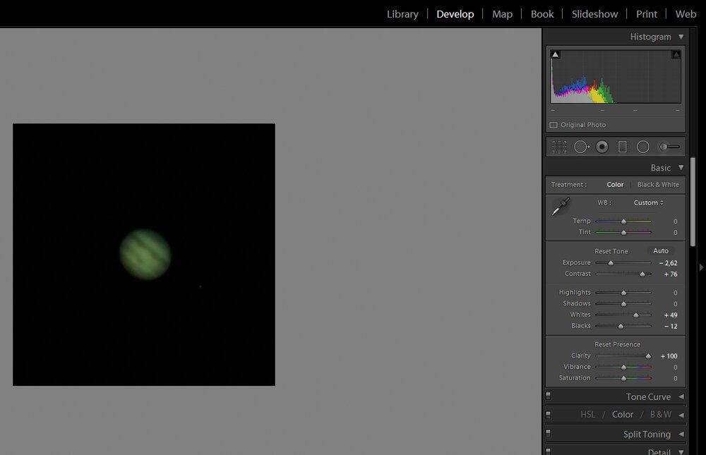

Is that the GRS in the lower band? It is supposed to be crossing the center of the planet tonight at 11:19 local time and these shots were taken at around 11:25. Hmmm. Is it real or artifact? I'm thinking it's real. The festoons (slight bulges here) of the upper band are indicated on other folks much better pics yesterday.
I also think it is the GRS. I compared with the other photo and did the same estimation.
I also took the liberty of playing around with an adjustment of your Jupiter photo just to show what I did with mine in Adobe Lightroom and Photoshop. I fiddled around a bit, and ended up using these adjustments:
In Adobe Lightroom:
Exposure: -2.62
Contrast: +76
Clarity: +100
(I also clicked the checkbox "remove chromatic aberration", which is not shown in the screenshot)

Those look great. I bow to your processing skills. Definitely not angry, Bru!
