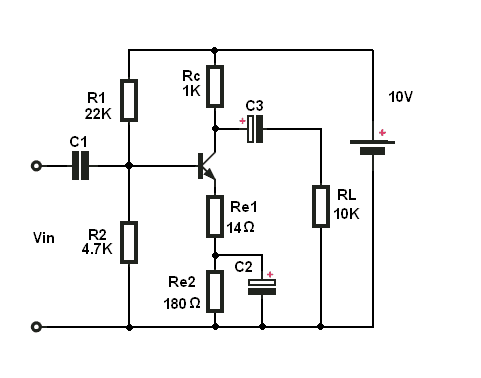

ooo man i don't know how to deterimine zin and zout ;-) how do you select zin and zout, i am just a begginer, is zin R1 and R2 and zout rc and rl, if is yes, how you determine how you select calculate
  • #54
Collector resistor is Zout.
Zin is R1||R2||(beta*Re). In the schematic that Jony posted Re becomes Re1||Re2.
  • #55
michael1978 said:
so this is the steps if i need to build an amplifier thnx
gain rc//rl/re, but i see there in resistor in serie with capacitor
how come now gain RC//RL/RE2+RE1 am i correct, if not can you tell me
i don't get gain of 50
Simply voltage gain of a CE amplifier is always equal to
Av = ( resistance seen from collector toward the output) / (re + (resistance seen from emitter to gnd)
So we have
Av = (Rc||RL)/ ( re + Re1||Re2) = 909Ω/( 6.5Ω + 220Ω||12Ω ) ≈ 909/18.5Ω = 49.13[V/V]
Zin = R1||R2||( Hfe+1 *(re+Re1||Re2) ) = 25KΩ||( 421 * 18.5Ω) = 25K||7.8KΩ = 5.9KΩ
And
Zout ≈ Rc ≈ 1KΩ

There is a error instead-of 70 it should be 50. The voltage gain we want is equal to 50[V/V].
OE amplifier voltage gain is equal to
Av = Rc/re so to find desired re value I use this equation:
re = Rc/Av
And in my example the gain I want is equal to 50[V/V] and Rc = 1K; RL = 10K
So form this
Rc||RL = 909Ω
re = Rc||RL/Av = (1K||10K)/50 = 909Ω/50 = 18Ω
It is clear now ?

  • #66
OK
Av = Rc/re = gm*Rc = Ic/26mV*Rc = (Ic*Rc)/26mV
50[V/V] = (Ic*Rc)/26mV
from this
(Ic*Rc) = 1.3
I choose Rc = 1K
So
Ic = 1.3/1K = 1.3mA
But as you can see this approach is not very good because give as low voltage swing.
We need to use Re1 or use a different type of a circuit. But lest as add Re1 resistor.
Now Av = Rc/(re+Re1)
And for Rc = 1K we can use this
Ic = 0.5Vcc/Rc = 5V/1K = 5mA
So re = 26mV/5mA = 5.2Ω
And
Re1 = Rc/Av - re = 1K/50 - 5.2Ω = 20 - 5.2Ω = 14Ω
This circuit is also not very good because low Re1 means that Hfe spread and temperature change will have significant impact on bias point stability. This is why I use Ve = 1V and add Re2 to reduce the voltage gain to 50[V/V]

  • #68
Also we can split Re resistor with a capacitor. And use Re1 = 14Ω and Re2 = Ve/Ic - re1 = 1V/5mA - 14Ω ≈ 180Ω
And now we can select R1 and R2
Vb = Ve + Vbe = Ic*(Re1+Re2)+ Vbe = 5mA* (180 + 14) + 0.65V = 1.62V
If we assume Hfe = 150
Ib = Ic/hfe = 5mA/150 = 34μA
R1 = (Vcc - Vb)/( 11*Ib) = 22KΩ
R2 = Vb/(10*Ib) = 4.7KΩ

This two equation holds only if Ve > 0.6V
R2 = Vb/(10*Ib)

  • #77
OK
For this diagram the voltage gain is equal to
Av ≈ Rc/(re+Re1)
Rc = 0.1*RL = 0.1*10K = 1K
And
This circuit is not very good because low Re1 means that Hfe spread and temperature change will have significant impact on the bias point stability. This is why I use Ve = 1V for good bias stability.
To overcome this problem of a low value for Re1 = 14Ω and Ve = 70mV (Ve = Re1 *Ic = 5mA*14Ω = 70mV).
I add anther Re resistor in series with Re1.
Now we have
Ve = Ic * Re1+Re2 and we want Ve = 1V so
Re2 = Ve/Ic - Re1 = 1V/5mA - 14Ω ≈ 180Ω
And I use C2 capacitor to "remove" Re2 from gain equation for AC signal.
Av = Rc||RL/(re + Re1)
  • #78
Jony130 said:
OK
Av ≈ Rc/(re+Re1)
And
Now we have
JONEY THANK YOU, i understand everything, just this one no
R1 = (Vcc - Vb)/( 11*Ib) = 22KΩ, where come 11, how come this 11 can you explain me thnx
  • #79
First think first.
The one of the methods to become independent of hfe changes is to select voltage divider resistor (R1 and R2) in such a way that base current don't load our voltage divider to much. The maximum base current is equal to Ib_max = Ic/Hfe_min where Hfe_min is a minimum value for Hfe in data sheet.
And we select voltage divider current so that I_divader > Ib_max
In our example voltage divider current is I2 current .
But as you can see the current that flows through R1 resistor is equal to divider current plus base current.
Additional if we assume that divider current is ten times greater than base current.
I2 = 10 * Ib
the R1 resistor current I1 becomes
I1 = I2 + Ib = 10*Ib + Ib = 11*Ib
And this is why
R1 = (Vcc - Vb) / (10*Ib + Ib) = (Vcc - Vb)/(11*IB)
and
R2 = Vb/(10*Ib)

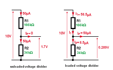

Do you understand first kirchhoffs law ?
Do you know how loaded voltage divider work?
joney i know i think
and i do like i see in some book voltage divider like this
for example we need base current of 50MICRO
AND base voltage of 1.7V so now
for example if is 10vcc
r2 1.7v base/50micro is come 34ohm
r1 must have 8.3V/50MICRO is come 166ohm
so 10VCC/200=5MICRO
so the current in serie is the same, maybe i do somewhere mistake
i am curios to know your calculation how you get 10 and 11 in voltage divider, this is something new to me, but can you show another with example so i can understand, you show also the first example with gain of 50 do you rembember also there i see
R2 = Vb / ( 5 * Ib) = 30K
R1 = ( Vcc - Vb) / ( 6 * Ib) = 150KΩ
wher how you get 5 and 6, and second example r2 10 and r1 11, can you show me example just one the second i find self, i know you can do it, just with example in some easy way please joney i whait yesterday all day message from you, because i want to learn it, and i learn good how to select desired voltage and i am happy, but this no
valu of 11 and 10
joney plase show me example in easy way so i can understand thnx for reply...
  • #85
so 10VCC/200=5MICRO
Simply you forget about base current which loads the voltage divider in your calculations.
So to reduce this loading effect on output voltage we need increase the current that is flow through voltage divider or output current should be a small fraction of the voltage divider current.
So when we design voltage divider we assume that voltage divider current is larger then the load current.
Normally Divider current is 5 to 30 times larger then the load current.
So if we want 1.7V and load current is equal to 50μA and we choose voltage divider current 10 times larger then load current we have this
R2 = 1.7V/(10*Iload) = 1.7V/(10*50μ) = 1.5V/500μA = 3.4K
And from I Kirchhoff's Law we see that R1 resistor current is equal:
I_R1 = 10*Iload + Iload = 11*Iload = 550μA
So
R1 = (10V - 1.7V)/(550μ) = 15K

  • #86
So
