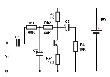

Jony130 said:
We need Re2 resistor simply because it is almost impassible to build amplifier with desired low voltage gain and Ve > Vbe. Which is needed for good bias point stability.
But if you determined to use only Re1 resistor. We need to change DC bias method.
So we are not going to use voltage divider, instead of voltage divider we will use a collector-feedback bias circuit.
So for our example for Vcc = 10V and Rc = 1K;RL = 10K; Ic = 5mA and Av = 50.
re = 26mV/Ic = 5.2Ω
Re1 = (Rc||RL)/Av - re = 909Ω/50 - 5.2 = 12Ω
Vc = Vcc - Ic*Rc = 5V
Vb = Ic*Re1 + Vbe = 0.71V
And
Ib = Ic/hfe = 5mA/150 = 33.4μA
Rb1+Rb2 = (Vc - Vb)/Ib = 4.29V/33.4μA = 128KΩ
Rb1 = Rb2 = 128K/2 = 68KΩ
And simulation show that voltage gain is equal to AV = 51.8092[V/V]
hi Jony can you help me with this equation
on page 3 post 48
this one Re2 = ( 220 * 11.5 ) / (220 - 12.5) = 12.1 = 12Ω.
is not like you told me Re2 = ( 220 * 11.5 ) / (220 + 12.5) = 12.1 = 12Ω in place from - in plus +

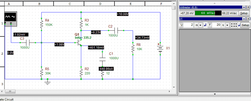

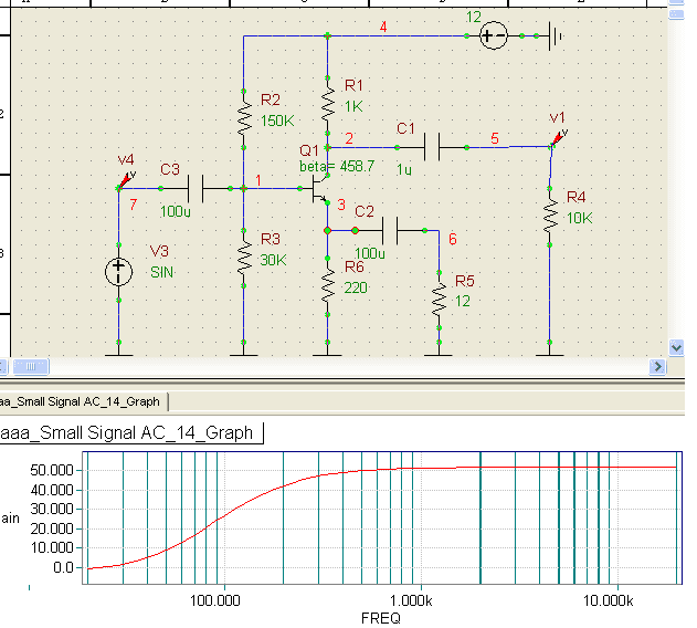

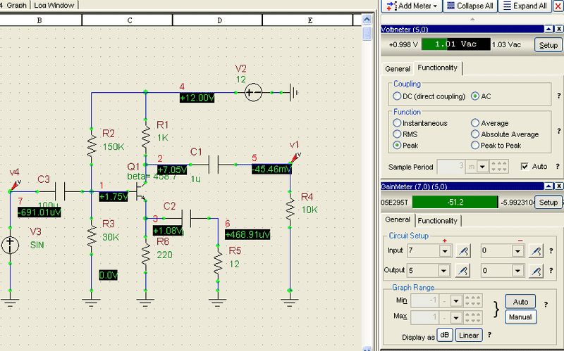

, of this is other formula
can you answer me
  • #178
NascentOxygen said:
This expression has re2 on both sides. We need to extract it to one side, and if you do the algebra you will see how the - sign comes about.
re2 = ( 220 * 11.5 ) / (220 - 11.5) = 12.13 ⋍ 12
yes you right i am learning a little bit math , from the book basic math for electronics
is not the same like this equation
re1||re2 (re1*re2)/(re1+re2)
  • #179
Jony130 said:
When we start design any circuit we need to know circuit specification.
If you have a 2mV input voltage and 100mV at output you need a amplifier with gain
Av = 100mV/2mV = 50[V/V] and Zin = 50K and Rload >2K.
Is not so easy to meet all this requirements whit this simple amplifier.
So I change them to
Voltage Gain= 50
Load Resistance= 10k ohm
Vce= 5V
First we need select BJT I choose BC546C with typical hfe = 520 and Hfe_min = 420
I start selection from Rc resistor.
Rc < 0.1Rload = 1KΩ
Additional I assume Ve = 1V
So
Ic = (Vcc - Vce - Ve)/Rc = (10V - 5V - 1V)/1KΩ = 4mA
next
Re1 = Ve/Ic = 1V/4mA = 250 but I chose 220Ω
Vb = Ic*RE + Vbe = 4mA * 220Ω + 0.65V = 1.53V (voltage at base)
Ib = Ic/Hfe_min = 4mA/420 ≈ 10μA (base current)
R2 = Vb / ( 5 * Ib) = 30K
R1 = ( Vcc - Vb) / ( 6 * Ib) = 150KΩ
So know if we want voltage gain 50V/V
Av = 50 = (Rc|| RL) / ( re + (Re1||Re2) )
( re + (Re1||Re2) ) = (Rc|| RL) / 70 = 909Ω/50 = 18Ω
re = 26mV/Ic = 26mV/4mA = 6.5Ω
18Ω = (re + (Re1||Re2)) = ( 6.5Ω + (220||Re2) )
Re1||Re2 = 18Ω - re = 11.5Ω

JONEY why i get 0.200 Vac?,
  • #180
I don't know why. Maybe you made a mistake in simulation program.
  • #181
yes Jony, i do it one more time and is now 0,68 Vac now smaller, of i have to change the emitter capacitor , because the value of capacitor i make 1000u, of transistor , which transistor you think to use do you know some type?
because input is 2mv*50gain=100MV
thnx for reply

look my circuit, i don't know where i make mistake, normal gain have to be 50*2Mv=100mV Peak
  • #185
It's not a very good design. For bias point stability (against VB and ß variations) you should allow a couple of volts across the emitter resistor; you have just 0.4V.
For maximum symmetrical output swing, you should allow approx as much voltage across RC as VCE. But you have ~1.8V and 7.8V, resp.
At what frequency are you measuring the ac gain?
  • #186
No the design is good. Simply the BJT that michael1978 use in his simulation has a very low current gain.
Ie = 0.4V/220Ω = 1.8mA
And Ib = IR4 - IR5
IR4 = 1V/30K = 33.4μA
IR5 = (10V - 1V)/150kΩ = 9V/150KΩ = 60μA
So Ib = 60μA - 33.4μA = 26.6μA
And Hfe = β = (Ie/Ib - 1) = 66.6
And this circuit was design for Hfe > 420

Well first you need to learn how to use the simulation program.
I use B2 Spice V5 and as a BJT use BC547C. And AC sweep analysis show that voltage gain is equal to 50.1V/V
For 20mV at input I get 1V at output.
  • #199
but this was disegn for 10v battery not 12v
  • #200
Well for Vcc = 10V the voltage gain is equal to 46V/V (0.9V at output for 20mV at input) because we don't included RL in our calculations when we solve for Re2.
