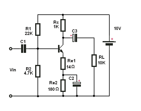

Jony130 said:
In our cases we have 11 apples
B = 10*A + A
And apples are equal to 50uA of load current.
So we substitute for A = 50uA
B = 10*50uA + 50uA = 550uA
And this is equal to 11*A = 11*50 = 550uA
the 11 tell as that the R1 current is 11 times large the load current.

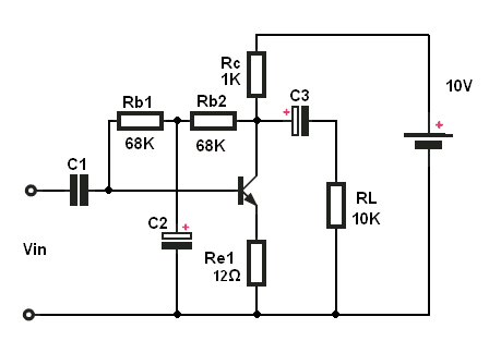

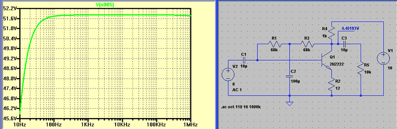

michael1978 said:
thank you very much
joney is correct this amplifier, he give voltage gain of 44mv not 50mv
I don't know. You need to tell me the bias point collector current and BJT model that you use.
  • #112
this your example i just simulate (do you see the foto the value) in quote 69
Vb = Ve + Vbe = Ic*(Re1+Re2)+ Vbe = 5mA* (180 + 14) + 0.65V = 1.62V
If we assume Hfe = 150 I (I use transistor 2N3903 I don’t know other there are a lot of types)
Ib = Ic/hfe = 5mA/150 = 34μA
R1 = (Vcc - Vb)/( 11*Ib) = 22KΩ
R2 = Vb/(10*Ib) = 4.7KΩ
Re1 = Rc/Av - re = 1K/50 - 5.2Ω = 20 - 5.2Ω = 14Ω

But your circuit is different than mine. Also you can read from simulation DC collector current.
And your circuit has a voltage gain equal to:
Av = Vout/Vin = 44.33mV/2mV = 22.165[V/V]

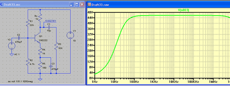

My example look like this:
And has a voltage gain Av = 45.8V/V But we can easily change the voltage gain by changing the Re1 resistance.

  • #115
I did not read the whole thread. Remember when I left off, I showed you how to calculate the gain? It's the impedance seen at the collector divided be the impedance seen by the emitter? Adding C2 don't change this, the total emitter resistance is
r'e+ Re1+(Re2//Xc2) where X_{C2}=\frac 1 {j\omega C}
You change the Re2, you change the impedance on the emitter side and change the gain.

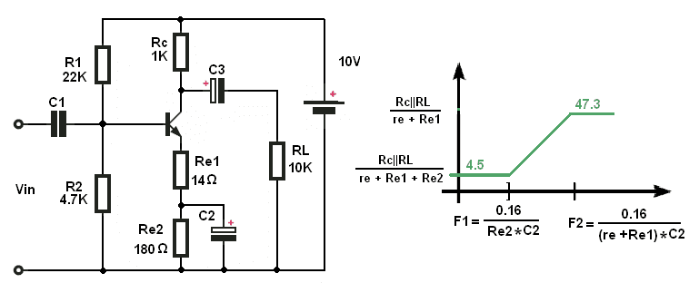

Regarding the circuit. This circuit is a voltage divider bias using R1 and R2 to set up the bias voltage of 10(4.7K/26.7K)=1.76V for Q1 . The emitter of Q1 is about 1.06V. Read this in Malvino. R5 together with R4 is to set up the DC of about 5mA current through Q1 and re' is about 25/5=5ohm. But without C2, gain of the stage is Rc/(Re1+Re2+re')=5. That's very low to be useful.
C2 is to provide a low impedance path to bypass Re2 at higher frequency. With the C2, the gain of the stage is Rc/(re'+Re1+(Re2//Xc)). The impedance of C2 is X_C=\frac 1 {j2\pi f C}.
But this is complicated for you. So you can use approximation.
1) At very low frequency, Xc is very high, so you can ignore it. So the gain is Rc/(re'+Re`1+Re2).
2) At frequency where Re2=\frac 1 {2\pi f C}, the total resistance of Re2// C2 decrease and the gain of the stage start to rise as show in the graph. It is not important to know the exact frequency as the final gain is usually the important one.
3) As frequency goes higher, Xc is getting lower and lower. Re1<<Re2, you can simplify by ignore Re2. At frequency where \frac 1 { 2\pi fC}=Re2, the effect of C2 start to level out. At even higher frequency, C2 can be approximated to be a short circuit( 0 ohm). So at much higher frequency, the gain of the stage is Rc/(re'+Re1) only, as C2 is a short circuit and Re2 is shorted out.
4) the transition frequency where \frac 1 { 2\pi f C}=R_{e1} is usually called f_c where \frac 1 { 2\pi f_c C}=Re1 or f_c=\frac 1 {2 \pi R_{e1} C_2}. You can see the point of fc where the graph of the gain start bending horizontal to level out.
Hope this help. This is an approximation. For more accurate calculation, you really have to use complex number, but believe me, it's good enough. I use this all these years for my own design at work.

yungman you made a small mistake. I suspect a typo error.
If we assume that C1 and C3 >> C2 and Re1 << Re2
So now we can find corner frequency as:
\Large Fc\approx \frac{0.16}{(re+Re1)*C2}

Yes, in 4), it should by Re1. I change the 2 to 1 already.

Read my post #122, I explained step by step why at high frequency, Re2 disappeared. The explanation is adding on top of what Jony130's diagram and all. You really need to stop and work it out step by step, put in some numbers and work it out.
BTW I still miss one on 3). Re2 should be Re1.
You need to show some effort, use the number Jony130 gave in the diagram and show us your calculation. Whether it is correct or not, show you try to solve the problem. I help you at the beginning, together with Malvino, you should be able to get started. But after 9 pages of question and answer, you are still pretty much on the same circuit with the addition of C2 and Re2!
Work out some numbers and people are more than happy to help.

  • #141
Read the bias scheme in Malvino. Re2 is to stabilizing the collector current. This is called voltage divider bias. R1 and R2 form a voltage divider to give about 1.7V at the base. The emitter is about 0.7V below so the emitter is at about 1V. You have Re1+Re2 about 200 ohm ( don't be picky), so you are setting up the emitter current ( collector current) of about 5 mA. This 5 mA will give r'e ≈ 5 ohm. The point of using voltage divider bias is to control the current through the BJT by the voltage drop across the Re2. This make it a lot more predictable. Read Malvino, it's all there.
The C2 is to bypass Re2 at frequency you want to amplify. At high frequency, Re2 is being shorted out by C2, so the resistance on the emitter side is r'e+Re1=19 ohm or 20 ohm.
No matter how the circuit looks like, in common emitter BJT circuit, the gain is the total impedance at the collector divided by the total impedance at the emitter. AND it is inverted. It is just that simple.

So you know it is 1.7V at the base and 1V at the emitter.
YES, you set Ie with the emitter resistor ( Re1+Re2). This is the KEY of DC biasing. You first set up the operating current Ie of the transistor, this is the first and foremost thing. Collector don't set the current of the BJT, collector current is only follow the emitter current. AGAIN, this is in Malvino.
1) In the diagram, Re1+Re2 is about 200 ohm. You put 1V at emitter, you put 1V across the Re1 and Re2. SO you force 5mA through the resistors...Which, means you set the Ie to 5mA. This is how you set up the DC bias current.
2) After setting the Ie, then you start looking at the collector. You know β is high, so you know the Ic≈5mA. If you have Vcc=10V, and you have 1K resistor at the collector, then you know 5mA through 1K is 5V. So the collector is at +5V.
3) AGAIN, gain is determined by the impedance at the collector divided by the impedance at the emitter. We gone over this over and over and over already. Read the old posts AGAIN.
These are all in Malvino. Please read that before you ask any more question. If you don't get it, read it, write out the numbers, work through the problems before you post.
  • #145
We need Re2 resistor simply because it is almost impassible to build amplifier with desired low voltage gain and Ve > Vbe. Which is needed for good bias point stability.
But if you determined to use only Re1 resistor. We need to change DC bias method.
So we are not going to use voltage divider, instead of voltage divider we will use a collector-feedback bias circuit.
So for our example for Vcc = 10V and Rc = 1K;RL = 10K; Ic = 5mA and Av = 50.
re = 26mV/Ic = 5.2Ω
Re1 = (Rc||RL)/Av - re = 909Ω/50 - 5.2 = 12Ω
Vc = Vcc - Ic*Rc = 5V
Vb = Ic*Re1 + Vbe = 0.71V
And
Ib = Ic/hfe = 5mA/150 = 33.4μA
Rb1+Rb2 = (Vc - Vb)/Ib = 4.29V/33.4μA = 128KΩ
Rb1 = Rb2 = 128K/2 = 68KΩ
And simulation show that voltage gain is equal to AV = 51.8092[V/V]
  • #146
re = 26mV/Ic = 5.2Ω
And
JONEY thank you for reply i am learning a lot from you, you are the beste;-) COMPLIMENT
did you see the post 146 of Joney, maybe i am mistake but malvino he don't show you how to get desired voltage, i wil like to ask you why Jony, he put so big resistance of voltage divider i say for r1 22K and for R2 4.7k how he calculate,? me i put it R2=170, and R1=830, look how big difference, he show one example but me i put in other way,

You talking about post 114? The resistance is 22K//4.7K ( if I ignore the input resistance of the transistor). In fact the input resistance is quite low to me.
Usually you want the input resistance to be a little on the high side so the stage driving this input don't have to drive a low impedance. Think if you have a stage like in post 114, if the collector is driving the following stage with low impedance like 1K. The collector resistance is 1K//1K=500 ohm. You lower the gain of the driving stage.
In both diagrams, the input resistance of the transistor is β(r'e + Re1).=β(20Ω)≈2K assuming β=100. This is quite low. Another way to look at it is the transistor in both case require 5mA/β= 50uA. The impedance of the input biasing network has to be low enough so it is not loaded down by the input of the transistor. Jony got into this a little in post 79 about the base current.
